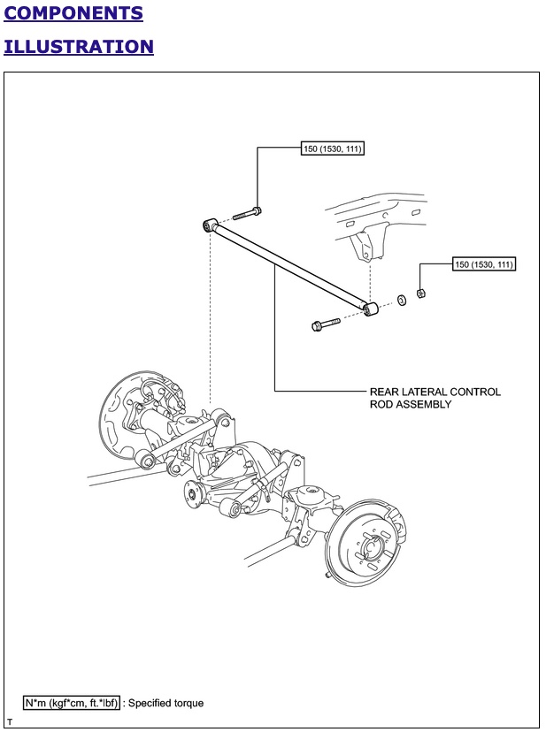

On a related note, can anyone confirm the torque spec for the panhard bolts? I’d seen 111ft lb, but not sure how reliable that source was.
That’s a great data point, and looking at it that makes sense, as raising it to level would have been a greater distance than the 2” compensation from the lift.
Assuming you find a nut that fits the factory bolt, yes 111 is the number. If you use other hardware you should look up the torque value for that diameter/pitch.
My eimkeith kit came with a nut, and since I haven't installed it yet, I'm only speculating, but I think the intent is to reuse the factory bolt.
More evidence of a well thought out product. I got my kit long enough ago that I forgot what was in there, and my 2720s haven’t forced the install yet. The 2721s sitting on my garage floor will..
