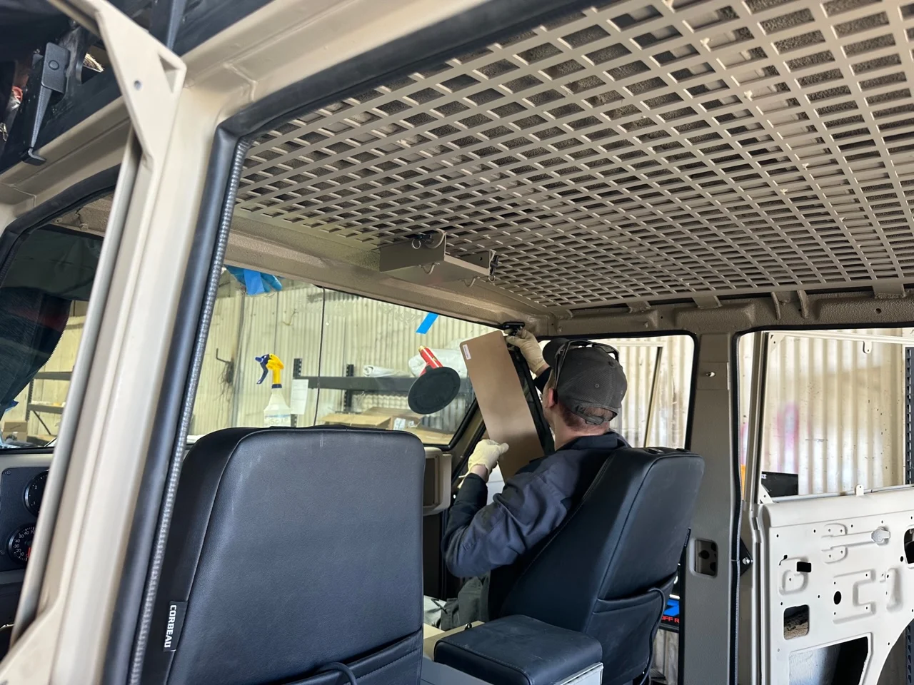

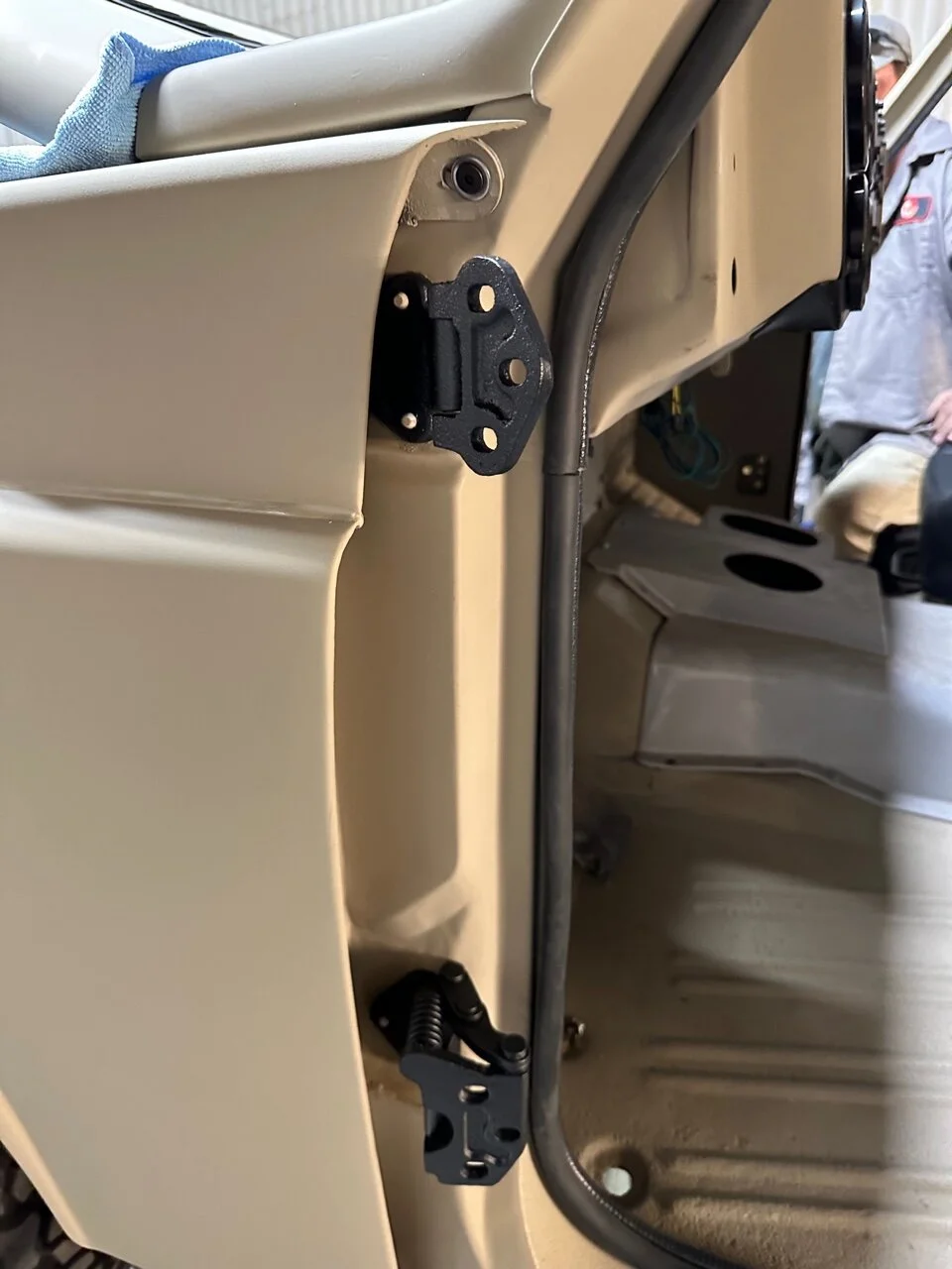

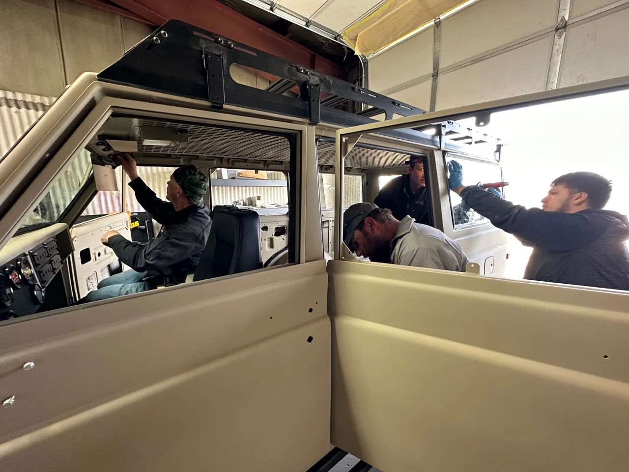

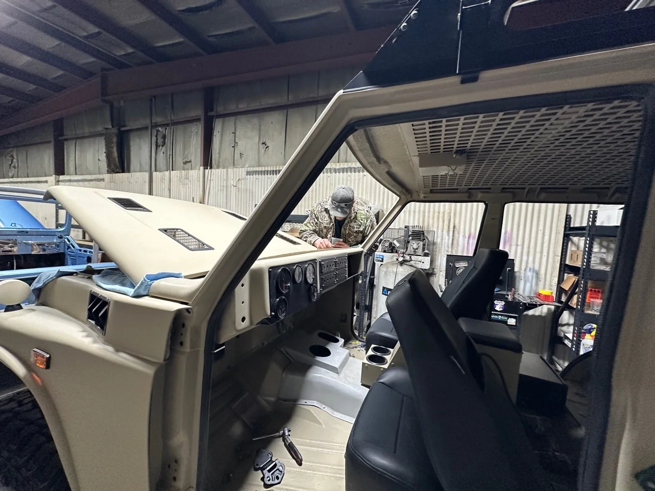

Not too much to report. The bumpers have been powder coated. The body was sandblasted. After sandblasting, we discovered that the Pig was a Sheriff's vehicle and that the sheriff (or deputy) must have dropped their donut and, while reaching for it on the floor, accidentally discharged their firearm and shot through the firewall (see last photos). That's all hypothetical, of course.
Bodywork has begun and we have also started to apply the Lizard Skin sound deadening and ceramic insulation.
View attachment 3193365View attachment 3193368View attachment 3193369View attachment 3193373View attachment 3193374
