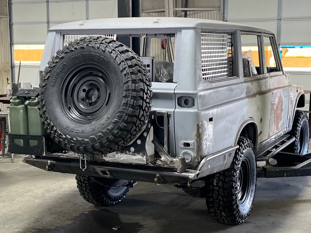

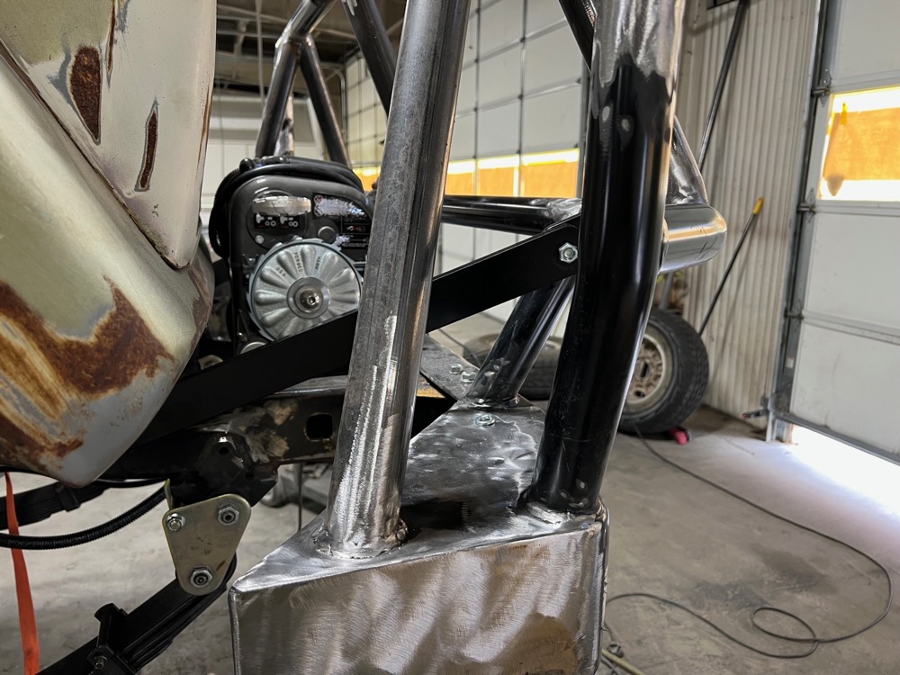

Hi everyone,
Evidently, I'm not a very good communicator......or so I'm told.

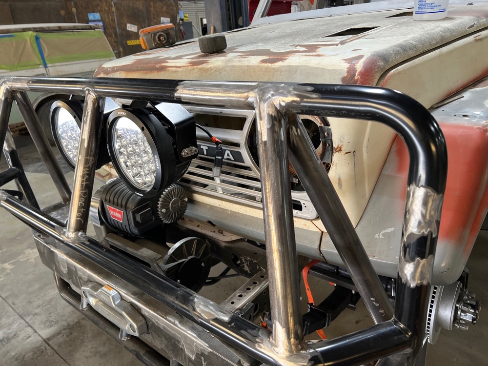

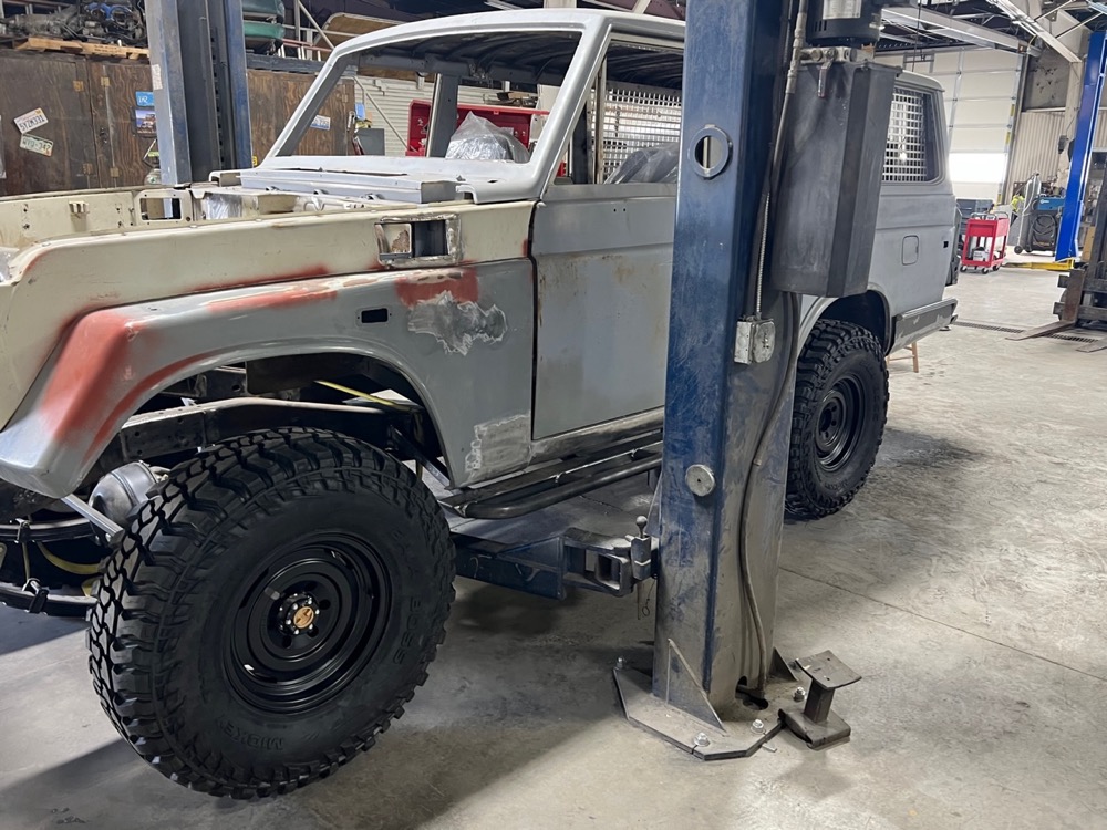

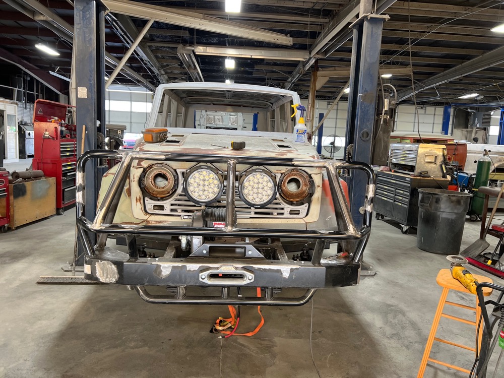

But I wanted to provide an update to the MUD community.....so here are some photos of the current state of the overland build.
It took a while to get the body in rust-free condition....and posting photos of that work isn't very interesting (to me).

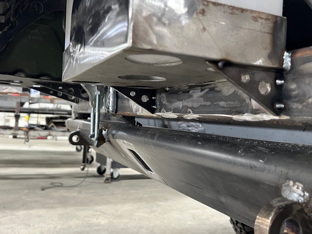

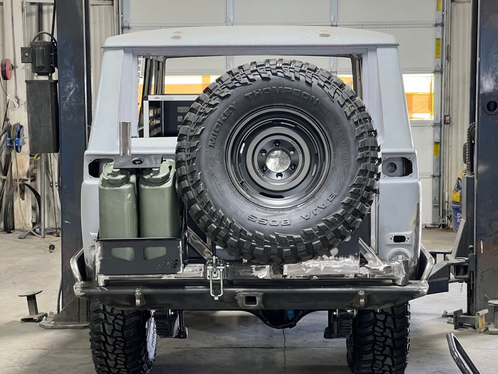

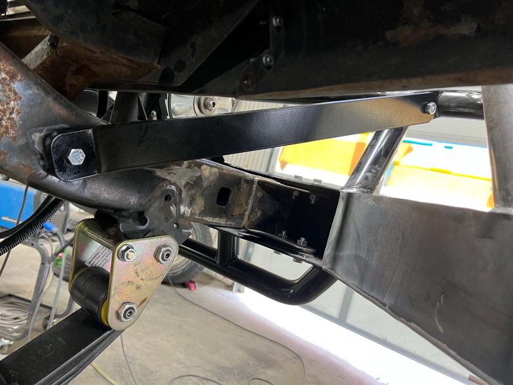

All the fabrication work has been done by Jason Burge and his team at The Rust Doctor in Grand Junction. I cannot say enough about the quality of his work. He's going to have to change the name of his company. They obviously do more than just rust repair.
Some of you will identify some of the components.....everything else is Jason's work. CBI can holder & tables, 4x4Labs bumper, Rotopax containers, White Knuckle rock sliders..... We are awaiting a 10 lbs. propane bottle to install the Expedition Essentials holder above the cans and the Uniden antenna mount. Then the bumper should be complete and off to powder coat.
The next step is to drop the rig off at Alcan Spring (just down the road 3 miles) for weighing and custom work on the springs.
I'll post photos of the front bumper in a separate post since I hit my 5 photo max.
The rig will be used on an around-the-world expedition...details here: www.overlandnomads.net
Thanks for your interest!
