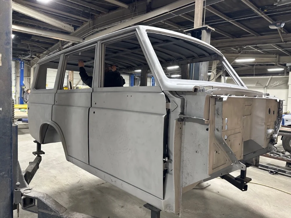

Not too much to report. The bumpers have been powder coated. The body was sandblasted. After sandblasting, we discovered that the Pig was a Sheriff's vehicle and that the sheriff (or deputy) must have dropped their donut and, while reaching for it on the floor, accidentally discharged their firearm and shot through the firewall (see last photos). That's all hypothetical, of course.

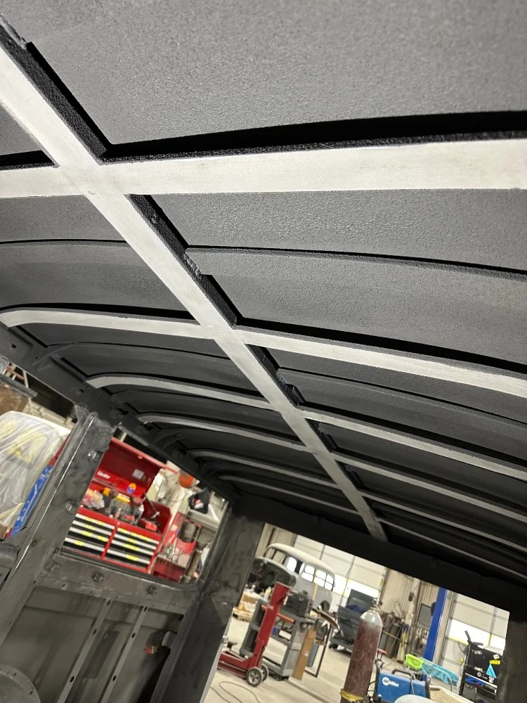

Bodywork has begun and we have also started to apply the Lizard Skin sound deadening and ceramic insulation.

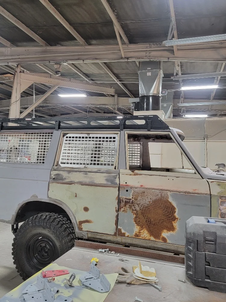

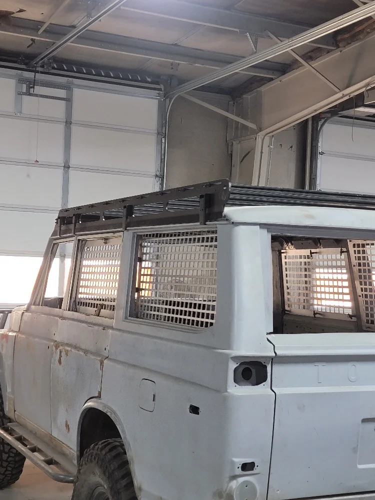

...before it went off to sand blasting, we received the rack from Bowfin. Very impressed with the quality and excited to spread the weight of the RTT, awning and shower cube across the entire length of the drip rails....versus using load bars and feet.
