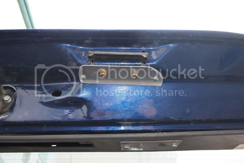

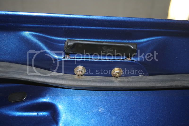

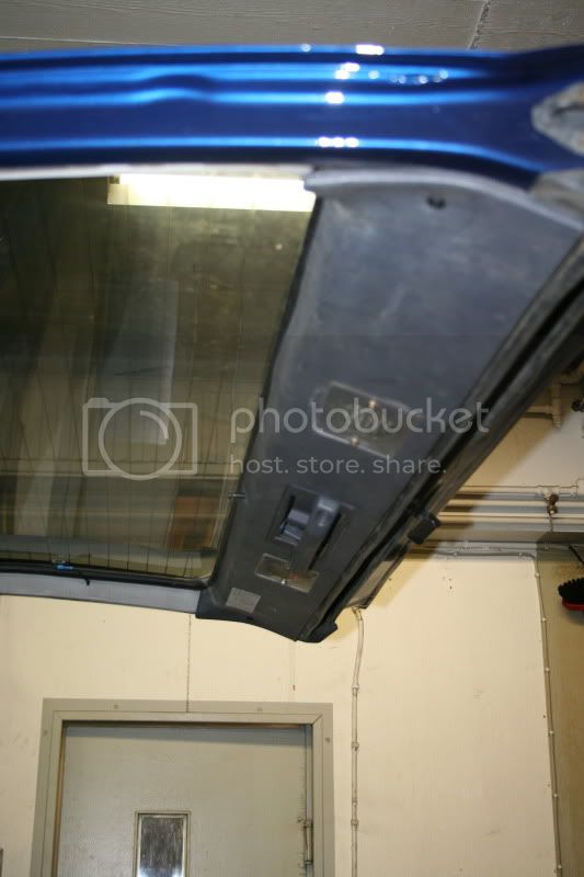

Yes, I am. I had some minor problems when installing the opening handle inside the hatch. In the original metal hatch it is a thight fit. The fiberglass is much thicker and there was not enough space for it. I had to cut a piece of the fiberglass out and use a strip of aluminum to hold it in place. But no problem at all. I´m sure the fiberglasser will take care of this before he makes the next one.
Now I have the aluminium painted in the same color and countersunk bolts to hold it in place. I will add some more pics of the gate and the interior when I finish it.

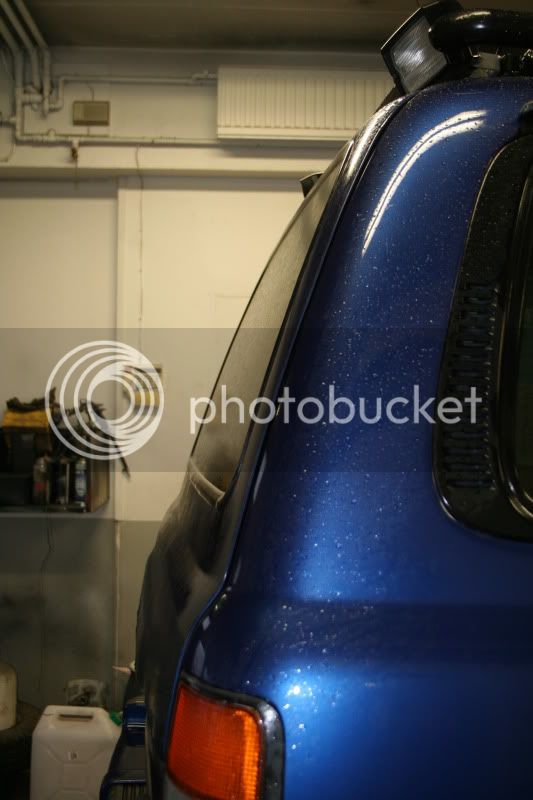

The outside of the hatch is not quite as perfect as a new metal hatch, when the sun reflects on it you notice that, and it is not quite as massive as a metal hatch (it bends out more easily when you pull the sides of it out with the gate locked) but it really looks good and is a good fit. Totally worth what I paid for it (1/5 of the price of a new hatch from the dealership). I got a good price since I my hatch was used to make the mold an got the first prototype.
I´m sure that no one will ever notice that this is not the stock hatch unless I tell them.

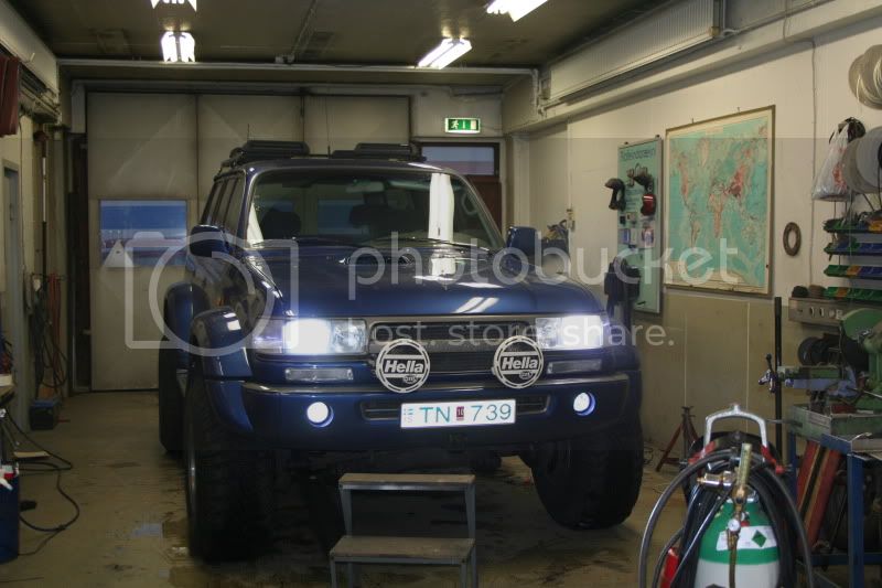

I love what you did with the front bumper. Can you go into more detail what was done here?
What did the standard bumper look like?
Cheers
The bumper was just the stock bumper as seen pic.
What I did to it was:
1. Found lights I wanted to install.
2. Found a metal pipe that fitted around the lights.
3. Drilled a hole into the bumper.
4. Welded the pipe to the bumper.
5. Had the bumper painted.
6. Installed and wired the lights.
7. Had the chrome on top of the bumper powder coated and installed.

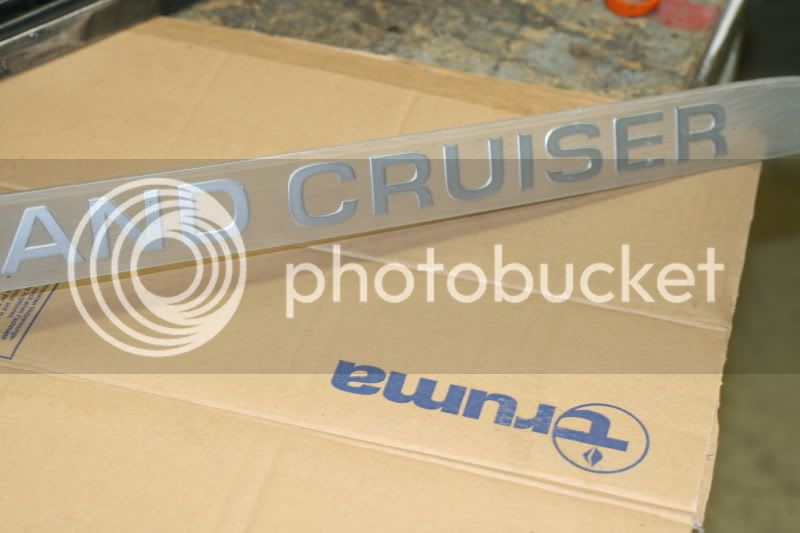

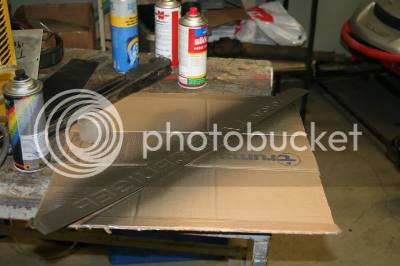

When removing the LandCruiser emblem off the gate I broke it. Then when scraping the old double side tape off I scraped through the black paint. I called the dealer and asked for the price off a new one. I almost dropped the phone when I heard the price.
Then I had a Idea. I finished scraping off the glue and then sanded off the black paint on the back side off the emblem.
Then I glued the two broken parts together with superglue.
Then primed the back side with plastic primer, painted it with the same grey color as the front grill and all the powder coated parts and clearcoat. Right now it is drying. Hopefully this turns out well and will be installed on the truck tomorrow.

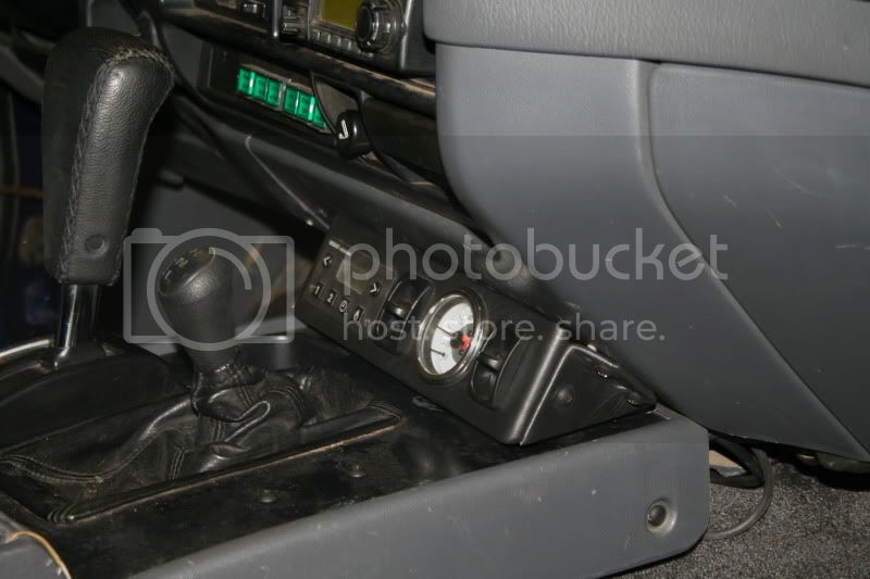

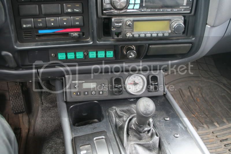

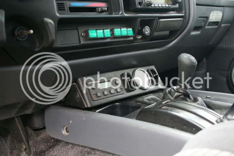

I made a new "dashboard" for the timer switch for the Webasto and air spring control knobs and meter. I´m running full time air springs in the rear.

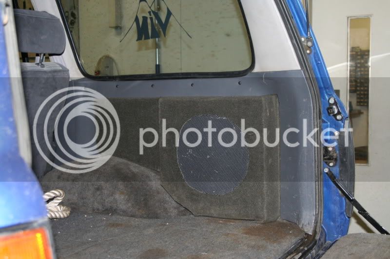

I discovered that covering the subwoofer with carpet was not a good idea. The contact glue holding the carpet to the metal cover was not doing its job. The carpet came loose and made a terrible rattle. Proofs that my sub box is WORKING!

I really like this .. can you elaborate .. ( more pics ? )
What do you want to know? I made this from aluminium plate, drilled the holes and then covered with black vinyl.
My experiment with the tailgate emblem went well. Looks a bit different from all the other 80´s out there. I like that.
thanks .. dude your craftmanship impress me ..
