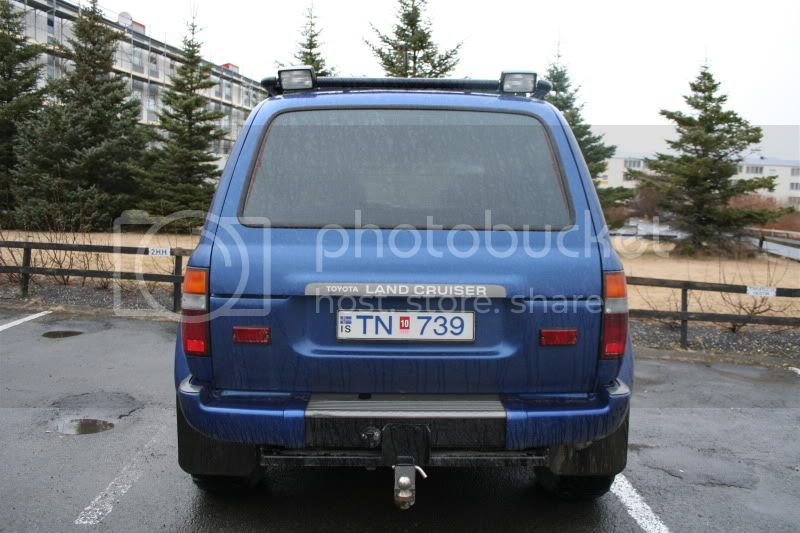

My experiment with the tailgate emblem went well. Looks a bit different from all the other 80´s out there. I like that.
Looks nice...

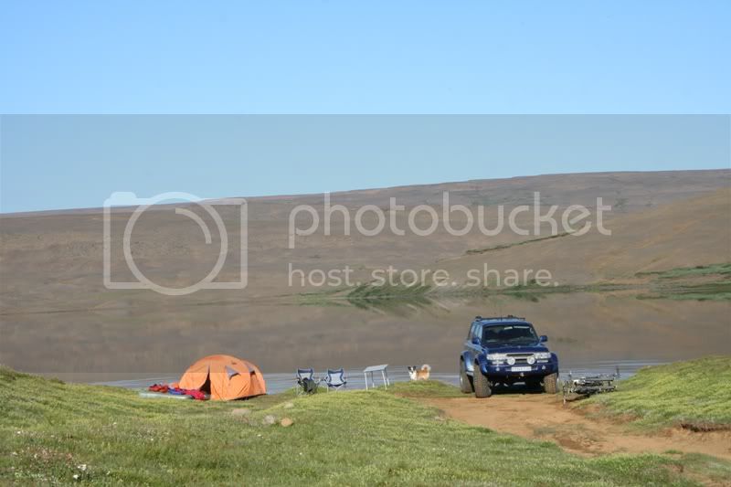

Some of my camping gear, my and my girlfriends dog, my truck and a beautiful summer morning by a beautiful lake.

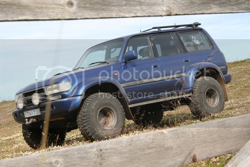

Me feeling "arty" next to a old wooden fence.

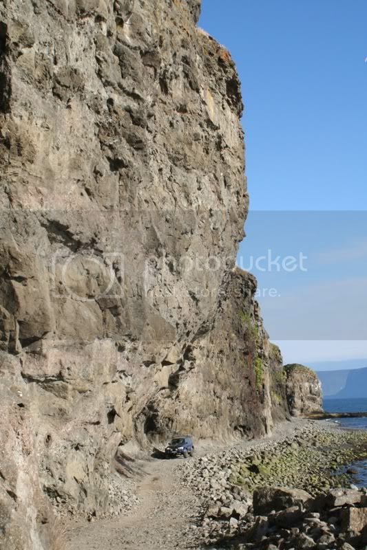

Two pics from one of the "coolest" roads in Iceland. Leads between two fjords. Goes under these high cliffs, only passable when the tide is out.

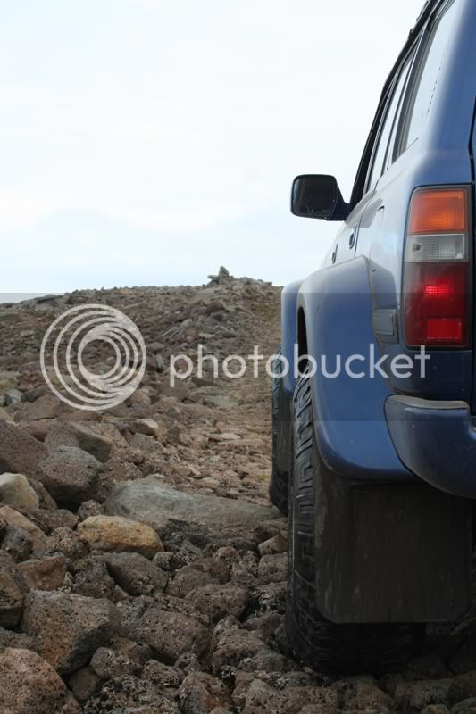

Three pics of one of the roughest roads I have driven. Leads to a glacier in the west part of Iceland.
If you look hard, you can see a tiny LandCruiser in the middle of the pic.

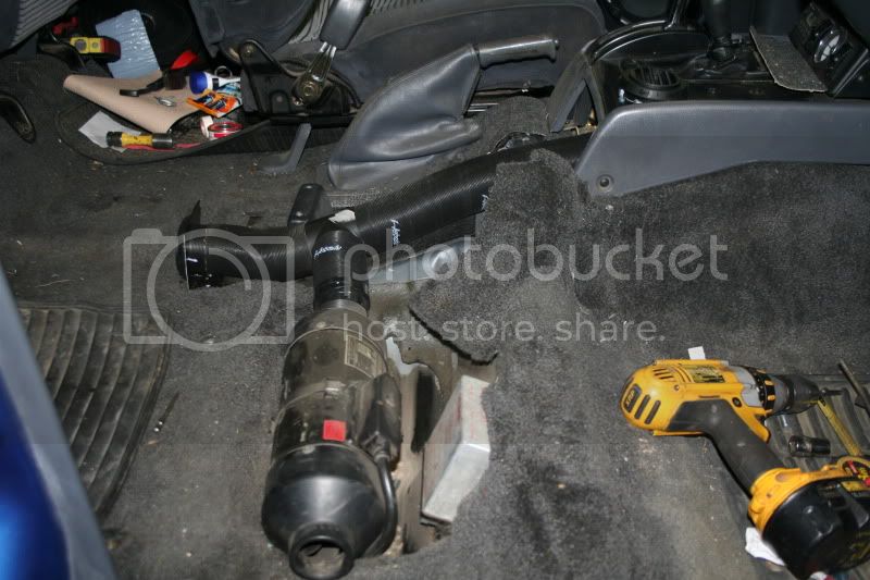

Now when the winter is coming I finally finished piping the heating vents for the Webasto heater located under the passenger seat. I installed two vents for it, one facing front and one towards the rear seats. The pipes are hidden under the center console and the passenger seat. I can close the rear vent but the one in the front is always open.

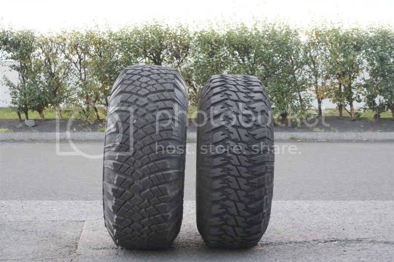

Then I had to get new winter tires, I bought a set of 38"tires designed by and made for Arctic Trucks.
Before, with my 37" GoodYears. My plan is to use these as summer tires.
When test fitting the new set. I will have to make a little more space in front of these to be able to make full turn while flexing.
New and the old tires next to each other.

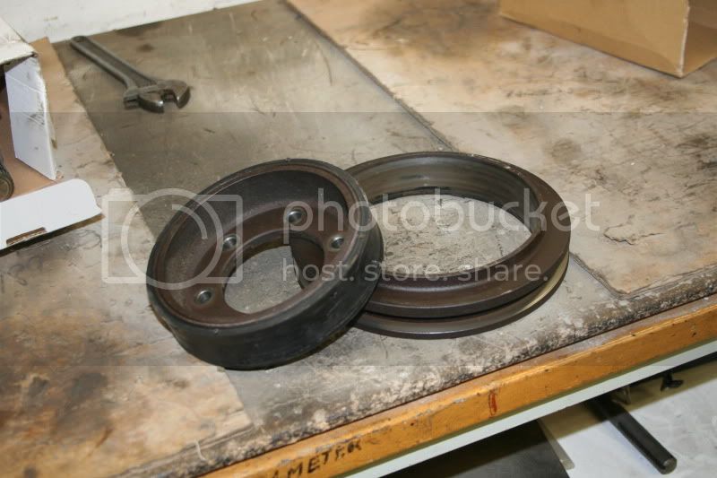

Last week I had a strange failure, I noticed a strange smell and a the transmission started to fail, the brakes also became weak. I stopped and found that I had a ATF fluid leaking from the front of the truck. At first I suspected the tranny cooler to be leaking. Then when looking better into it I found this.
This is the AC crankshaft pulley that I use to turn my York Compressor. The rubber bushing inside the pulley had failed, the pulley itself had fallen off an cut through one of the hoses to the tranny cooler causing the leak.
I have never heard of a fail like this before.

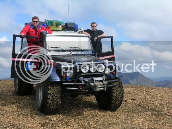

Here are pics of some of the rigs where I have installed all the aux electrical equipment.

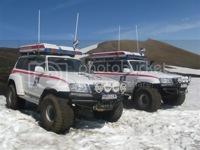

These three pics are from the same rig, both of them have all the same stuff installed. These are owned by a Search and rescue team.

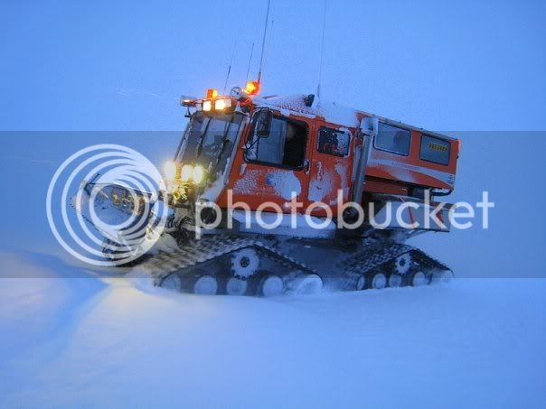

This Snow Cat is owned by the same SAR team.
This Defender was a SAR unit, it was replaced with one of the Patrols on the pic above.

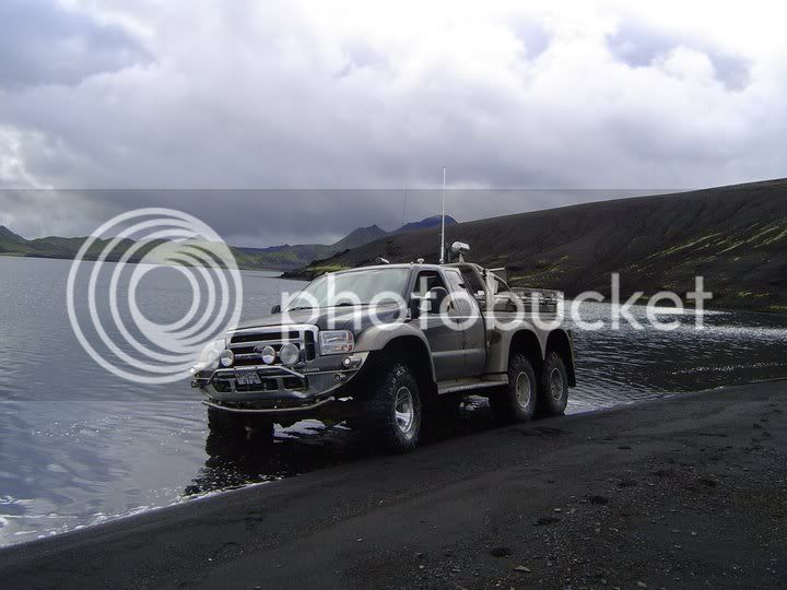

This Ford is a private rig. Probably one of the most modified truck in Iceland ;) These 41" tires are just for summer driving, in the winter time these are replaced with 6 49" beasts.
