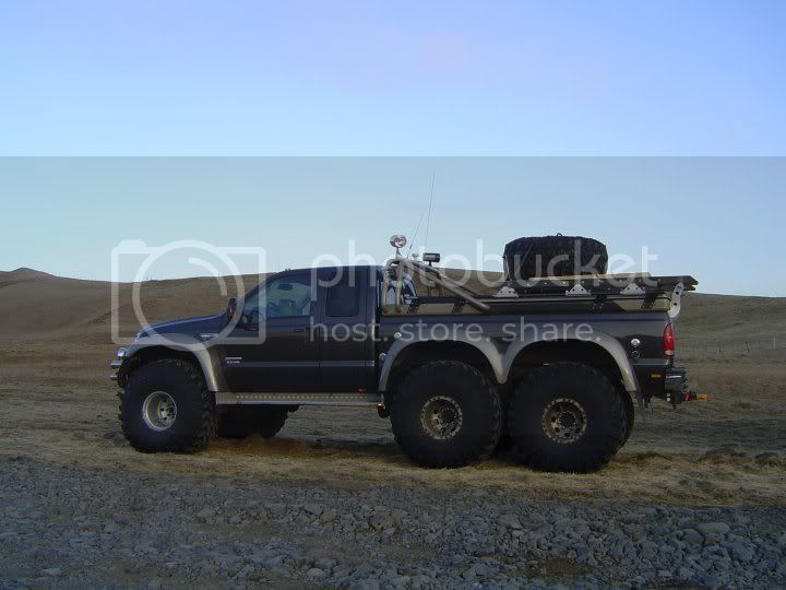

pics of the ford with the winter tires . ?
Yep, the bed is lengthened, i´m not sure how much was added though. It might be up to one meter, even a bit more.
I think it, using the original axles, the just added one extra, the original axle was moved a bit forward and then the second one was added in the back. A transfer case was added to the front rear axle to power the rear rear axle. Both the axles have air lockers.
This mod was done by company called Icecool. It is known for making a few six wheel E series Fords used in the Antartica.

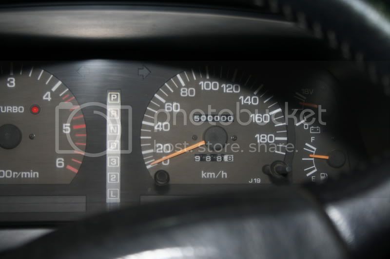

non rebuild 1HD-T .. ?
Yes I belive so, I have no records of a engine rebuild. The po did not mention anything about engine repairs. I´m sure the BEB´s were replaced around 100.000 and then I had them replaced again when I bought the rig with 380.000 on the clock just to be sure.

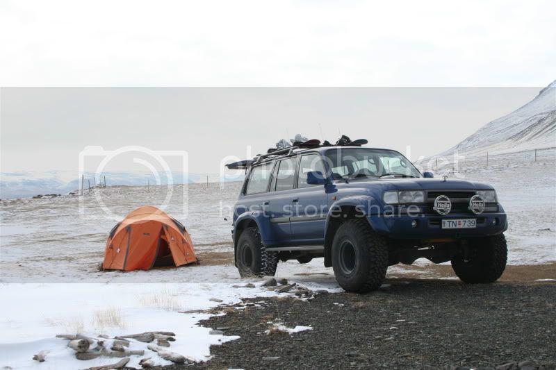

One pic from yesterday instead. Yesterday was the first day of summer according to the calender so of course I went on a camping/snowboarding trip.
