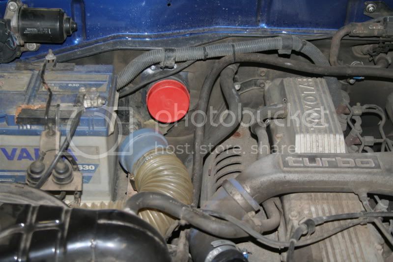

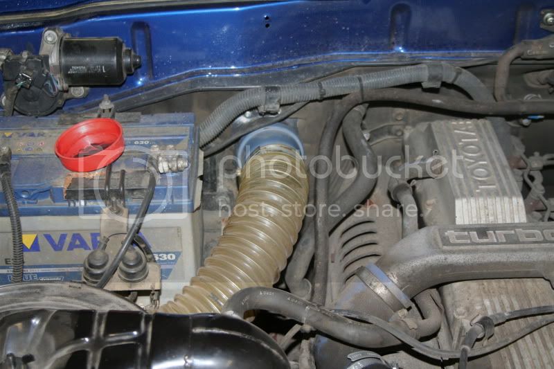

I don´t run the air intake through the cab all the time. It´s just an option to hook it up before crossing a scary river. In fact I haven´t used it.
If you look at these two pics (I think these are somewhere in the thread already) you see it both on and off.
I don´t have any old pics, but what i did before was I turned the intake on the air filter housing. So instead of sucking air from the fender behind the light the intake faced the firewall instead. I hope you understand what i´m trying to explain ;)
Regularly I have the intake as seen on the first pic. Then I belive the hood scoop delivers enough fresh air in to feed the engine even though the intake is so close to the firewall and not facing front.
When connected through the firewall you can clearly hear the sucking sound,but its really not as noisy as one could imagine. I had the same setup on a old Hilux I had, it had a 2,4l non turbo engine, that sounded much worse than the 4.2l I-hdt.
ya makes sense, I thought it might be noisy in the cab to run it all the time, but it seems to be a good idea for water crossings! :beer:

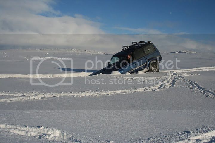

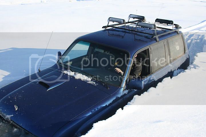

How good is that middle picture!!!!:grinpimp:
Re: the bottom one - are you stuck or just waiting for the coffeee van to come past?
No, not stuck, you can see the wet snow moving in front of the cruiser.

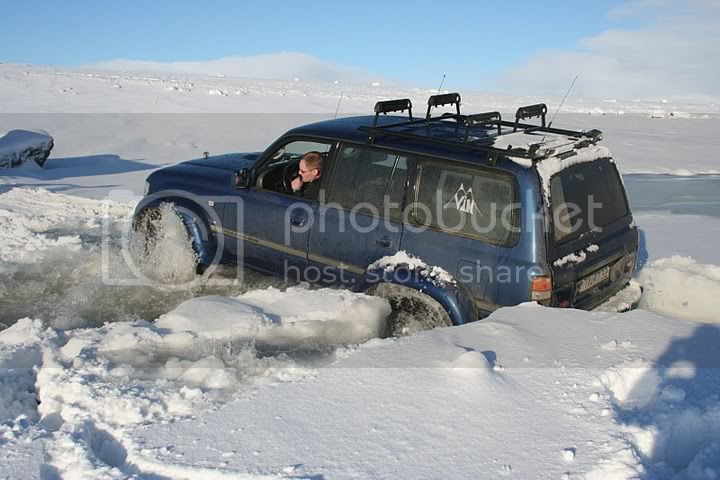

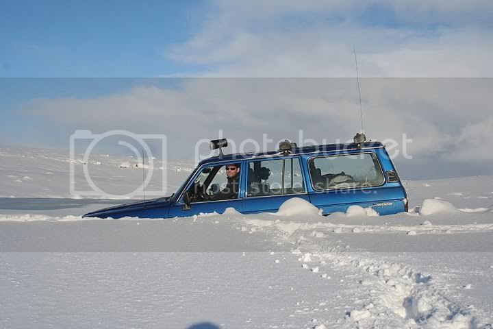

These are the next two pics from that series.
My uncle had already crossed that pit in his 60 series on 44" tires so I had his track through. He made quite a deep track.
