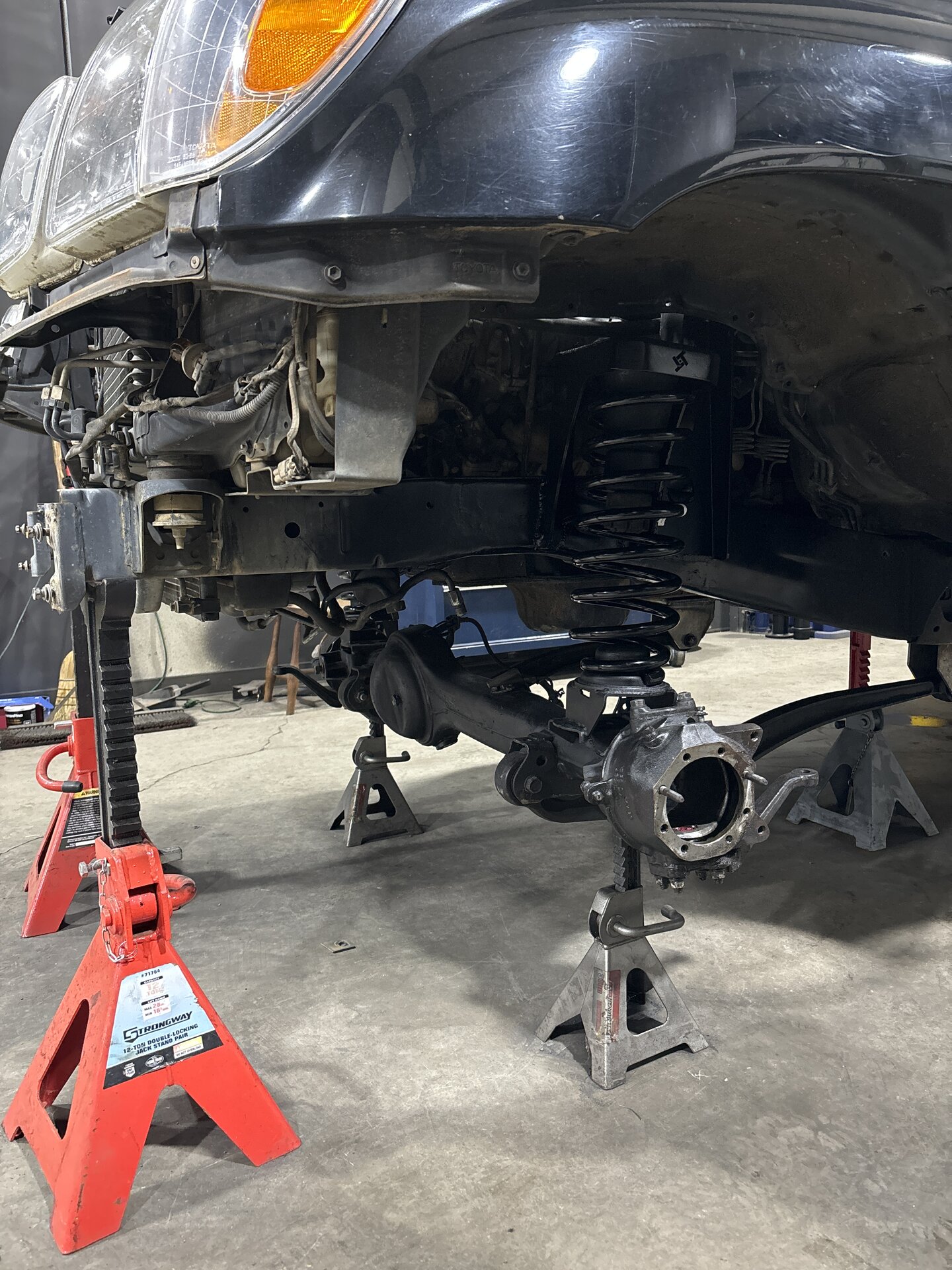

I need to get the actual suspension setup we will run installed and then we can measure and see where it’s at. Thanks for the suggestion, hadn’t thought of that yet.

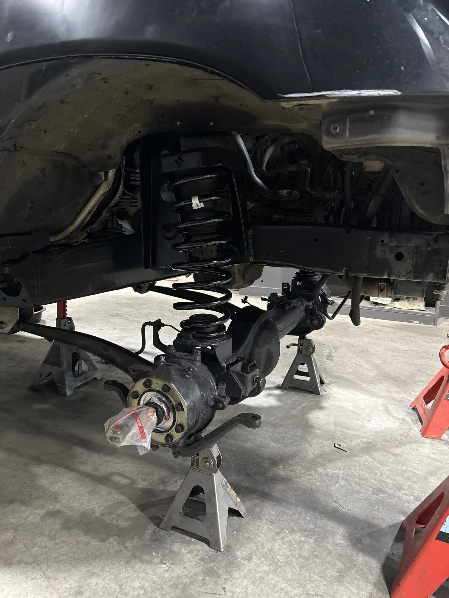

Decided against the Dobinson VT coils after recently checking the price on them. I bought a pair of Flexi springs back in 2019 and hadn’t realized they’re a small fortune now…
Anyways, I decided to run a pretty common 80 OME spring setup. 2850J front and 2863 rear with the OME L shocks. Coils showed up yesterday, shocks should be here Monday.

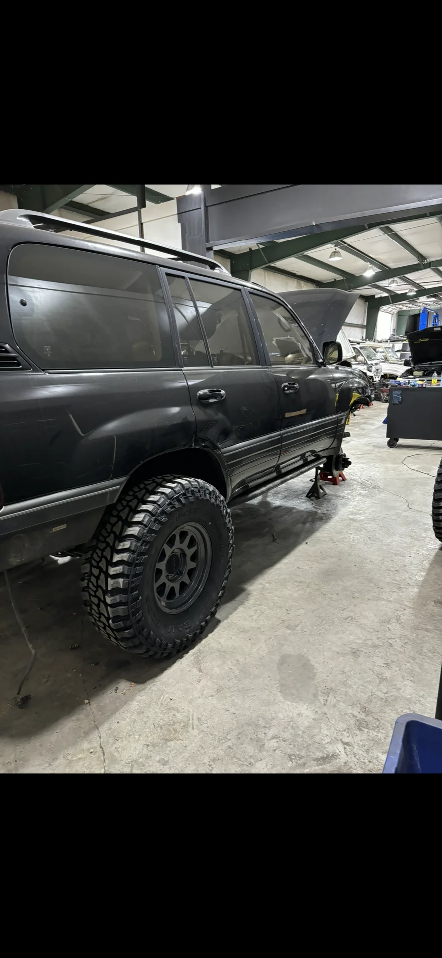

Next up, we need to tear down the 3rd’s, throw in the 4.88s, and install Eaton locker for the front diff. That way we can finish rebuilding the front axle and throw in the new 105 parts. Need to get this thing off jack stands so we can see where ride height will be.
Lots of progress this week. The guys have been putting in some solid work to get it finished up.

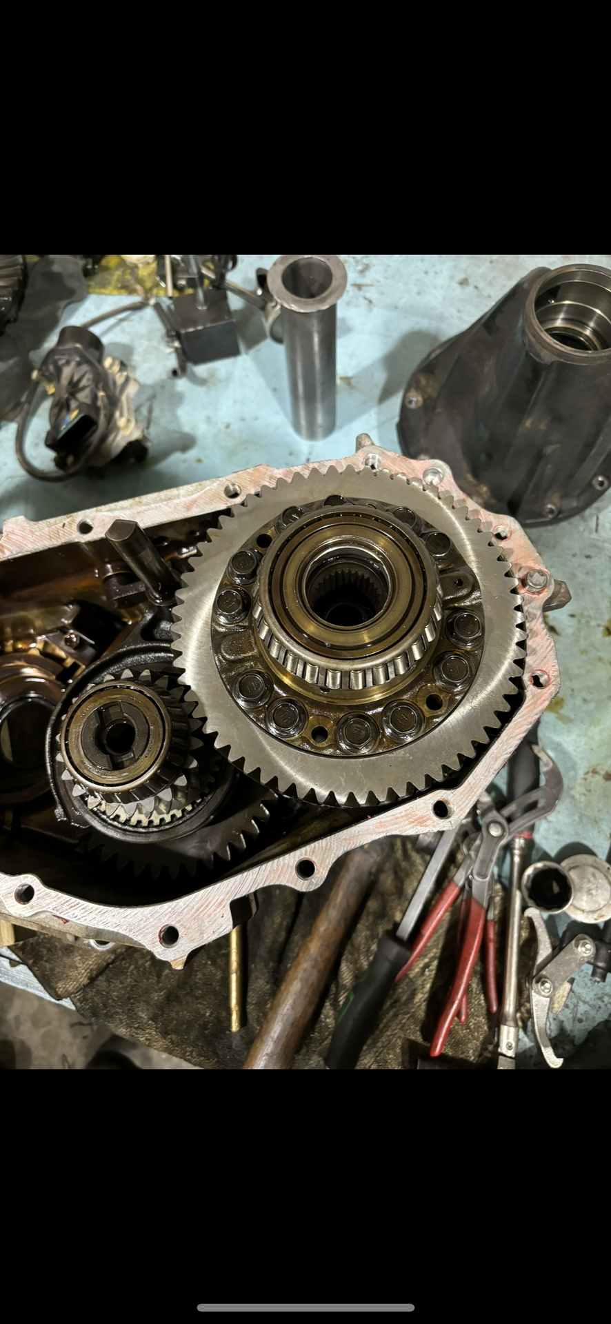

-Tcase low range gears installed

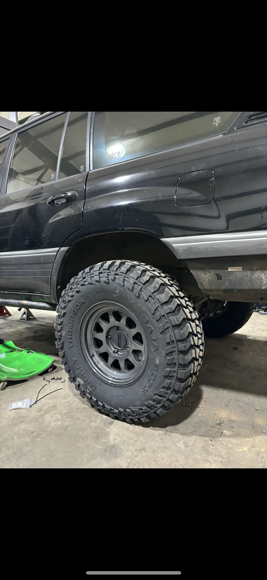

Wheels and tires ordered, should be here tomorrow. Really curious to put it on it’s own weight and see how it sits.

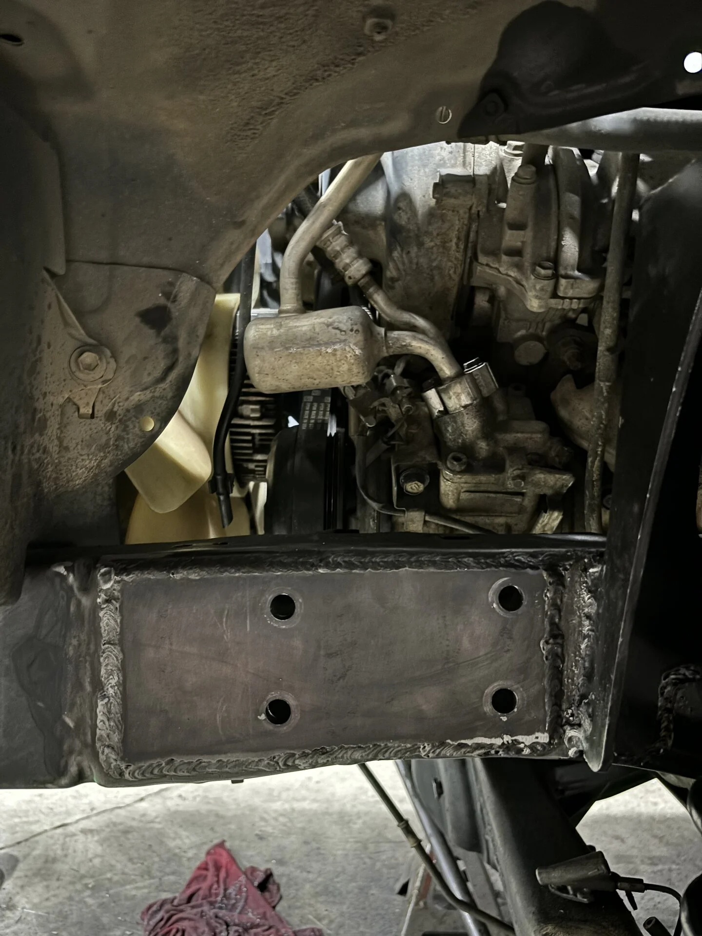

Next up is sleeve and mount steering box, already plated frame. Figure out steering & intermediate shaft, weld in Panhard bracket to frame and install Ironman adjustable panhard bar. I’m sure im missing things, but lots of pictures coming in the morning. Had to leave the shop early today.
You're moving fast! What tire/wheel set-up did you go with?
