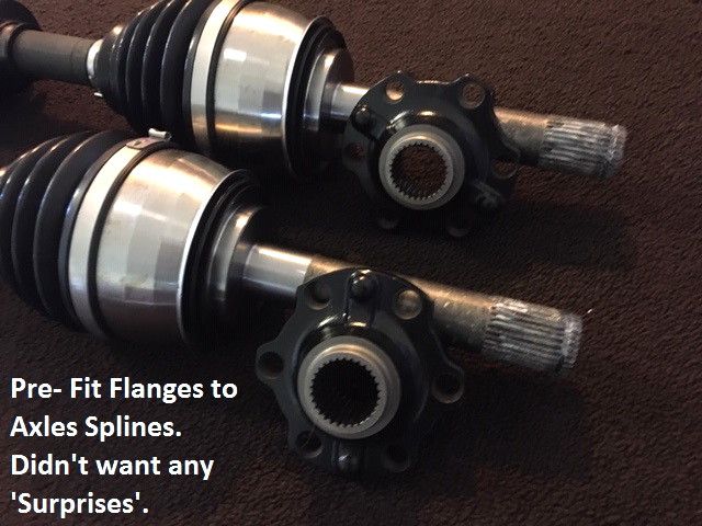

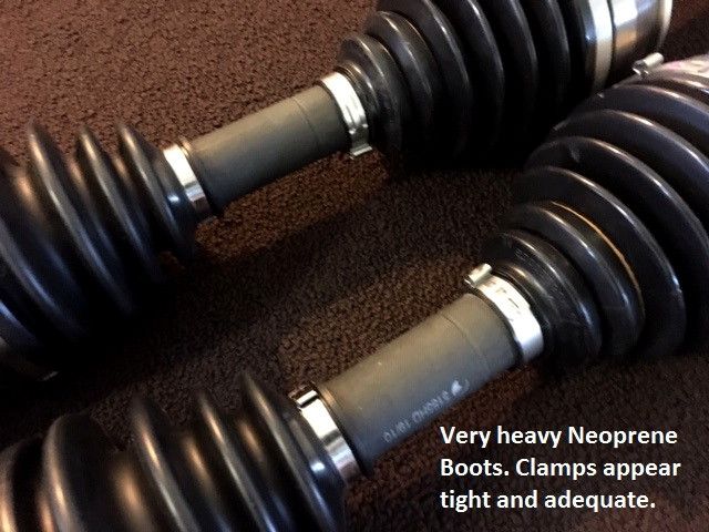

My CV driveshafts came in today and against conventional wisdom (go with OEM) I am going to be the Guinea Pig for a pair of NAPA's premium offering. I will inspect the OEM's that I take off to determine if they are worthy of rebuilding and IF so, have them serviced and keep them for the future use. In the meantime...I wanted to give these aftermarket units a fair shake.
Since the LX is my Wife's DD and rarely sees any 'off-roading' I am expecting (hoping) these will hold up for awhile. She drives 40 miles a day (round trip) and isn't particularly rough on vehicles. The CV's appear to be of decent quality and manufacture. I did notice when trial fitting the new Flanges to the splines that they are quite a tight fit. In fact...I lubed them with some white Moly grease and still had to 'tap' them into place with a brass hammer (and back off again).
You aren't going to slide these on by hand (initially). I imagine they would better fit flanges that are worn some and no doubt will loosen up with use. But, better 'tight' to begin with than loose.

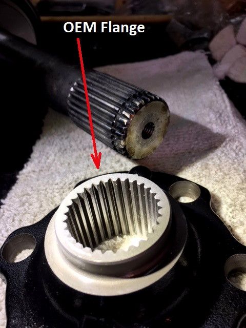

Did the new OEM hub flange have any detectable play on NAPA FDS (CV) axles splines. Either rotational or laterally?
In another car club, we purchased product and traced Cardone, Surtrack/Trackmotive, and Import Direct to the same manufacturer named Wohn industries. No NAPA parts were available for the study. Wohn appears to produce different grades of CV axles depending on the purchaser.
Absolutely none. In fact...if anything its too tight. I suppose they are designed to fit snugly in 'worn' flanges, because in new flanges I am going to have to 'tap' them home slightly upon installation. As they sit ( even having tapped the flanges on and off twice) I would not be able to fully seat them by hand.

I'll have to look at it more closely and see 'why' it is such a tight fit. IF the O.D. of the splines is slightly larger than the flange receiving it...then a very light sanding with crocus cloth about the circumference might free it up. But IF the binding is due to a disparity in the spacing of the splines (Axle vs. Flange) there isn't anything I can do about that except wait (and hope) for them to 'pattern' themselves. It might well be that the axles fit my existing flanges better anyway. Won't know until I tear into it all.
Make sure to see if fit is just as tight or not, with hub flange pushed on until face is lined up at back of snap ring groove on axle and no further.
Will do. Going to check the fit (off vehicle) today.

OK, dry fitted both Hub Flanges to both CV Axles today. They still remain fairly tight. Got a little better after hitting them with some Crocus Cloth and running the Flanges on and off the splines a few times...but definitely not going to go on by hand.
I marked the splines with Prussian Blue and tapped the flanges onto the Shafts. Found a couple of places where a spline was just a bit high, but I believe there is just enough difference in the Flange and Axle Spline profiles to cause them to be tight. It's not like I have to 'hammer' on them...but I DO have to 'tap' on them with a brass punch.
The Flanges on my vehicle now...might slip right on them, don't know yet. But the new flanges definitely will not.
