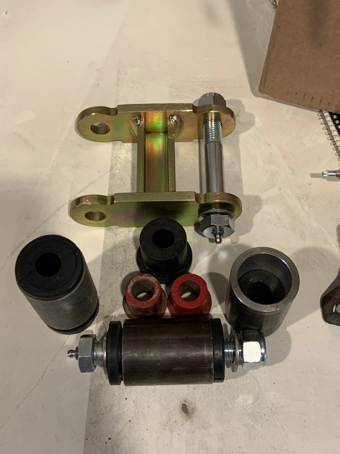

The difference in bushing size is my favorite part. The 75 series rear bushings (front also?) have an 18mm ID and a 45mm OD, which is significantly larger than the 55’s.
I this pic the 55 bushings are red.
Be careful with the larger OD bushings and the extra load from the arched springs, they will allow for more side load movement that could be a good thing off road in the rocks but not a good thing when you hit railroad tracks at speed and get the death wobble.
This was not a fun lesson for me to learn.
FYI the bushings that tried to kill me are the exact bushings in your picture, I replaced the thick bushings with these thinner bushings and my issue went away. These have the same OD with a thicker inner bushing giving the rubber a thinner cross section.
But you still keep the 55 size bushings for the frame mounts, eh?
There is nothing fun about the death wobble...
