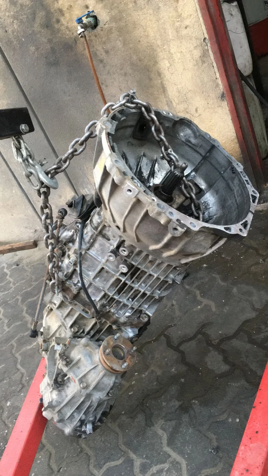

I put the OEM Toyota clutch in my FZJ75 a few months aga when I had to send the transmission to Georg for repair. No complaints. I did it as a PM given the pain to remove the transmission so since it was out.... Make your decision and acquire your parts but I wouldn't install a new clutch until I needed one unless I had other reason to go into that area.

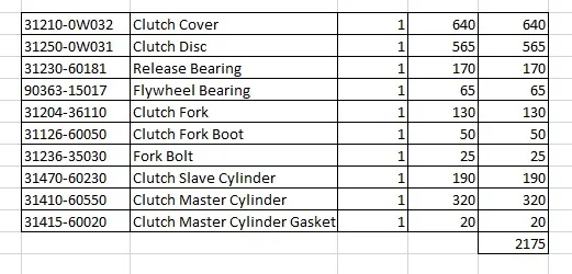

This is the list of parts I got for the Holy Truck. It is an 80--I'm just illustrating.
That is in AED, not USD, BTW.

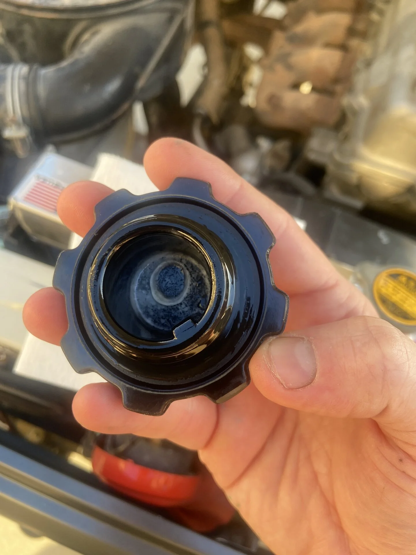

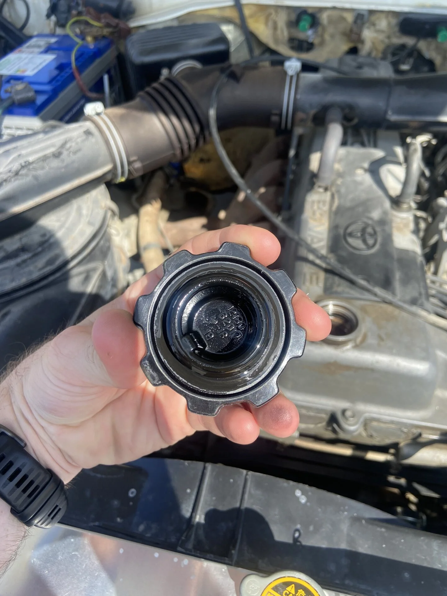

Also good news, don't believe I have a head gasket or oil cooler leak. Just wasn't putting the engine through its paces thoroughly. Running at 70mph for 20 minutes and all the white gunk on my oil cap is gone.
i figured it was just condensation not being burned off, good that you have confirmation.
Agree, thanks for being a voice of reason when I first found this! This was the first time I'd taken it on the highway for any duration really, so great to see this.
