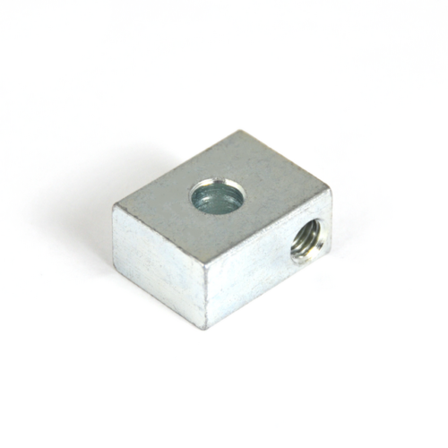

Seems I'm missing the "alternator adjusting bolt". Does anyone know this part number? Cannot find it listed on part souq.
New radiator installed. Need a cap and a couple worm clamps now before she's sealed.
Now to finish the heater core to get her started up.
Looks like it's this part#
Adjust Bar Bolt - Toyota (90119-08493)​
Funny, I just went through that search last week while replacing the belts on my '94 FZJ75 pickup. It initially appeared to me from the ToyoDIY parts diagrams that it wasn't OEM on these general country models. Having said that, I took a chance that it was the same as my '97 80 series and ordered the same part number that you quoted above. FWIW I tightened my AC belt first and then borrowed the adjusting bolt from that idler pulley after locking it down to tighten the alternator belt.
I later did find the part and that is the correct number. It is on the "Radiator & Water Outlet" diagram and not on the Alternator diagram.
You good Sir are a saint. I also ordered the new bolt, but will do this workaround for now.
Tried your technique. Unfortunately the adjusting bolt used to be there. Don't see this full part number on the partsouq diagram.
Yes I was stumped by that assembly on the parts diagrams. I can't find it anywhere. Fortunately mine for the AC belt was complete. And oddly enough, the "block" shown above appears to be the same as the one for the Alternator but on my diagrams it says "not applicable". However, it does show it and it also gives parts numbers for the fastening bolt and the adjusting bolt. Very odd.
Found the part on ebay searching for the adjusting bolt.
