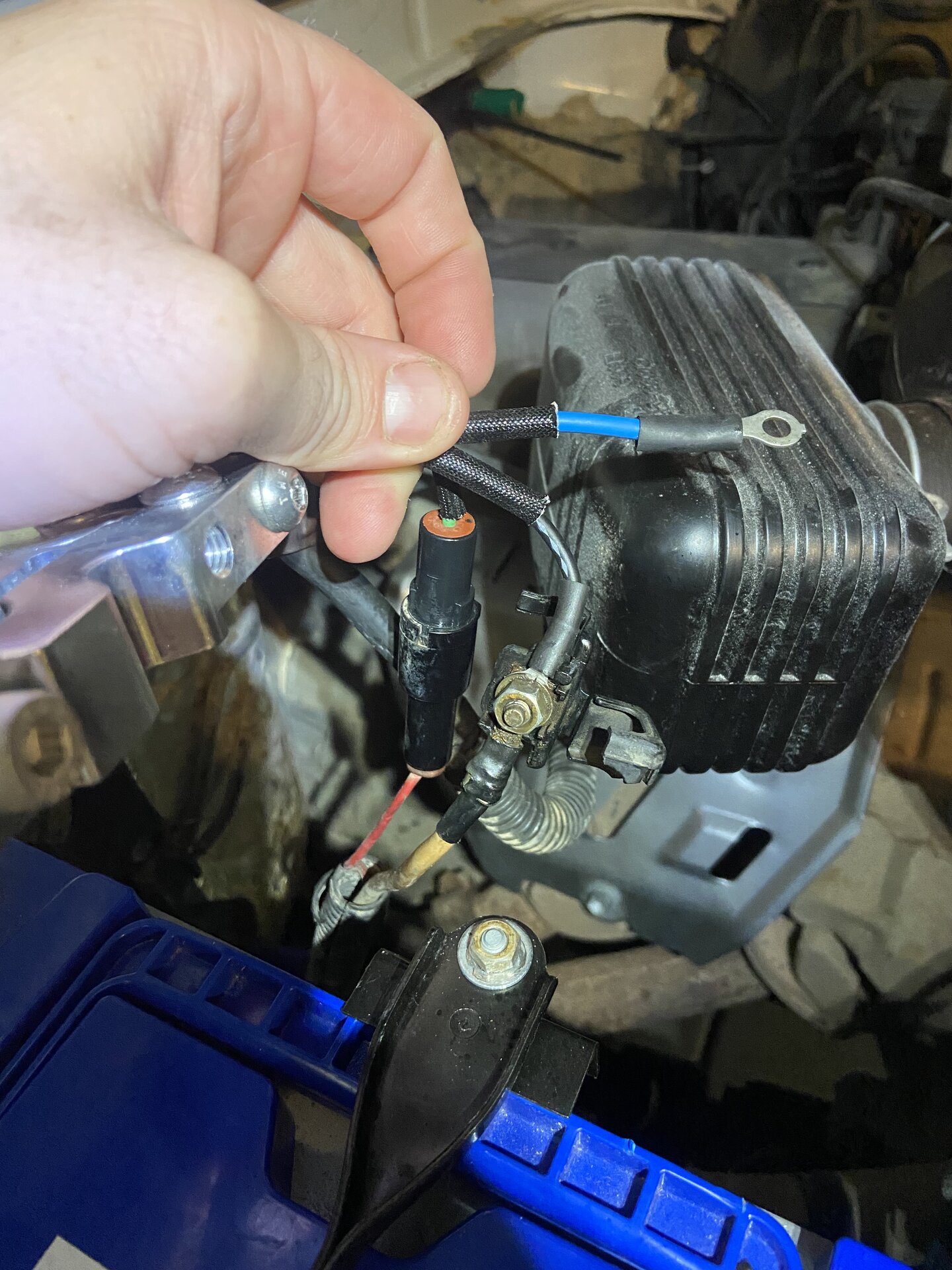

Replacing my battery terminals as mine were fubar. My fusible link was old so I replaced it, but I've only got 1 terminal post in the junction. Where do I connect the second fusible link ring terminal?
All positive can go on the same terminal or appropriately rated busbar if you prefer not to have everything on the battery terminal.
Edit - if you’re speaking of the fusible link, the 1HZ has two. Not sure about the 1FZ.
so stack both the leads coming off the fusible link to that single post I have in the junction box?
I have the 1FZ. The part number for my junction from partsouq only has 1 terminal. Toyota 82670-90K00
I've got the larger of the ring terminals on this junction terminal. The other isn't connected to anything. Starts right up just fine. I'm sure I'm screwing something up though.
edit: Per partsouq: The FZJ75 fusible link, 82627-60070 only has one lead coming off of it, pic attached.
So that would be the correct fusible link for your application… and the number of connections would add up, yes?
Yes, it would. But that link is NLA from everywhere I've looked.
Edit: guess I didn't look hard enough. In stock at megazip.
Hello,
This part is long discontinued. Ask me how I know.
Two options:
  1. Use the 1HZ fusible link. You have one lead free for future applications.
  2. Toyotamatt / @ToyotaMatt makes replacement fusible links for the 1FZ engine. Order one from him.
Juan
