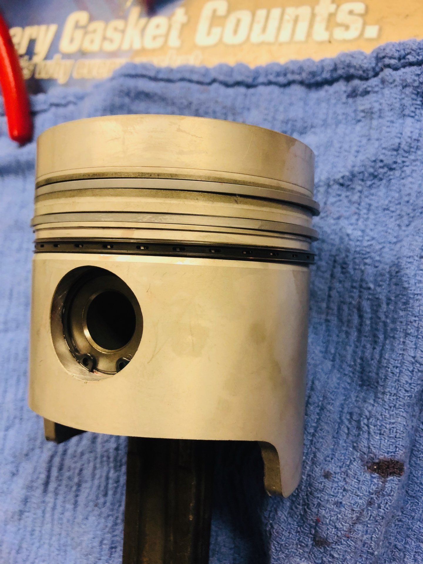

Inspected 300k mile pistons. Found gouging I a couple. Particularly on ring gland area close to piston face.

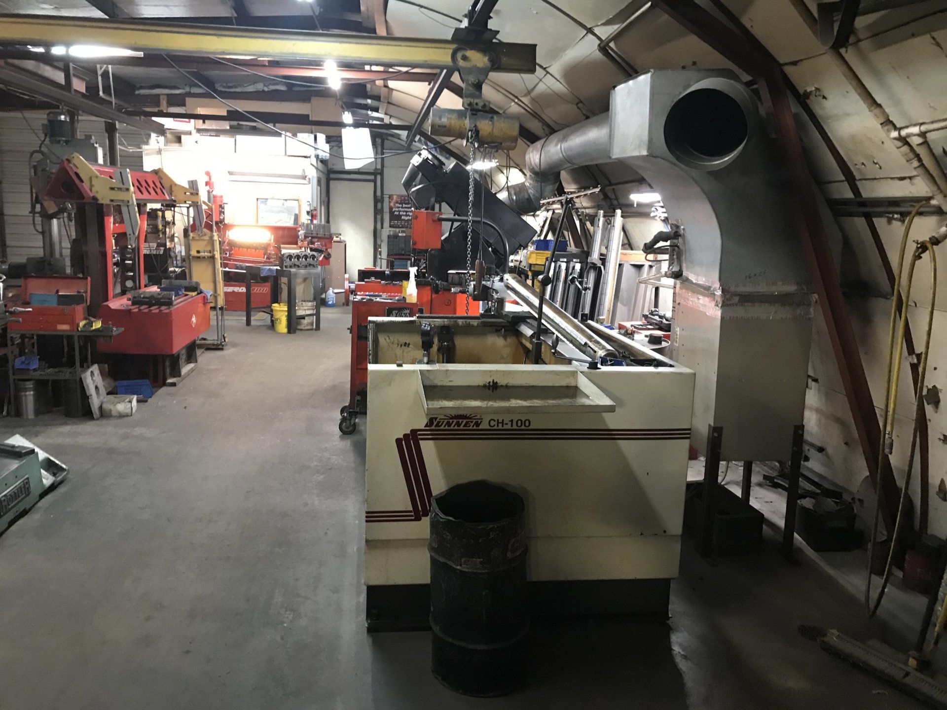

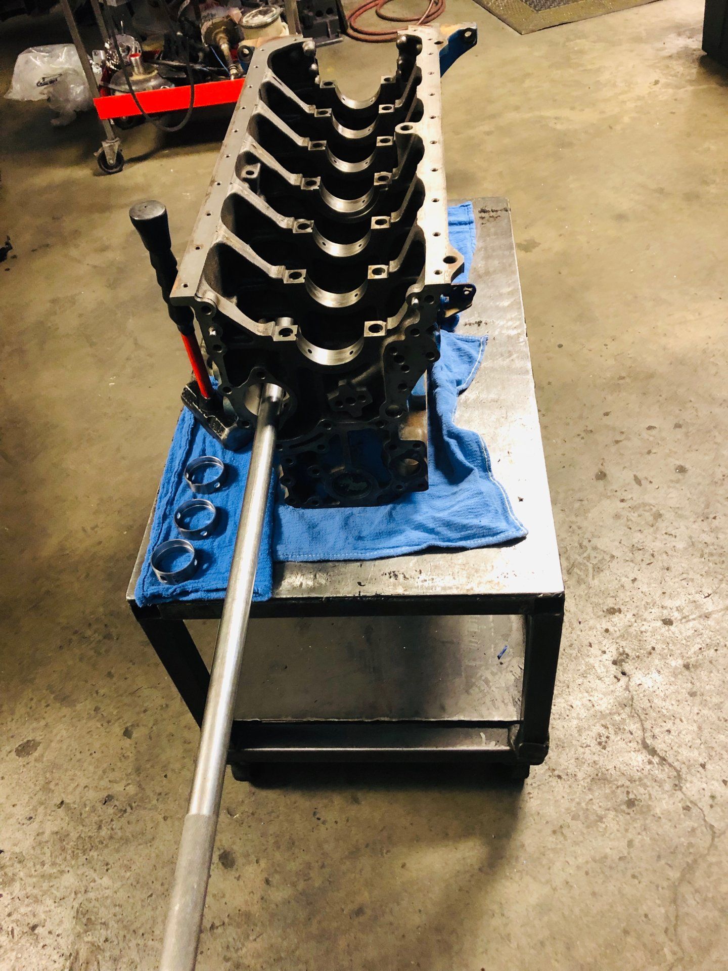

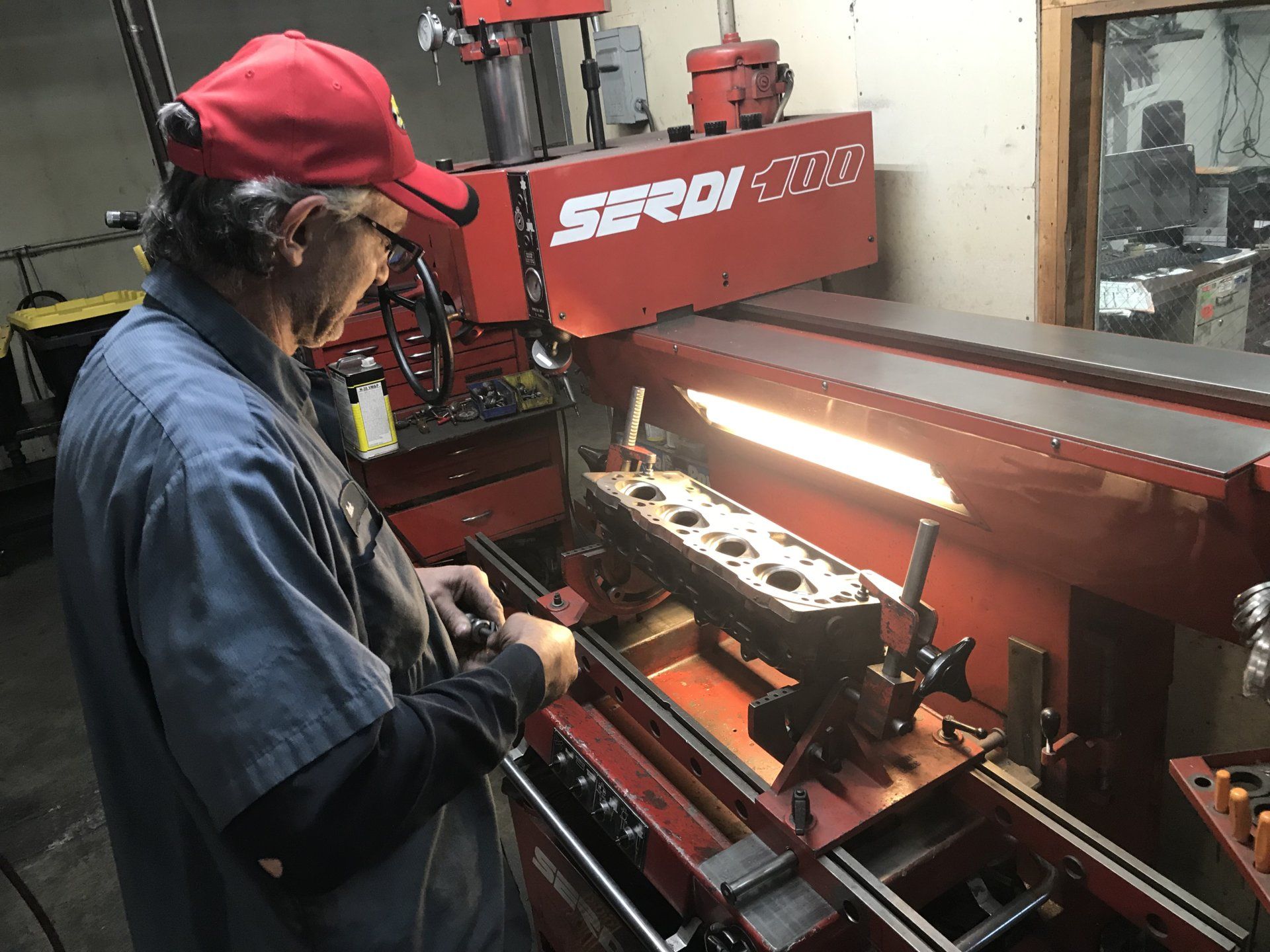

On our way upto pick up a FJ45 in Tucson, we happen to pass through Amarillo and had @Yackster get the new Taio cam bearings knocked in. Zack has a great machine shop where rebuilds Diesel engines and race engines. While there he also honed the block and place the new Alfin Pistons on the conrods. On our way back we picked it up from @yacksters place. I highly recommend this place for engine work. First class. Look up him up if you need good work done.
A few more pics of Zack’s work!

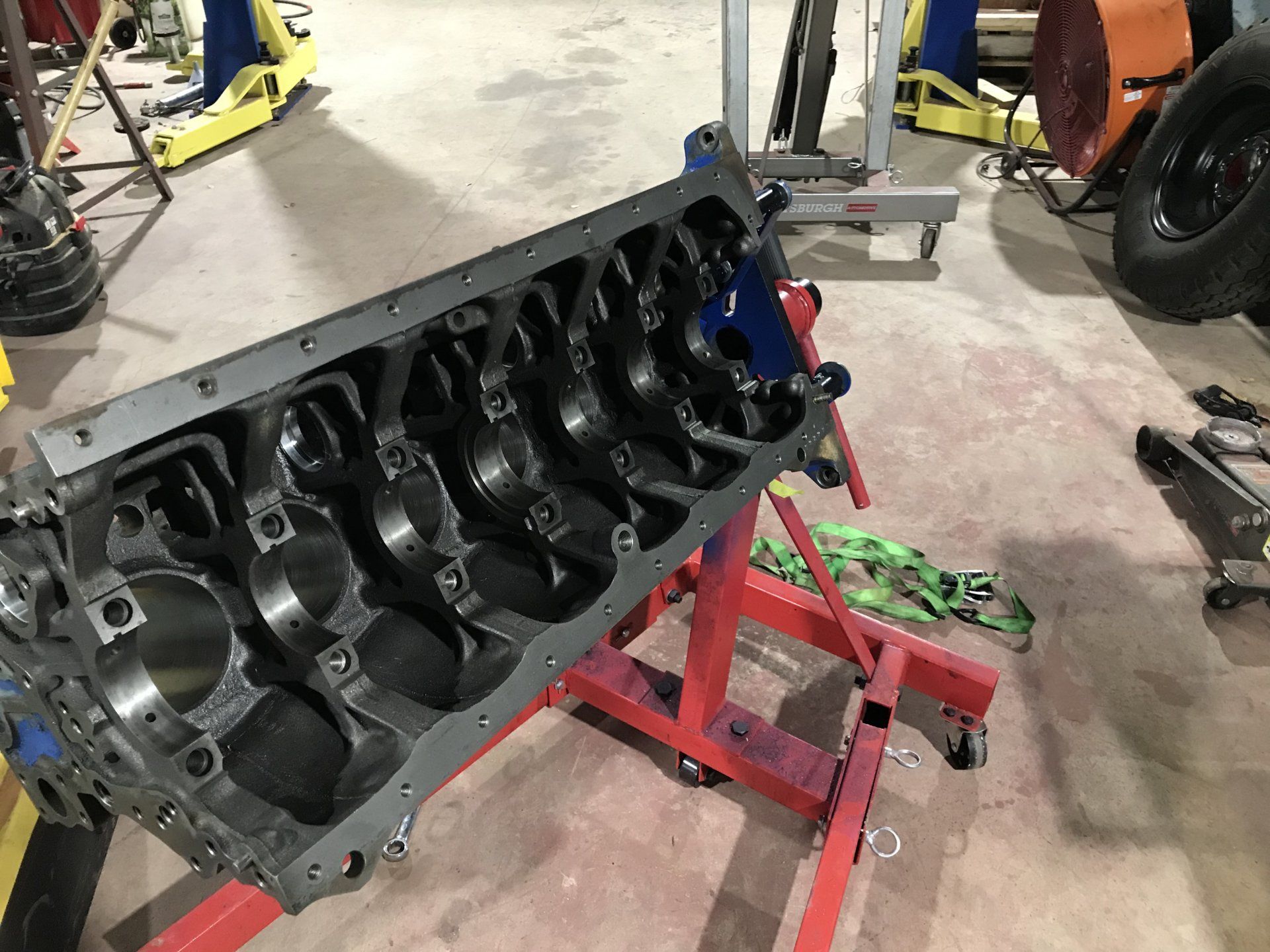

Over thanksgiving @Cowboy45 got the block back on the stand for re-assembly to begin. He also taped the rebuilt cylinder head to get it ready for paint. Taping the head for paint was death by a thousand razor cuts for @Cowboy45. The details take time. He is determined to get it done right. He is doing a great job. I forget at times he is only 14 years old!!!

Looks like it's going to be a nice engine. A clean machine shop with fast turnaround time that also know what they're doing is a rarity. It's the main reason I avoid recommending engine rebuilds these days.
Make sure to take care to really blow out oil passages in the block and head with good pressurized air and cleaner before assembly. @Cowboy45

@Yackster turned engine machining and all in a day or less. Really awesome. @Cowboy45 and @SipLife both mentioned working under @Yackster for a couple of weeks in the summer.
