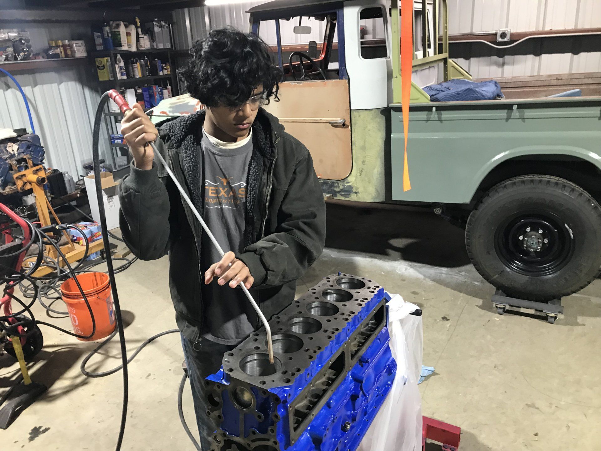

This past we got a lot done at the barn! Since the Alfin Pistons just got back from @Yackster’s place we now can start putting the engine back together!

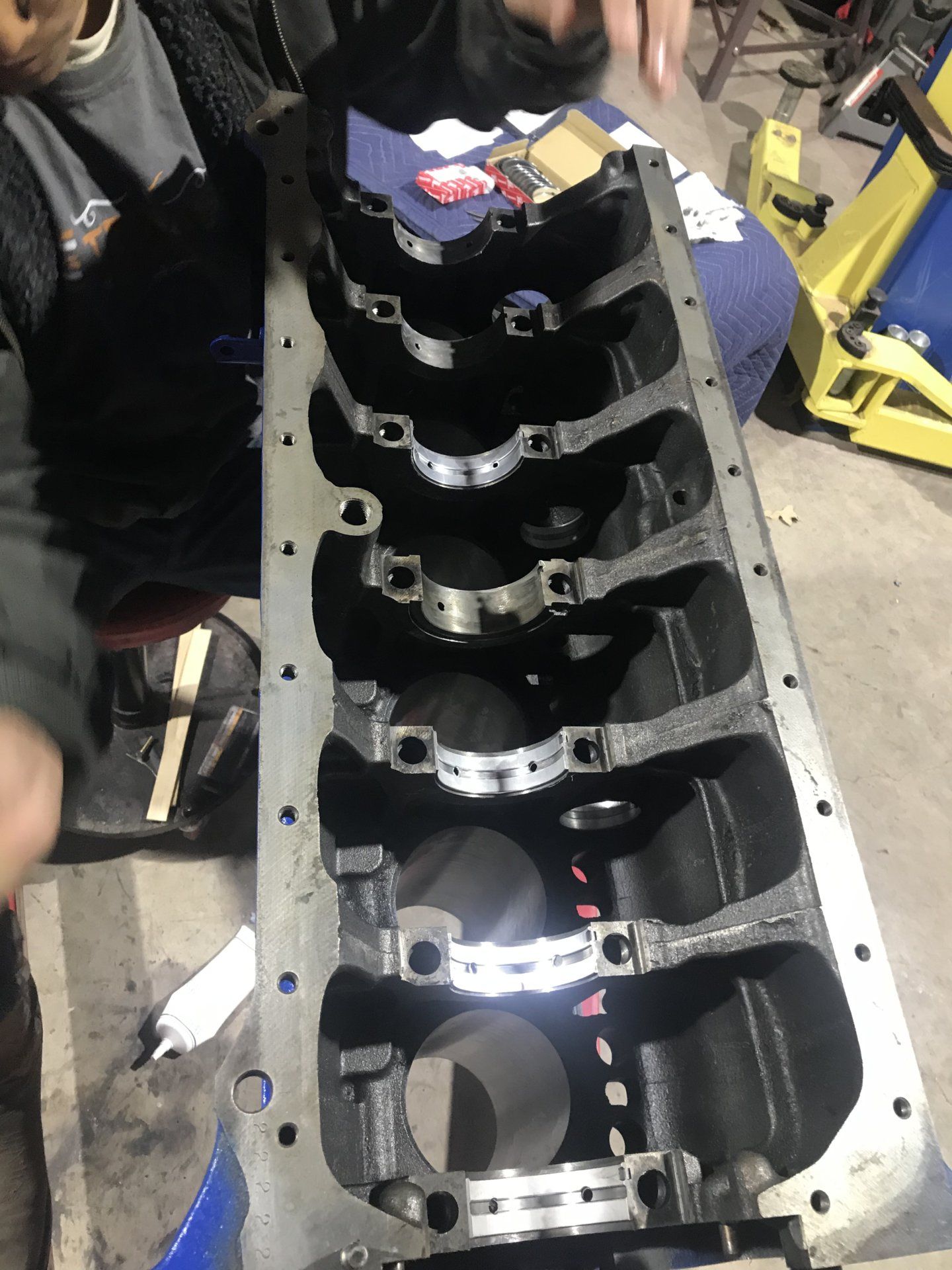

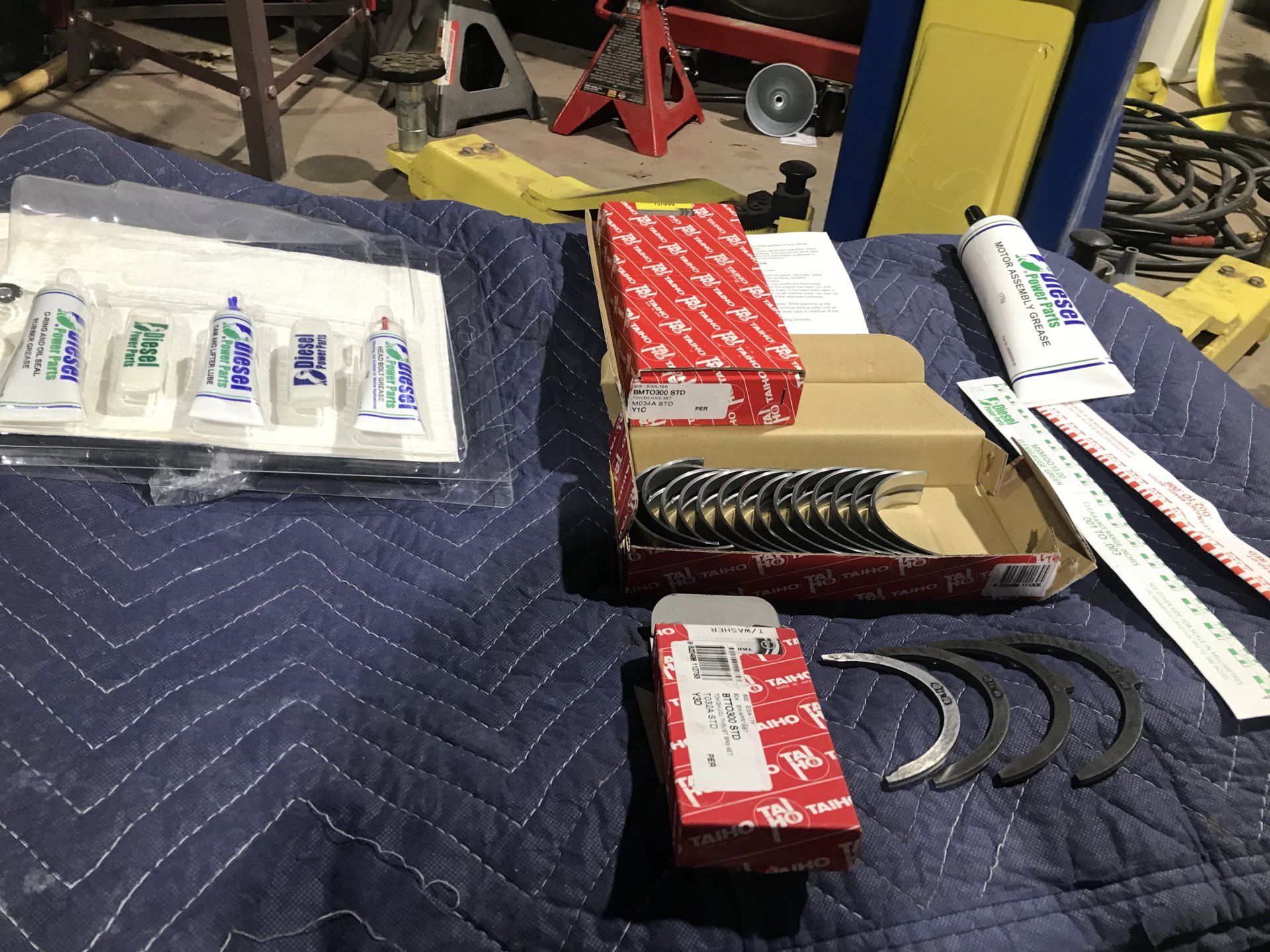

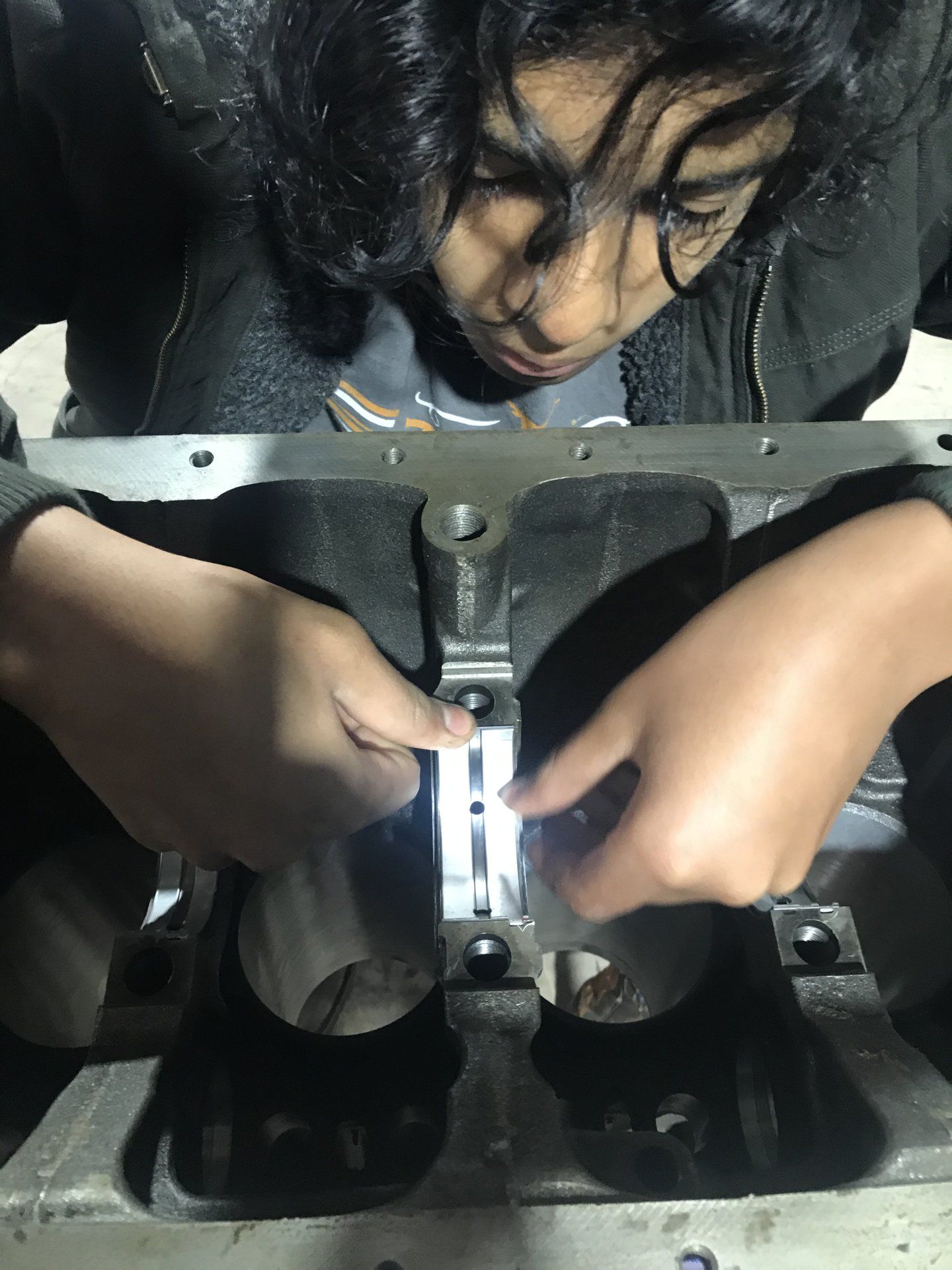

First thing was to blow out all oil and coolent holes make sure everything was free of any dust or dirt. Then we started by cleaning the Crank bearing races from any old oil or grease, then with some brand new engine assembly grease we installed the new bearings. Our block is stamped with all 2’s which I believe is bearing size, but when we told our Australian contact he sent us a box of bearings with just standard so we are hoping they are two’s and not 1’s or 3’s. (Will include pictures below!)

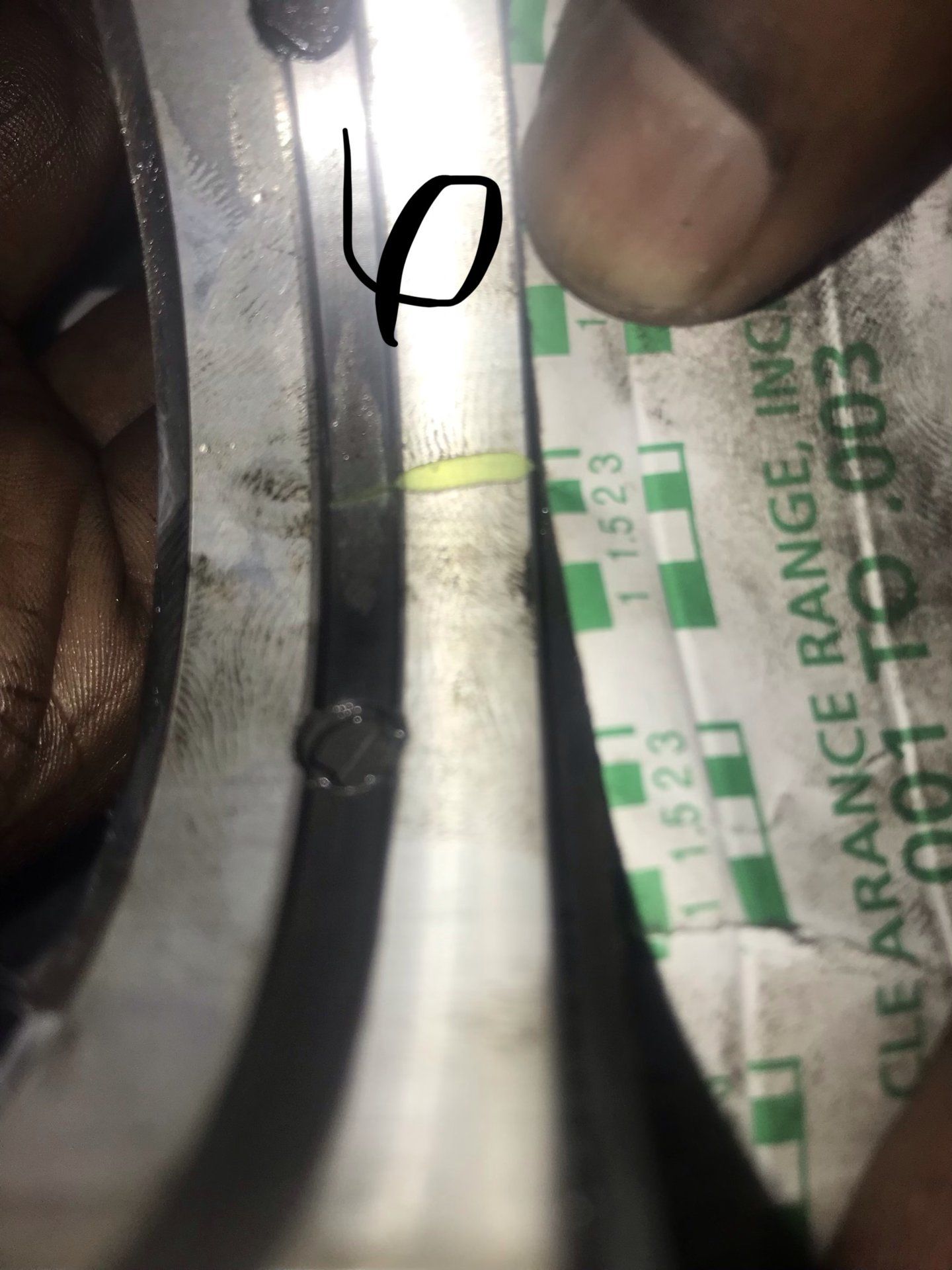

After the Crank seemed to be turning well we removed the bearing caps and laid a piece of plastigauge on each bearing! After we torqued the bolts to exactly 100 ft lbs we checked the oil clearance and everything seemed to be in the .0013 and .0027 range!

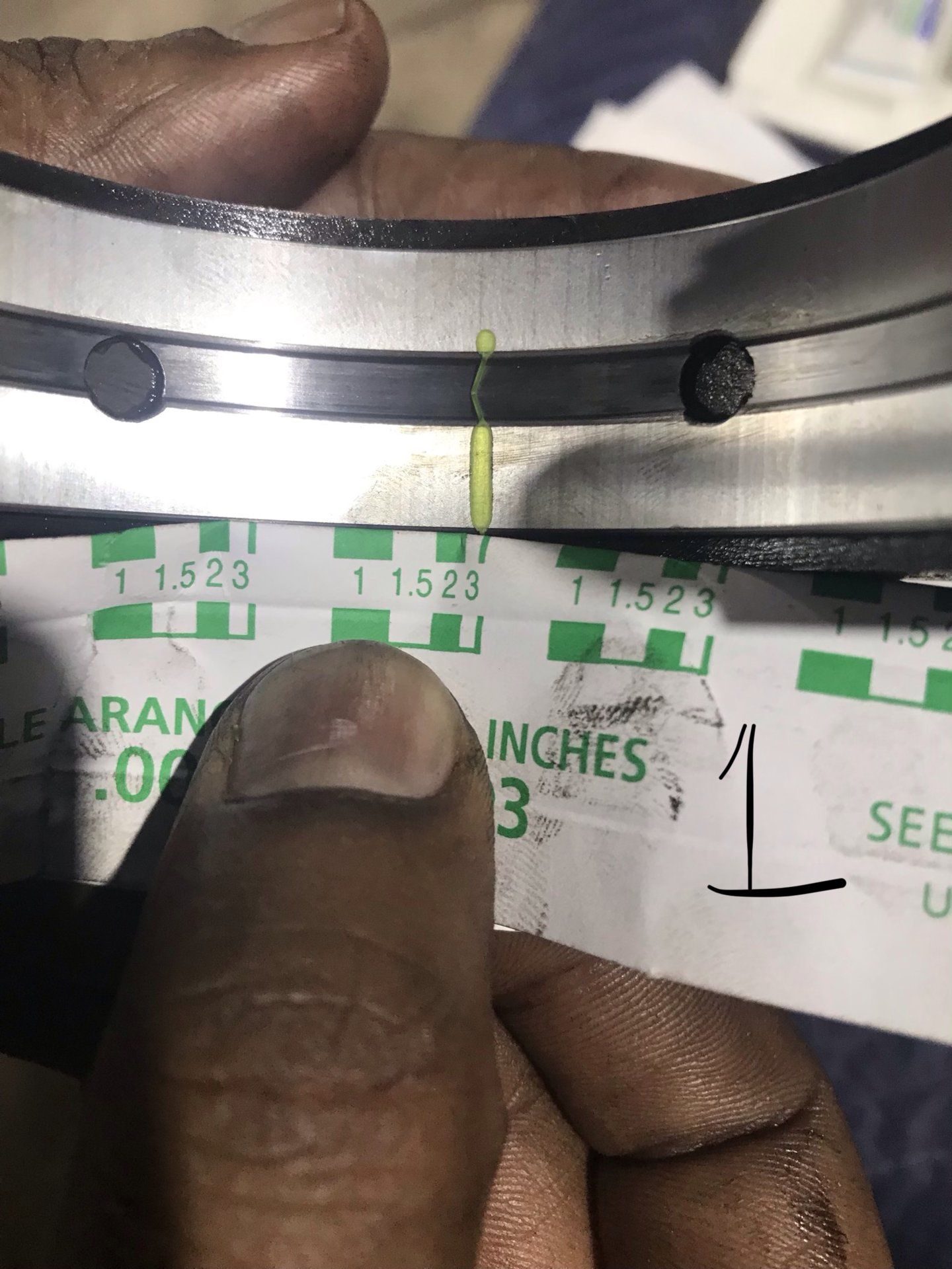

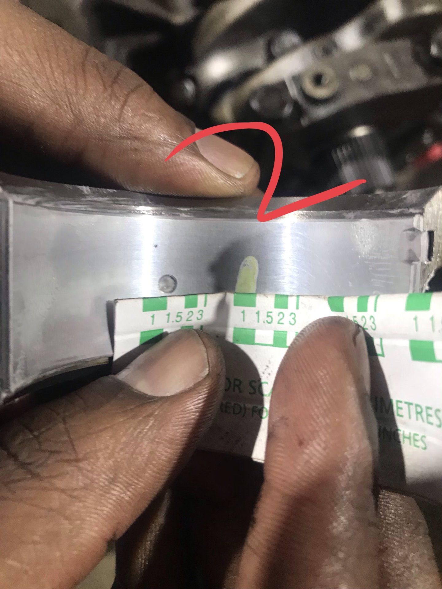

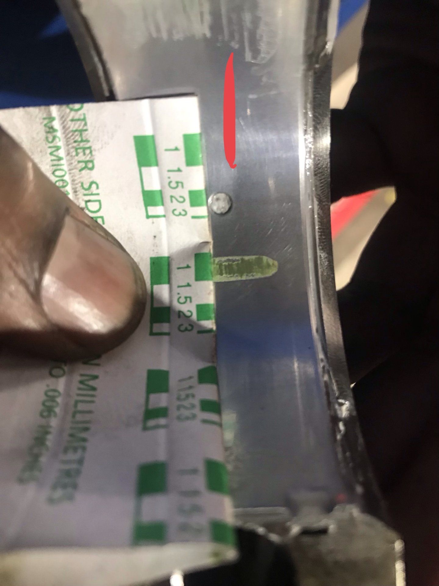

Each Con rod was then first hand tightened so they were able to freely turn with the Crankshaft! Then each was turned to top dead center where we laid a piece of plastigauge and torqued down to 65ft lbs! Once removed all were well within specifications for oil clearance (.0012 - .0028)
