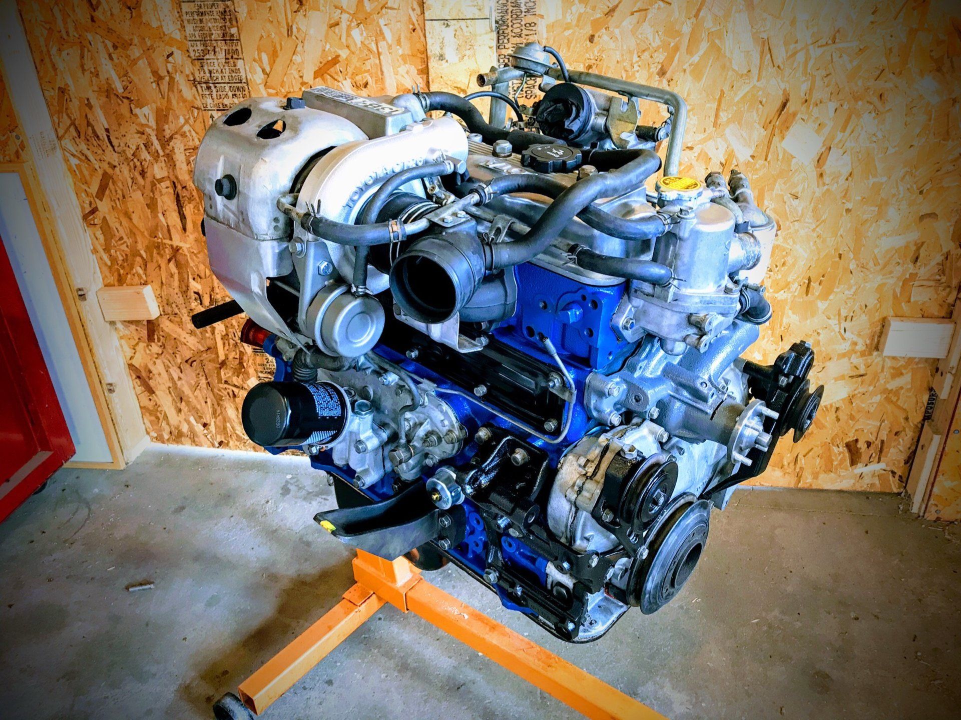

Ford blue is what I used. I believe it was VHT. In retrospect I should have used the darker for the 13BT block, but I just didn’t want it to error on the more purple side.

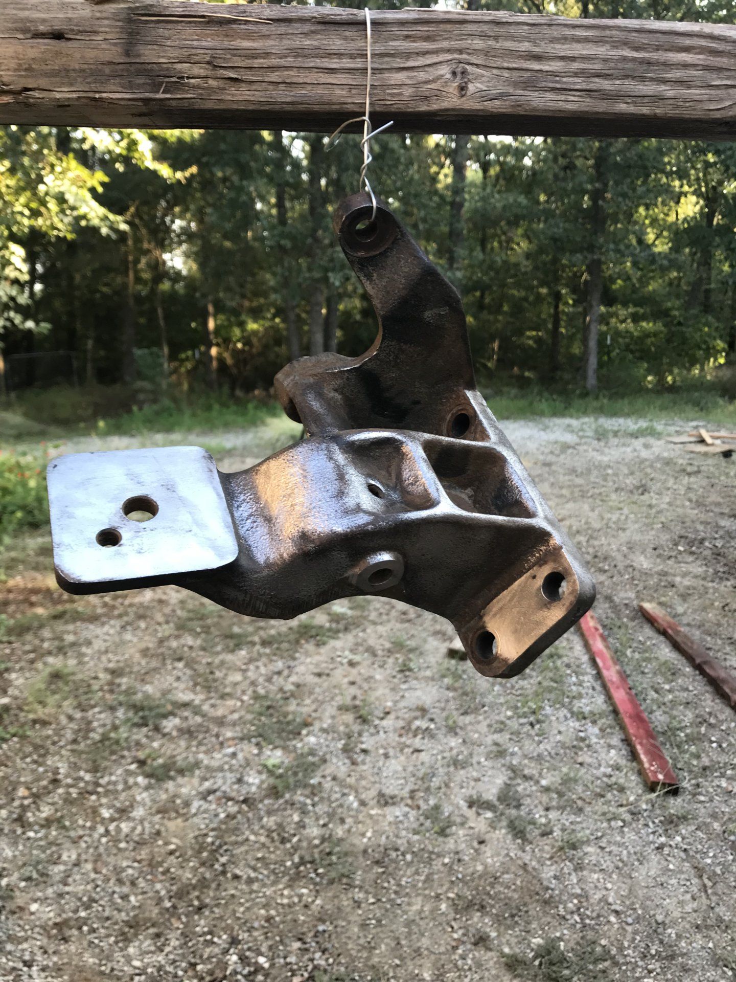

I cleaned al the parts last weekend before paint. I used some gasoline and a metal bristle brush to loosen up all the gunk. Then, soap, water, and a dish brush to get the big chunks off and clear most of the grease to where there is only a light coating. Lastly, I used lacquer thinner and some shop towels to dab at the grease and wipe it off and let it evaporate.

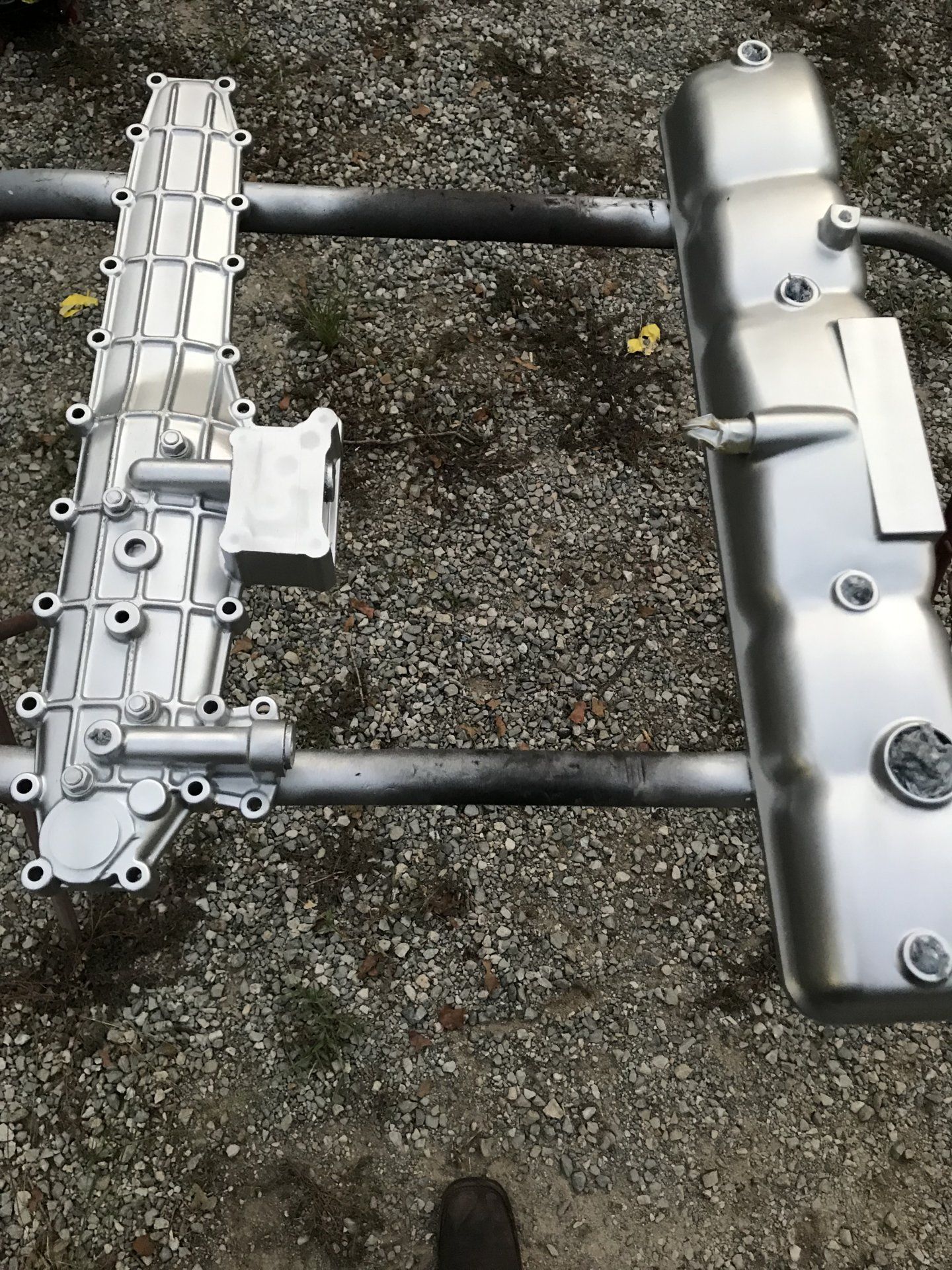

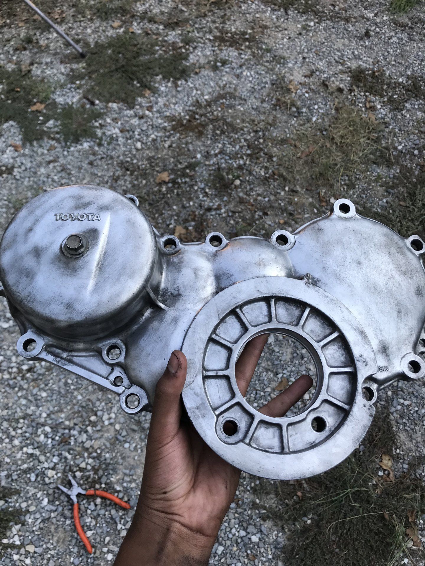

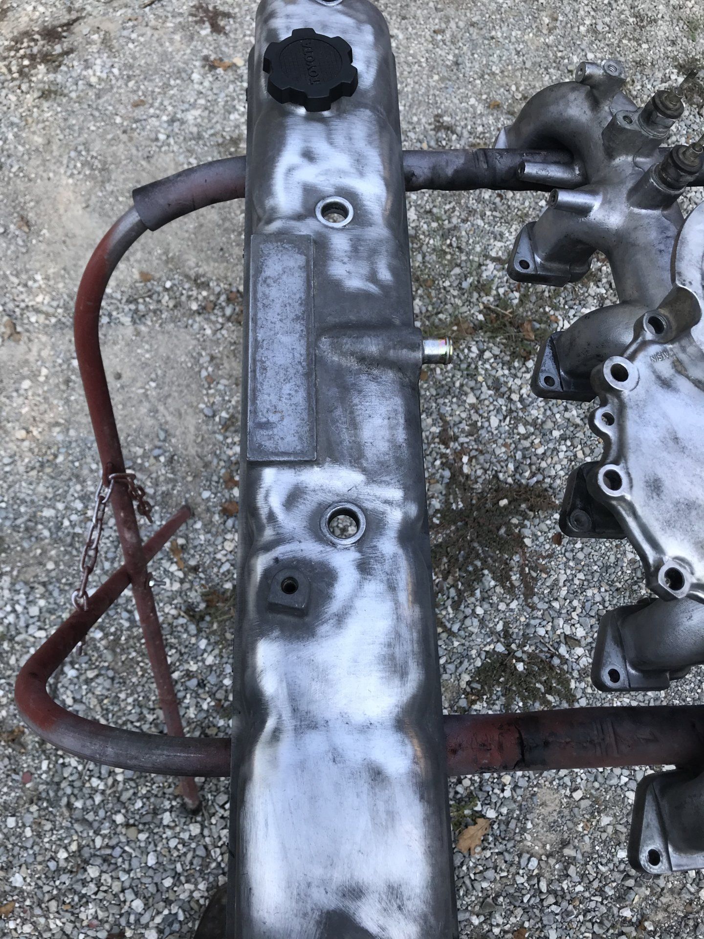

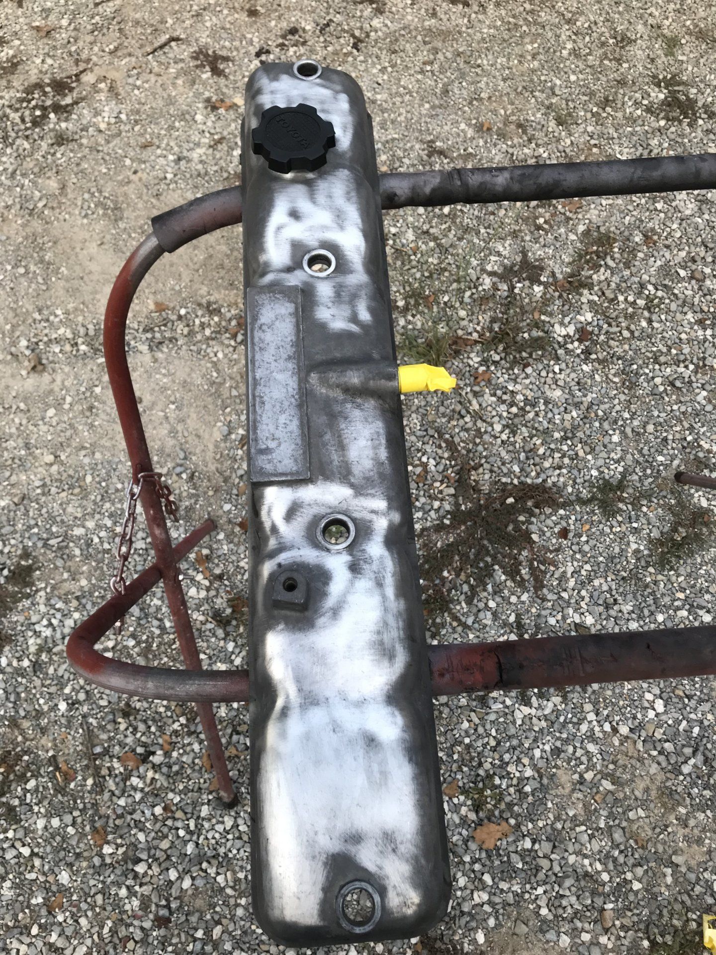

All the parts that got cleaned before paint also got a wire wheel treatment to get the tough dirt spots off followed by more lacquer thinner. Here are the valve cover, timing cover, intake manifold, and oil cooler.
I used a softer bristle brush on all the gasket surfaces of the parts as well to get any hard gasket pieces and to clean it up nicely.

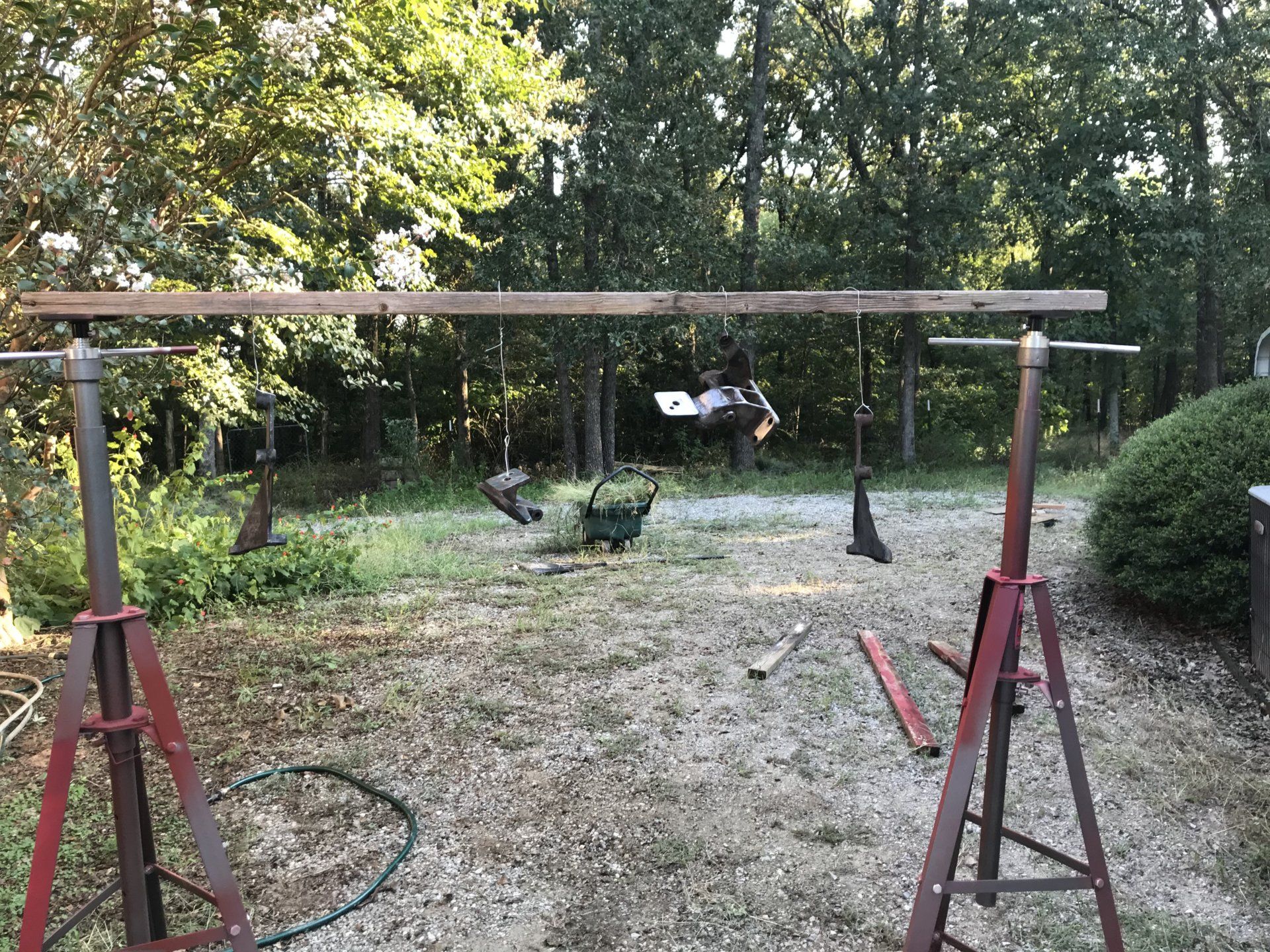

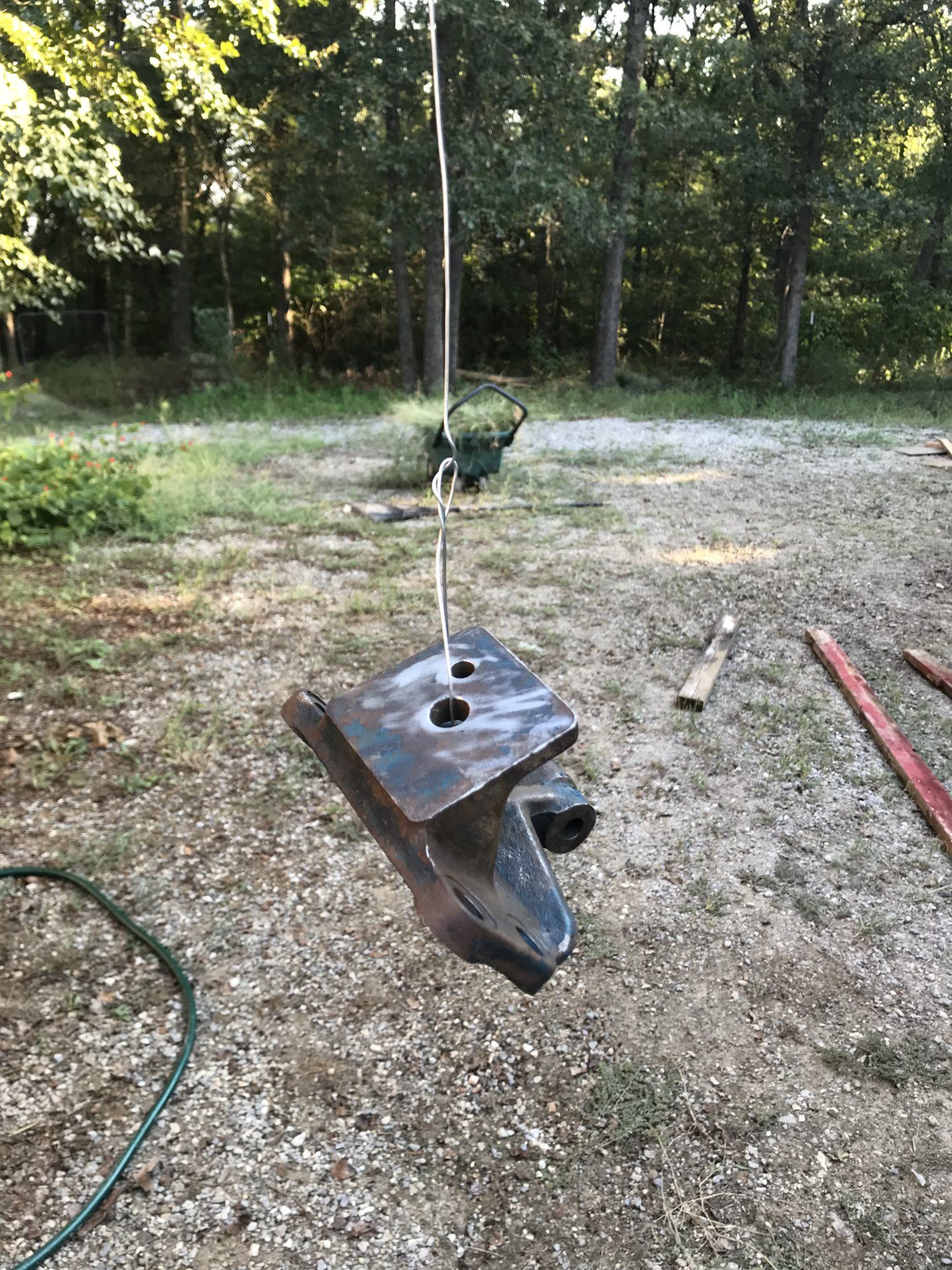

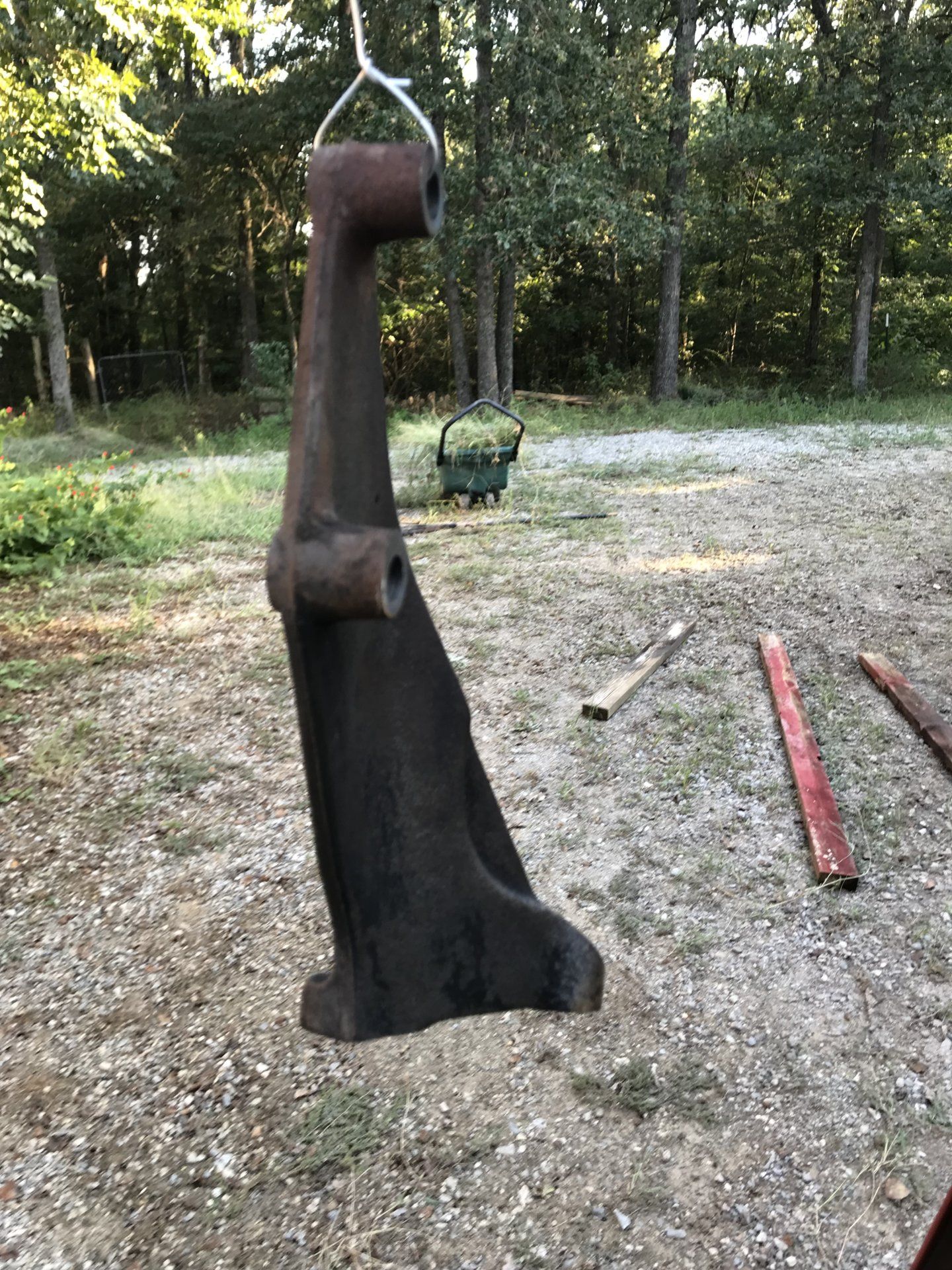

Then I got everything taped up and ready. I put carb cleaner one last time to make sure there was absolutely no grease before paint and I hit it. I turned out great and the nice blue I wanted (Thanks @FJBen!) The silver also turned out amazing and clean! Before...
