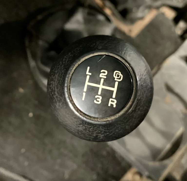

After driving around the 40 to school this past year or so I just love the feeling of being able to put my foot to the gas and get somewhere. The 350 with the 3 spd has been awesome and never struggles to get me where I need to go. Having the extra horsepower just makes sense for the kind of driving we do in Dallas and is far more practical than a 2H would be. Turbo kits are also very expensive…

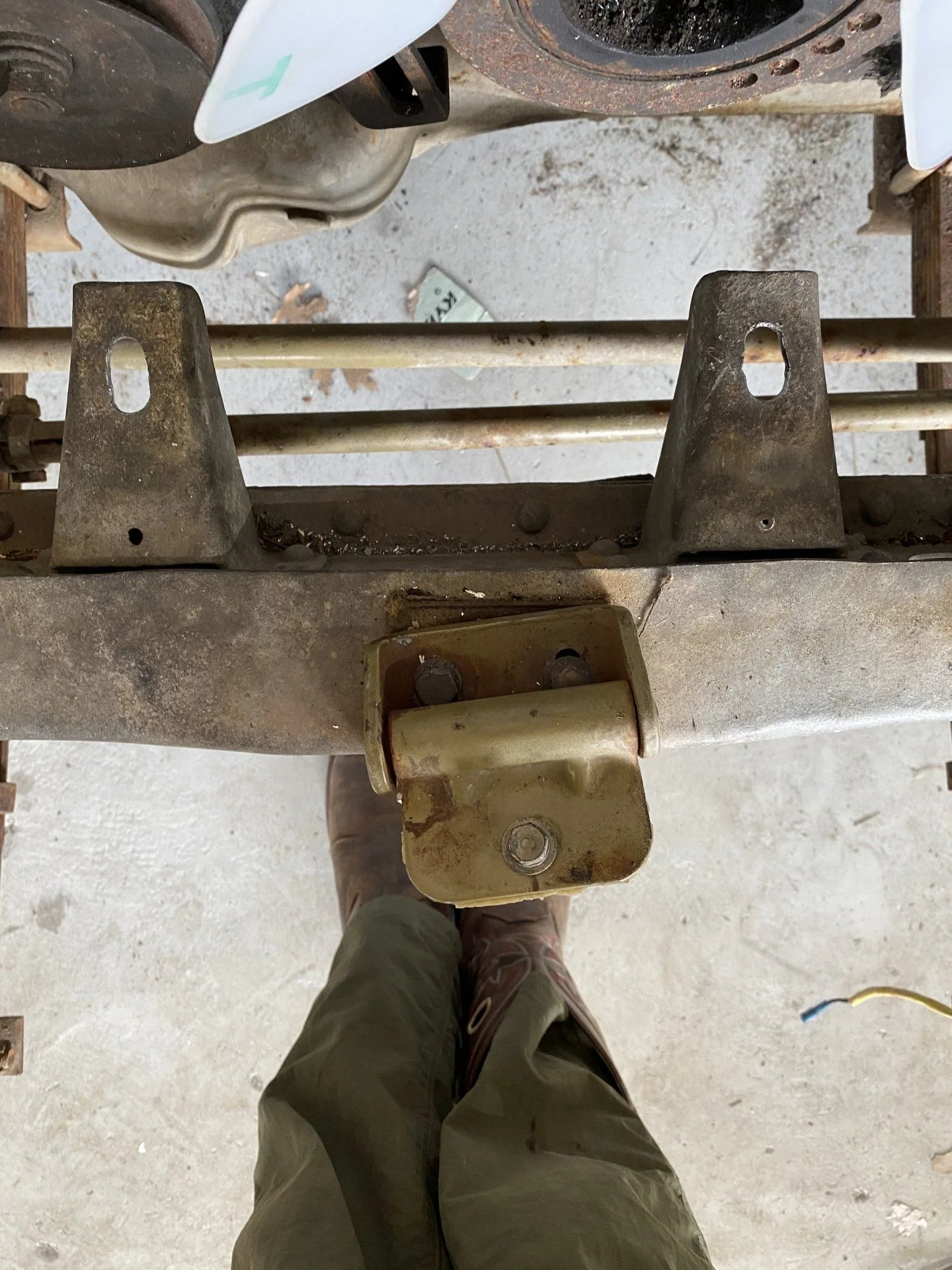

So there we have it. The 2H won’t go to waste. We’ve been wanting to diesel swap Kermit (my dads 40) for a while and now we have a rebuilt engine to do it. 6.0 baby 🤝

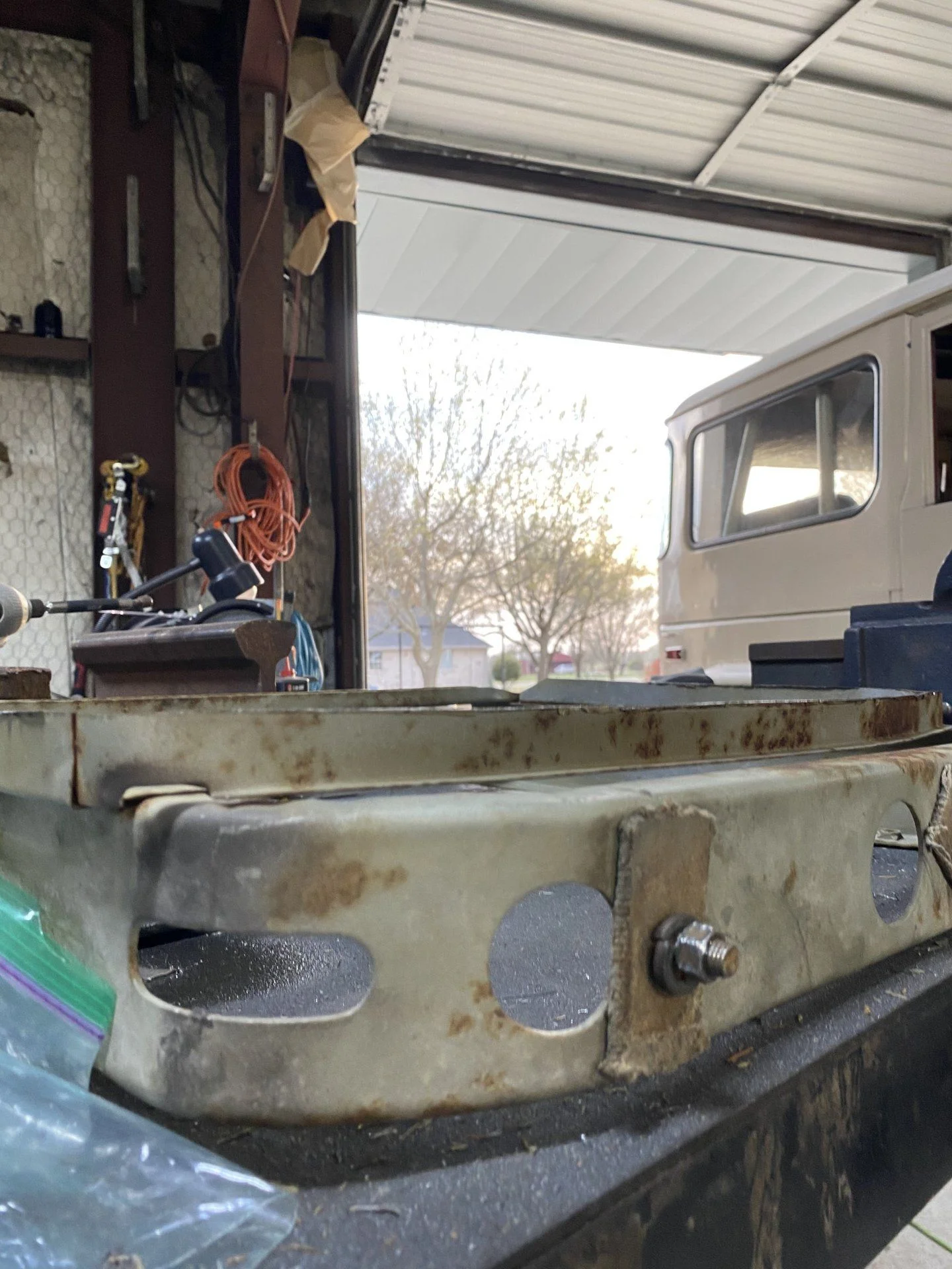

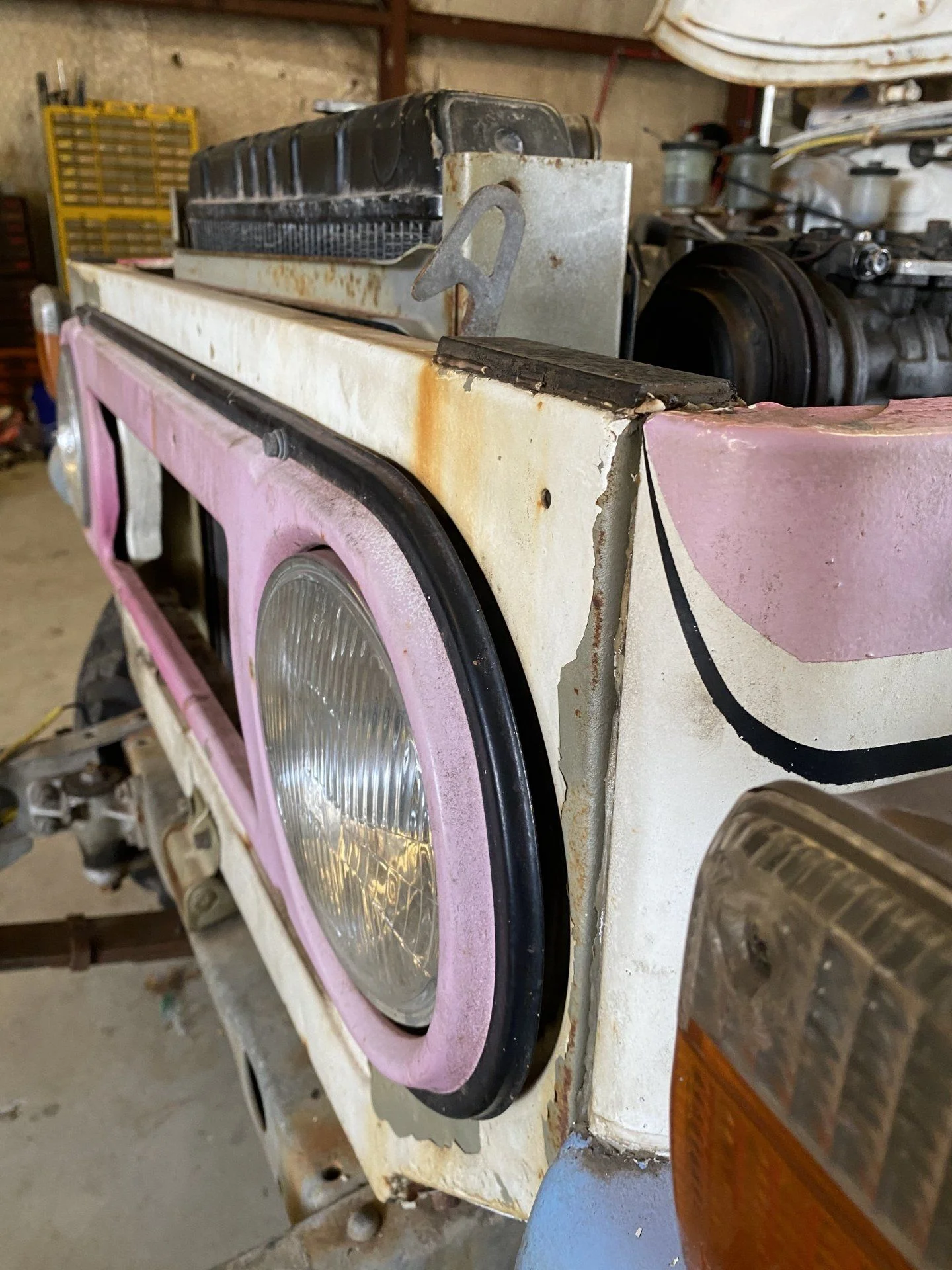

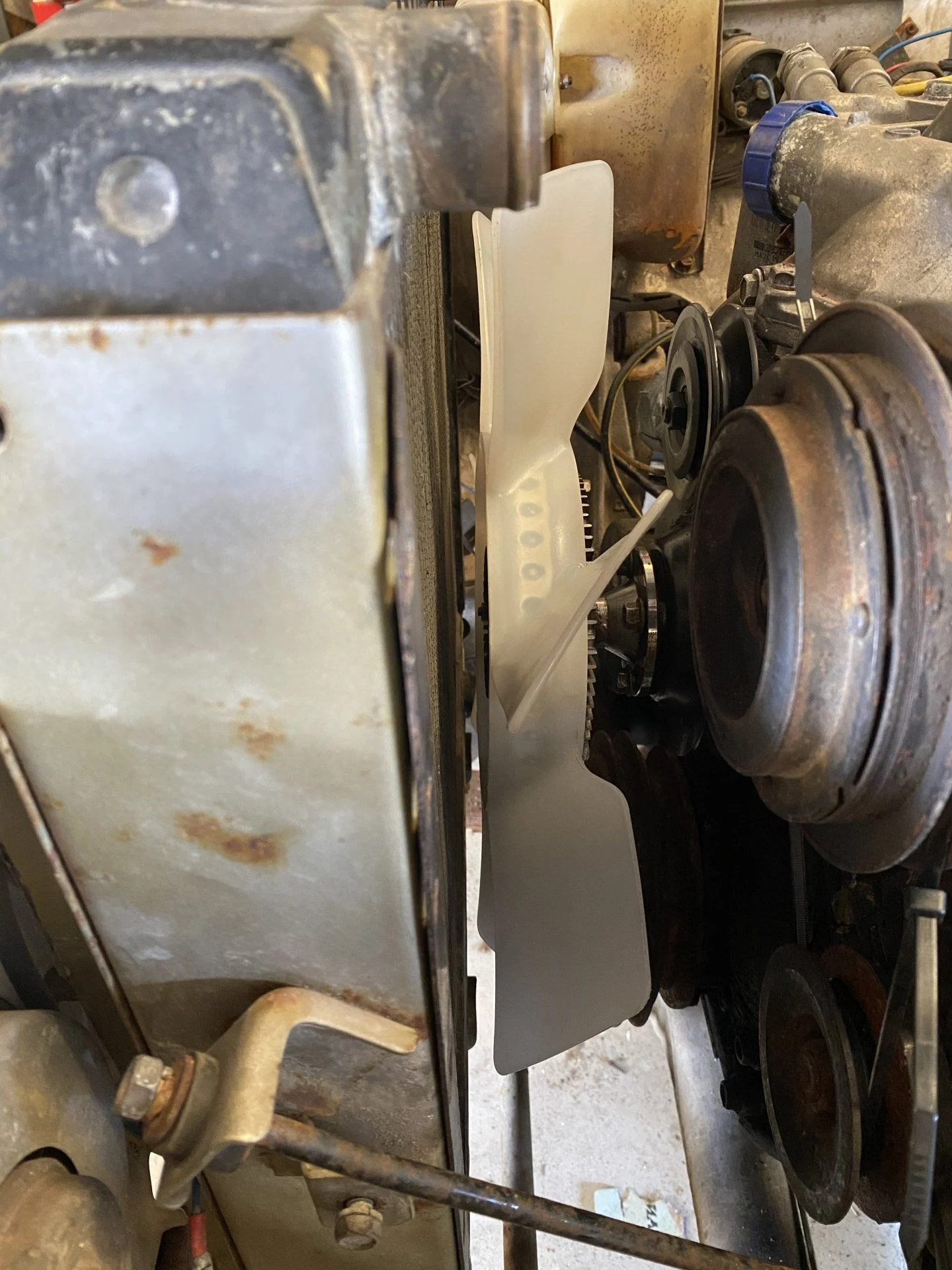

Forgot to post this but I finished up the radiator and fan placement. I notched out the mounting spots for the core support to bring it closer to the bib. To account for this I ground off about a 1/4 inch off the front lip of the core support. Even after that I still had interference with the grill mesh so I decided to scrap it. Probably going to cut some mesh pieces and mount them differently just for the aesthetics but that’ll probably be a little down the road.
Got a new fan as well, blades are just short enough to clear the harmonic balancer, and with the core support modifications it has decent room to the radiator.
Which fan blade did you end up using? I'm in the same boat right now.
2H/12HT was what we settled on I’m pretty sure
We experimented to find a fan clutch with the shortest hub shaft as well

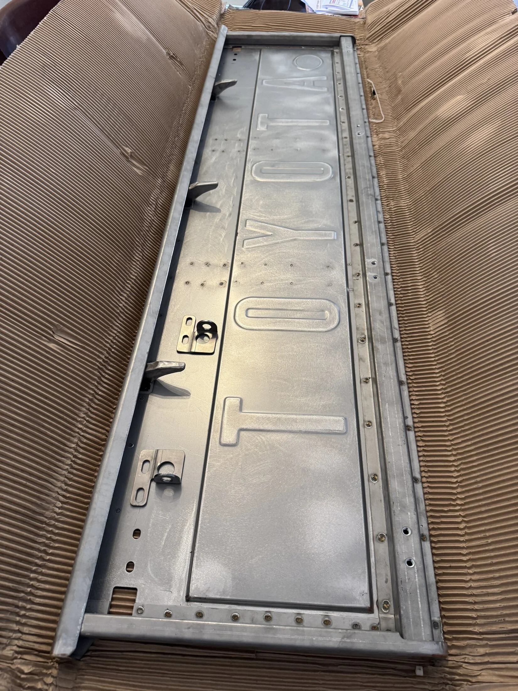

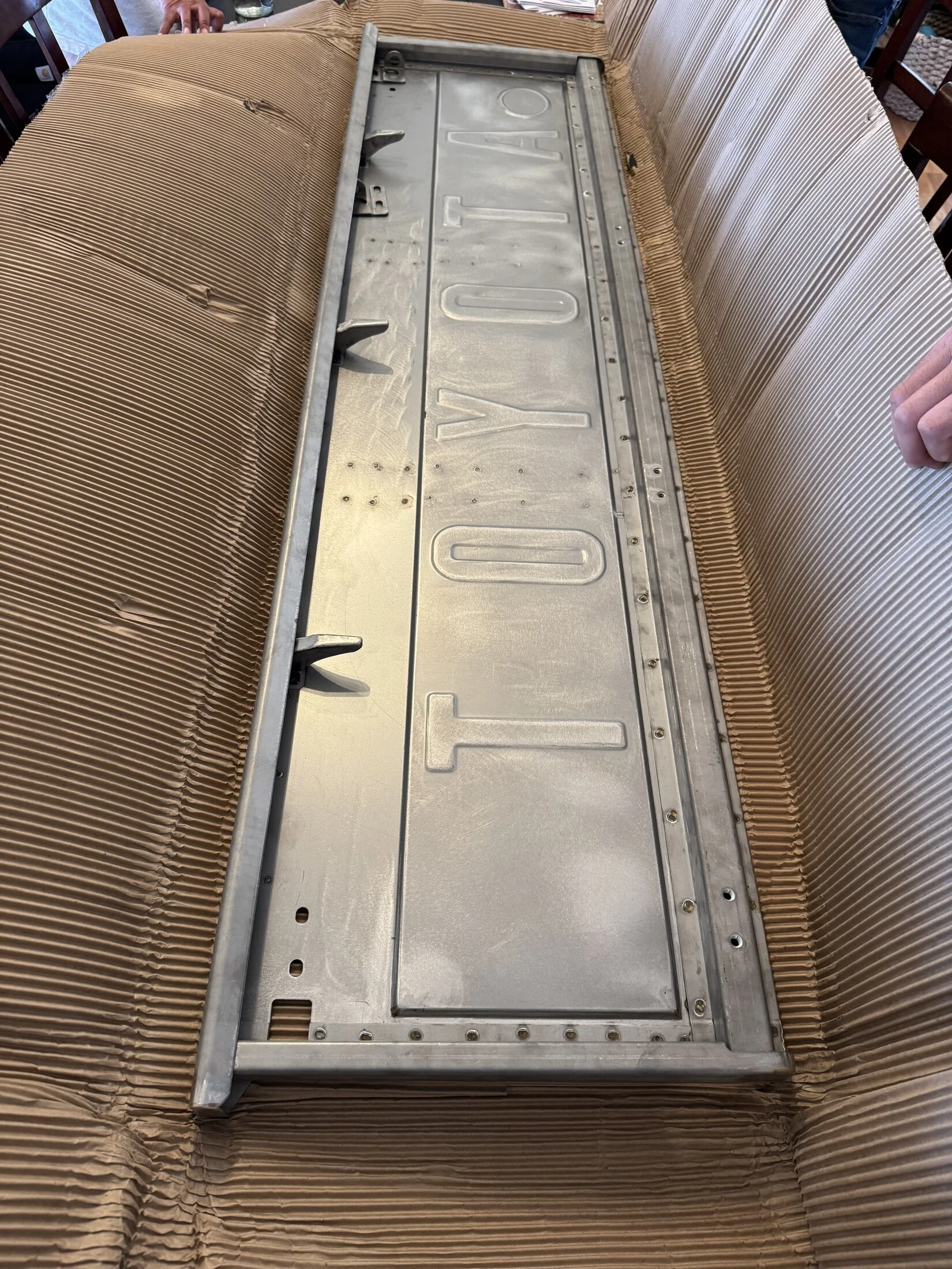

I was able to source the last fj45 tailgate made by AWL_TEQ. Its a masterpiece. Got all the NLA hinges, chains, latches. Old Landy is a South African HJ45. It has a different tailgate but will make this work, which is a better looking tailgate
