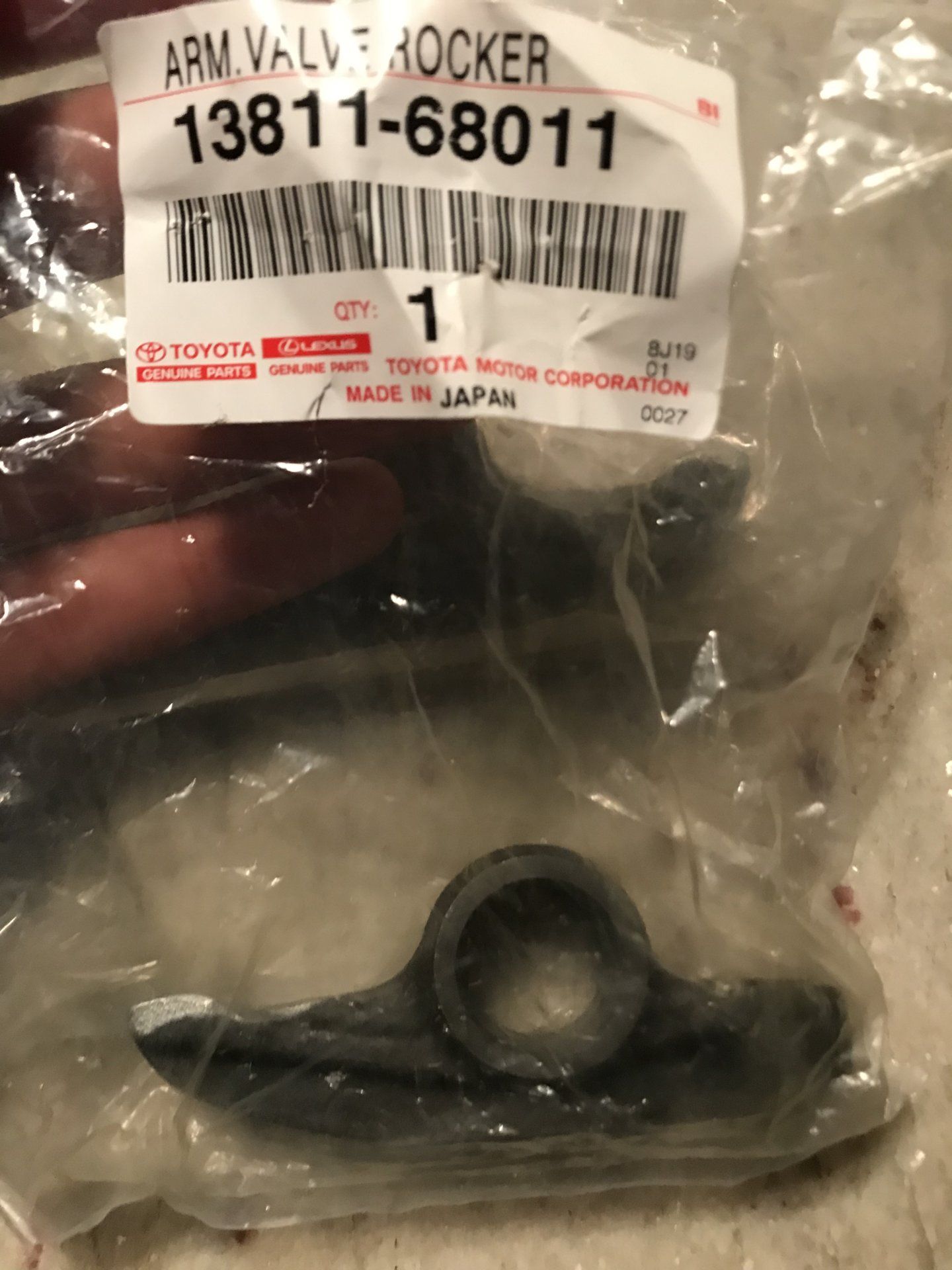

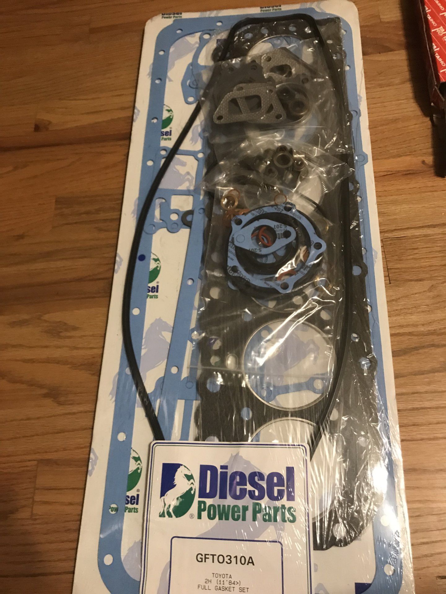

Gaskets for the timing cover and valve cover came in yesterday along with brand new rocker arms! Thanks to @Onur! Getting prepped for putting the 2H back together!
The last one is 1213-68010

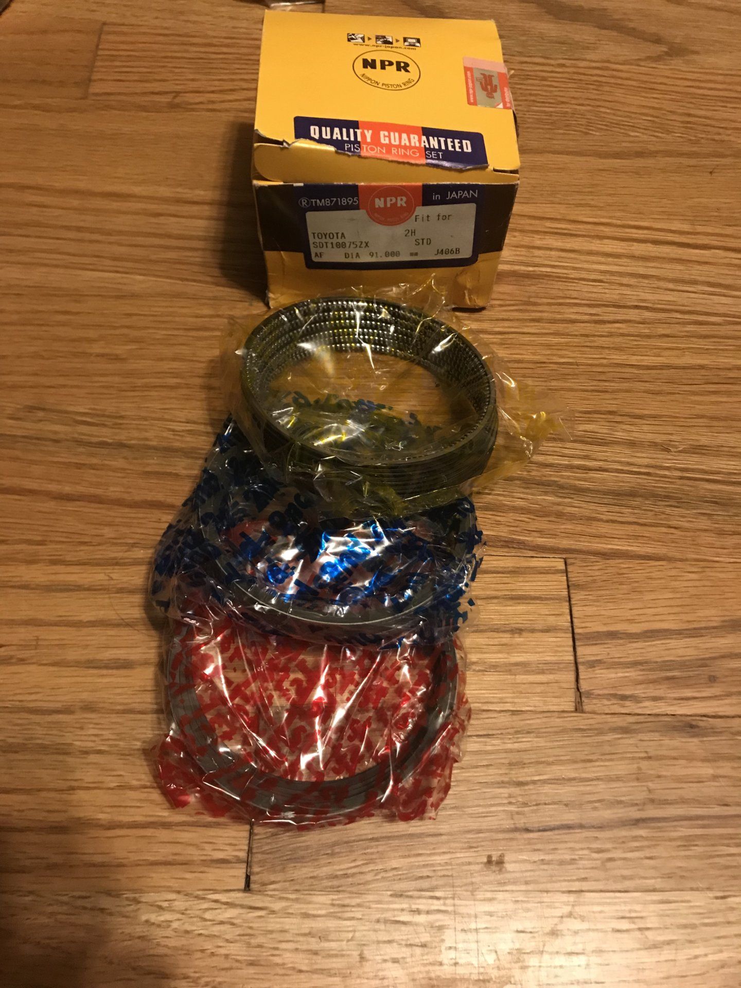

Complete std piston ring set

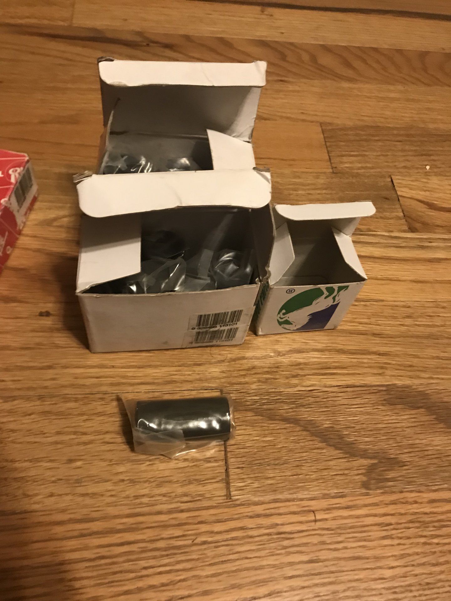

Std #1 lower conrod bearings
Std #2 main crankshaft bearing kit

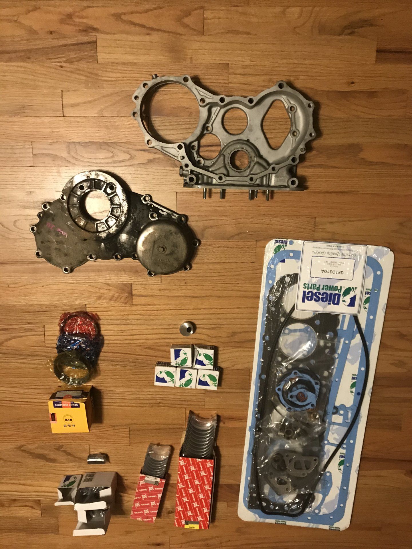

Well a whole load of parts came in from Australia for the 2H rebuild! We got brand new pre-cups, piston rings, con-rod bearings, Crankshaft bearings, timing cover, timing cover housing with oil pump, and a brand new gasket kit. We also have been cleaning up the engine and getting it ready to paint. Gray or blue???
I will update some more once we paint the engine. We plan on taking another 2H, H55, and Split Case to mark up positioning while the engine is going back together. Stay tuned!
