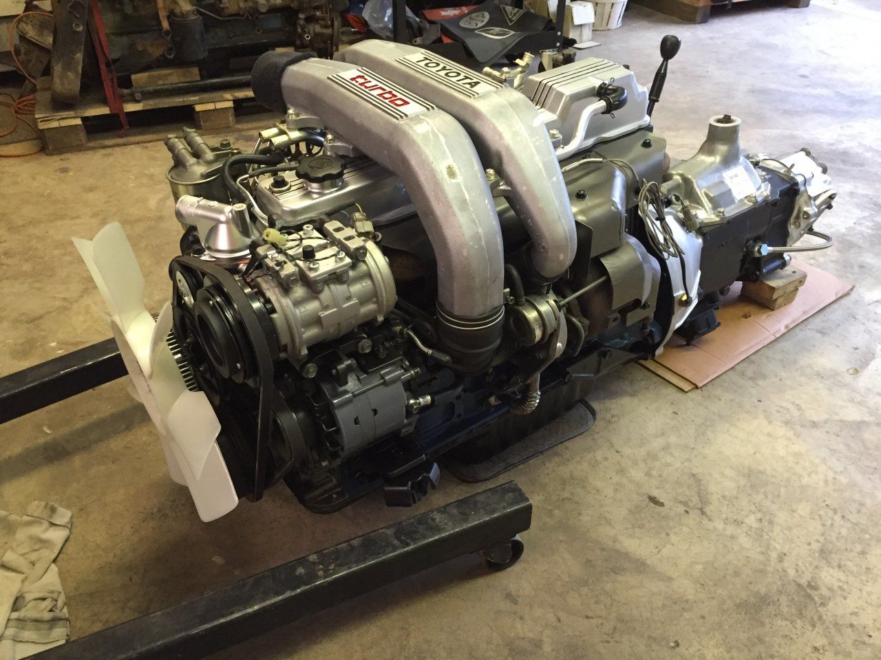

I finally completed the detailing of the engine. Now it's ready for installation. If only.........................
View attachment 1319632 View attachment 1319633 View attachment 1319634 View attachment 1319635 View attachment 1319639
Cowboy the engine had already been rebuilt when I purchased it so all it really needed was a good detailing. I spent several hours cleaning and painting (sometimes with a small detail brush) to get the engine where you see it in my thread.
