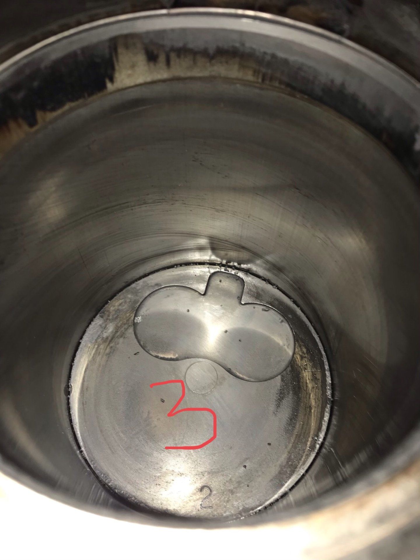

Cylinder 2

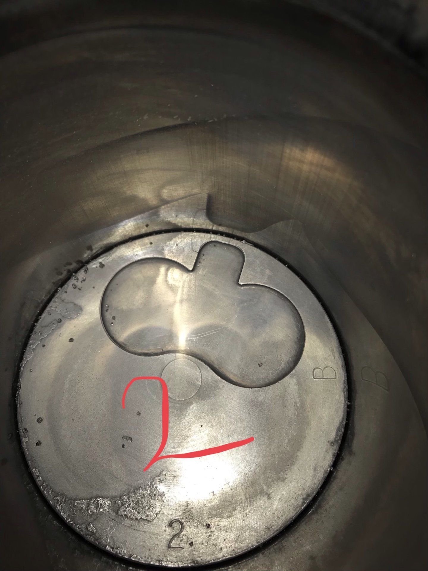

Cylinder 3

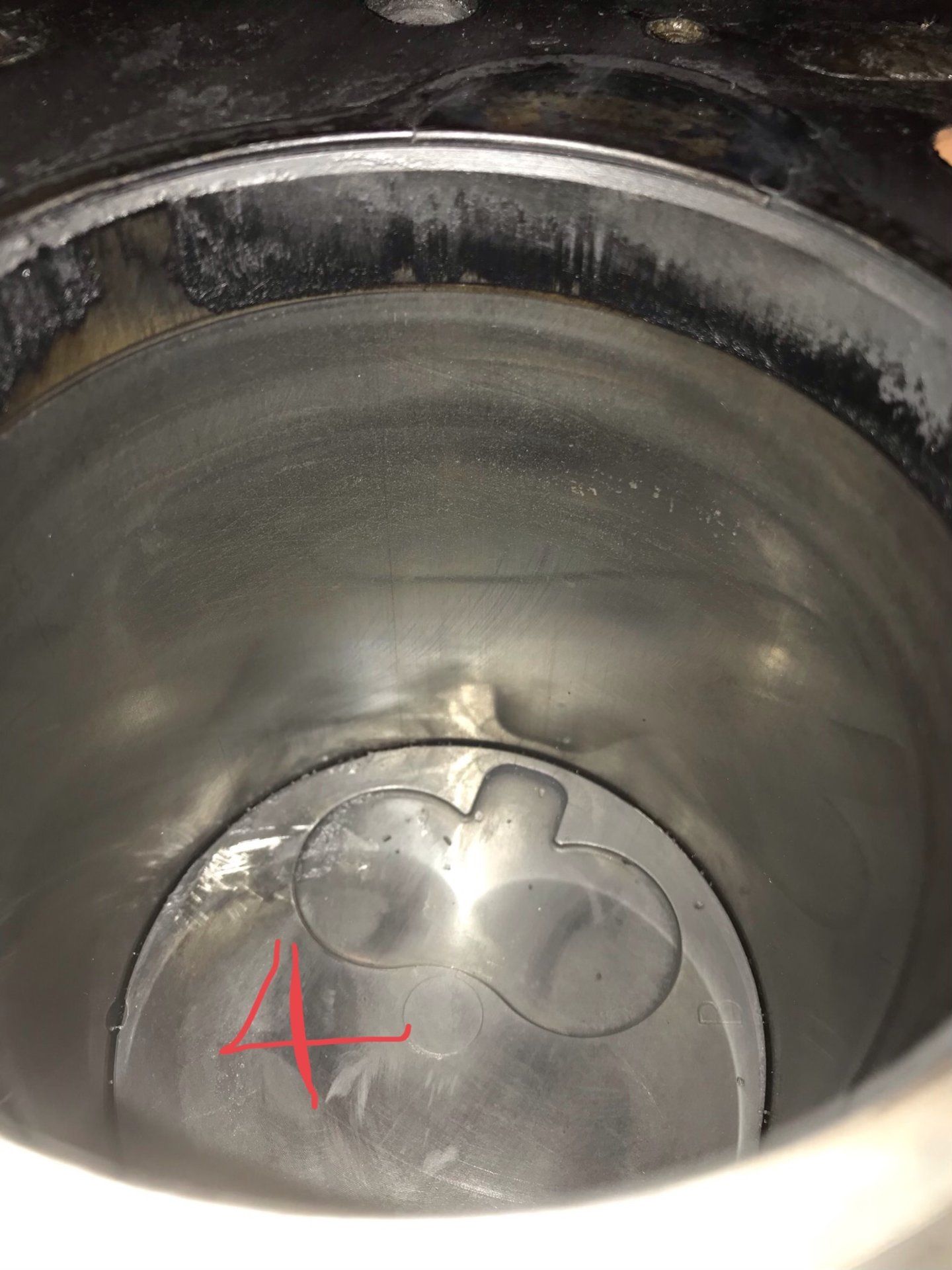

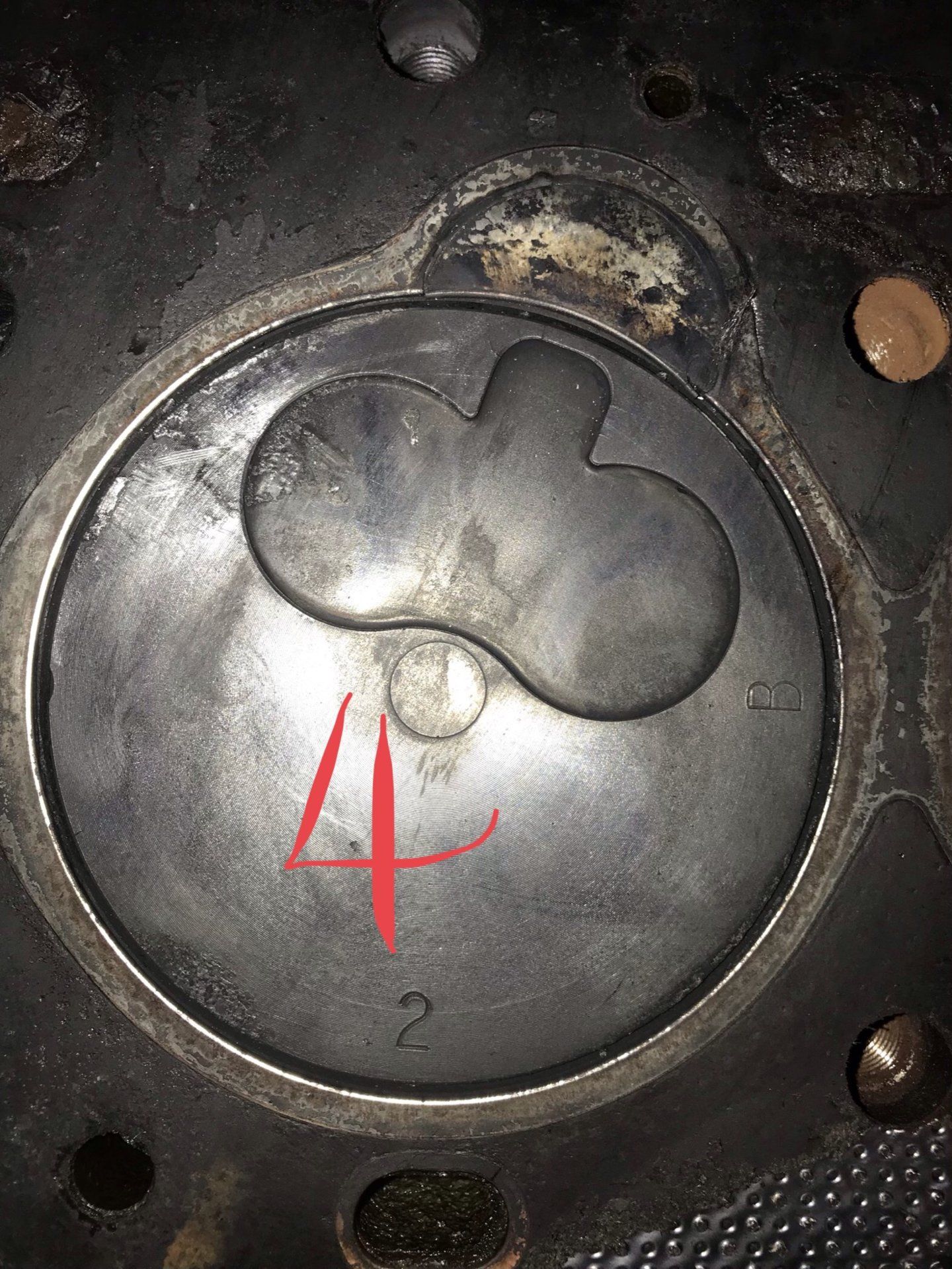

Cylinder 4

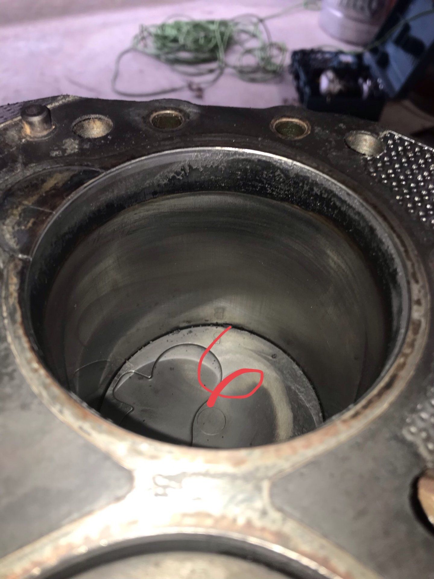

Cylinder 6. Piston has carbon build up which knocks down with a plastic scraper
We will also measure the bores next weekend. We will be pulling the oil pan and bottom end bearings to do some more plastigauge measurements. We will also be inspecting the piston rings and glands.

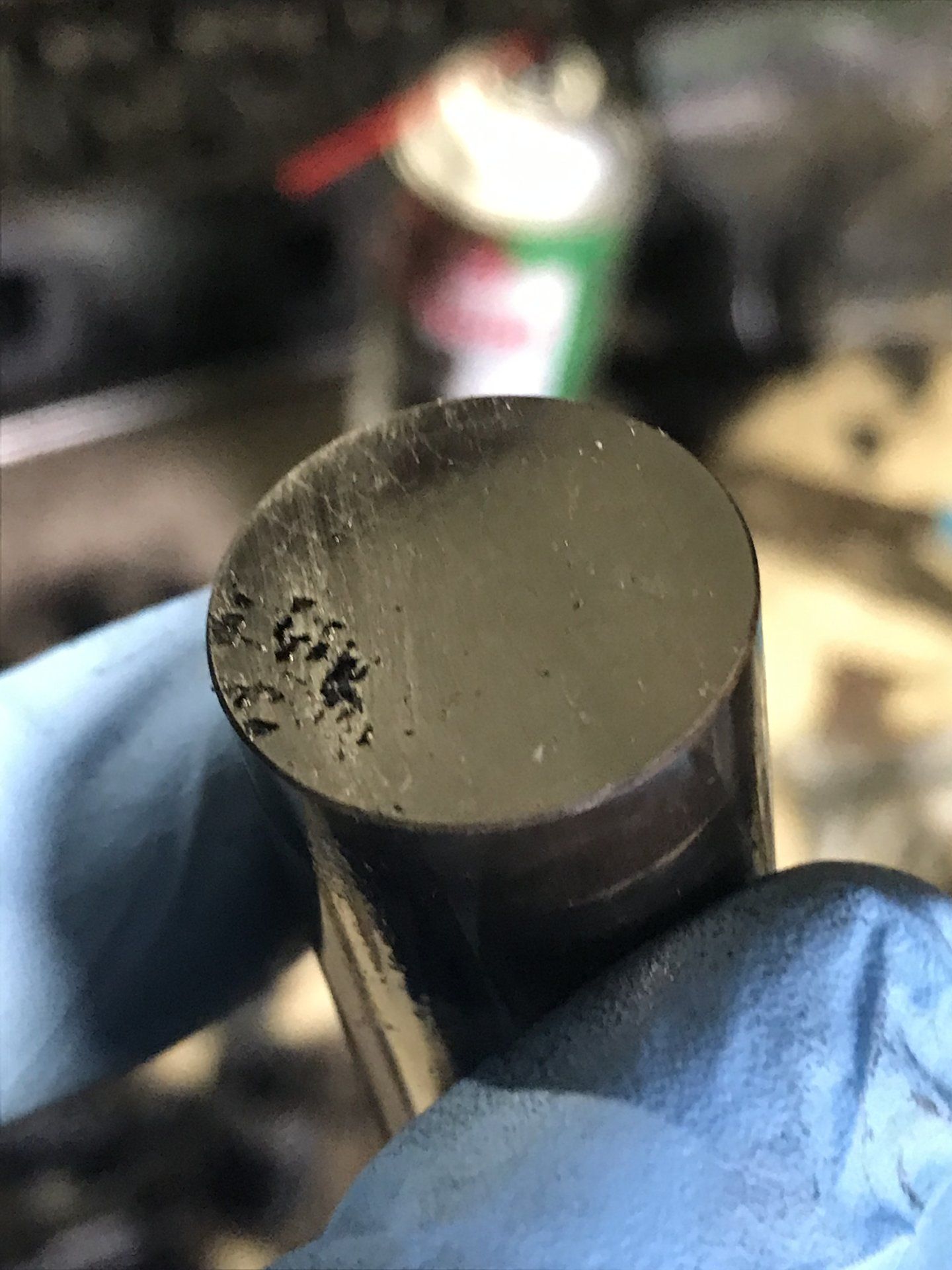

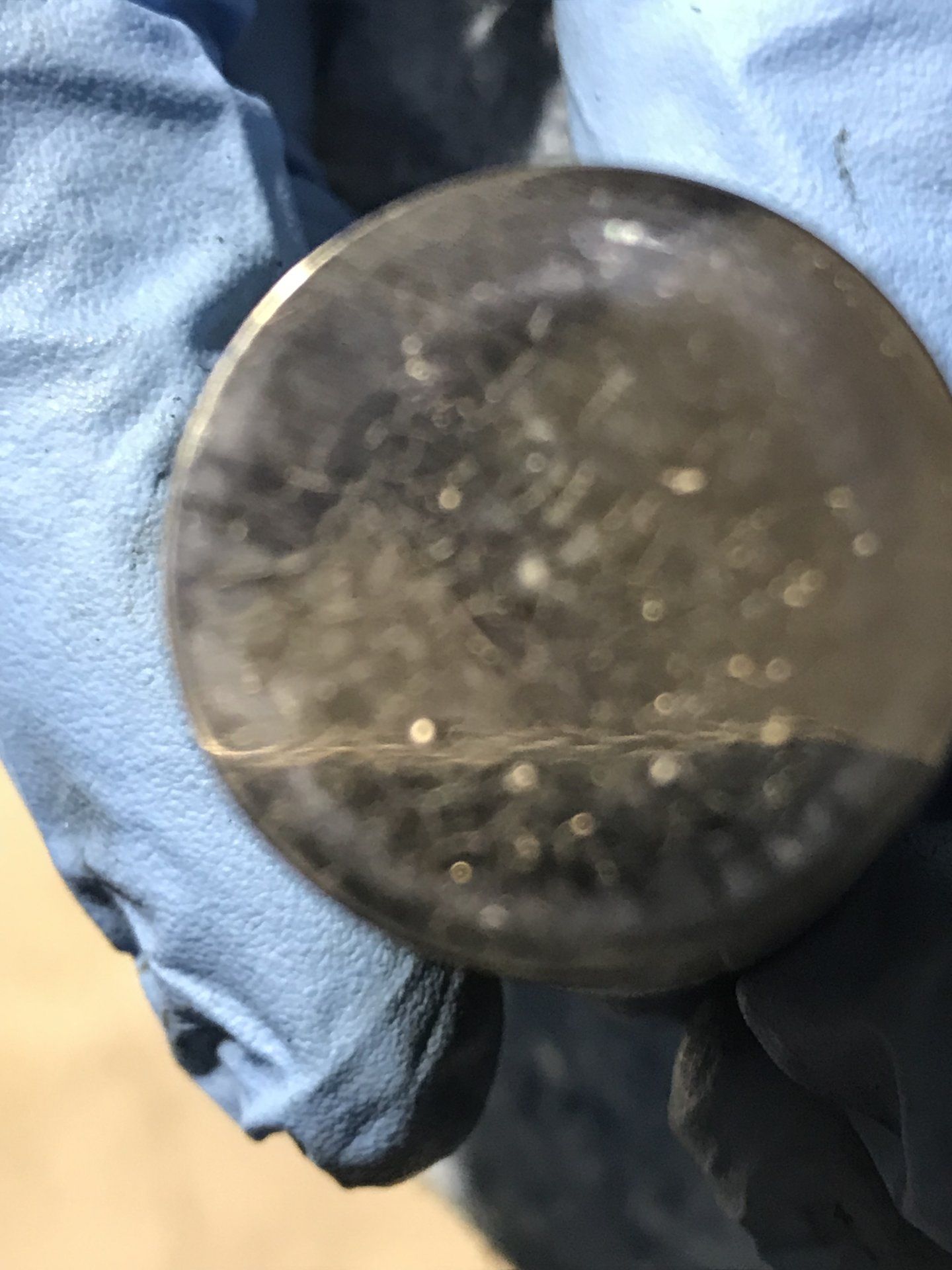

We also pulled the lifters which showed some webcracks and pitting. This was the only component that seems to be of issue and will be replaced.
Depending on measurements on bores, we will hone and rebuild motor.
CD you need to apply clean oil to the cylinder walls since you throughly cleaned them with laquer thinner. It will inhibit rust but more importantly you still need some lubrication for the remaining dissassembly steps.
@76 FJ40, good suggestion. We think alike. We did swab it with oil. :).

What causes the web cracking and pitting?
I have a PM dialogue with @crushers on this. I cannot confirm if the lifters we took out are OEM. @crushers, having rebuilt a ton of these motors has seen this as usual. Perhaps he can chime in.
My 2H is trashed
Shows same lifter issue. Unsure of motor mileage.

As I stated in the diesel section, I would replace those lifters and honestly rebuild the whole thing to make it reliable for another 30+ years. They don't look good which makes me really wonder about the camshaft. Take it to a machine shop and let them look it over and go from there.

@gerg shared some thoughts on the cylinder bores and lifters. Looks like lifters have been run in even worse conditions according to him. Good to know. I will keep them as spares but plan on replacing them.

I wouldn't worry about the carbon too much. It's where the rings start seating on the cylinders when the piston reaches the top of its stroke. Top dead center they call it. The rest of the cylinders get wiped clean by the rings but because the rings sit lower in the piston it doesnt make contact all the way up. If you're want you can clean it gently with some scotch brite. I find a shop vac works wonders for sucking the junk out of cylinders when I work on them. Compressed air just blows the junk on another part of the work area.
Will you be doing a full rebuild on your engine? Have you talked with your dad about reinforced alfin pistons? Now would be a great time to change them.
I've run lifters that looked worse than that with pitting and such. These old engines run relatively soft valve springs so they don't put a lot of force onto the lifter face your looking at. Replacing them would be a good idea but if your on a budget I'd run them. If they haven't come apart in the last 40yrs I don't think there going to do it any time soon. It is possible to replace them later when the engine is back together in the truck. I've looked into haveing them resurfaced and my machinist said they are too thin unfortunately. Well at least they are on a 3B, the 4 cylinder version of the motor your working on.
