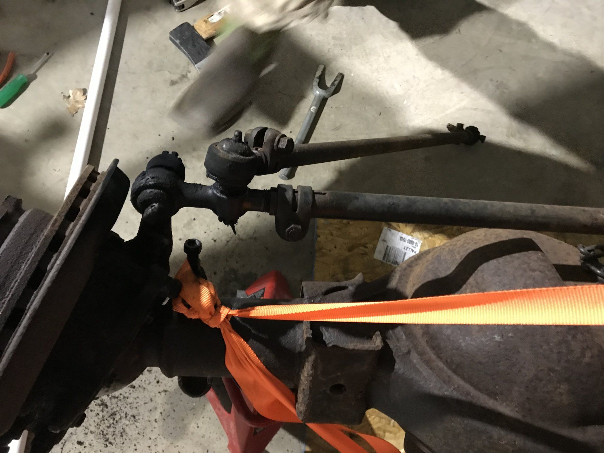

We first started by taking off the tie rods and calipers from the axle. The tie rod ends were stuck so we torched them to see if they would expand and come off easier. The brake pads were pretty worn, but can be replaced. The main kicker was the caliper pistons were frozen. We tried to get them off, but we don’t want to risk it so we might be getting new ones.
95 4runner disk calipers “S13WB” are another good option. They have equal sized pistons vs one big one small piston like the “S12WB” 60 series caliper. O’Reillys usually has them on the shelf for under $40 ea
We hashed through some calcs on 4 runner calipers on pg 20. 4 runner Caliper pistons are not only the same size but each are bigger (2x41 mm) than 60 series caliper pistons (35 mm and 28 mm). About 60% more piston area on the 4 runner which also uses larger brake pads. Higher force (Force=Pressure x Area) and better force distribution.

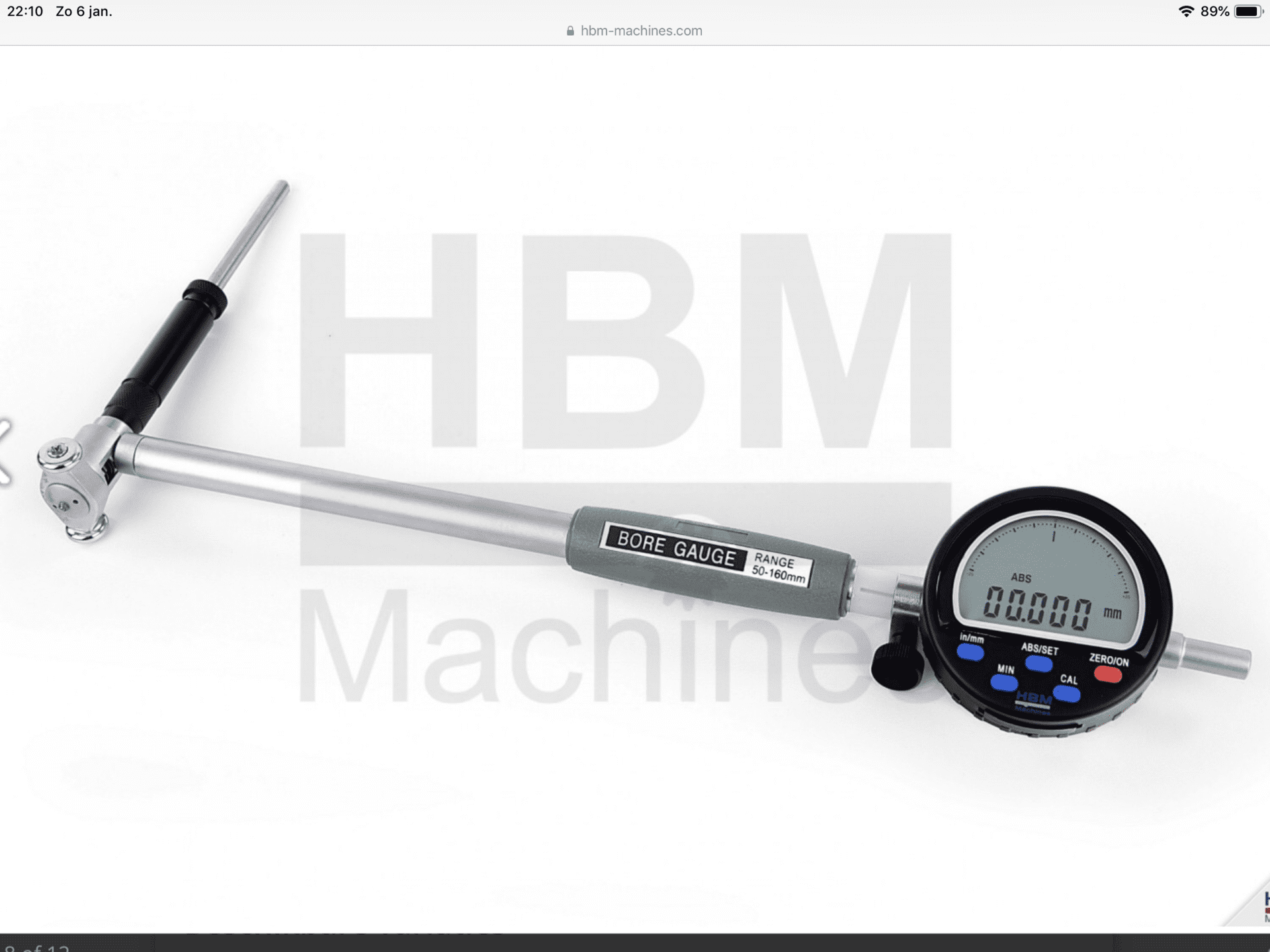

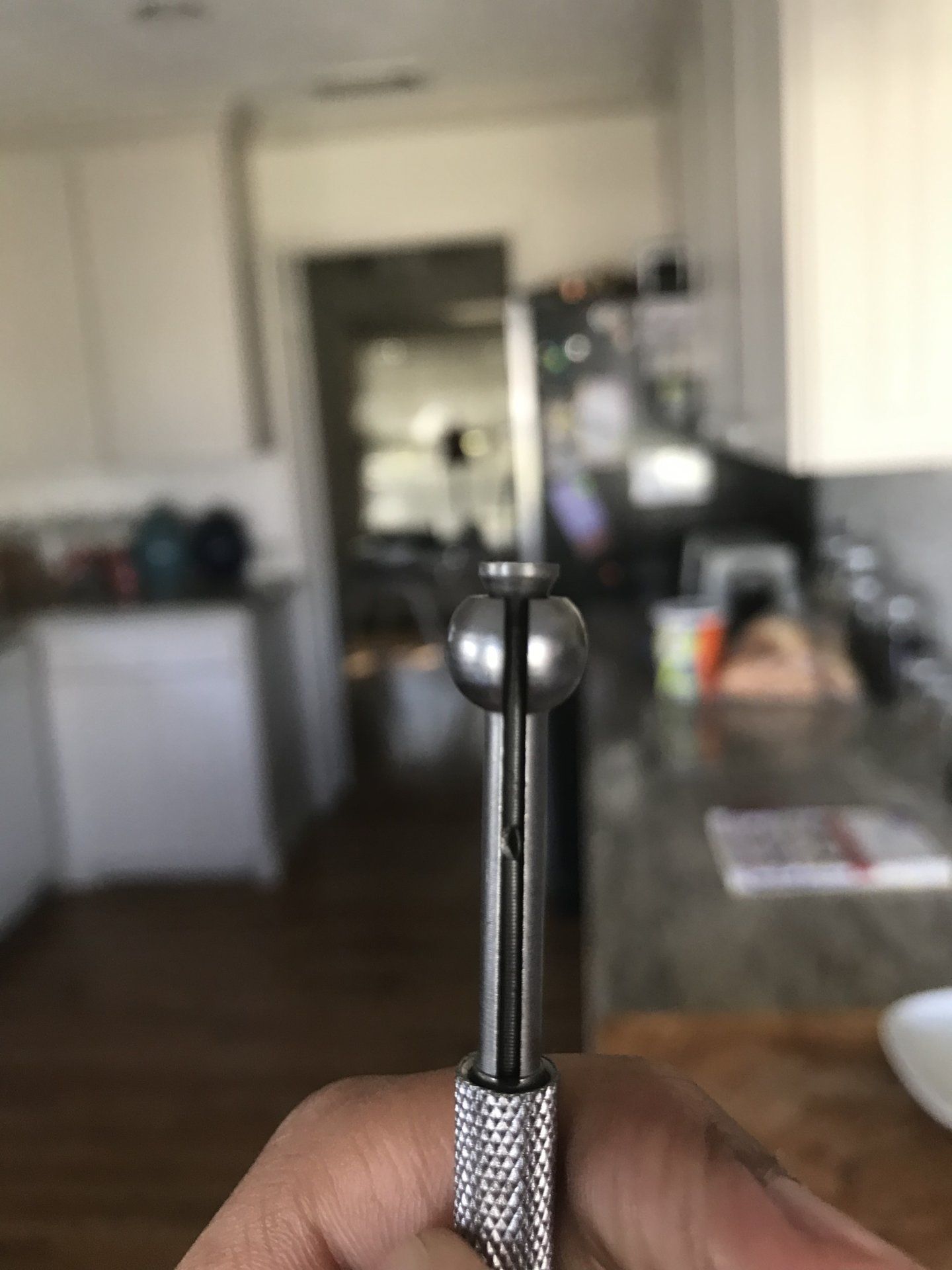

I thought this would be helpful to anyone who is doing the same job as us with there engines. We just found some really cool tools that help with cylinder bore measurements and bushing measurements.
Cylinder Bore measuring tool: This tool is a rod that T’s at the end. On each end of the T there is a piston that freely moves in and out depending on your bore size. When you place the tool in your bore it will adjust to the diameter of the bore. When ready you can lock the pistons in place and when you pull out the tool it will keep the distance between each piston. Then, just measure the distance from one piston to the other to get the diameter.
The next tool is used to measure the diameter of various holes. This tool has a knob that controls a cone shaped push pin which is surrounded by a two halves of a ball. As you tighten the knob the pushpin retracts causing the two halves of the ball to push out making the diameter of the ball bigger, and as you loosen the knob the pin pushes out causing the two balls to retract which means a smaller diameter. You can easily stick this in any hole and figure out the diameter just by measuring that ball after adjustment.
You might want to look for this tool too.
You can measure the cilinder in different positions and read the values directly.
