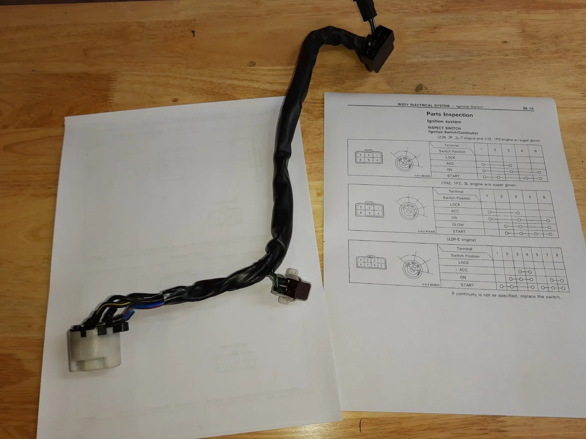

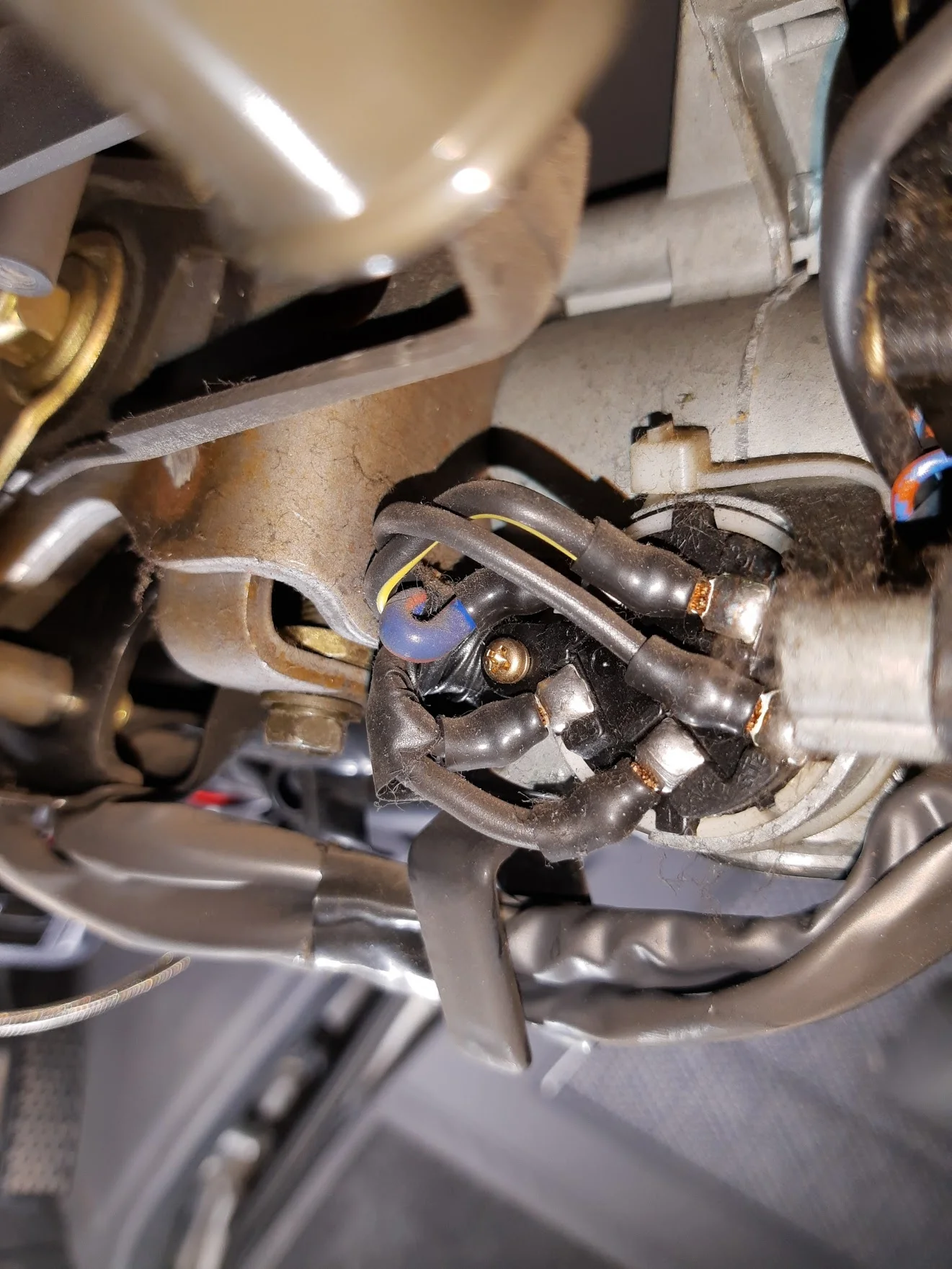

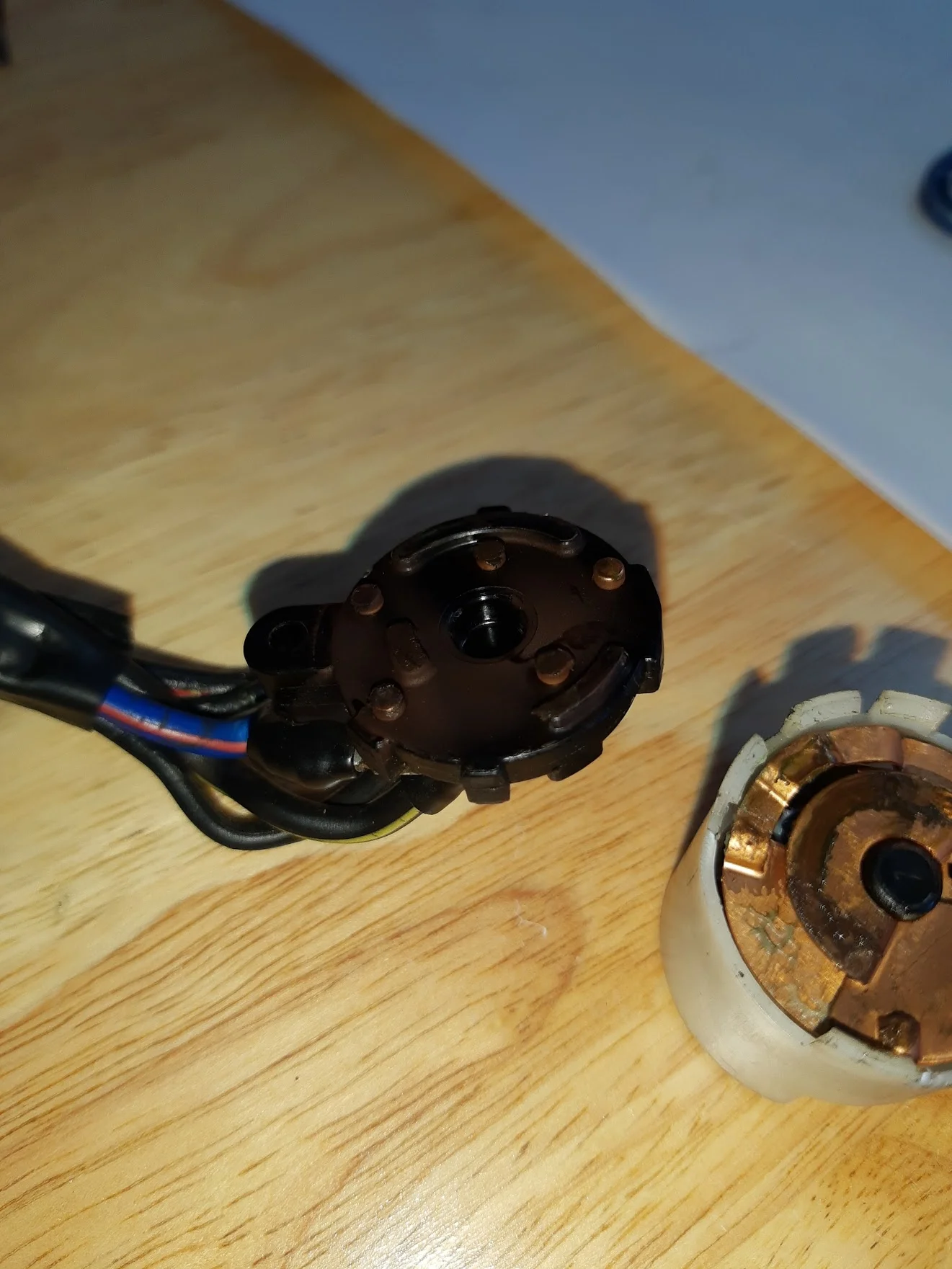

So I took a little camping trip last weekend, and several times the truck went quiet when I turned the key to "start". I've been suspecting the ignition switch, since it generally only misbehaved when it was warm. And it was very warm last weekend. We actually hit 37* C at one point, which for Alberta is usually unheard of. In any event, when I got home I figured it was time to do some digging.
I started by taking off the column lower shroud, and then popped the lock tumbler out (a little scary how easy that was, but at least I'll know what to do if I ever lose my key?) Then I managed to unhook and fish the ignition switch and harness out of its cosy home. It really didn't wanna come out...
Using the FSM, I tested continuity between all the terminals, based on key position. Everything checked out.
I could've applied heat via my heat gun to see what would happen, but instead I carefully popped the cap off the switch. Lots of evidence of buildup on the contacts...
240k kms will do that! I guess it could be cleaned up, re-lubed, etc. But a brand new one was only 60 plus shipping, and it's kind of an important piece - this thing is known for reliability, so my thought was a brand new part for a known failure point is money well spent... hopefully it will be here by Monday.

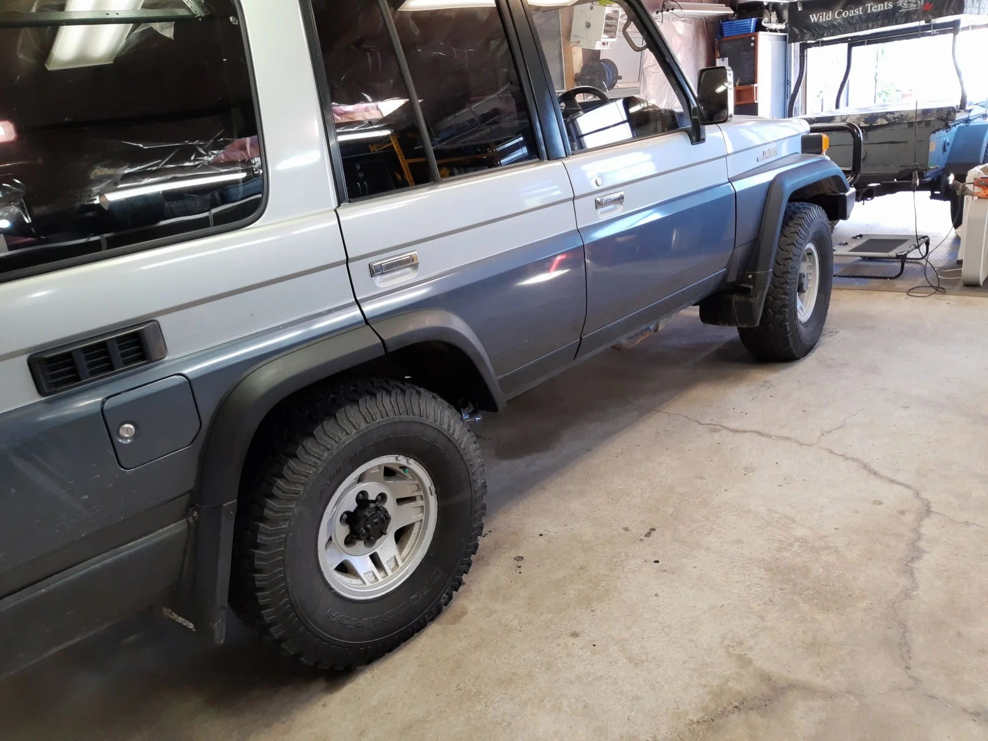

Been dithering on paint for a while. Don't want to spend the money any time soon, and it's not *that* bad. But the flares were all badly shedding clear coat, and the resulting dilapidation brought the whole truck down. So... Today I finally decided on a stop gap measure until "someday." I scuffed up the body colored flares, masked the rest, and hit them with a satin low texture truck bed liner spray. Wasn't sure if it would be better or worse but now that I've done it, I think better?
Because there is black cladding on the rockers, and the flares run into the black molded mudflaps, and the black rear bumper caps, the black flares seem to fit in just fine. Better than peeling and faded clear coat, in my estimation.
Blends in perfectly in my opinion.

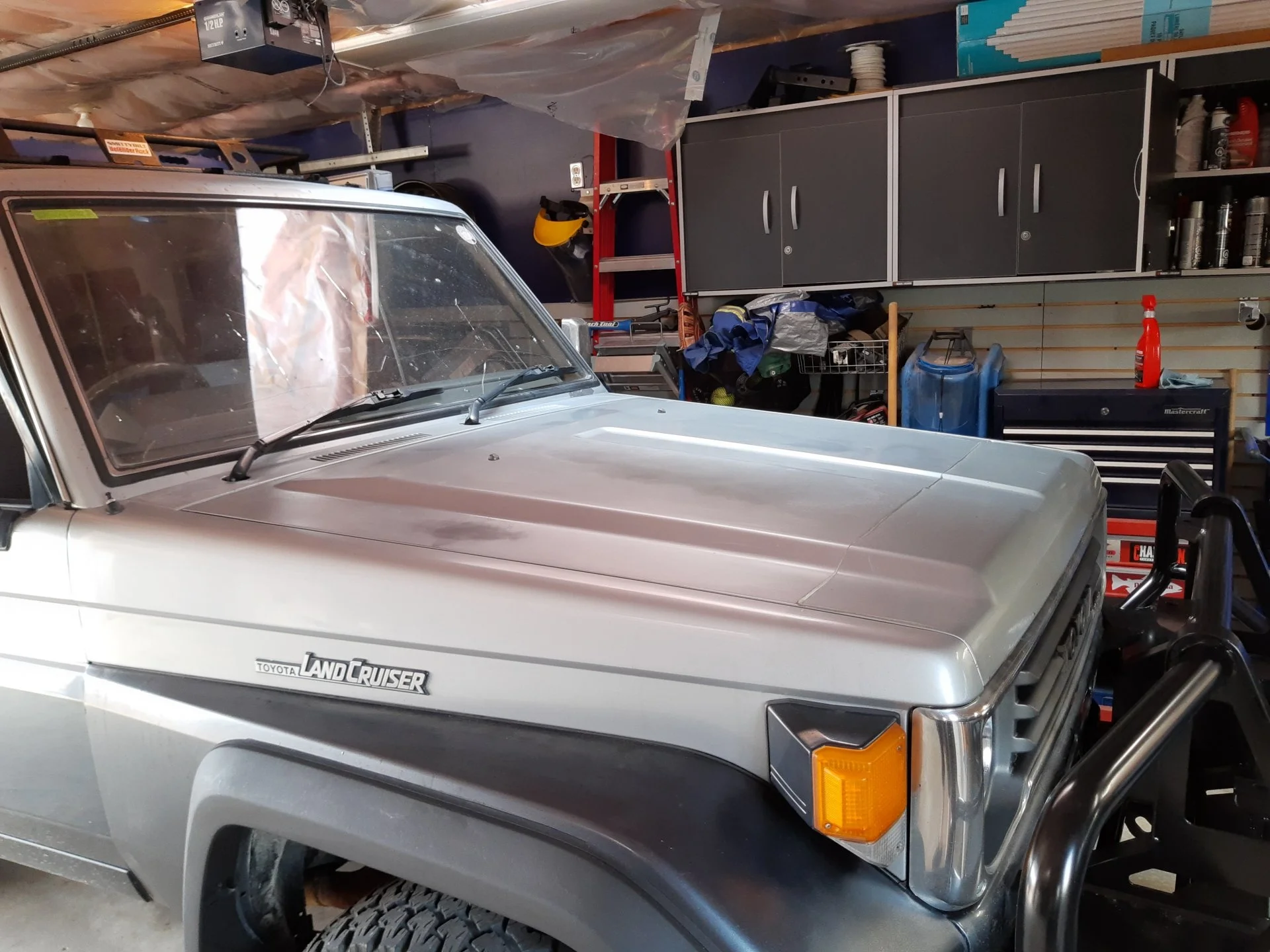

Knocked down the peeling/cracked clear on the hood and dusted it with my remaining color matched rattle can. It's still "patina-ed", but without looking quite so neglected.
Between this and the flares, I can now look at it without cringing. Someday a full spray will be likely raining down, but these stopgaps are acceptable for now.

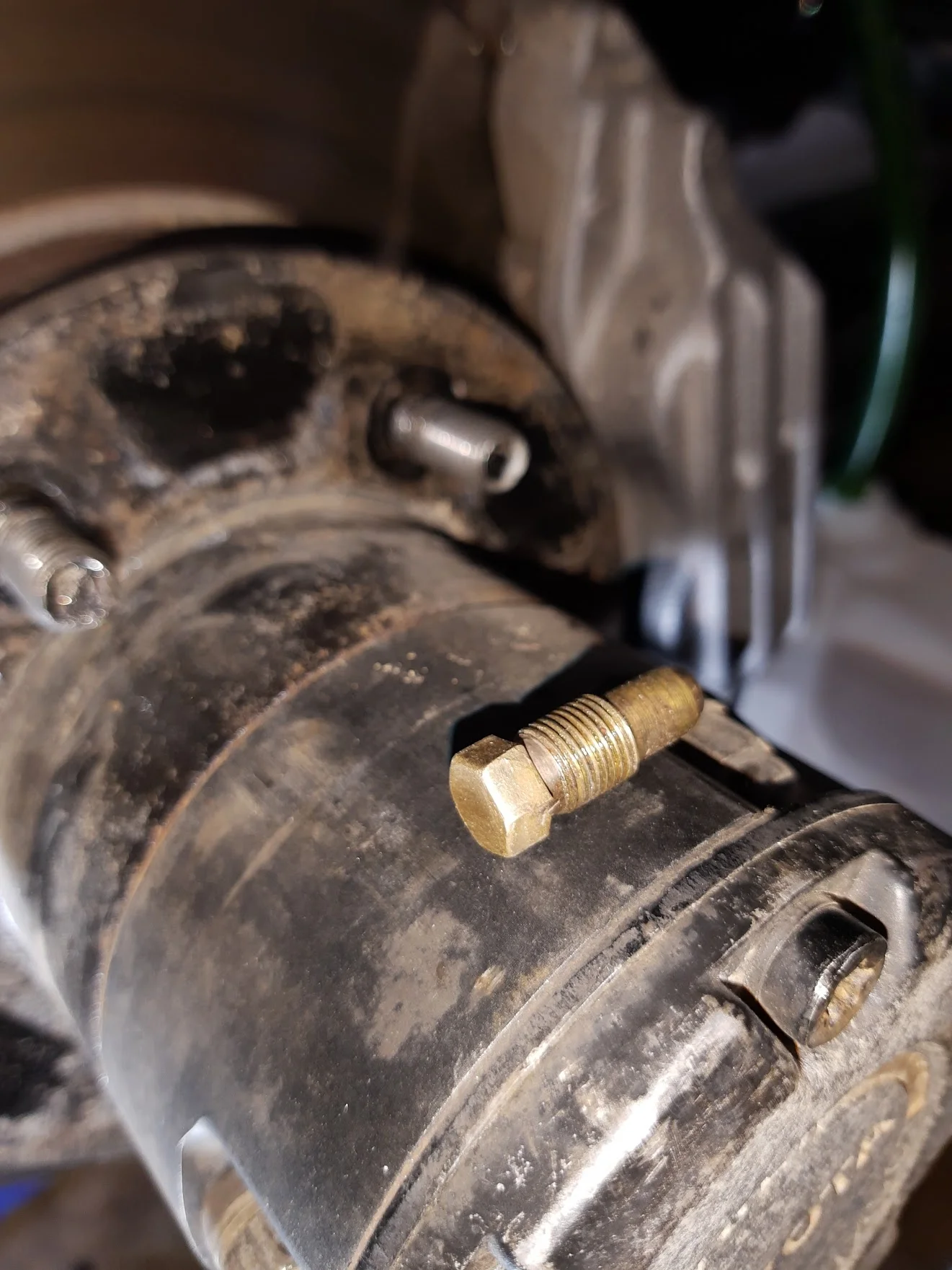

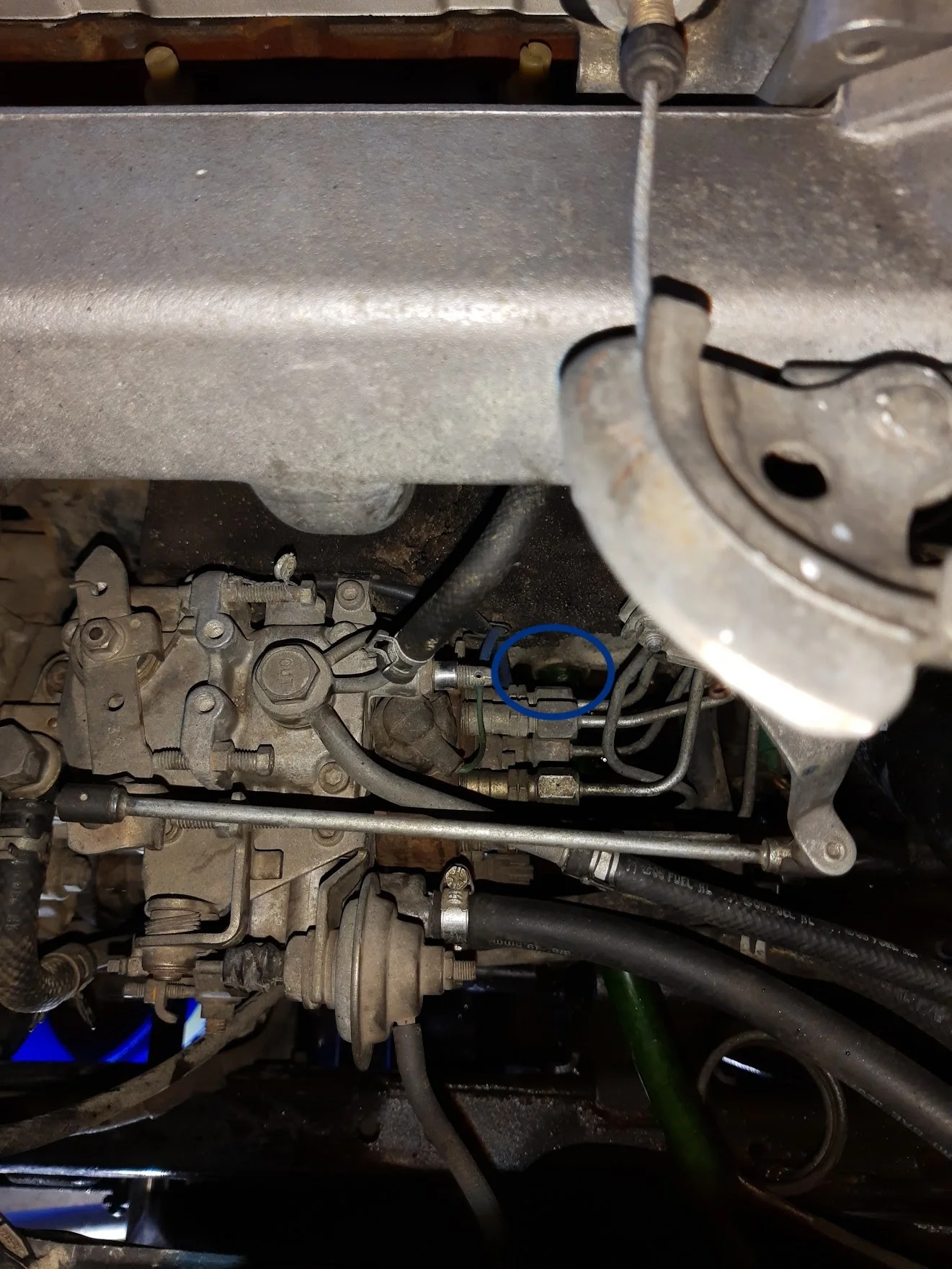

Oil change on the Prado 90, and then on to cooling system overhaul on the 77. Which meant of course that puppers had to go in the house.
Started by trying to find that damned block drain. There are pics of it all over the internet, in many places, shapes and sizes. Finally I gave up and started looking really closely at what looked likely. Pulled the LHS wheel, and the inner fender skirt. Finally came across a brass bolt that looked like there was a drain below it's extended socket. BINGO!
So ON THE JDM 1HZ (since it seems to be in many places) its almost directly below the spot on the IP where all the pipes converge... tried to get a pic of it while my hose was directing the coolant into a bucket. Not super helpful I know, but might help someone...
If you look closely at my blue circle, you can see where my hose plugs onto the end after you pull the brass plug.
That's a start... more to go.
