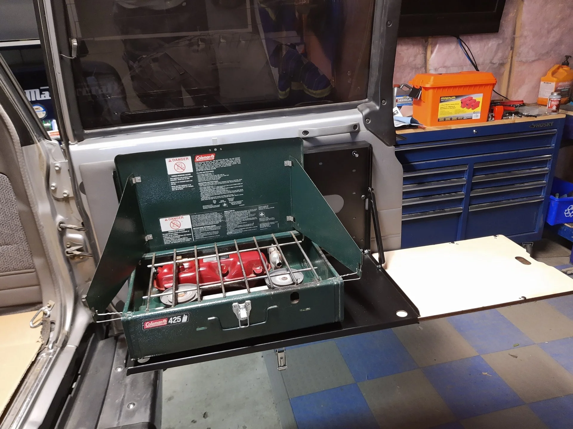

At long last I have myself a tailgate table. After agonizing over which one to buy, or even building my own, I ponied up for the Frontrunner drop down table. Two things really stood out on this model...
-the slide out undershelf
-the HD brackets to hold the table in lieu of cables
I'll install it soon, but my thus far in-box examination says it's a worthy addition!

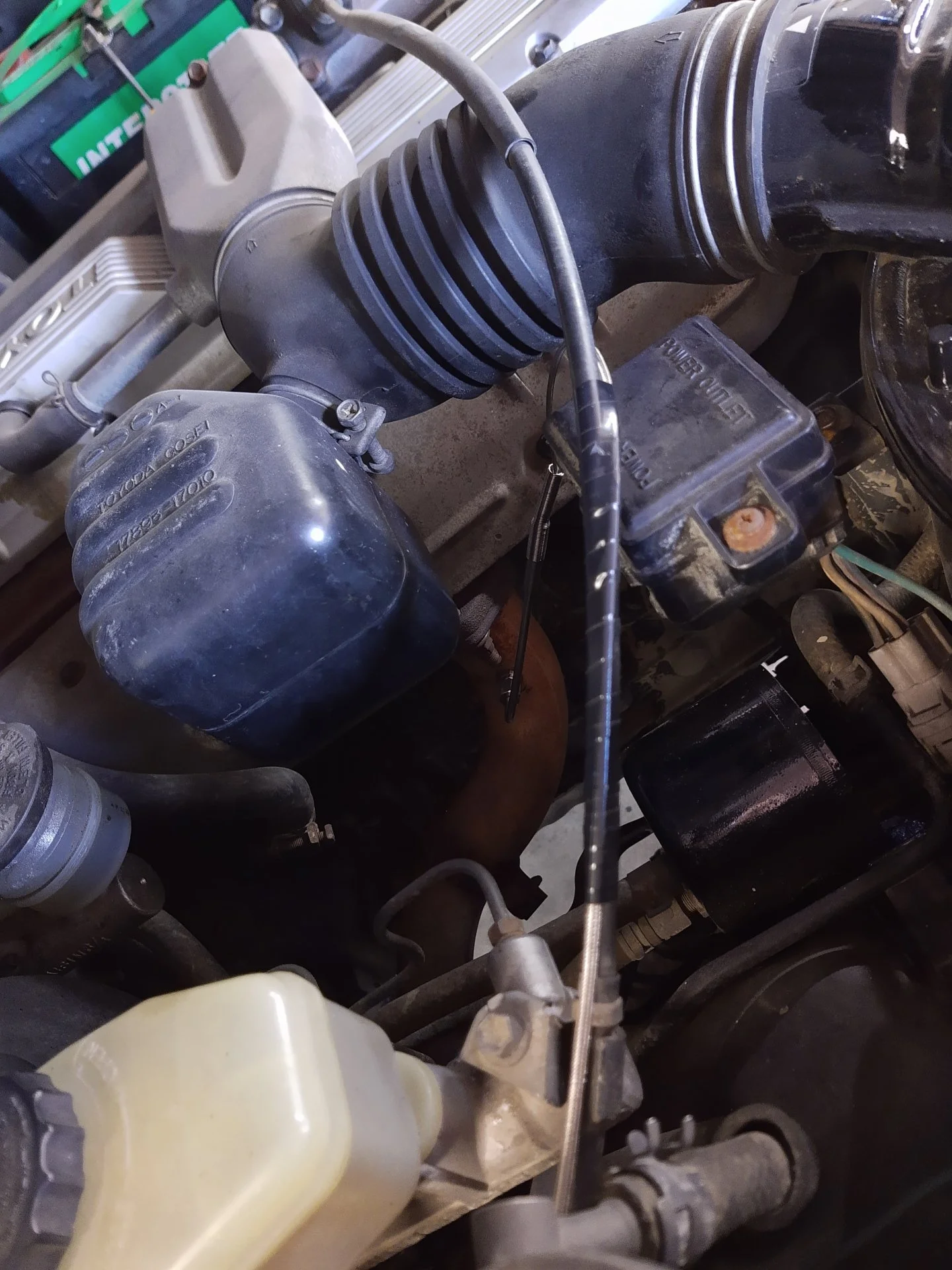

Well, rather than pussy foot around the rest of the summer, I've ordered new 23600-69055 injectors. I gave the pump a long hard look under strong light, and both anti-tamper measures are in place on the fuel screw. The truck only got 1000 kms in the six years before I bought it, according to the timing belt sticker. It starts extremely quick and smooth every time, cold or warm. Injector bodies have ND on them (original "looking"?) and the truck has 240k kms.
It idles smooth, runs fine, but under hard acceleration it sends a steady, thin line of black in most gears, more so on hills. I'm at 1100m, but I don't think that's enough of a factor to account for the unburnt fuel. My theory is that the spray is not atomizing, thus I'm dumping some of the fuel in the precup.

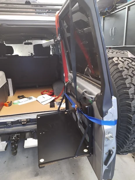

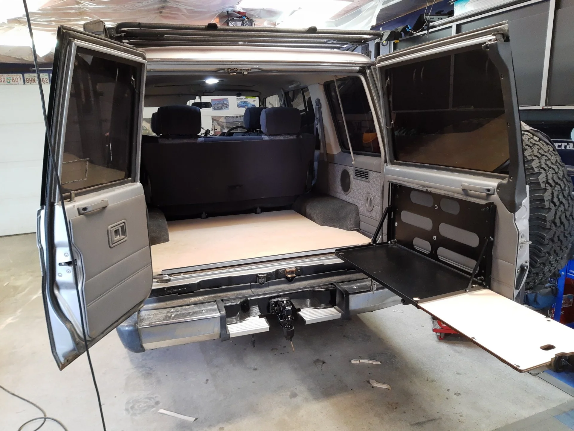

Meanwhile, on the other end, I began drop-down table install. Here it is strapped to the back door. I'll probably bolt it on though. The straps feel kinda... temporary? ;)

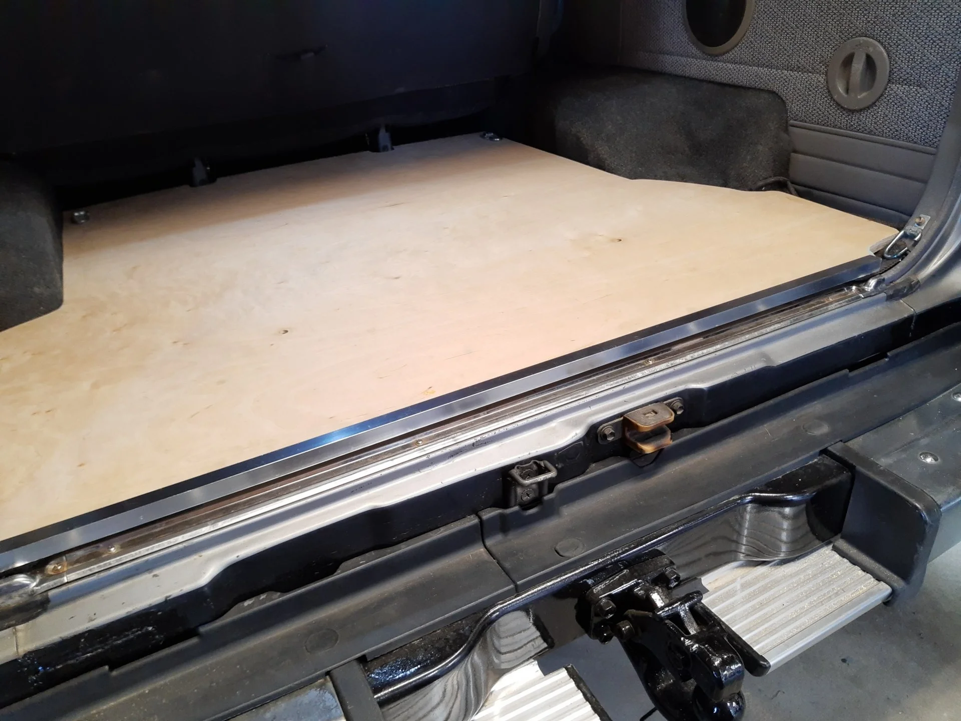

The goal in this phase is a floor base plate that I can use L-track on, bolt drawers to, etc.
That meant creating lots of sawdust.

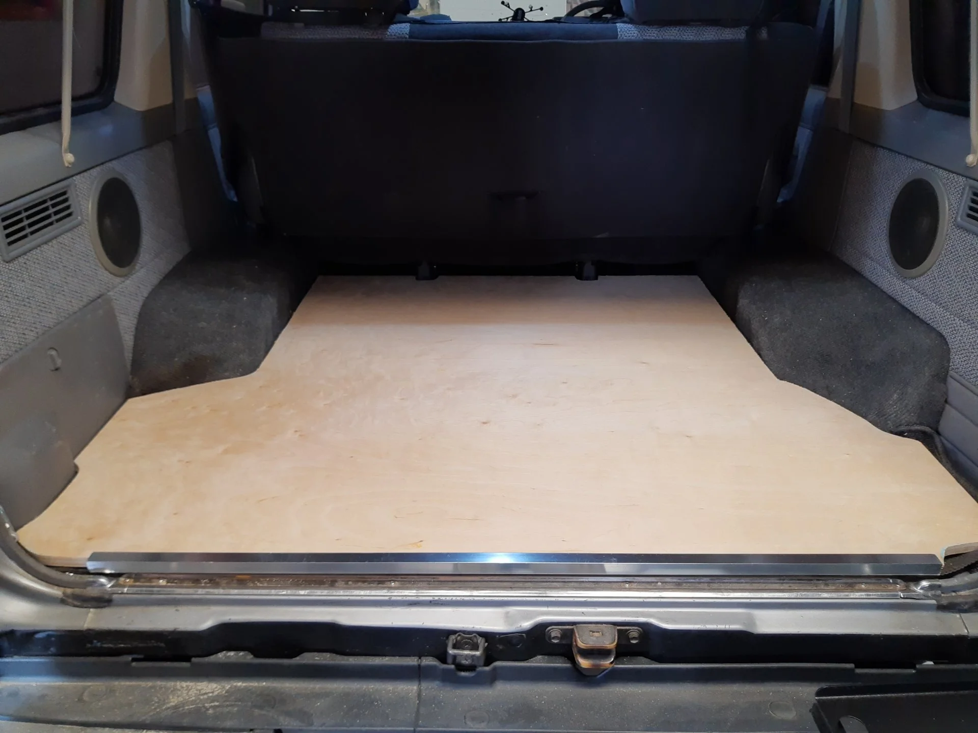

I had previously made a cardboard template, but yesterday was the day to actually trace/cut the plywood. Used 3/4 inch birch plywood.
Here's how it looks so far after about 25 test fitments...

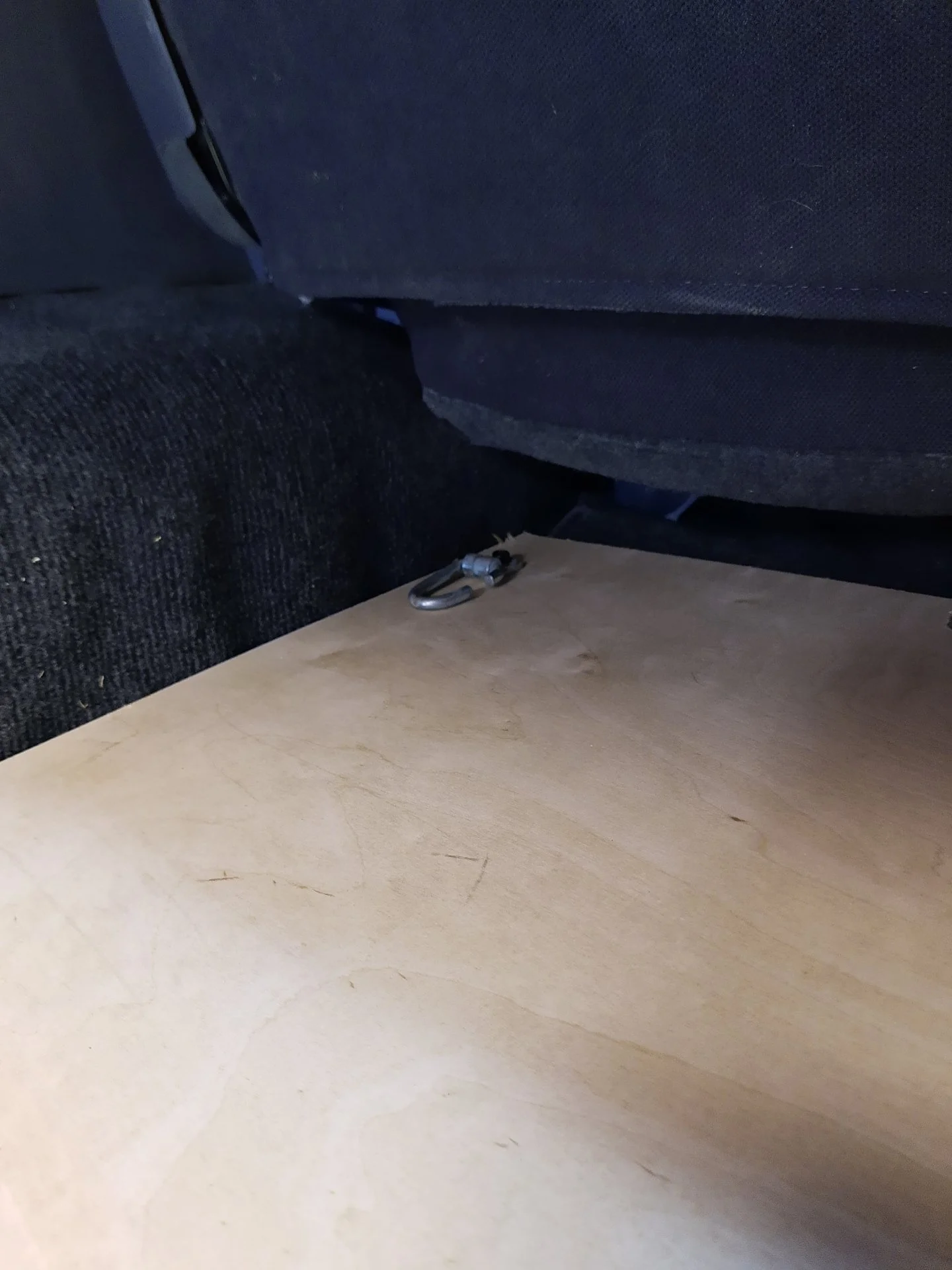

I'll use the hatch door hinge and front tie down bolt holes (with longer bolts) to bolt to the floor.

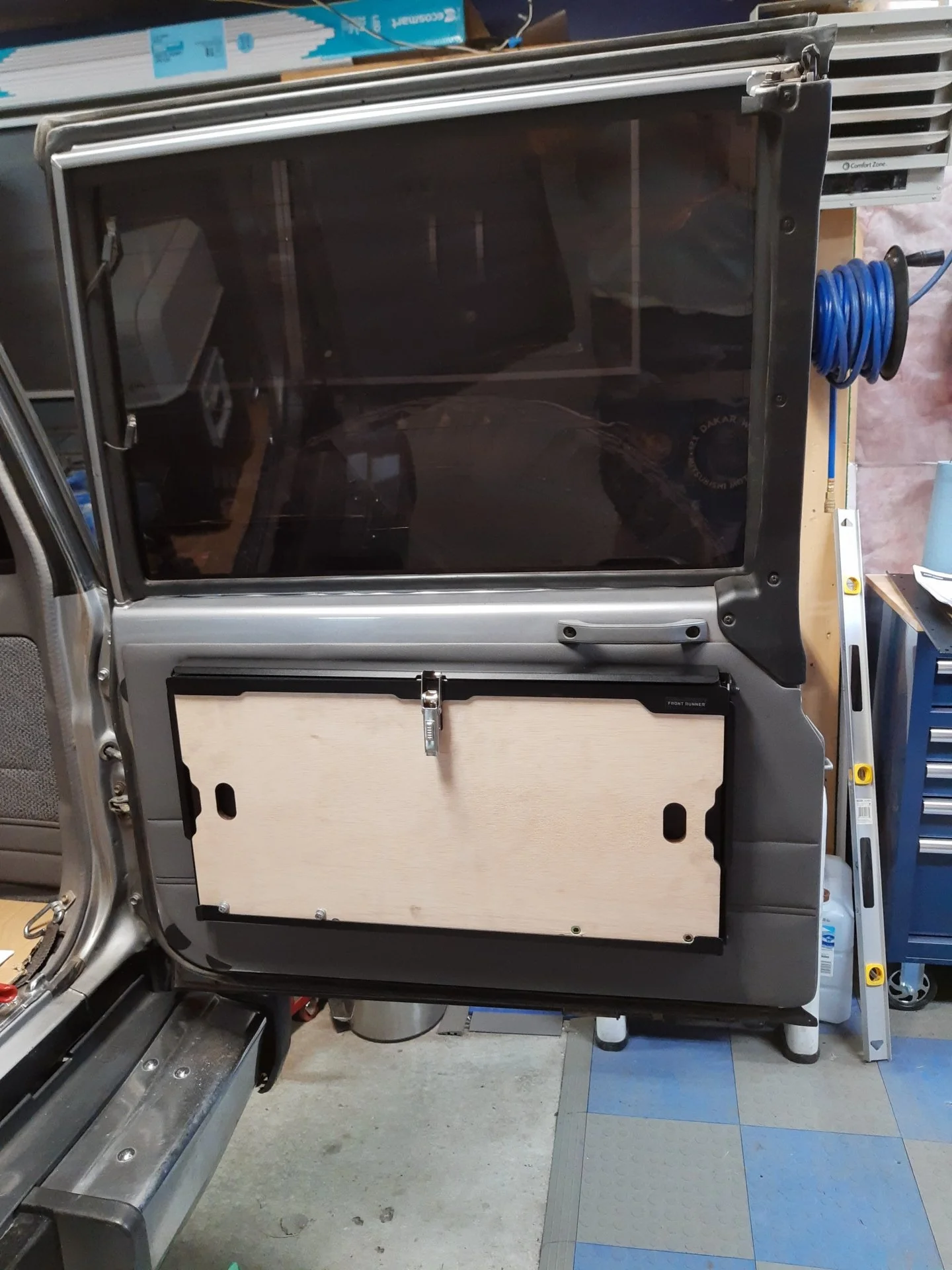

All buttoned down now. I got delayed finishing because my wife wanted a platform in her 100 series too 😂.
Here's the finished product.
I used aluminum angle on the exposed edge to keep the ply from delaminating as it wears.

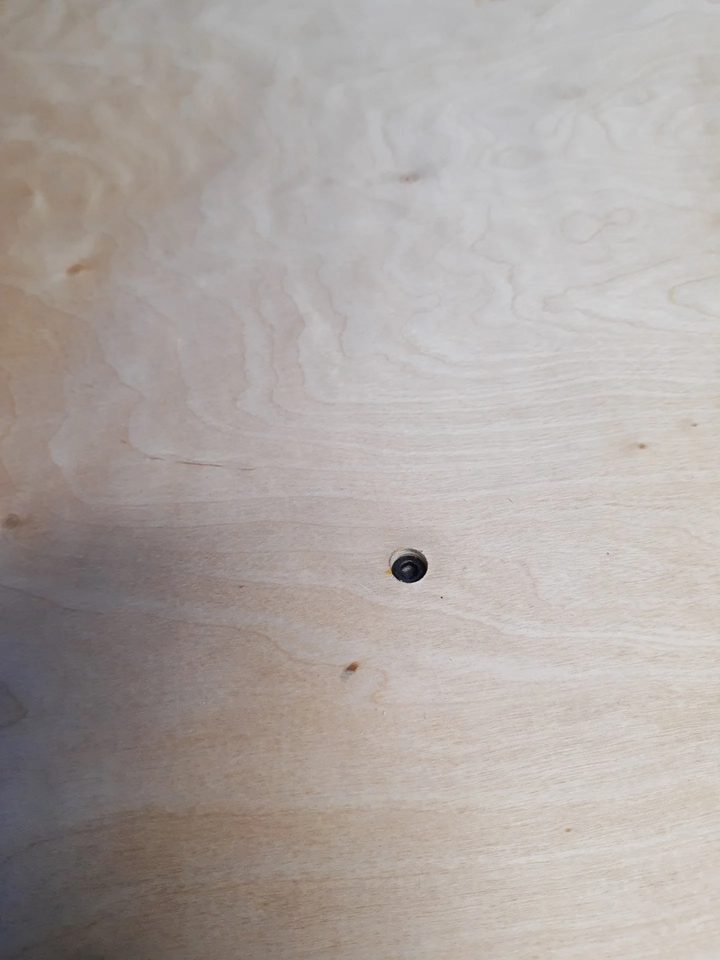

Here are close-ups of the tie down points:
Existing holes from wooden hatch cover... (Most useless picture ever)
And longer bolts on the forward tie downs...
I'll probably put some sort of stain, oil etc on there. But at least now I can bolt things down. I will probably fashion an angle bracket to bolt under each rear tie down to hold the back corners, just for redundancy. It is very solid as it sits.

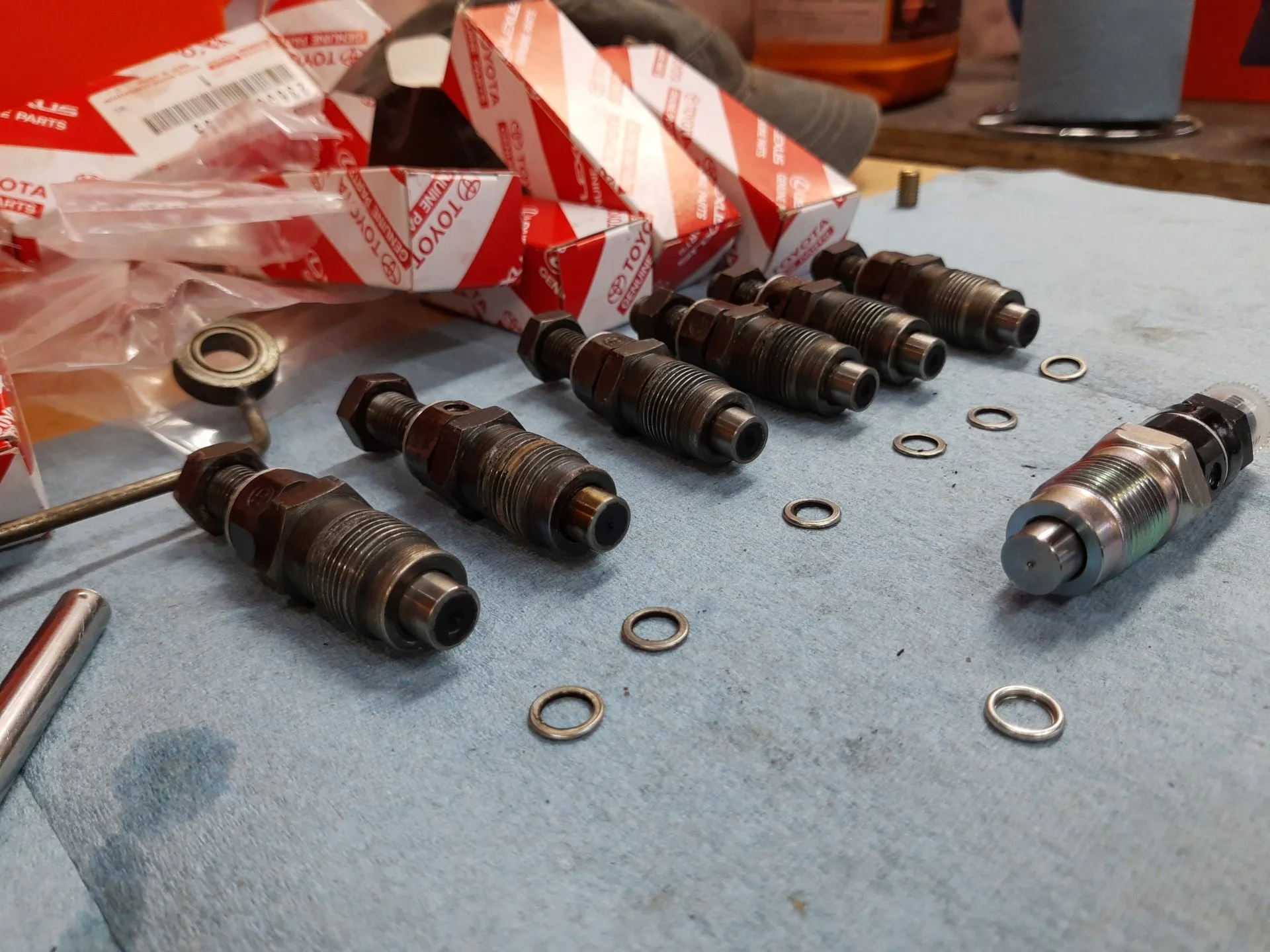

Just pulled the old injectors and crush washers. New ones are hand threaded in place for now.
I did manage to drop one new crush washer. 😏 The back one. Lol. 😚 Somehow blindly combing my frame, starter, and transmission area with my magnet coughed it up.

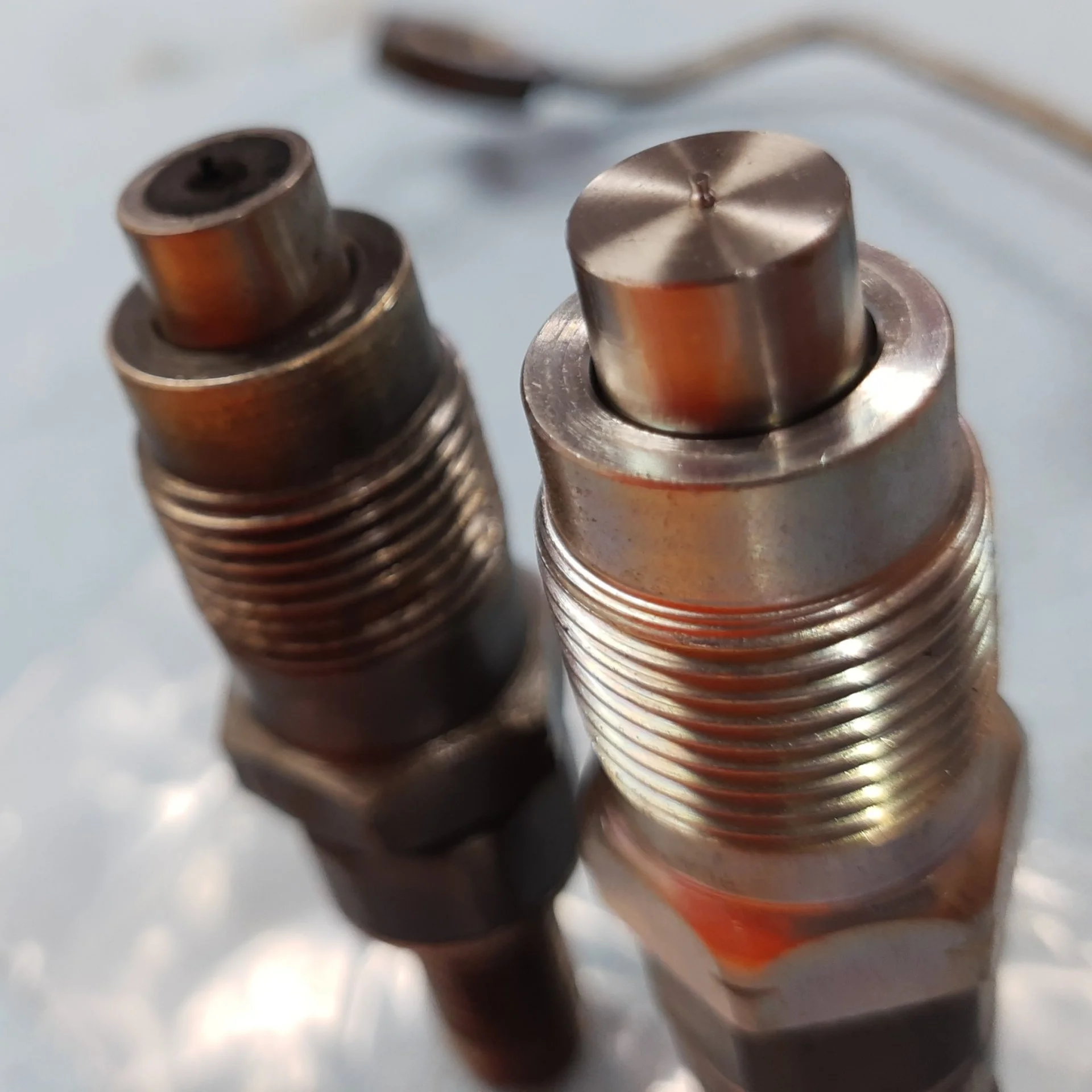

Here are a few shots of the old and new injectors.
Several of them were wet where the two lower parts met. Not sure how important that is, but clearly they all had a layer of soot on them, and the injector tips were slightly larger with buildup.
Tomorrow I'll torque them properly and put everything back together. Whether they were ever serviced or not is anyone's guess? But the bodies certainly appear original....
Got the new injectors torqued properly and all buttoned back up.
I was expecting to have to go through an elaborate bleed process. But nope! A few turns of the engine to prime the lines and it started right up, no smoke, smooth running.
So. It was test drive time...
Just got back. Huge difference. I can accelerate uphill. I can squeeze the throttle in 4th around town and not lay down a smoke screen. She's almost starting to lean towards peppy, for a large, heavy, solid axled, naturally aspirated diesel on 33s. Lol. Okay well, how about "not as sluggish"?
I can still get a thin line of smoke on the ground under WOT if I really try, but it is a lot better. And temp only got to 950° as compared to 1200 plus before injectors.
I'm gonna take it for my long commute tomorrow and get a better feel before I monkey with fuel, but so far... Injectors are worth every penny!
