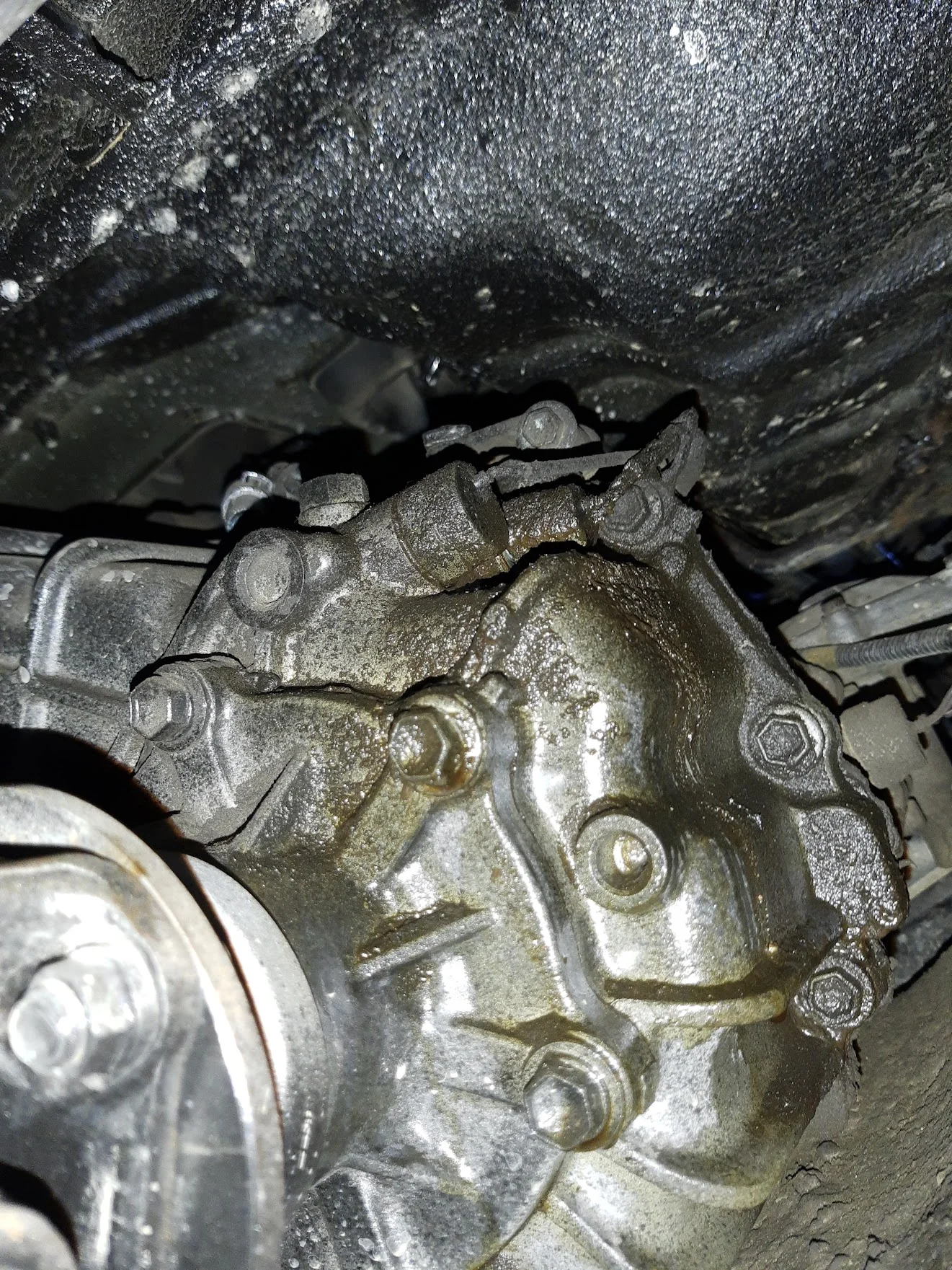

I've noticed a little oil underneath lately. A tiny drip from where the driveshaft meets the rear diff. But more difficult to pin down, a pretty good leak from the transfer case/Transmission.
Today I decided to do some poking around underneath, to see if I could narrow it down. This was what I started with.
I was pretty sure the source was one of the two sending unit/switchy things on the top. I checked the oil levels, and was getting ready to clean everything off and figure out which unit to order, when I happened to nudge one of the wires with my rag. The sender rotated! WTF? It was of course the back one, but with some creative application of my 17mm wrench, I was able to tighten it back up again, and then I did a very thorough degreasing of the whole area. We'll see if this was THE problem, but I'm guessing it was?

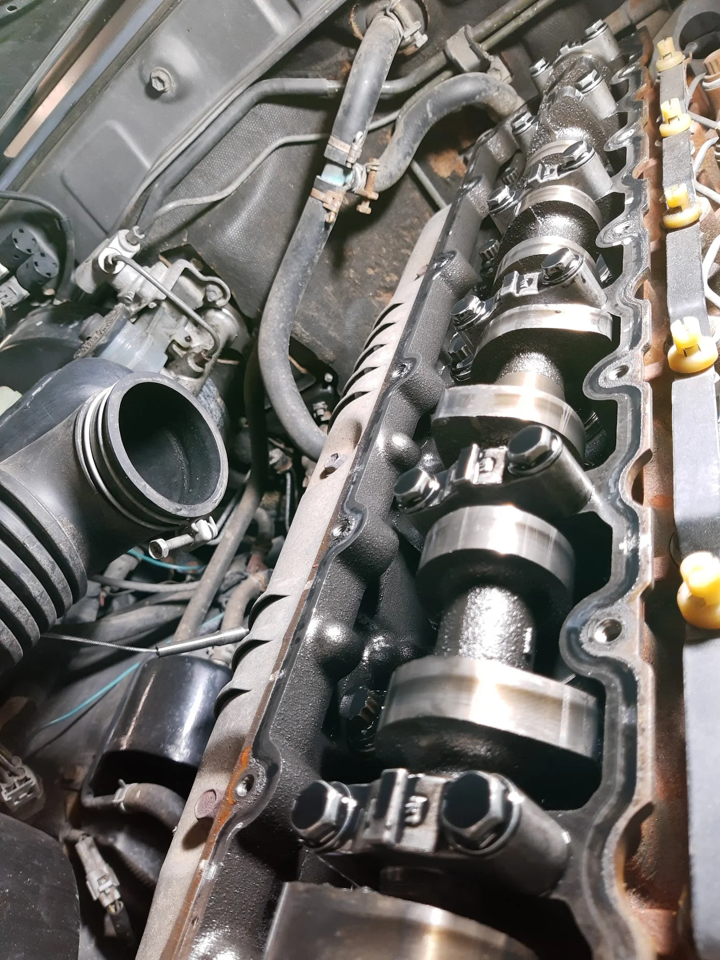

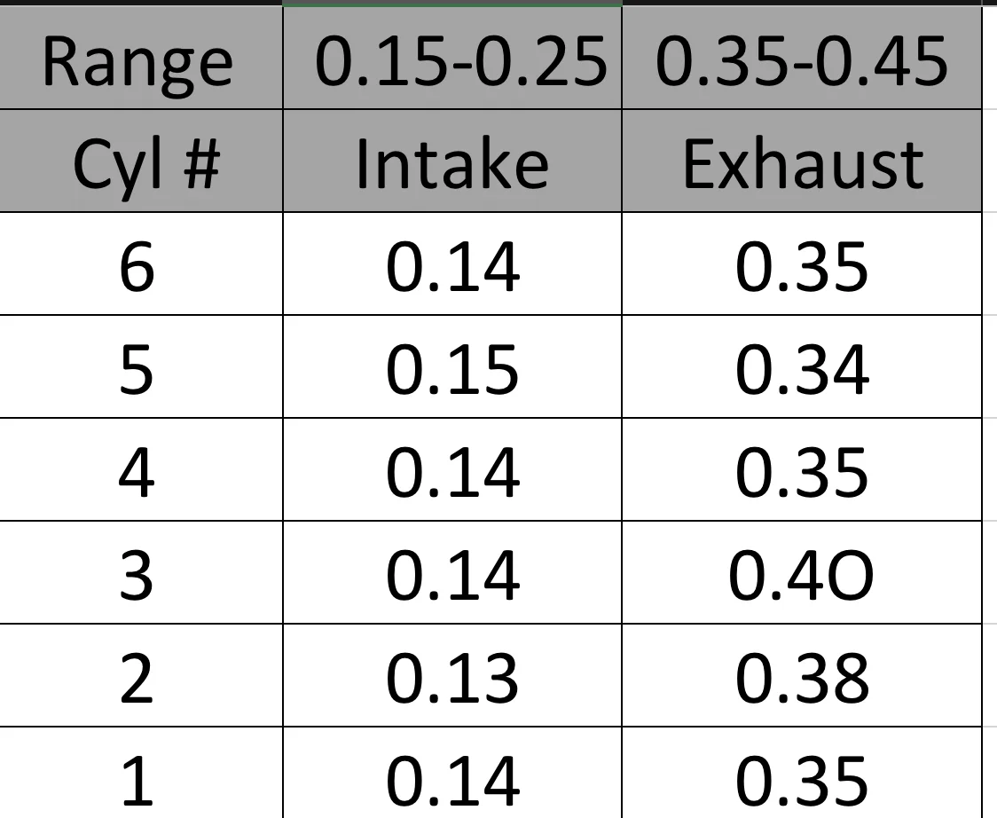

Trying to get some more of that pesky baselining done. Today I finally measured the valve clearances. Everything is pretty tight, but just at or below the minimum specs.
Not sure how much affect, if any, these clearances will have on performance? I am planning to get the SST and then I can measure the shims onboard. Yes, this is a tedious way to go about it, but I wanted to at least know if it was worth the effort first...

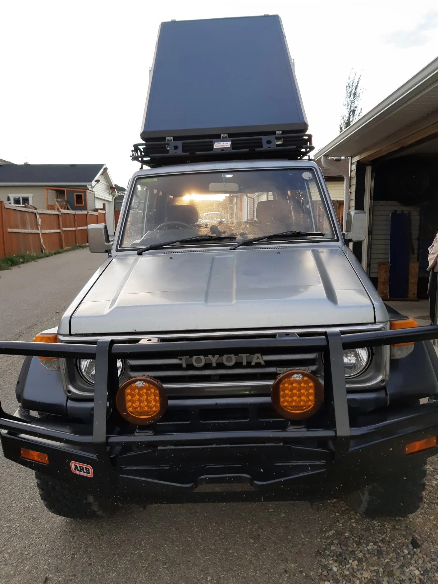

Annnnnd things continue to evolve for the old girl. GONE is the military trailer. GONE is the rooftop tent and annex! Sold em both on the weekend. New plans are afoot! More to come, but the idea is simpler, faster to set up, and lighter/more compact...
Some more progress tonight...

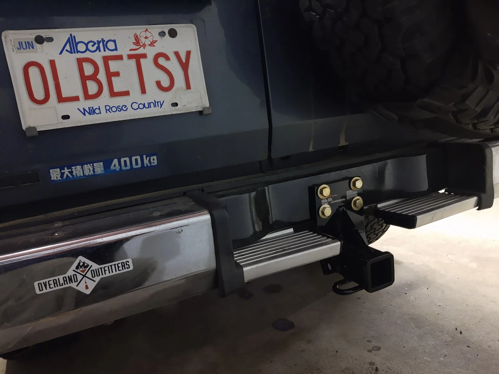

Unbolted the pintle/ball hitch that was on the rear crossmember, had to do some tapping of the holes, and then installed the CURT 13091 receiver in its place. It hangs down a bit, but in my experience with low hanging receivers, its like a mini fuel tank protector. LOL we'll see how it does.
Not a travel trailer type attachment obviously - just for my mountain bike carrier.

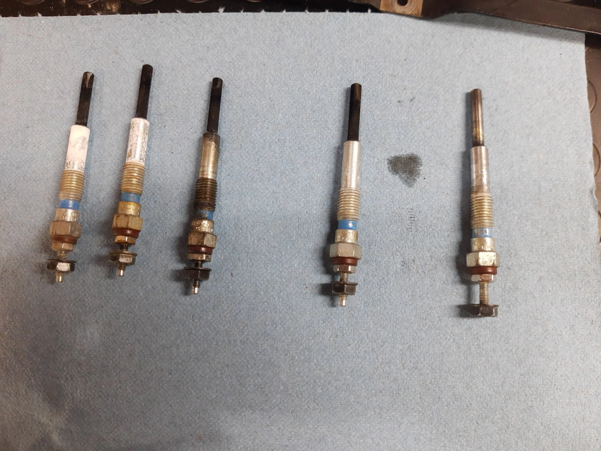

Also, figuring I had some air in the system, I pulled all six glowplugs, gave them a good cleaning up, and then cranked over the engine with the plugs out, in case any air remained in the lines or injectors themselves.
(obviously the one on the end was the first one to see some scotch brite attention... overall they cleaned up pretty good. 24v starting is the bomb!)
Anyways, after reinstalling the glows, and starting her up, after the obligatory black puff from the excess fuel I had just finished blowing out, there was no sign of white smoke, so I decided to take her for a test drive.
Sadly, its exactly as noisy as it has been. Power seems okay, black smoke isn't bad, but as soon as I breach 2000rpm or so under load it gets really loud, sort of a combo of a rattle and a tap? It doesn't seem to be exhaust, but I'm not convinced that my tight valve clearances (above) are enough to be the cause? Kind of rattly and loud at idle too... maybe its normal, but certainly not as quiet as other 1hz's I've heard. So... I dunno. Maybe I just turn up the radio?

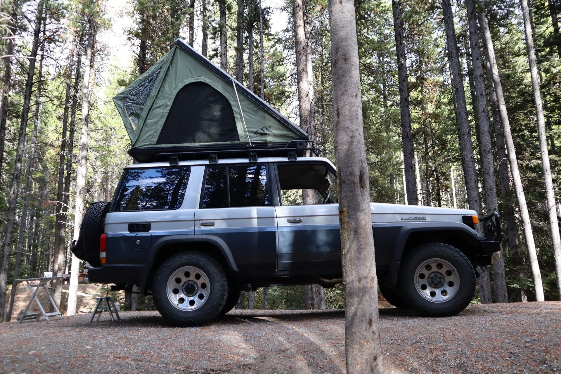

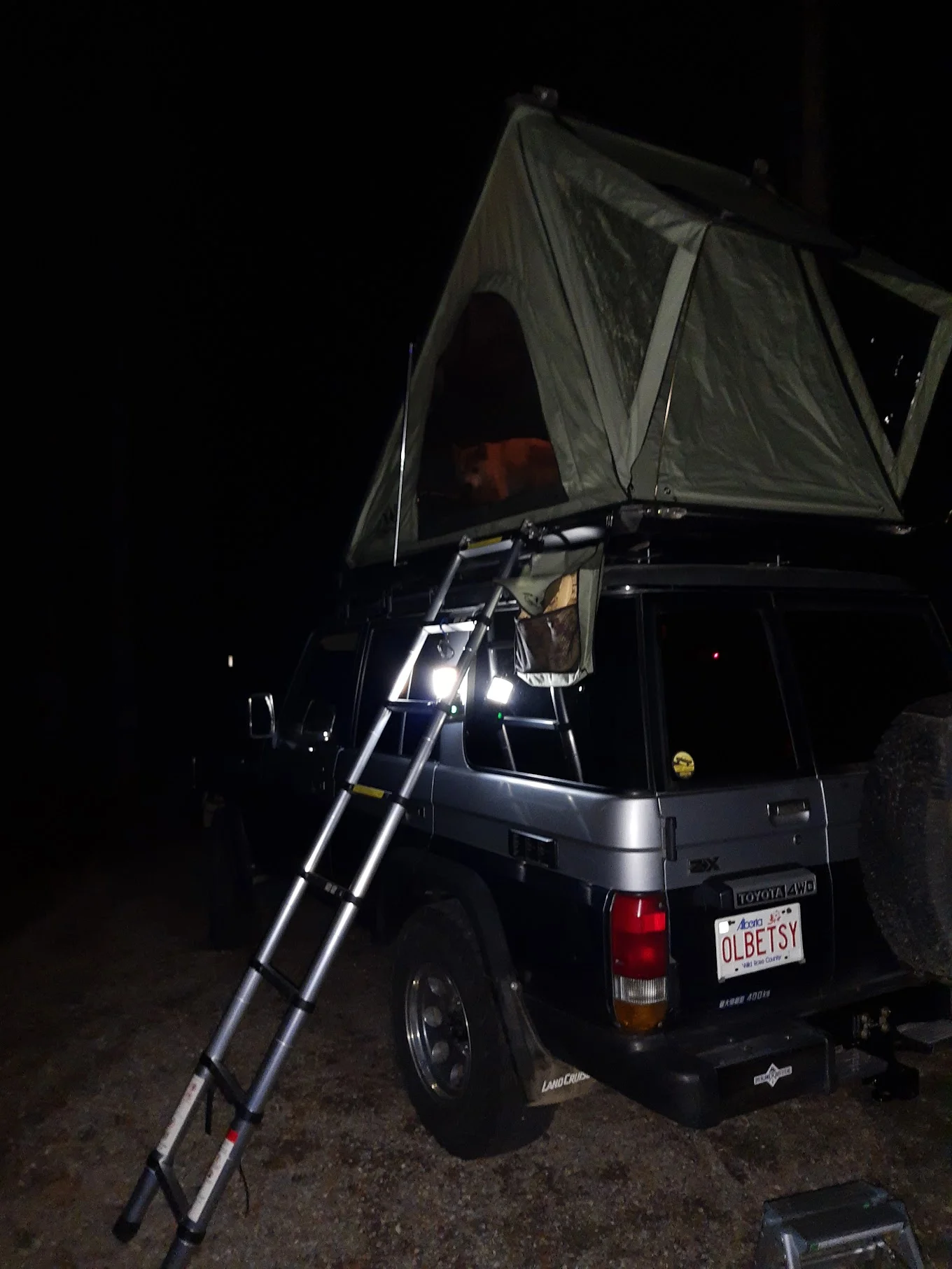

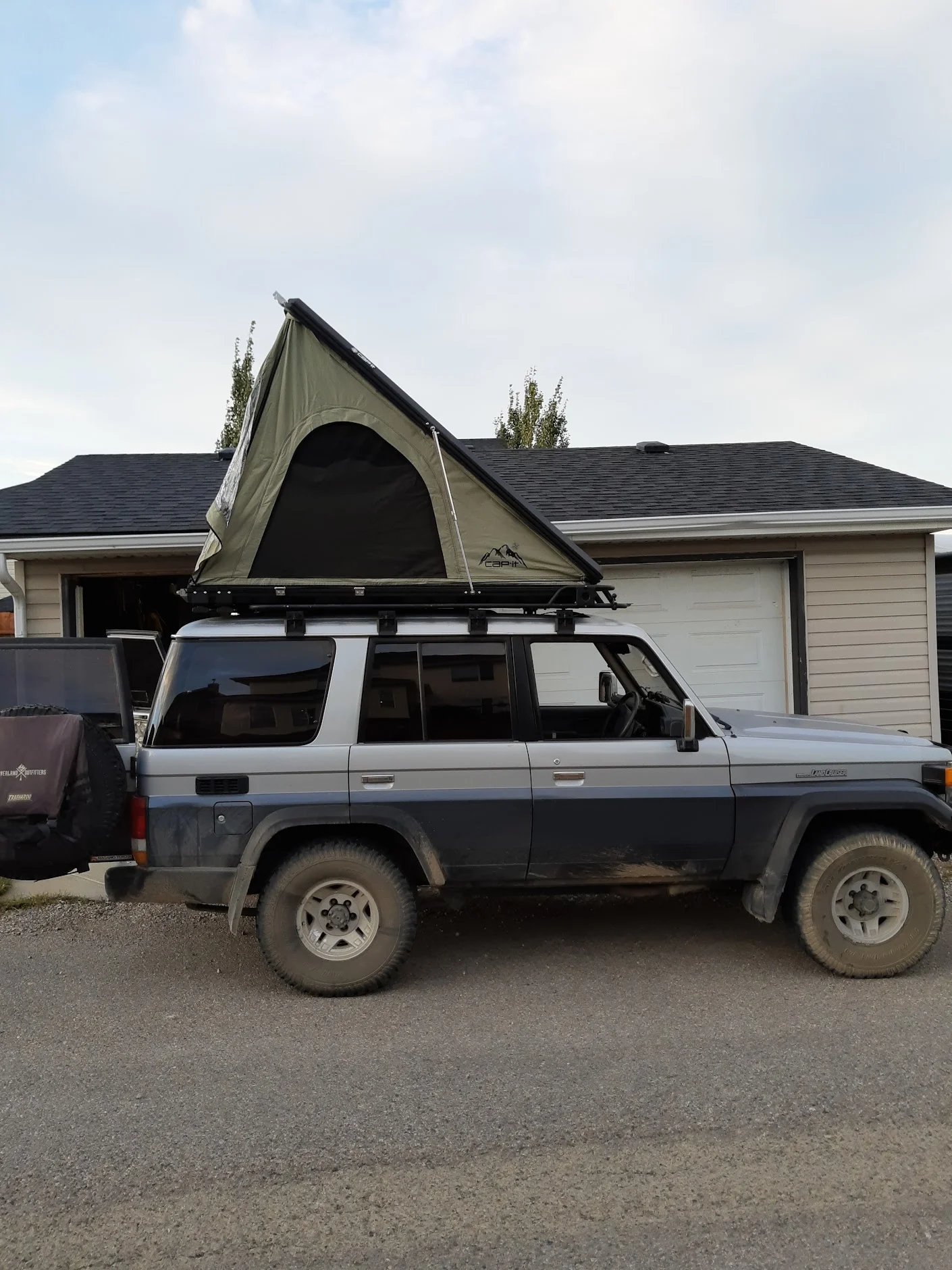

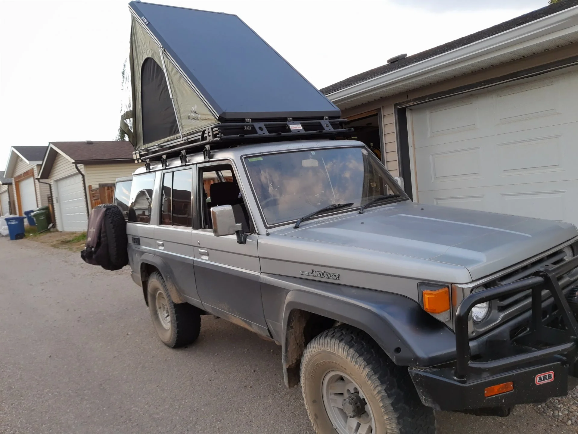

Today I was able to get the new setup set up!
My new tent is a wedge style, very similar to the Roofnest Falcon, but Canadian branded by a place in BC and Alberta called "Cap-It". Aluminum top and bottom, under 7 inch profile, deploys in under 30 seconds (for those more astute among you, yes, it STILL takes me 30 seconds to pitch a tent... bahahah).
As an aside this is my fifth RTT over the years, but this is the one I've been waiting for. I'm happy to report that I can actually drive in and out of my 84 1/4" door height garage!
No airing down needed, no unlatching the overhead door, no mounting it on a trailer... (all things I've had to do in the past). Its REALLY REALLY close, but it fits! It's barely above my platform roof rack's raised front section, and it comes with roofbars that slot into a keyway on the edges, so I can still carry things on top of the tent if I really want to. (They won't fit in the garage on top, so if you look carefully you can see them inverted at the back, UNDER the tent...)
Yes, it adds a little to the wind resistance, but won't have as much of an impact as towing my trailer with the RTT on top... And now I can go on those trips where there are switchbacks, and trailers aren't welcome...

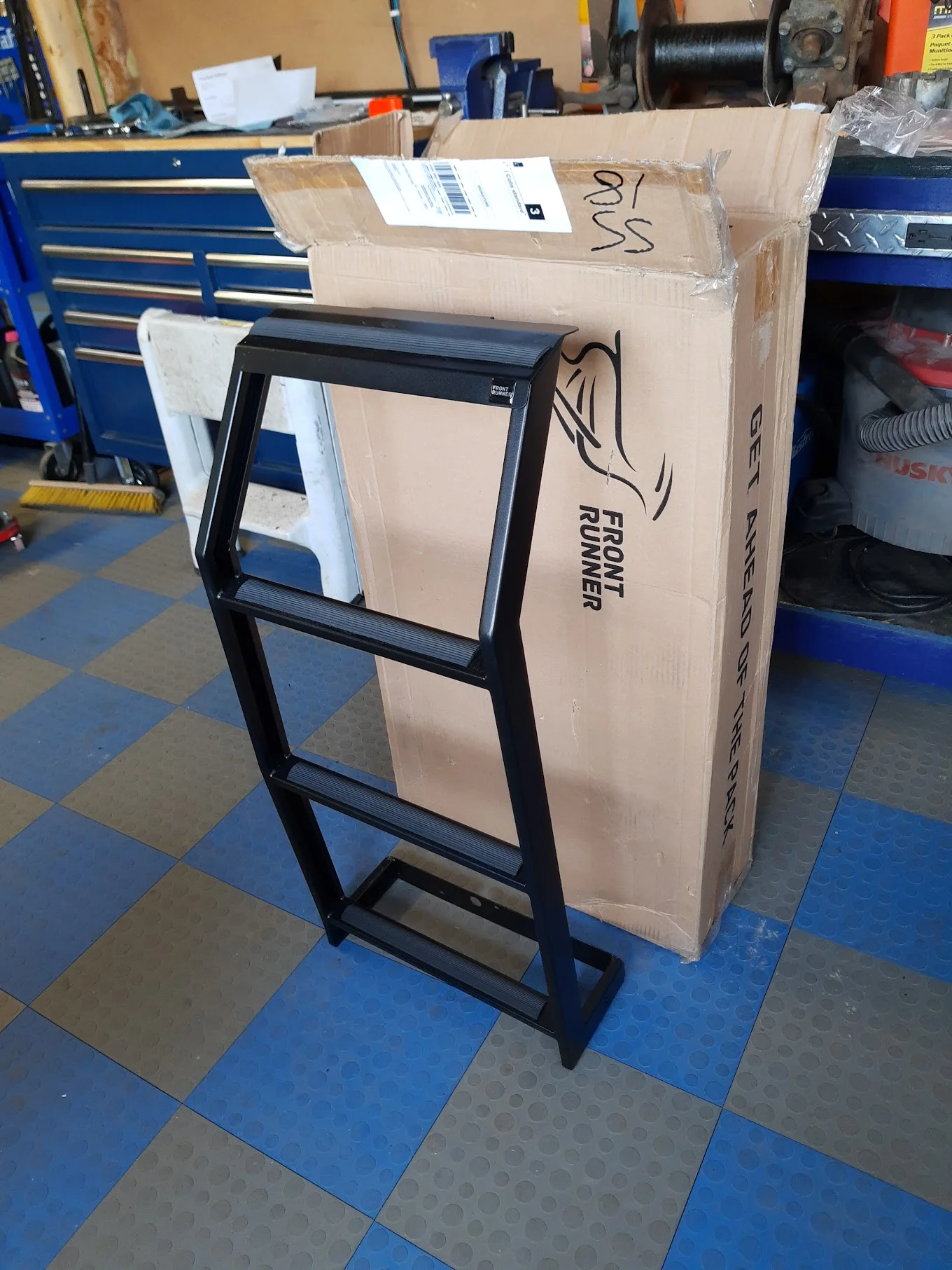

The ladder I alluded to above turned out to be the wrong one, despite me being very specific. I ended up with the troopy ladder, which obviously is too long, so the right one has been (re)ordered, and will be here in 3 weeks (or so). Once I have it on the back door, I won't even have to use the ladder that came with the tent.
Tried out new setup last weekend. Excellent so far. Pic in the pinned "what did you do" thread, above. Doubtless I'll have more pics soon...

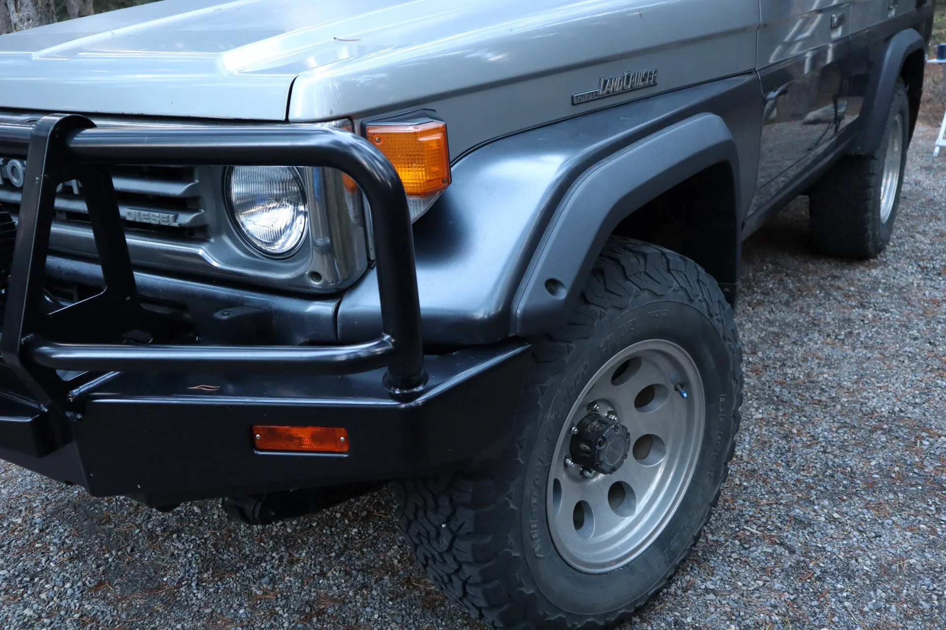

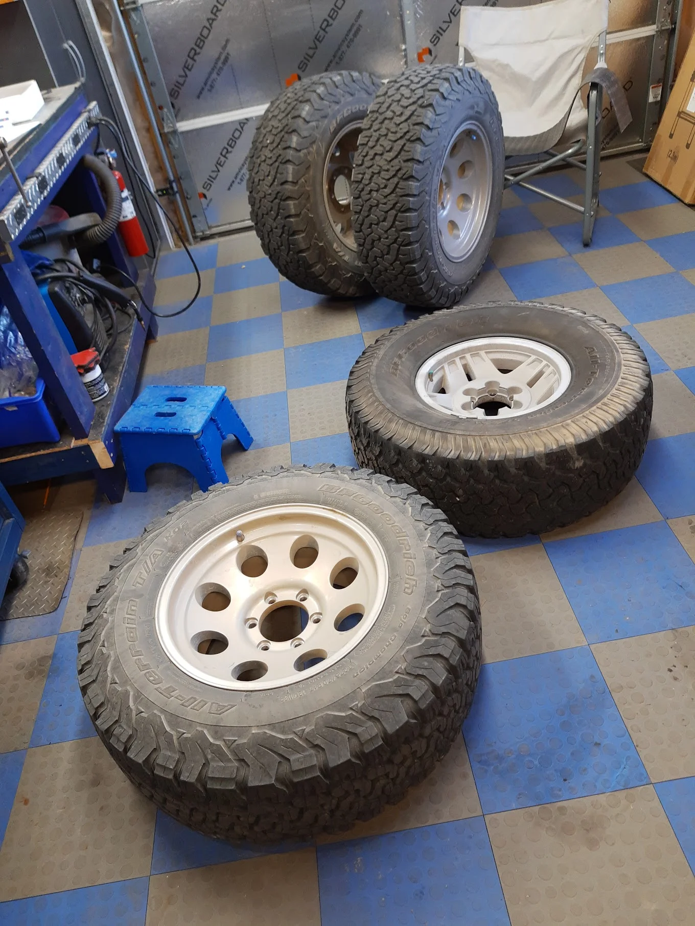

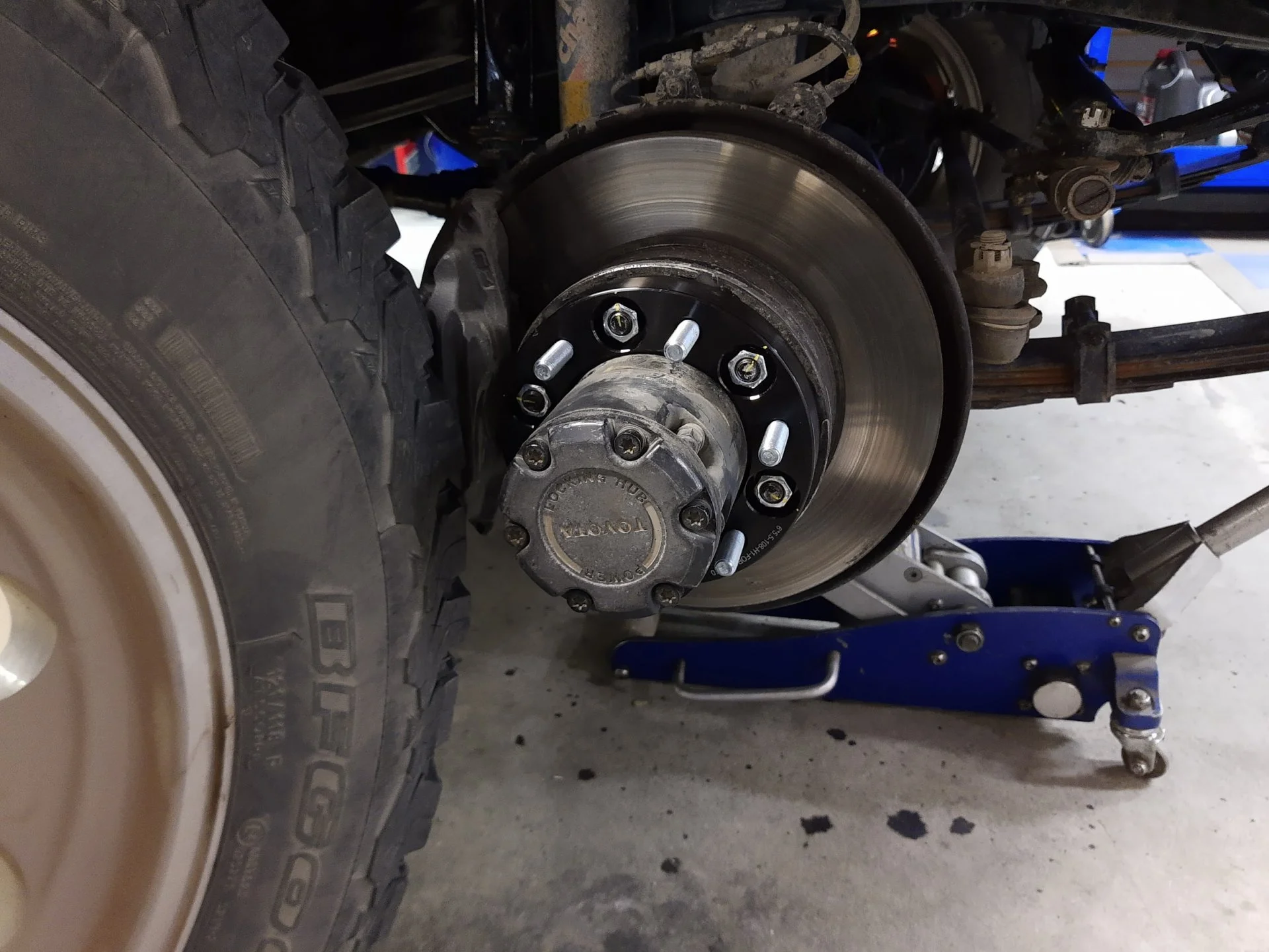

I feel I need to preface this next modification by saying I'm neither for nor against spacers. If they are necessary, and done properly, they have their place, IMHO. Eventually I plan to source some FJC steelies, so I figured spacers were an eventuality, and had resigned myself to my fate. But in the meantime, I have a set of wheels/tires here that I'm not using (they came on my Prado 90 but I've switched back to stock wheels for better fuel econ on the daily drive). The tires have maybe 20k on them, and are in excellent shape. The wheels are AR767's or something to that effect. Period correct I suppose, but not my first pick. They almost fit the 70, but for one obstacle. They are 9 inches wide. Yes, I know. Practically spherical! So at full lock, they came very close to TRE contact (on the OEM TRE's they actually did contact, but with the Terrain Tamer version, they didn't quite touch). Tires are BFG-AT's in 275-70-17 (32x10.8). Not quite my pick either, but getting close...
So, I got spacers. Little fellers, at 1 inch thick. Then I debated the loc-tite versus none, and the red vs blue, etc etc. Finally settled on loc-tite (RED), torqued, and then used my paint pen to mark an index on each bolt to check for movement, which I expect none of.
Fronts are now installed, torqued inside and out, and waiting for tomorrow for the rears. If I had a choice between spacers or the correct wheel spacing, then obviously I'd take the latter, but for what's easily available, nothing beats what is sitting on your garage floor. And if I settle for spacers, then 1 inch is only half as offensive as 2 inch, isn't it? 😂
They're dirty right now, but are actually a very nice polished finish, and only 2 years old, with 2 seasons on them.

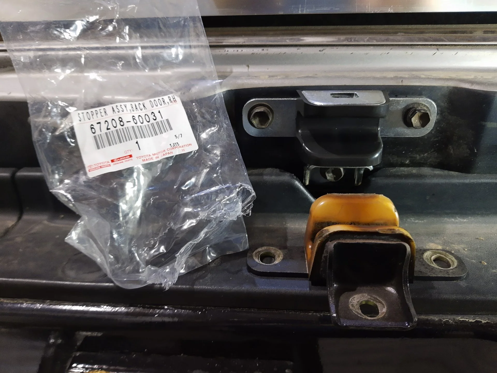

Tomorrow I tackle the rears, and then reveal the two new fancy SST (tools) that came with my door bumper!
Oh, one more update: Advanced my timing a little (again) while I was waiting for the goods to do it properly (that's a hint btw) and the thing ran like a scalded cat on the highway this weekend. An old unmotivated cat, with arthritis, but still: Big improvement over the sloth like performance I'm used to! Lower EGT, almost no black smoke. Hmmm... I could get used to this!
Nice work, and glad you used loctite for the spacers. Still double check the torque after 500km anyways just to be sure, especially if they are Aluminum. Those are nice wheels!
I also have been wrestling with the spacer idea, as my rear wheels are 3/4 inch in from the edge of the flare compared with the fronts. I would only do it with loctite if I do, and if I decide to at some point, then I will need to decide to just add them on the rears at 3/4 in thick, or go 1in on the front and 1 3/4 on the back to give it a slightly wider stance with my 4" lift. I might also wait until these tires wear out and I go with 10" wide tires next time (unless I get another crazy deal on 12.5's) :rolleyes:
Let me know how it goes with the spacers! And I love the tent, if I was ever to go with one, that would be my choice too. The low profile and durability of the hard shell is hard to beat. Definitely a great feature if you are on a continuous journey with nightly stopovers... 👍
Thanks Darren. They actually suit the rig pretty well.
Here they are in dusty trim...
So obviously I took them to work today, and my students watched me torque the wheels at recess time (guess they were bored? :) ) So far all good. No new vibes (actually less vibes than on those 33-12.50s on R15's). Actual size measured out to be exactly the same in diameter, and a little narrower, with a much flatter sidewall. But the combo is heavier. Probably a wash when you consider the friction generated by 1250s, esp on those too-small wheels.
In any event, handling seems a little crisper, and the ride is about the same, since I could run them a little softer than the ones I took off, (less sidewall + less pressure = zero sum gain/loss? Probably).

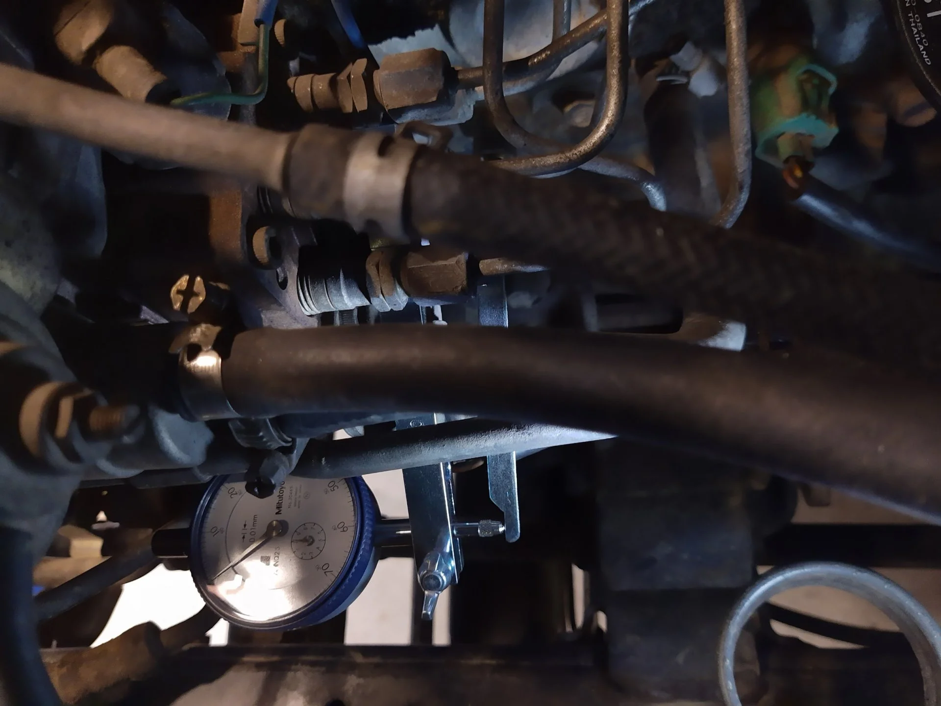

My injection pump SST came recently, so it was time to set the pump to factory spec...
09275-54011 was mated to my Mitutoyo dial indicator.
Found TDC. Backed it up to calibrate zero, then forwarded to TDC again. Reset to 1.09mm, then realized I hadn't defeated the ACSD. For that matter, I didn't realize I even had it. Not sure it works. More on that later...
Jammed the ACSD open as per the FSM (they didn't exactly use the word jammed, but that was the gist of it) then went through the whole process again to set it at 1.09mm.
Really is a pain figuring out how to get the contraption in there, so I can't imagine trying to do it without the SST!
Then it was off to K-country for the weekend.
The drive up was not that pleasant, owing to a wicked wind gust that kept pushing me, mostly front on... But it was nicer down in the valley. Gave me a good chance to test the wheel/tire setup, as well as gauge the pump reset. Handling seems a touch more predictable with 17s, less sidewall, and better tire/wheel compatibility. Plus these tires are relatively new compared to the ones I took off. Fit the wheel wells nicely too, so overall I'd call this a win.
The pump settting? Hmmm. I felt like it was slightly down on power from my previous timing advancement (which I didn't measure properly before I changed it, due to the ACSD dabacle). If I had to judge the setting based on fun, my previous, advanced state felt a lot better. I may have to look into what is a safe level of advancement, (if there is one), since I'm at the factory upper end. Hmmm...
Finally, this morning brought with it a new issue. Smoky start. But not just for the first 5 seconds. Nope. A white heavy haze that followed me all the way out of the park, a good 7 minutes of easy driving. Quite embarrassing. Yes, I will check the glowplugs, and yes it was 5* celsius this morning, but I did do two glow cycles, and this smoke hung around and persisted for longer than necessary LOL. Once I got to the road proper, it was gone within a minute, and didn't return. Also, next to NO black smoke on the way home, whether I was climbing steep mountain grades, or accelerating. Virtually none.
So. Likely my ACSD is non-functional. Possibly glow plugs are past their sell by date. Easily sorted. Could timing adjustment have any play in this embarrassing mosquito fogging? No idea...
