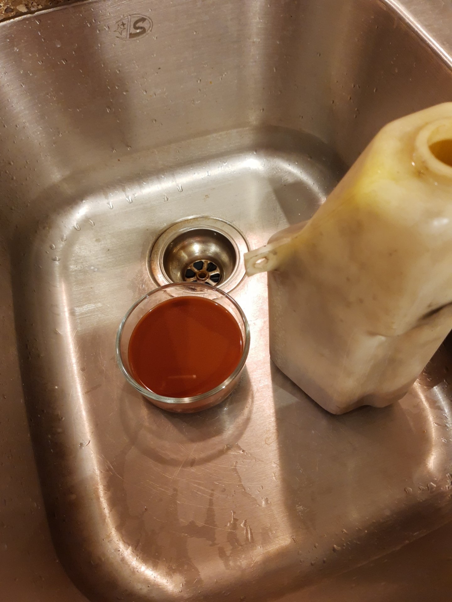

Today was the start of my truck's cleanse. LOL. I refilled the empty cooling system with water and Thermocure. I have many friends who've used this with good success, and although my system didn't look *that* bad, there was a disturbing amount of rust at the bottom of my overflow jug.
(Of course that's not the kitchen sink. Don't be silly... 🙈)
I hope the first few pages of this build proved my dedication to rust eradication? I don't want it in my water jacket either...
The extension and sealed funnel allowed me to add the water and Thermocure then run the engine up to OT to get all the air bubbles out.
Now it's a matter of letting the elixir do its work. I'm going to leave it in there for 4 days or so, to maximize the benefits, while I drive the truck to allow lots of circulation. Then I'll flush it again with water as many times as necessary before refilling with 50/50 HOAT coolant. Before the final fill I'll also replace upper and lower rad hoses, and thermostat and rad cap, for good measure.

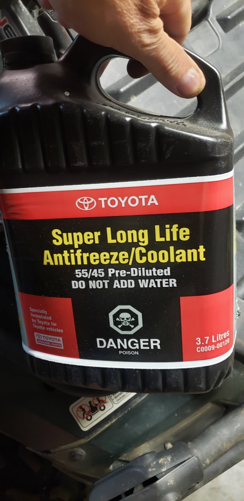

In case you have not already picked up the long life toyota coolant, the best price I found was from Sherwood Park Toyota, and they carry the 55/45 that is good to -42C for $19.04/gallon. You will need 3 gallons. Go HERE

So it's back to the cooling system. Time to drain the Thermocure. The first flush yesterday yielded a black liquid, as expected. Second drain (after letting it run for a while) was slightly lighter - let's call it dark gray? This morning's drain was medium gray. So we are getting there.
Also took the opportunity to replace upper and lower rad hoses, and the stat, gasket, and cap. The existing thermostat looked like it could be a recent replacement but I had it apart at that point so may as well replace it?
Time to go and do another flush. I'll be using water until it runs clear. Then a flush with some distilled water, and finally "pink gold". I suppose that's called "rose gold" nowadays? 🤣
