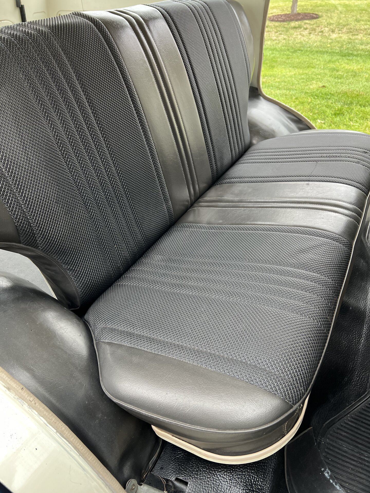

Back seat and latches placed!
Hope to move on to door cards this week.

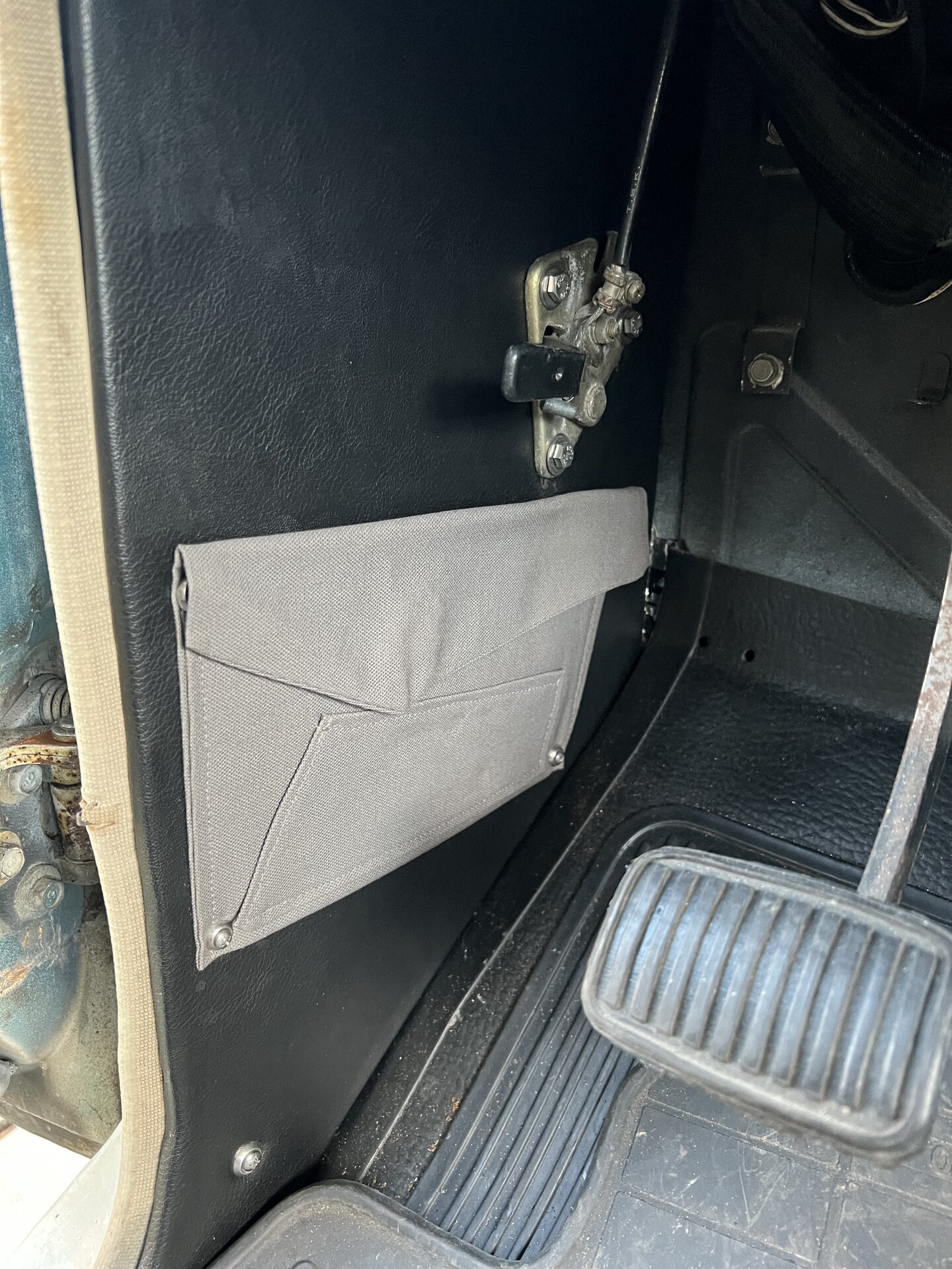

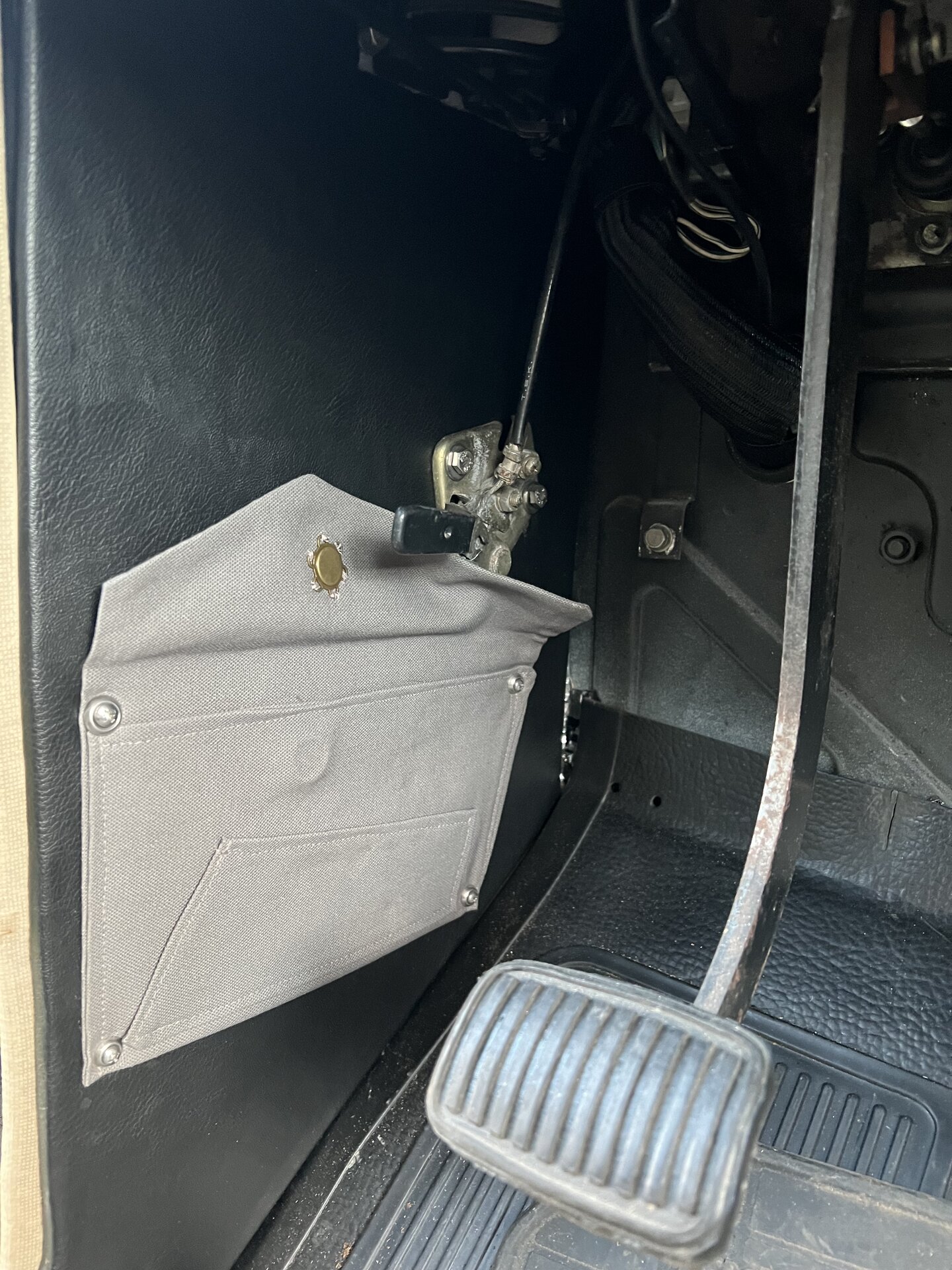

Kick panels went in over the weekend.
Hood latch was a bigger problem that is should have been.
For some reason measurements were off 3/4”, but, got it figured out.

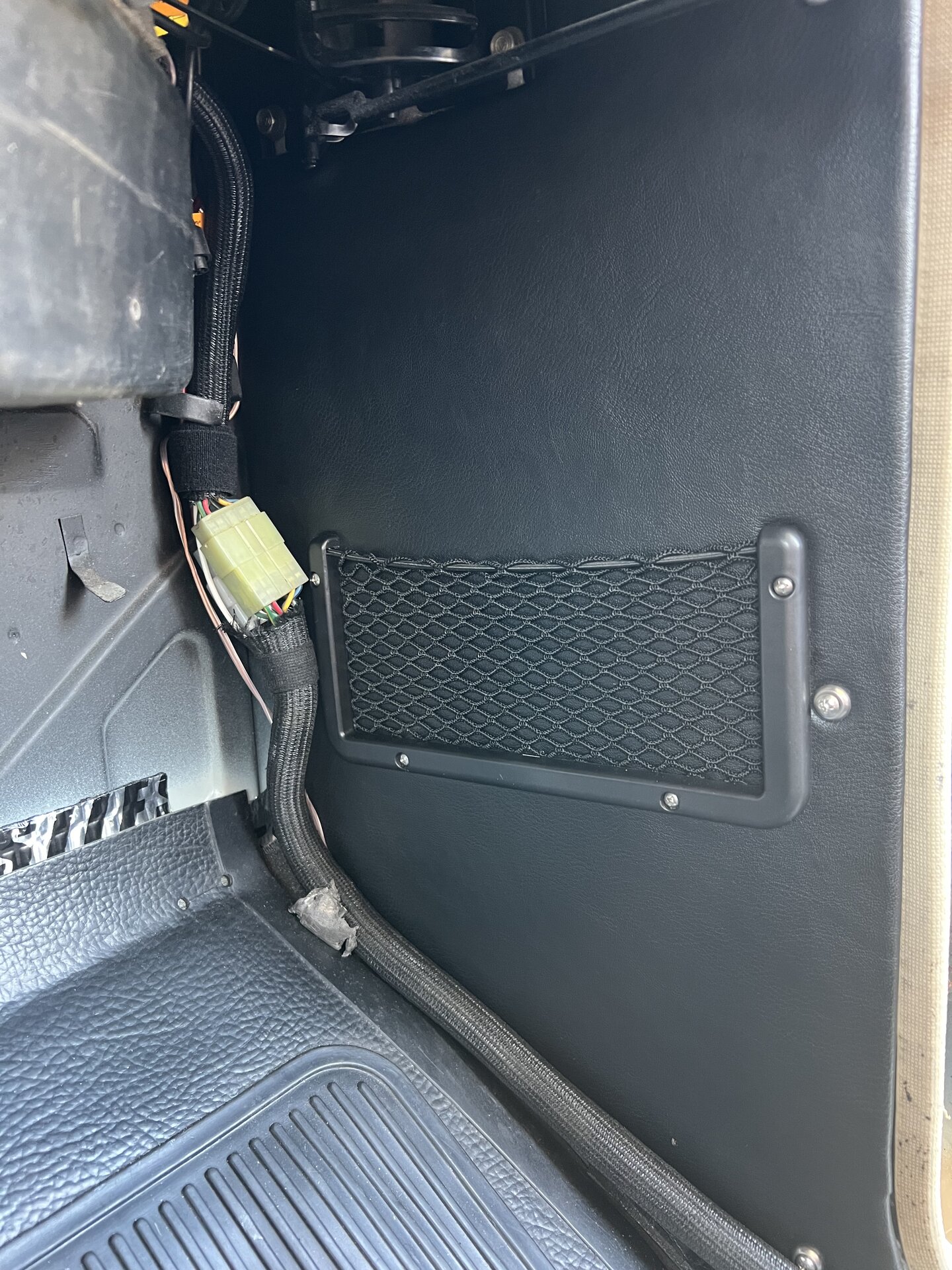

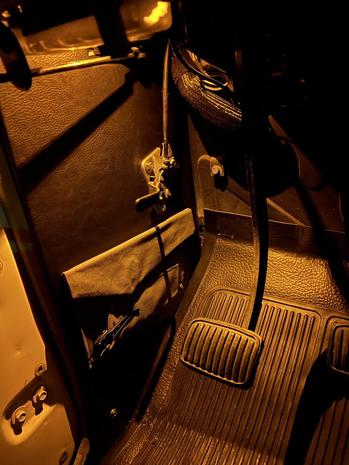

Elastic netting on one side and a home made pocket for the driver side with built in sheath.
Very nice, source on the net piece?
@Ol Yeller Sourced from
Amazon product ASIN B0BK951DHL
I purchased 2 sizes.
Small for the kick panels
And a larger one for the rear cargo cards (yet to be installed)

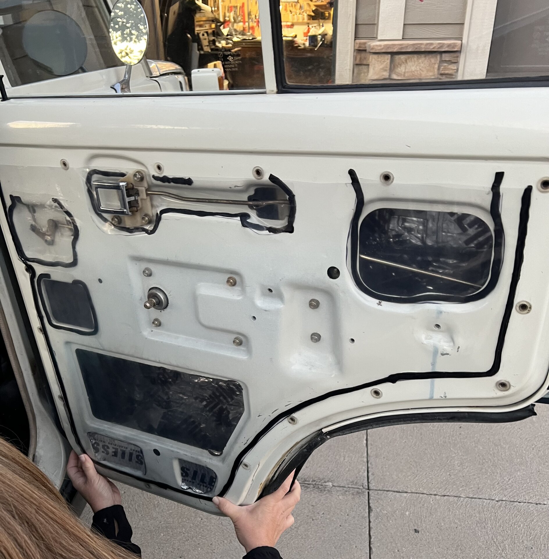

In case others are interested, vapor barrier material, used 8 mil.
Butyl tape.
I actually cut this in half to have narrow pieces of butyl, worked well.

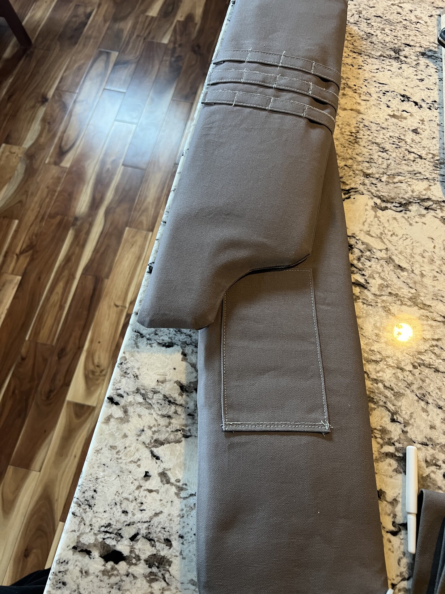

Quick update on rear cargo cards.
Was finally able to add a cargo net and the fuel cover.
Added some large washer to the back, just in case someone pulls a little hard.
All attached with stainless hardware.
Don’t mind the wrinkles in the waxed cotton, they will go away with a little heat.
Vapor barrier is cut, vent is cut out, now need to determine where the lights and tie-downs go.
Been working on dedicated lighting solution as well. It will be mounted to the other card.
More to come on that.
