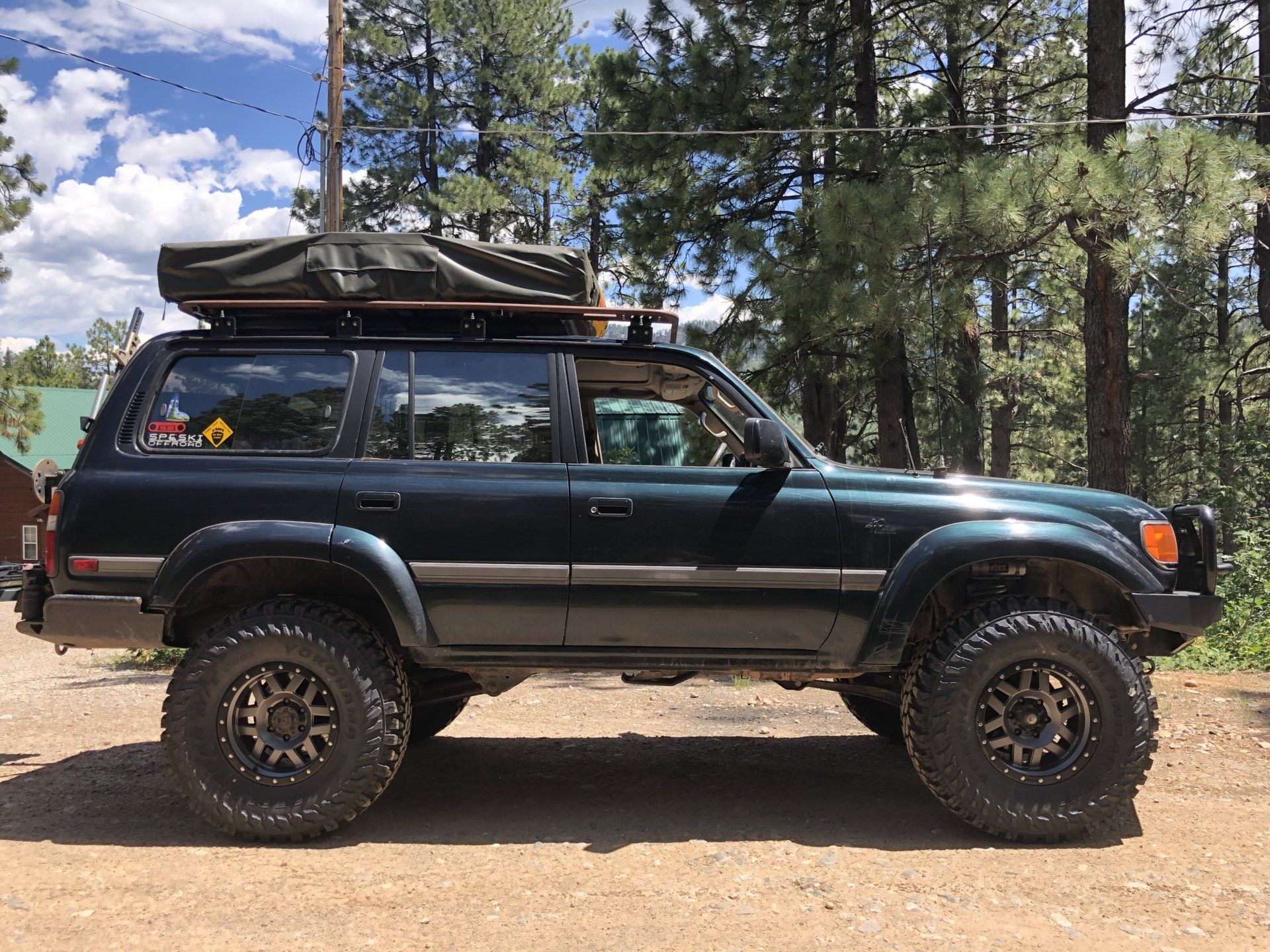

Finally got far enough along I felt like I could put a pic up. 37x13.50 Toyo M/T's... =) Project Evergreen Part 1 – Introduction – Evergreen Adventures

what type of tent setup is that? i really like it!
Year - 1997
Lift - 4” Slee, Heavies
Shocks - Slee/ADS
Bumpstops - font - rear - Timbren
Body Lift - none
Trimming - rear flares small triangle behind wheel
Tires- Yokohama MT 37x12.5 G003
Wheels - KMC Machete 17x9 -12mm offset
Spacers - none
Front axle relocated 1” forward using Redline’s kit. Landtank extended rear LCA
