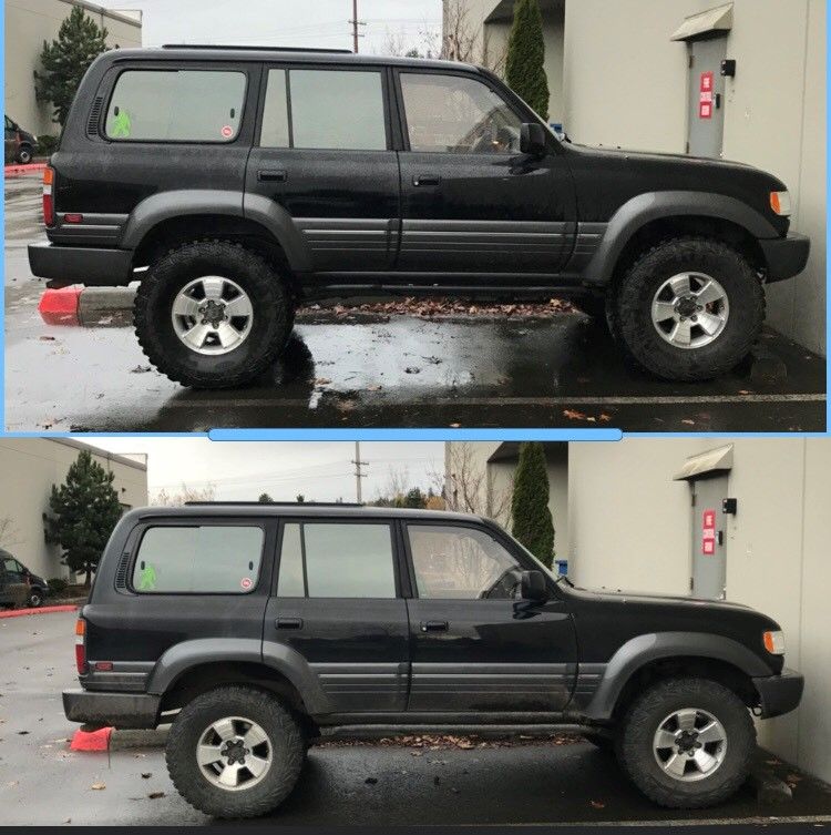

Welp, I did it... Not sure if I should have, but I couldn't say no to a great deal. 4 - 37x12.5r17 Goodyear MT/r's slightly used $750. They sure fill in a lot better then the 35's. Small amount of rubbing in the front end when turning, which I expected. I'm going to put in some 30mm spacers in hopes that it will help with my current stink bug and fixes the slight rub.

Pardon my ignorance... what wheels are using? I currently have 37's on 16" Fj60 steelies. I want to go to a 17" wheel, so I have more options. Thanks!
Those are Tacoma/4Runner wheels, 17”x7.5”. You can usually find them as take offs on Craigslist.

They are Tacoma rims i picked for $20 off craigslist. They work for now but i need wheel spacers to help with rubbing so i wouldn't recommend. i plan on replacing with steel Unique 297 17X9 6-139.70 from Discount tire. They run about $86
