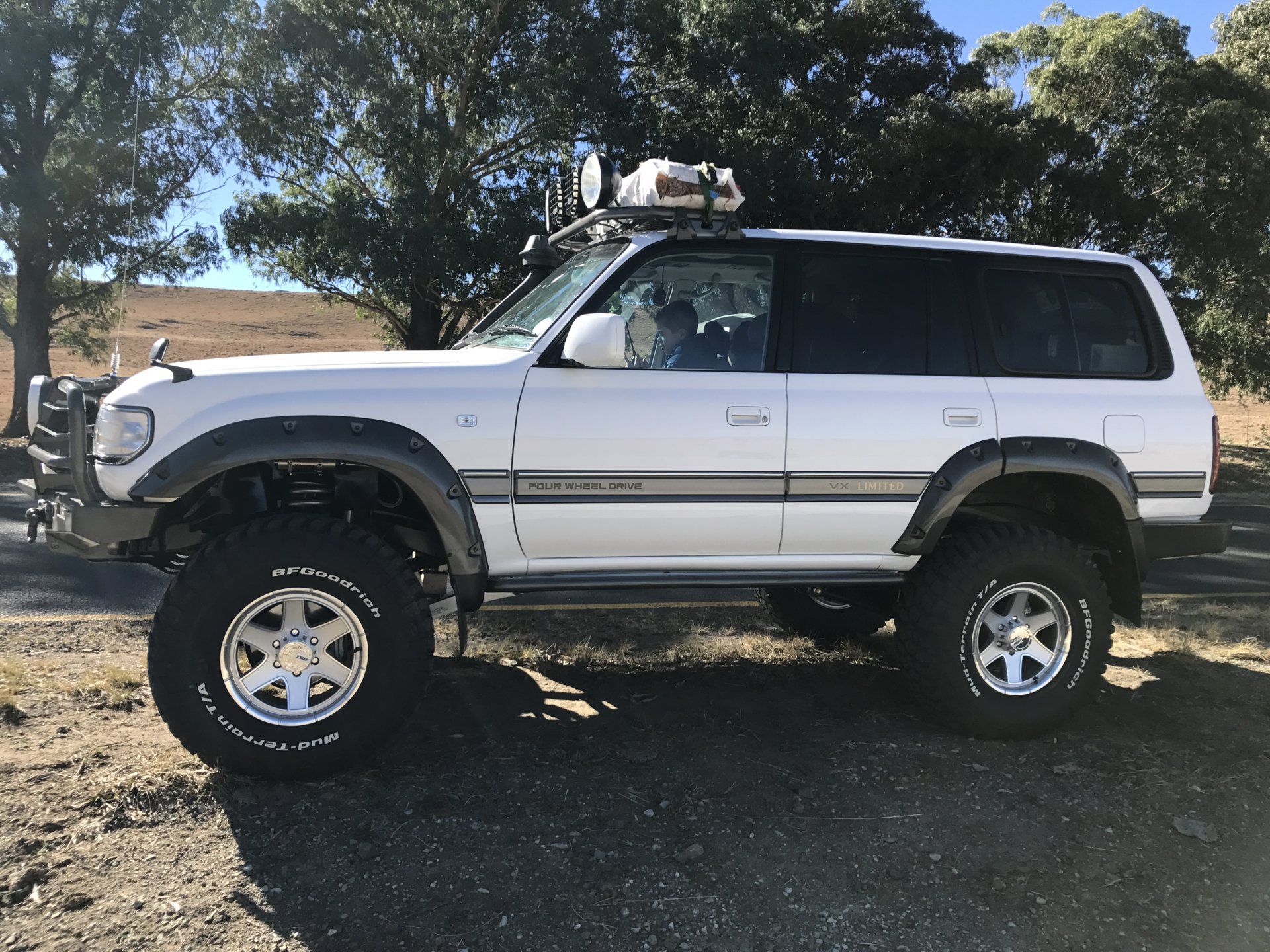

My Hoopty Wagon
1" body lift & 1" suspension lift.
Lowered front bumps 1" & rear 1.5"
2" cut front fenders & gutted flares.
Non cut rear fenders & trimed flares.
3.5" BS 9" wheels.
37" ST Maxx Coop's
I forgot the rest.....
