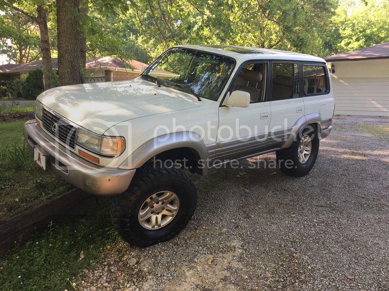

veiloctane, I though mine were wide at 365's. What wheels are you running?
Year - 96
Lift - 2.5" OME Heavies w/ 2" front spacer
Shocks - OME
Bumpstops- stock
Trimming - small piece of inside of front valance
Tires- 37 x 13.50 R17 Toyo MT
Rims- 17" Tundra/Sequoia Wheels
Spacers- 1.5" wheel spacers

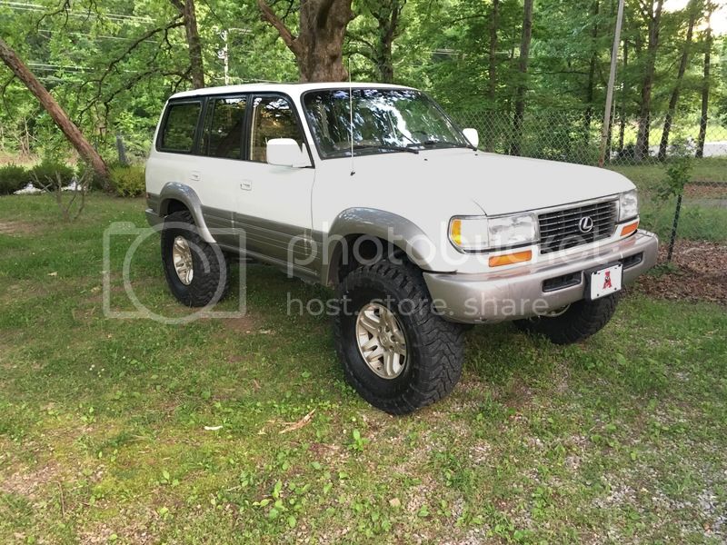

Yea man I was there late friday-sunday. I saw you towing your rig through the campsite and then turn around, sorry I missed you! Both of these pics are from GSMTR this past weekend.
Year - 96
Shocks - OME
Bumpstops- stock
Wow any other pics of this LX? Never thought I'd consider 37s but it seems possible with minor trimming and a 3 inch lift
At the time this was taken I was on 37s with OME heavies, 1" front spacer, 2.5" bump stops in the rear, 2" bump stops in the front, inside of rear fender flares trimmed to be flush with body, front rear lower inner corner of the fender well pushed back with BFH.
Doable for sure. Ran 37s for several years on j springs... probably a little shorter than Bama's 2.5+2" spacer. Minimal rubbing without spacers. Id imagine a minimal trim with them. Backspacing is key and trimming a wedge out of rear of rear flare ala tools r us if they are gonna stay.
Thanks, I just got them put on last week. I've been following your LX as well and love what you've done with it so far. These are the only other pics I have of it in the driveway testing rub.
Preciate the pictures and the compliment. I wanted to keep the stock wheels but 37's are a PITA to find for a 16. Keep us updated!
I thought for sure I can do 40's with some trimming but 37's barely fitted .....
I think the rear axle needs to be pushed back out about 2" in order to fit 40's
