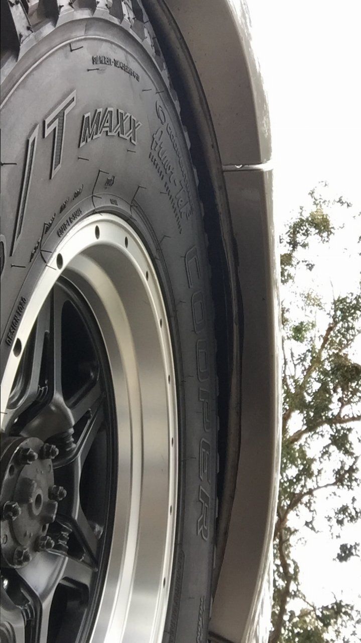

Will a 17x9 3.5bs stuff into front and rear fenders with 37x12.5 tires?
3.5 bs seems to maybe be too aggressive and not work. This will be in a J spring truck and I don't want to lose all of my up travel. I have no flares to worry about and I'd like to not do much or any cutting if possible.
Here's how my 17x9 -12 offset tucks in with a 37x12.50.

Level 8 Strike 6, 17x9 -12 offset.

1. Is this with OEM or extended bump stop?
2. Does the axle touches the bump stop?
3. Does the tire touches the inner fender?
Thanks.
1. Extended bump stops 3" (in the pic the bump stop was ~1/4" from touching the axle). My bump stops are this length so that I; a) don't have the tire eating my inner fender and b) don't bottom out my shocks.
2. My axles come in contact with the bump stops with 1" of upward shock travel still available. This is by design as the bump stop will compress some to "slow" the bottoming out of the suspension.
3. No, with my bump stops at 3" and proper backspacing for the wheel I do not make contact with the inner fender. There is still about an inch of available space.
