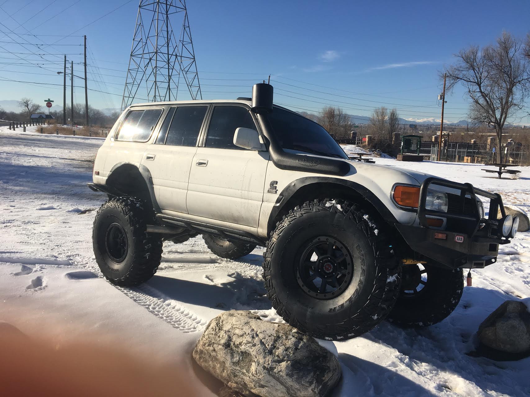

About 2/3 or 3/4 of full flex/stuff checking clearances. I might be able to remove 1" bumpstop from front and rear compared to what I was running with the 39.5" Iroks pre fender trimming. This is after the fender trimming with 42s
Good lord man. What axles are you running? I've seen a lot of 80s around town, but I think I would have noticed this one.
'93 with ironman 6" with metal tech and homebuild spacers up front, 2" body lift, 1.5" wheel spacers, on xml's. 5.29's on the way...

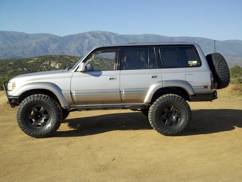

37 x 12.5 17 MTRs on Method double standards. Bit of rubbing, really need to go to 4" backspace ideally.
3" slinky long travel lift stage 5 with bypasses all round.
