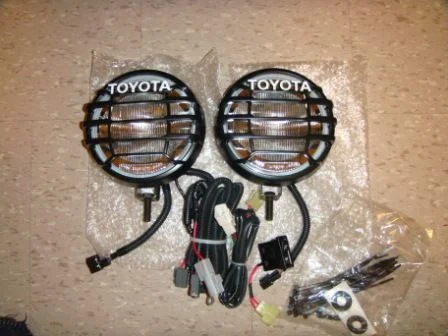

some pics i found of the OEM lamps..

Here is a pair of newer-style OEM (JDM) fogs for sale in classifieds:
https://forum.ih8mud.com/diesel-jdm...dm-oem-toyota-aux-fog-lights.html#post7123004
attachment.php
How well do the older style fogs work?
I have referenced this post for years... finally found a set that I believe to be OEM. The bracket on top is different than yours though. The internals changed from a screw for bulb access to a rubber grommet so there may be differences in years. The bulb in these are Koito and the internals are the grommet style.
Sure would be nice to convert those to an H4 style bulb. I like the look of those lights, but having to source replacement bulbs would be a PITA.
