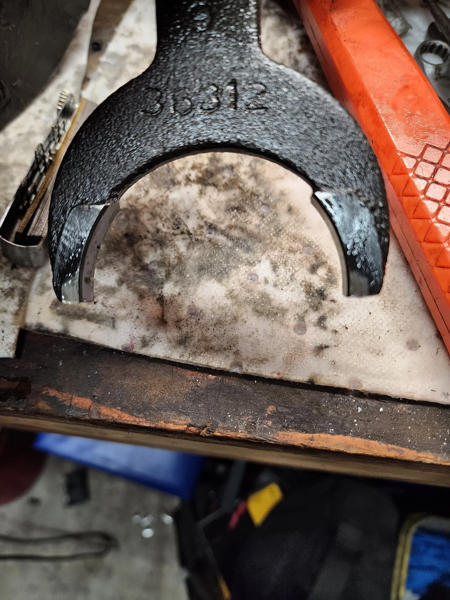

Chances are the hi-lo fork and collar are both worn, prematurely. My symptoms were the same.
The fork is worn a bit oddly. It seems it isn't making contact with the shift collar evenly front to back - tilted maybe a better word. The shift fork and collar were new from AA when I installed them. So what should I do here? Leave it alone? File down the fork to make it sit flush? Use the stock fork that has some wear? But read on for the other issues...
I had a similar problem and I mixed and matched the shift rail, spring, and ball bearing until I got a combination that would hold. I don’t remember which was Toyota and what was AA, it was more about playing with it to find the right combo. I used a digital torque wrench to measure the resistance in the selection. Since I did that, I have had zero issues with popping out of gear.
I looked at this a little bit before I dug deeper. I could definitely add more preload on that spring with the stock Toyota screw instead of the AA bolt. I might play with this when I put it back together. Luckily I still have all the old parts from when I built this 4 years ago.
