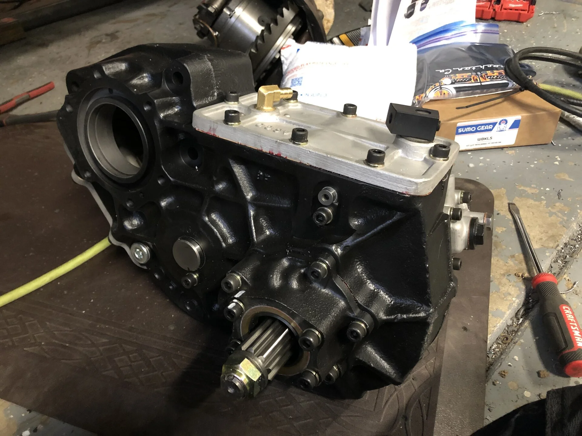

Thank you Georg for getting mine done . I was super busy today and didn’t have much time to talk to Rork but I got the email tonite . I will call you in the morning. Thank you again
This thing is beautiful. The attention to detail speaks volumes. Thank you Georg and everyone at Valley Hybrids
Just wanted to report I have about 11 years on my 4:1 ratio Orion now, and it is my daily driver, and occasionaly I wheel it. Only problem I've had is gear oil pumping from the t-case to the transmission. I added a hose from t-case to transmission fill plug for now till I can put in a new seal.
If I were you, I'd keep the overflow hose. For some reason, the seals don't seem to last. Better to have it and not need it than...
Thanks for the tip, I am going to keep it, I also put an inline strainer in the hose, it is stainless steel mesh, not too fine, so it does not impede the flow of the thick gear oil.
Any idea who built it? This is great feedback!
Whoa. I was scratching my head reading H55f and orion, now I am scratching my head wondering how someone has so much talent and skills! Really really cool build.
Thank you so much. The Orion- H55f combo has had no issues so far other than the seal leaking. It has been amazing to drive. 70 MPH on the freeway is no problem. I get 24 MPG highway. I usually drive about 65 MPH. Diesel fuel is expensive, but still for a FJ40 this is pretty incredible.
