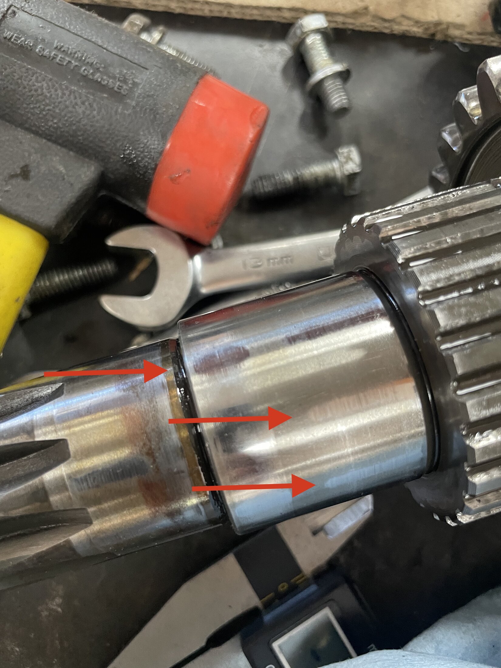

Yeah, it looks like we're on to something. While I don't have a micrometer, I can tell from the looks of the output shaft the high speed gear has "chattered" on the shaft. Measurements with a simple set of calipers also confirms the discrepancy. I can feel the gear wobble when moving it side-to-side by hand. Looks like I'll be ordering an output shaft for sure.

My high speed gear has less than 300 miles on it so I doubt it's the gear bushing. Mine never fully popped out of gear. With the wear pattern on the output shaft resembling a chattering issue, I'm betting that's largely my issue. I like to be able to find some evidence to support what was happening.
Other than the measurements across the bearing surface indicating more wear at the edges evidencing the oscilating/chatter I have found nothing, except it pops out which I could solve by going to fine spline shafts which get you the improved dog teeth, IMO.

After reading all 48 pages of this forum and studying, I believe I have an explanation for my noises from post #937. I originally had a few circumstances where it was decelerating and ended up in neutral. I didn't think much about it, but there was a reference to shift linking here in this thread. I adjusted my shift linkage to position the shifter lever up close to the bracket stop which on the stock levers keep you from going into 2WD Low. (I had first removed this stop because I wanted the use of Low range 2WD.). When it popped out of gear, I thought this might contribute to the issues and decided to weld the stop back in and adjust the lever to be close to the stop.
What was happening was the transfer was trying to pop out of gear on deceleration but because I had the linkage adjusted close to the lever stop, the lever prevented full movement into neutral. The HI/LO sleeve was just starting riding on the ends of the dog-tooth which created my gear noise. Bottom line, on deceleration I had the famous pop out of gear issue.
I've since replaced the output shaft with a new one and I also replaced the HI/LO clutch sleeve.
