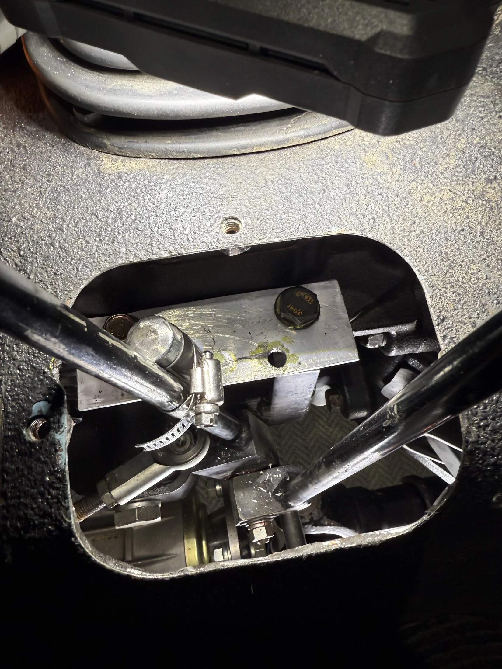

I agree, it's too good of a mod to go back. Working on a locking mechanism like @NikP

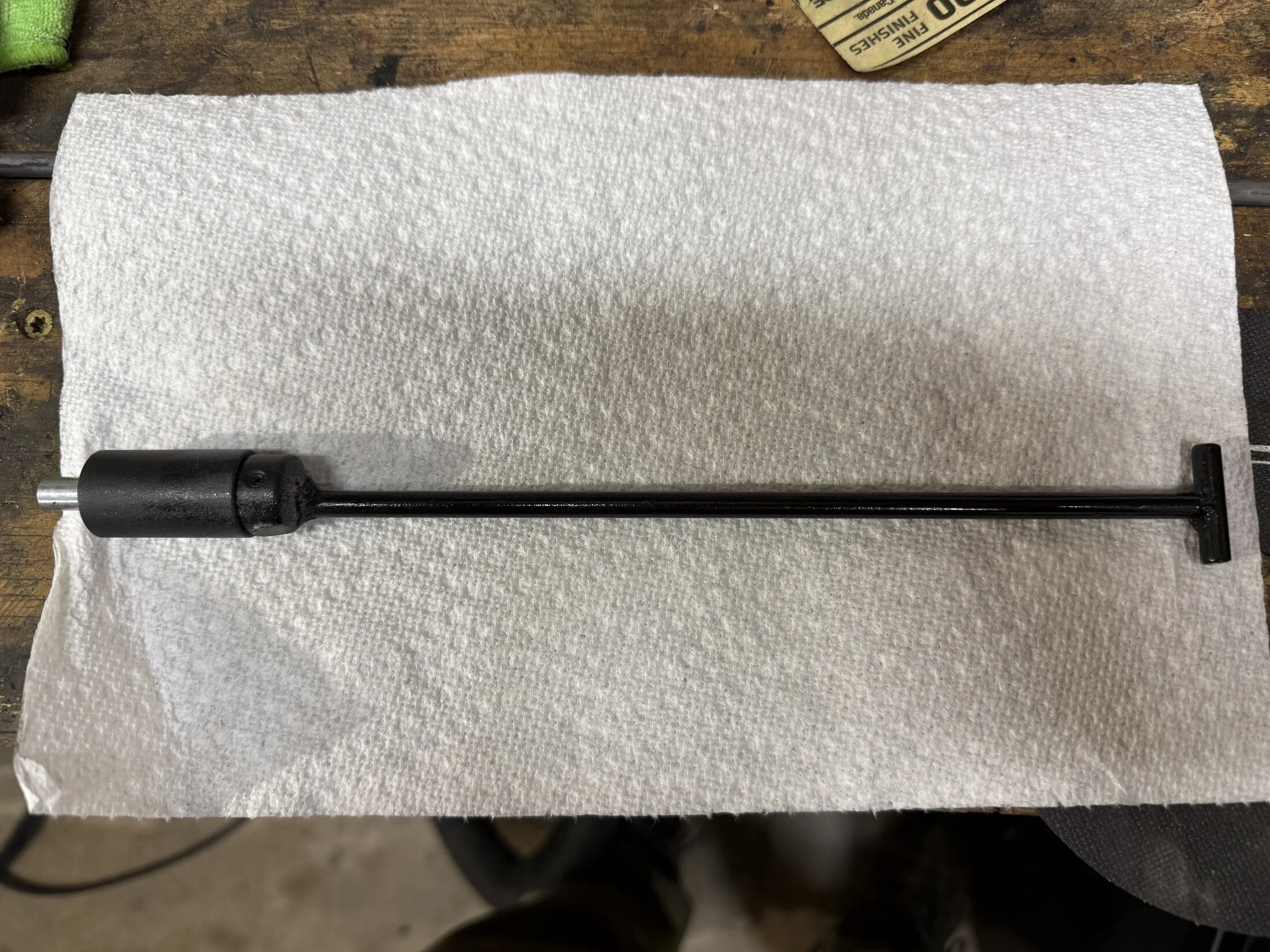

I will weld a vertical rod on top of the indexing plunger with a T handle to actuate it. The indexing plunger is a weld on, but I may run hose clamped until I am confident in the setup. I did try and flatten both surfaces of the shifter and the plunger body so they marry up easier.
I used aluminum for the plate on the trans, it's just easier to work with than steel.
I like it! I'm glad my design provided some inspiration! It took me a couple iterations to get the holes in the transmission plate just right.
Here’s a final look at the indexing plunger. I made a T handle and kept the actuation simple. If I rest my palm on the top of the H-N-L shifter I can actuate the plunger with the T handle between my middle and ring finger.

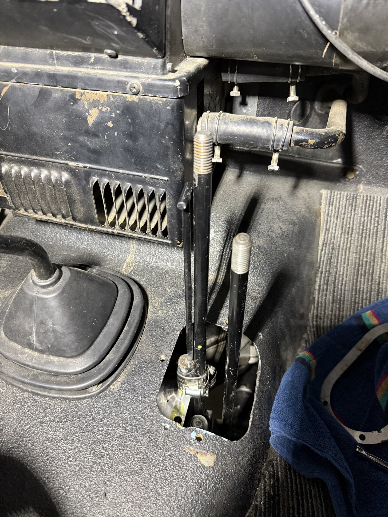

So I pulled the trigger on the orion and had valley hybrids get it all assembled and mounted to my sm420. I'm going to need to play with the new twin stick kit a bit to make it work because I have a plate style adapter and not the longer advanced adapters setup. Those of you that have been through the popping out of gear thing, if you were in my position, would you give it a shot and run it as is? Or work on fabbing something to hold the shifter in place now while the trans/t-case is out of the truck. I'm leaning towards copying one of these locking pin setups and getting that dialed in now before I put everything back in the cruiser.
Man, I'd be torn on what to do. I'd be tempted to run it and see if there's something Georg does differently when putting it together to keep it from popping out of gear. His video doesn't show anything specific in that regard. It won't hurt anything to try it, but you'll crap your pants when it pops.
Not a big hassle to fab the lock pin setup but you have to remove the tunnel cover again to gain access.
I would run it and see if it stays in gear. Georg & crew know what to watch and I would be suprised if it popped outa gear. I would test it with no linkage attached , in 2wd, run it up and let it have some good decell decompression in low and in high. On my sm420 a good 3rd gear wind up and let off like you were going 45 and coming to a stop, when she's really rippin on decompression it will pop if its gonna.
I’d run it- see what happens. Be ready, but Georg probably knows what he’s doing. Worst case scenario, have a bungee ready to hold it in gear. That’ll get you home.

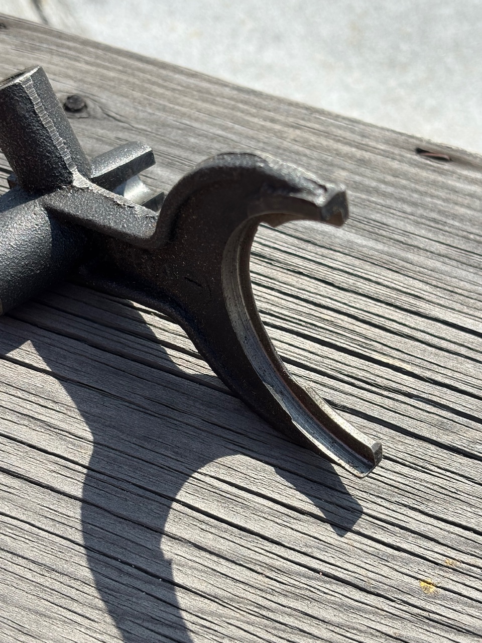

Keep in mind that locking the shifter does NOTHING to relieve the forces at work inside the case, and the load on the shift collar WILL wear through the hi-lo shift fork.
I totally get that. It is a bit of a band aid for now with rubithon in a few weeks but beyond that I’m not totally sure what else there is to do.

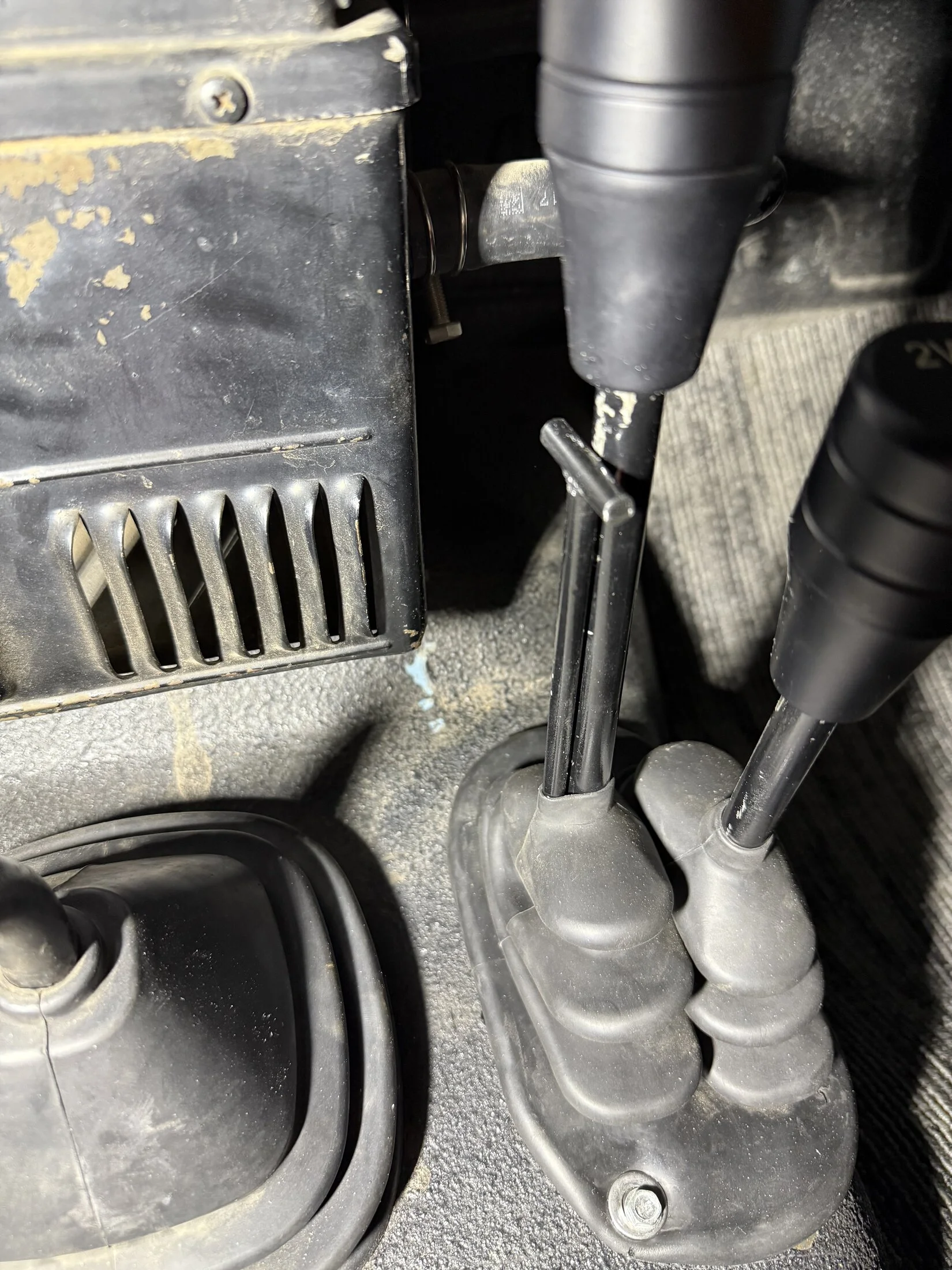

Not sure if this is really much better than any of the other lock solutions shown so far, but it worked great last year on the trip down to the Rubithon from Portland, and back. No issues at all. I was going to fashion some sort of metal bar, but this HDPE prototype is so quiet and works great, I just left it in. It could for sure be made prettier, but doesn't bother me. I like that the shifter is able to move around and never really ride on the stop at all in normal driving. It only bumps into the plastic stop when it's working its way out of gear, but hasn't popped out once. I had all the parts in my garage already: a cheap cabinet hinge, some IKEA cutting board, a mismatched colection of hardware, and even the hose barb plug. It took a little bit of trial and error to make it the right size and placement so both the H and L settings still have some movement, but don't let it slip out of gear, but it has so far been 100%. Would take some adjustments to the design to use with a pretty boot, but I'm not too worried about pretty. The slotted foam keeps about as much noise out as the original rubber part, and I've driven it in Oregon rain a bunch and never had any water ingress. I'm calling this solved on my end. Any wear on the fork from the few seconds it's rubbing while trying to walk out of gear when rubbed up against the plastic lockout will likely take more time than I have left driving this to cause any problems.
