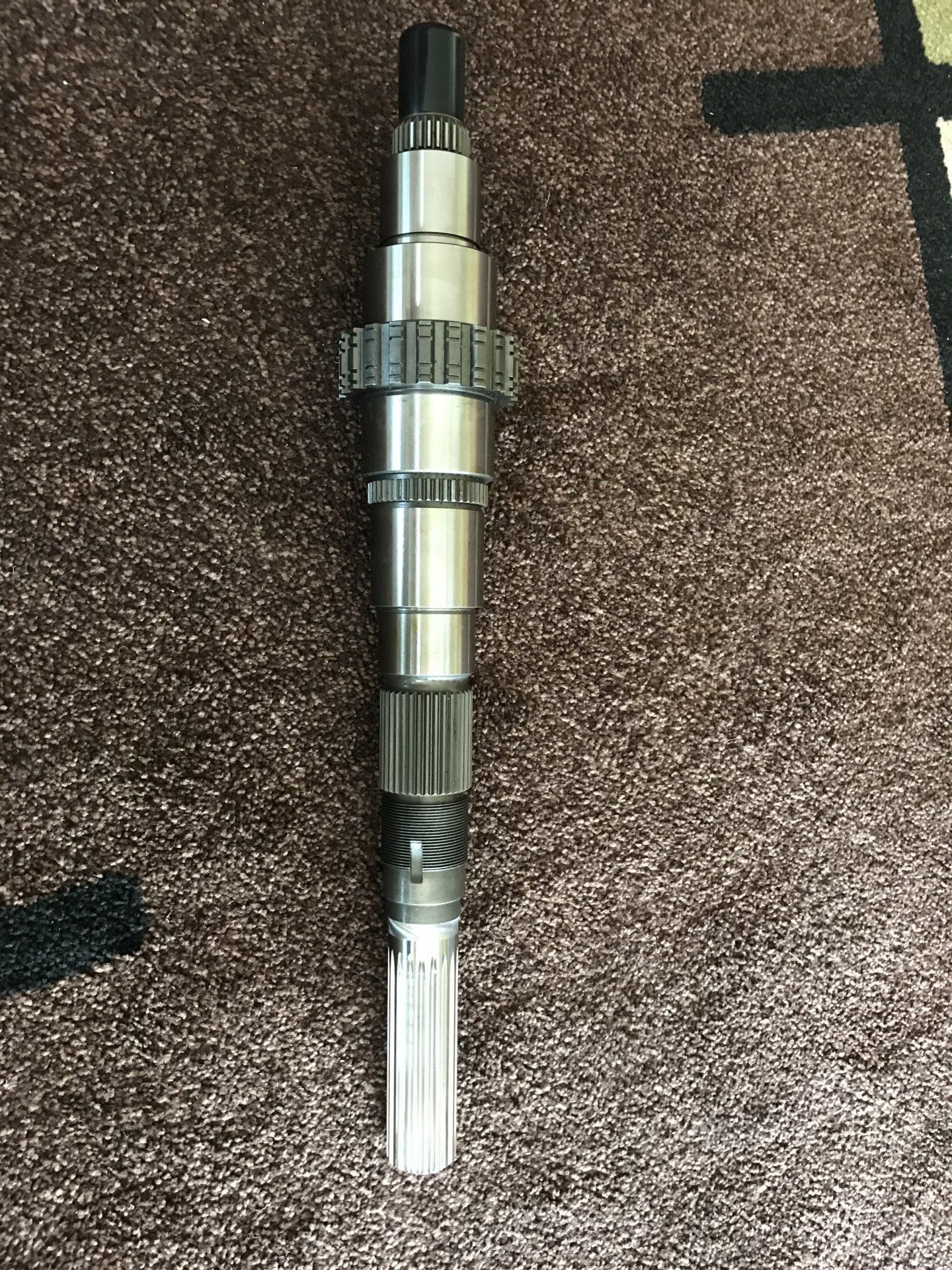

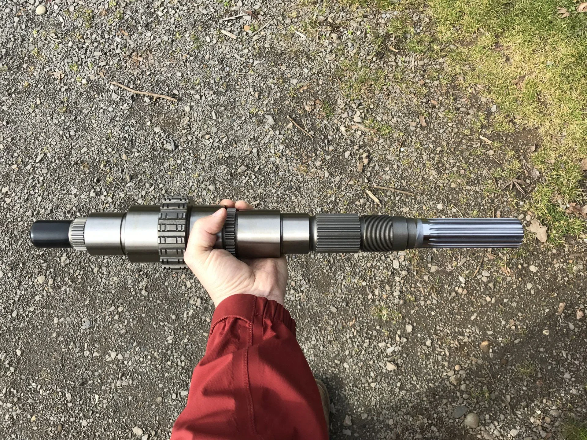

Hey everyone. I now stock the plates and shafts required for this conversion. First run of plates are $300 each and shafts are $350. PM for details. I am in process on building some bolt in motor mounts that will require no welding or frame modification as well. I’ll post up when those are ready...should be about six weeks.

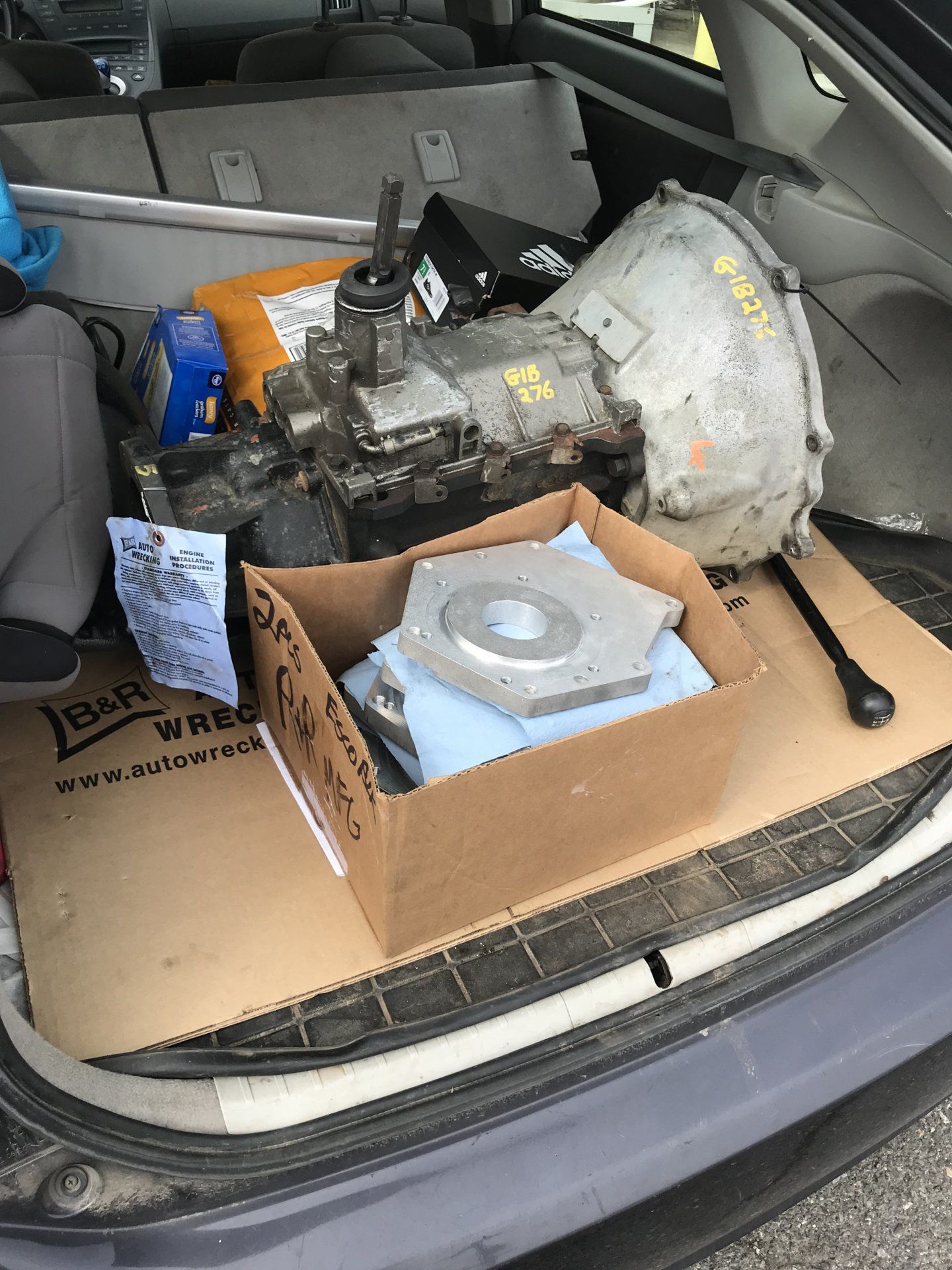

Does anyone who "machined" a plate possibly have one to sell,? if so PM me, I have an idea that isn't using a cummins or NV4500, but I'd like a plate to "tinker" with. Thanks
just shot you a pm

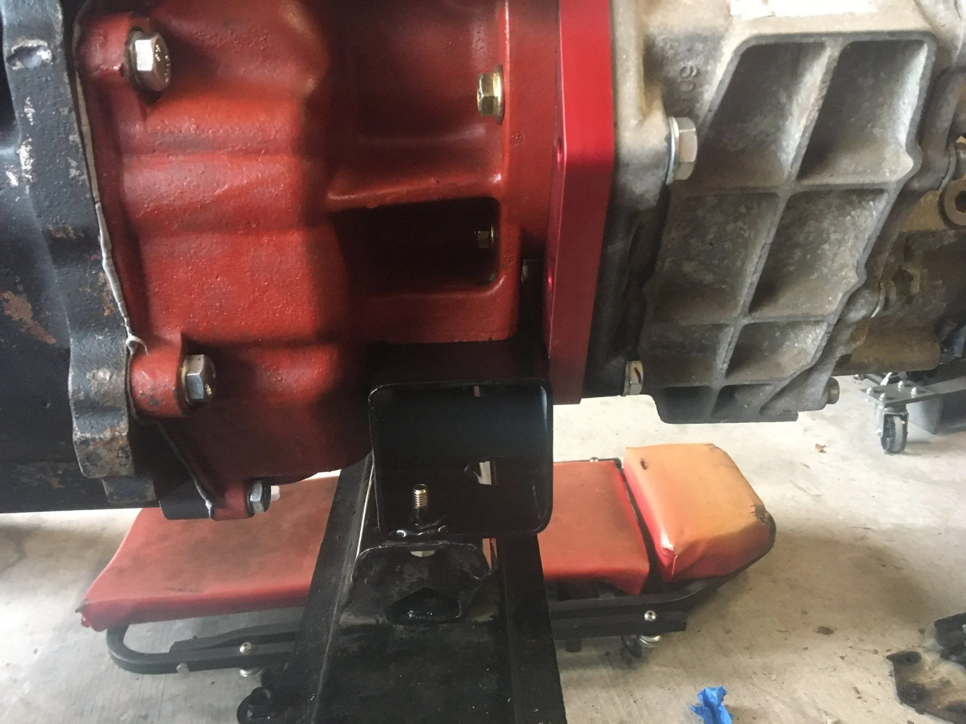

Has anyone come up with a trans mount bracket for the NV4500 and OEM FZJ80 crossmember? How about 6BT engine mounts?
I used 3”x3” tubing to adapt to the cross member. I think I’m going to lower it a bit so I need to find some 3”x2”. The NV4500 trans mount fits perfectly in the crossmember so I chose to adapt to that instead of modifying the crossmember like others have done.
