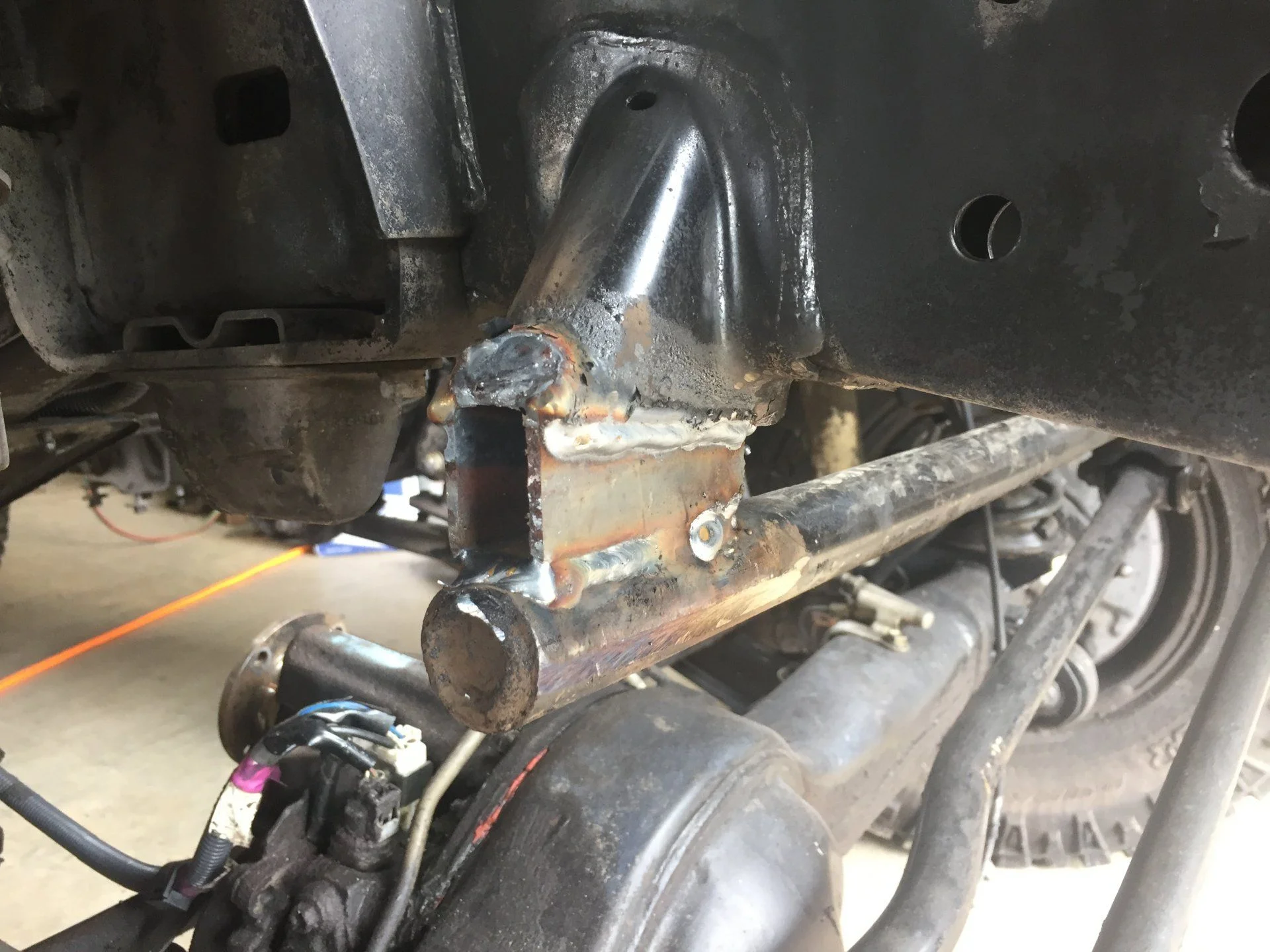

Following others' lead I dropped the panhard brace. Instead of cutting it I ground the welds off and added some tubing.
This should give me plenty of clearance and doesn't interfere with anything at full bump. I'll paint everything before the engine goes in for the last time.

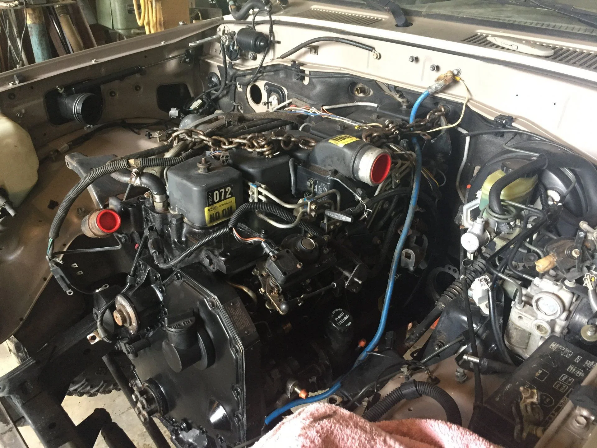

With all that done I swung the engine and trans in for a first test fit. Needed some clearancing on the tunnel on both sides. Took it out and did some adjusting with a 3lb sledge. Put it back in and this is where its at. The first gen dodge mounts sitting without the rubber on them on the stock 1FZ frame mounts actually put the motor close to where it needs to be.

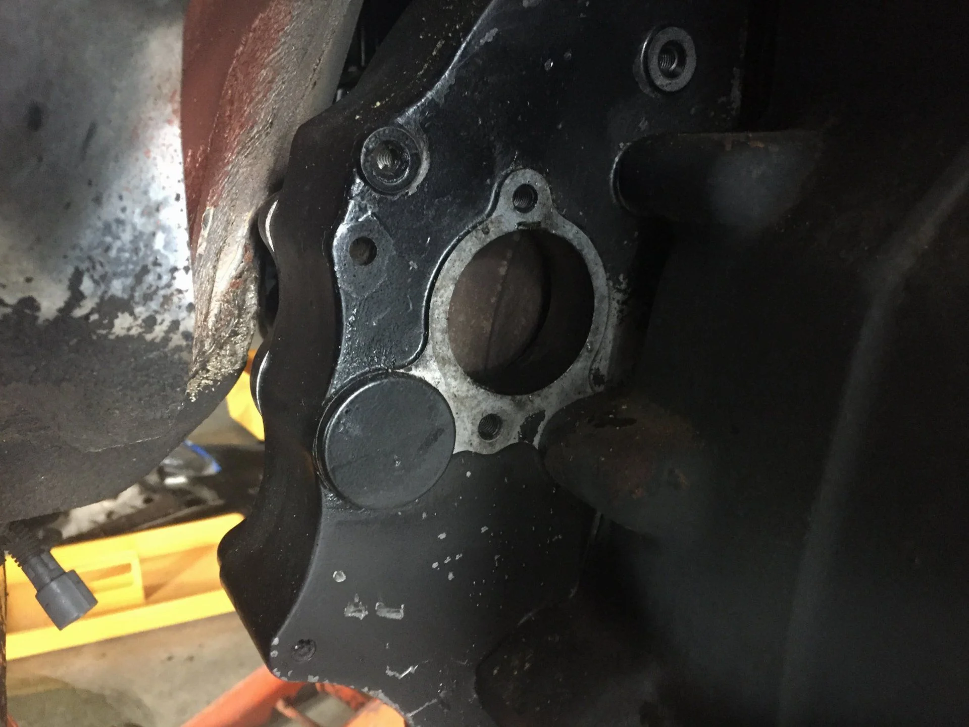

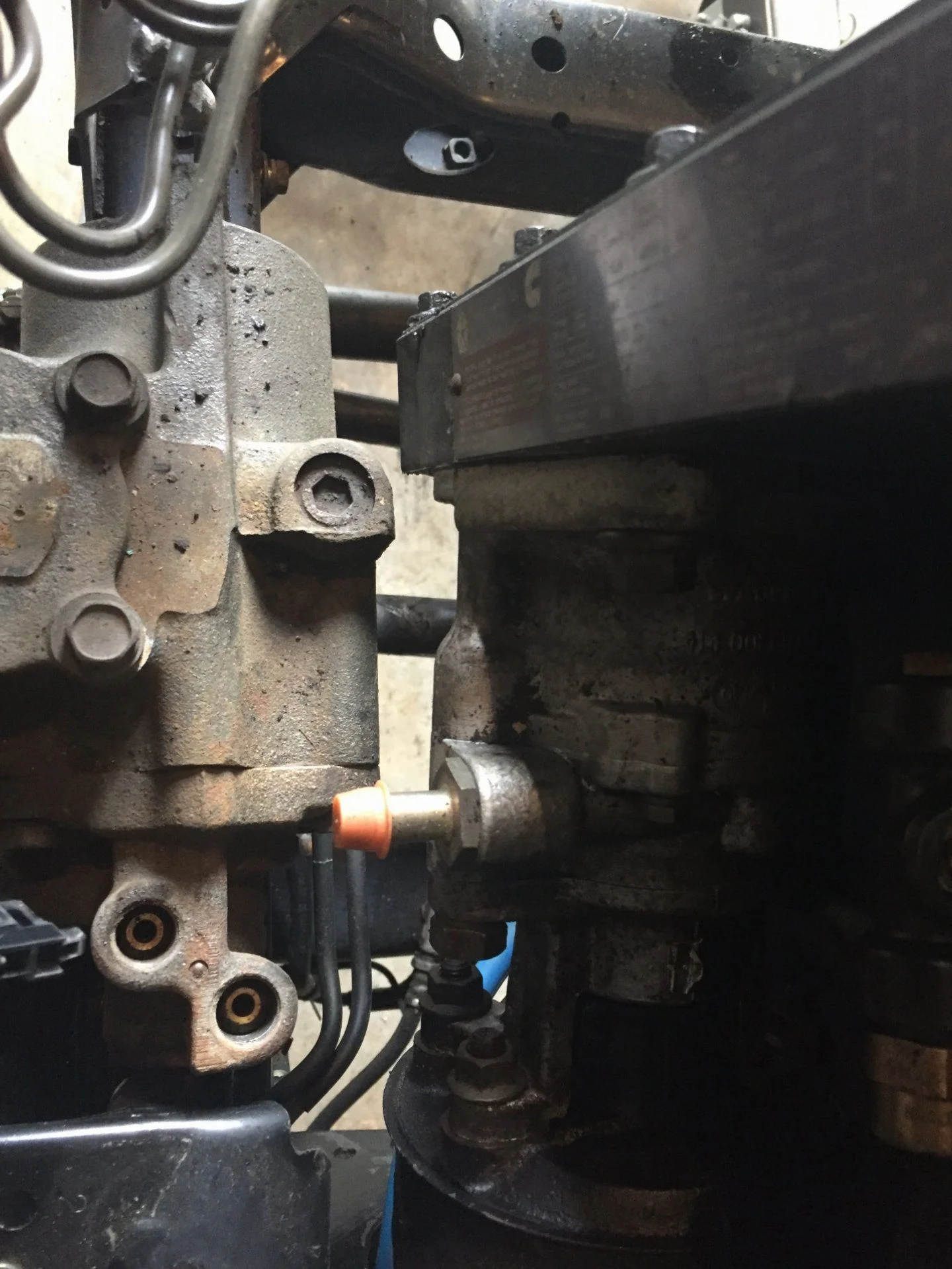

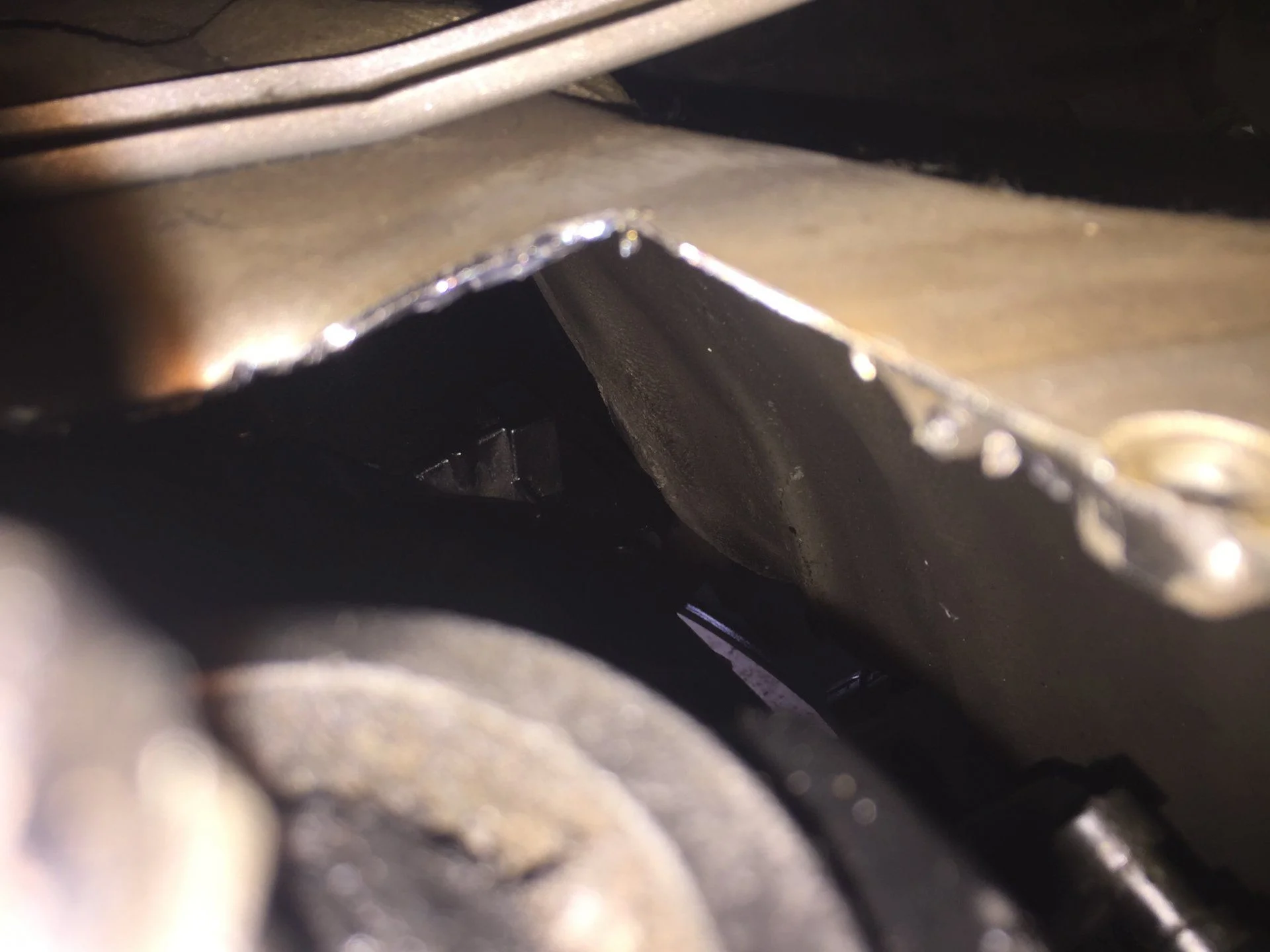

I tried to catch a few pics of the tight spots for folks. These pics are all taken with the engine about 1" too far back I think. I think moving it forward an inch will make me comfortable all around except possibly the slave cylinder side.
Starter bump out to tunnel:
Slave Cylinder bump out to tunnel from front:
Slave Cylinder to tunnel from back:
Exhaust manifold to firewall:
Timing case to PS box:
Here's the panhard brace to pan clearance. At least .75"

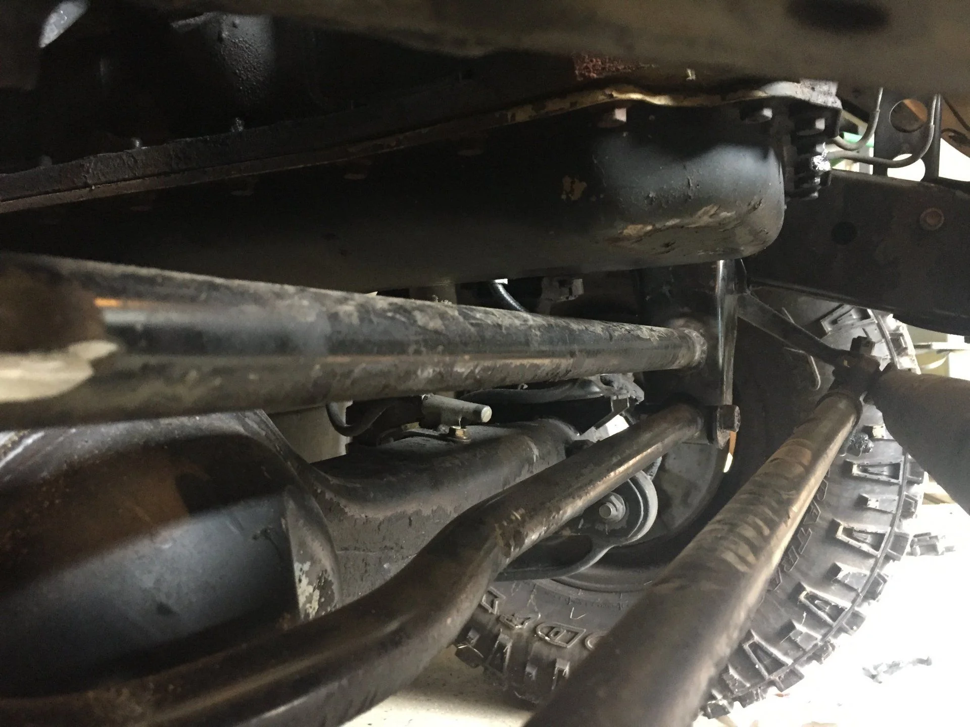

In the original post I mentioned that draglink clearance was going to be tight. Indeed it was more than tight at full bump. My motor is from a '92 Dodge 2500. I don't know if it was 2wd or 4wd but the pan sump was about an inch longer than some of the newer pans. I ended up buying a pan from cummins for $120. Offbrand ones on ebay were running $105 so this was great. Here are a few pics of the two pans.
While it doesn't look like much...that my friends is enough difference in length to make it so I don't have to drop my bump stops!

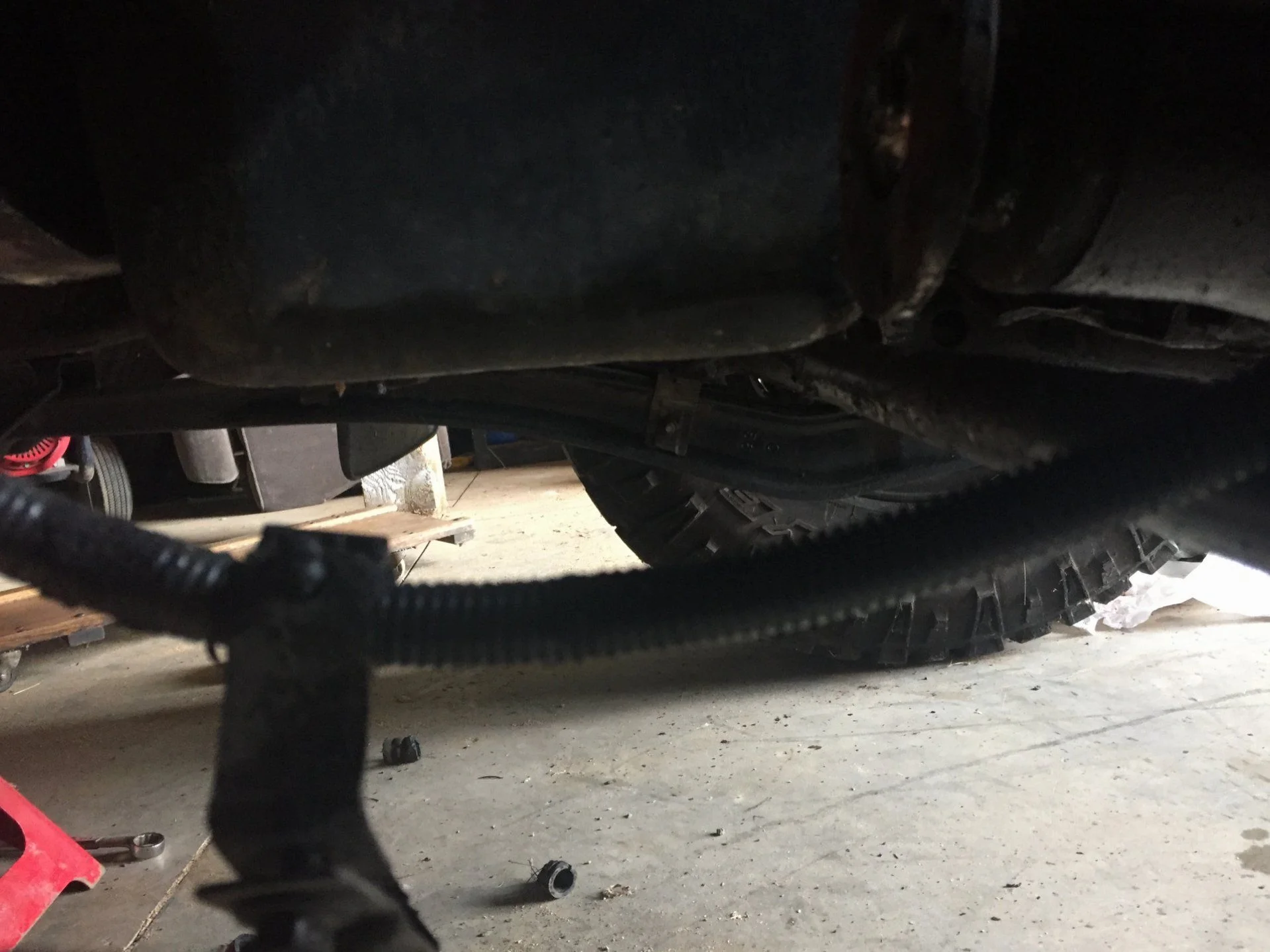

Once the pan was on and the engine back in I dropped the truck to the bumps to check out clearance.
You can see in this pic that the draglink clears the pan in the front and the front diff clears as well. Fits superb in my opinion.
This is a bad pic of draglink to pan clearance from the driver's wheel well:
You can see its pretty much touching there. I will likely drop my bumps an inch or so to make sure things stay happy down there. I was pretty impressed with how well this engine fits though!

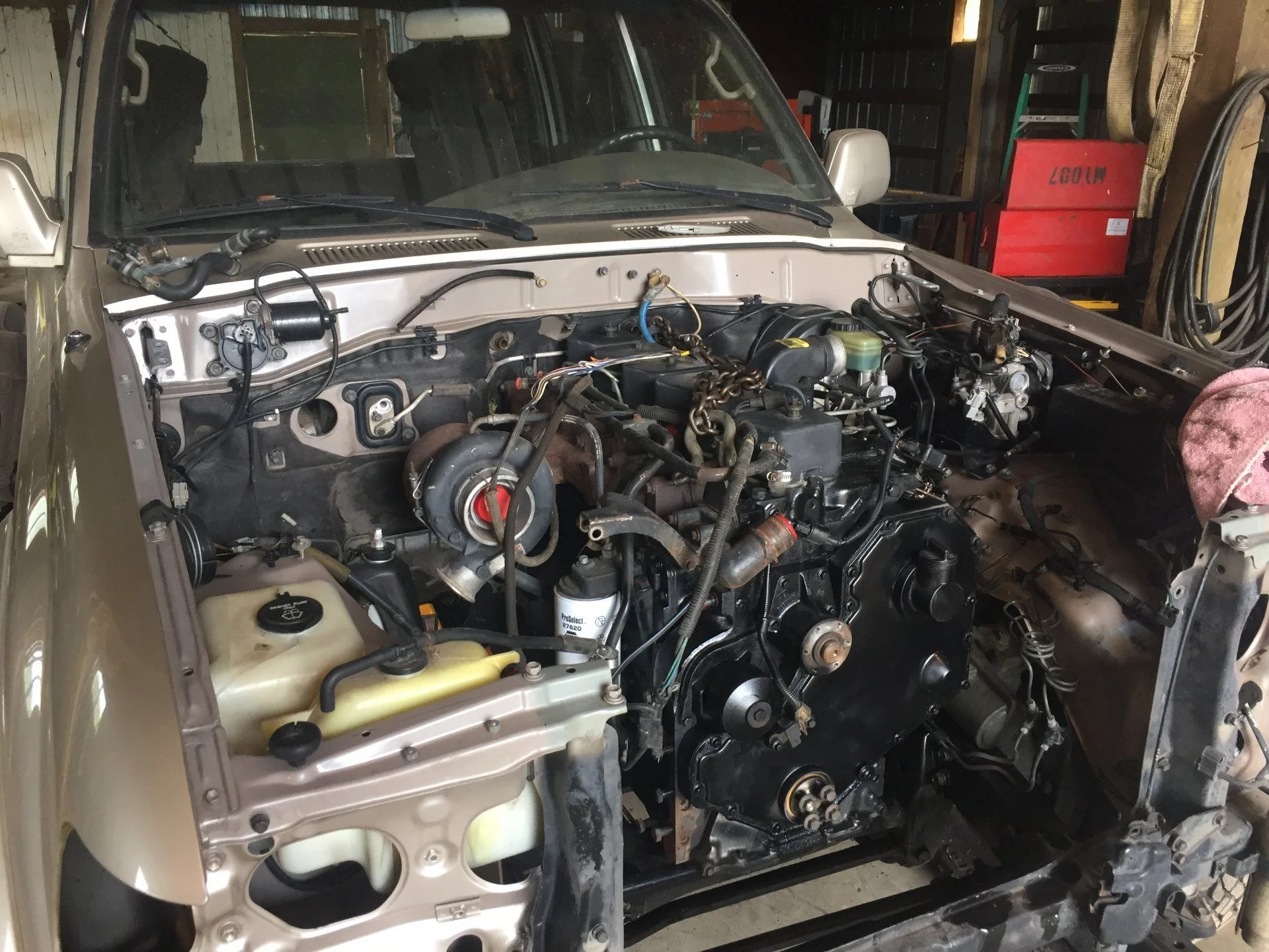

I decided to run stock first gen dodge accessory bracket with the dodge AC pump and a 22si alternator. The clearance issue for me is bottom radiator inlet to AC pump. I was able to circumvent this by cutting about 1.5" off the bottom radiator outlet and using a very tight end radiator hose. I don't have a good pic of it but here are the two hoses I chopped up to make top and bottom hose (plus a stock dodge lower hose).
Finally I removed the rear heater and redid the heater hoses.
I also made up the intercooler pipes and mounted the intercooler. Just used aluminum angle and some nice rubber mounts from the hardware store. I cut the holes in the core support using a 3.5" hole saw. Worked out well I think. Credit for all this goes to @Wheelingnoob
I also got the power steering hose in using adapters that @maxamillion2345 documented in his thread.
