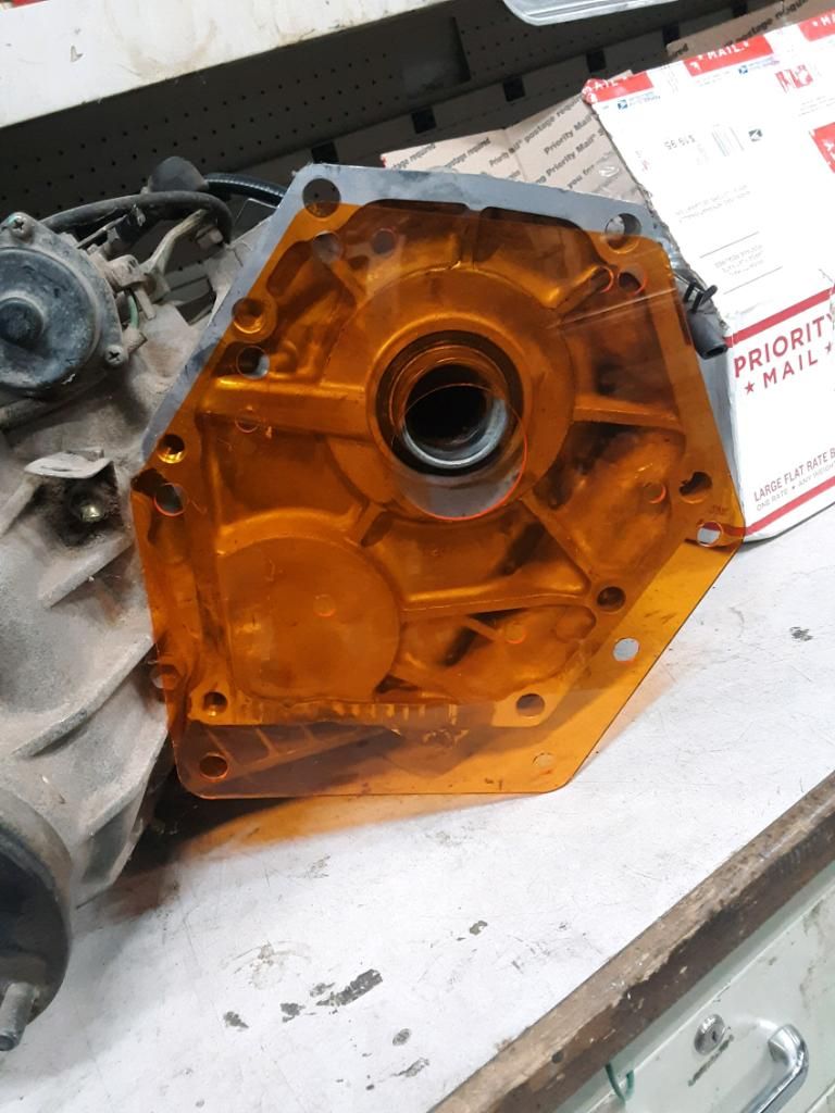

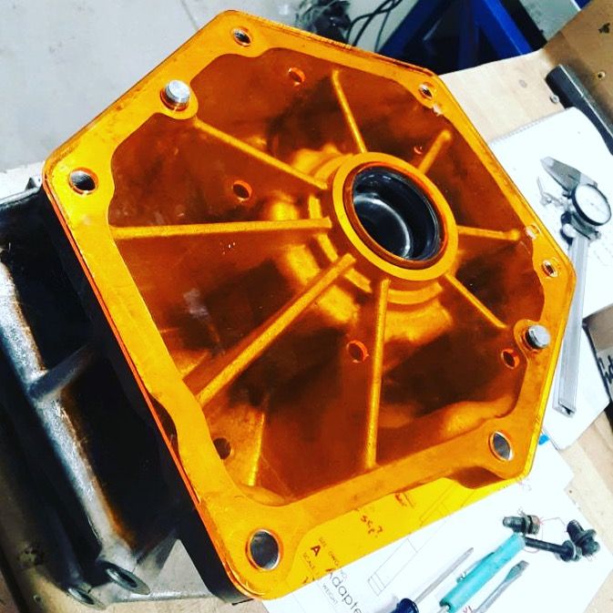

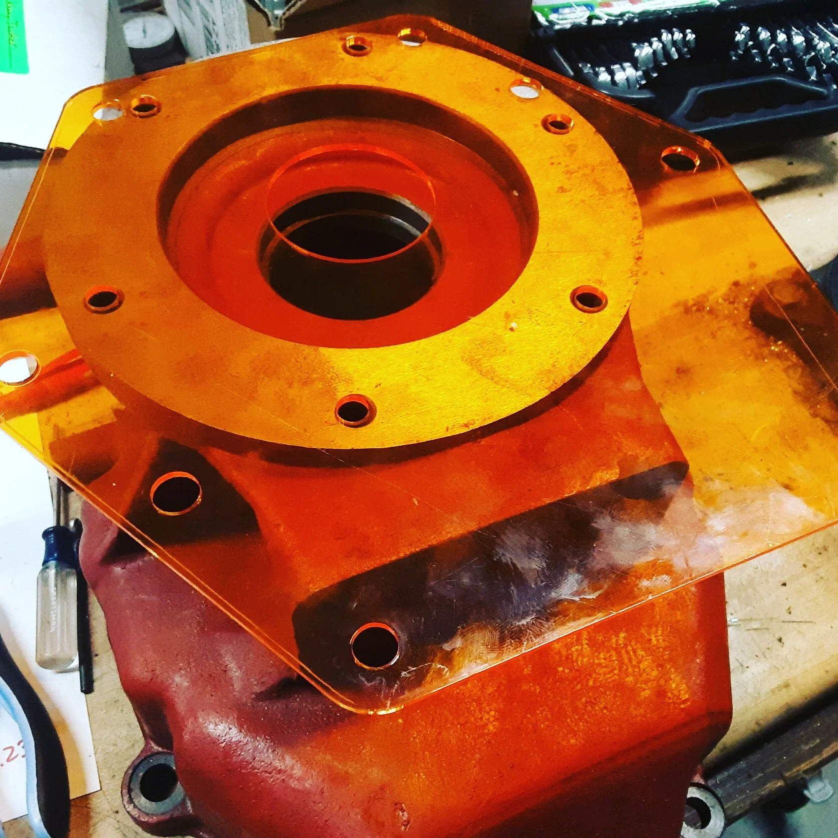

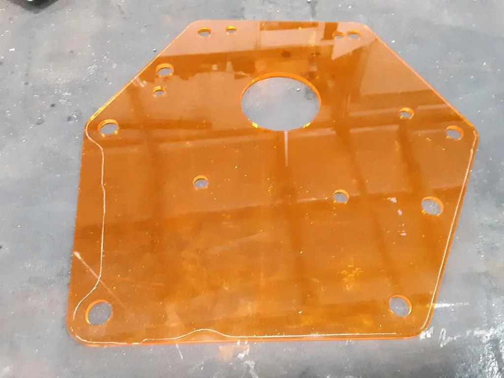

Last minute trying to fine tune the CNC file. Laser cut some acrylic to figure out the clearances needed.
1912396
Badass!
