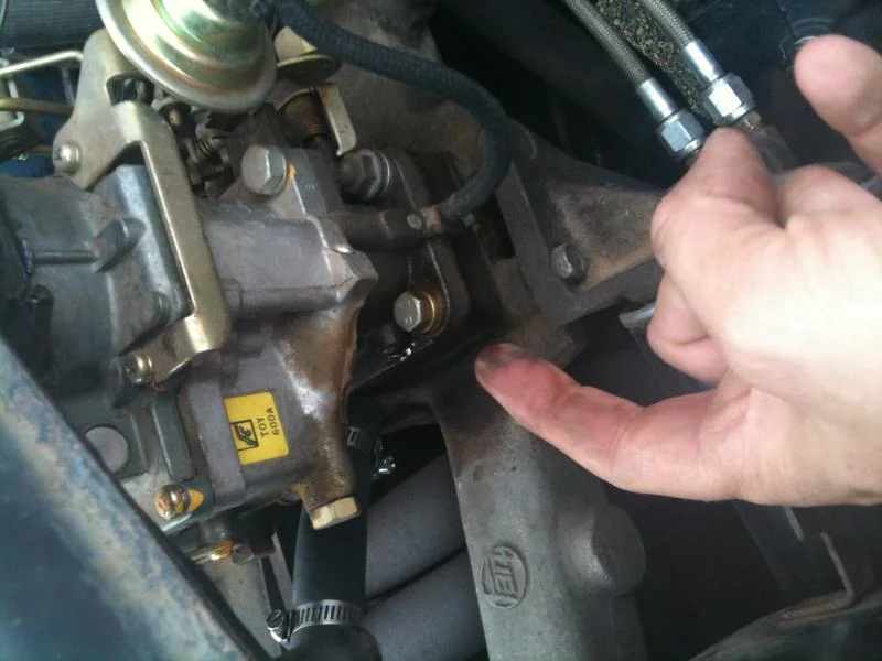

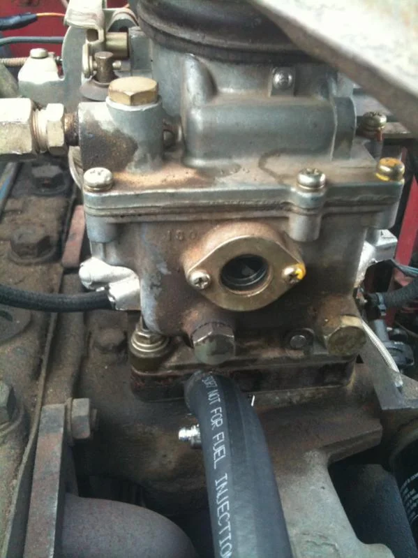

What size line is it that goes from the Carb to the Oil fill tip. Is the metal piece that the hose attaches to on the oil fill supposed to be loose and turn. Why am I getting gas coming out of the plug in the front of the carb. I have attached some pics for reference purposes.

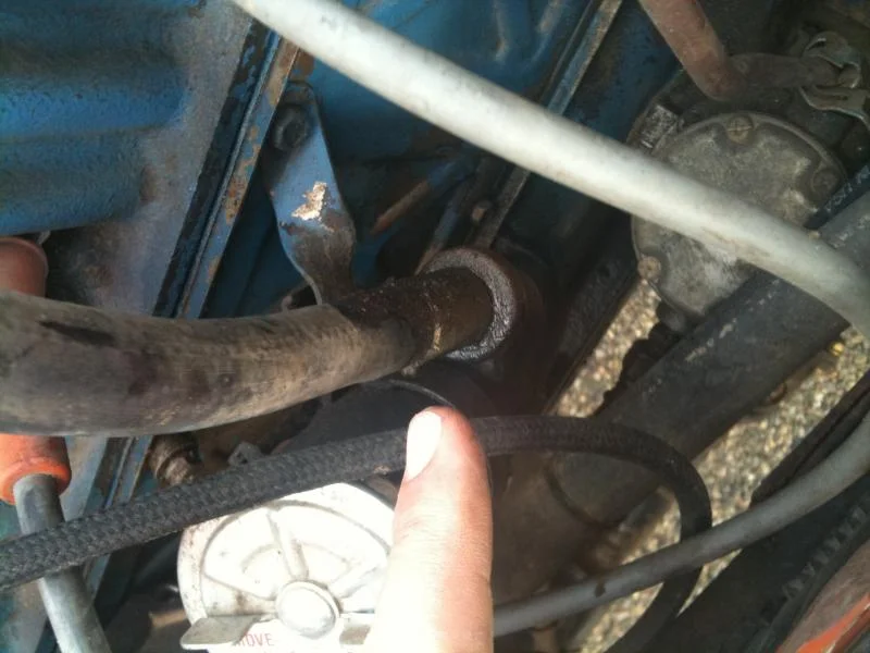

I think that's a 1F engine. That line your asking about goes to your PCV valve at the oil fill end. It should all be snug and tight or you will have a vacuum leak.
Which would cause it to idle like crap. Is there an idle solenoid on a 1f carb? Electrical connection that if it got wet would cause idle issues...
This may be a dumb question but how do i tighten the PCV valve at the oil fill end. It just turns and doesn't seat well? Can I buy a replacement at a local parts store or is this a specialty item?

I don't like the gas leak on the carb. I would agree with trollhole that you should start by looking at the fuel level in the carb window. It should be in the middle of the window. If it is not visible, you're not getting fuel. If it's overfull, then the float valve is stuck. If the float valve was stuck open or leaking, you could flood your engine causing poor starting and idle.

Ok. Replaced PCV valve. replaced vac hose. Replaced in line filter. Still running bad. No fuel in the window.
Any thoughts?
Sometimes it's hard to tell no fuel in window from too much fuel. Look carefully.
If you're still unsure, one easy thing to try is to drain the carb bowl by removing the jet access plug.
Drain the bowl into a glass jar. If you only get a little bit then you know that you're not getting fuel.
If it's not the filter then it can only be the fuel pump or fuel lines.
If you get a lot of fuel and you see the level drop down through the window as the bowl empties then you probably have a stuck or clogged float valve. If so, you might be able to free it or clean it by spraying a little carb cleaner into the fuel line port on the carb.

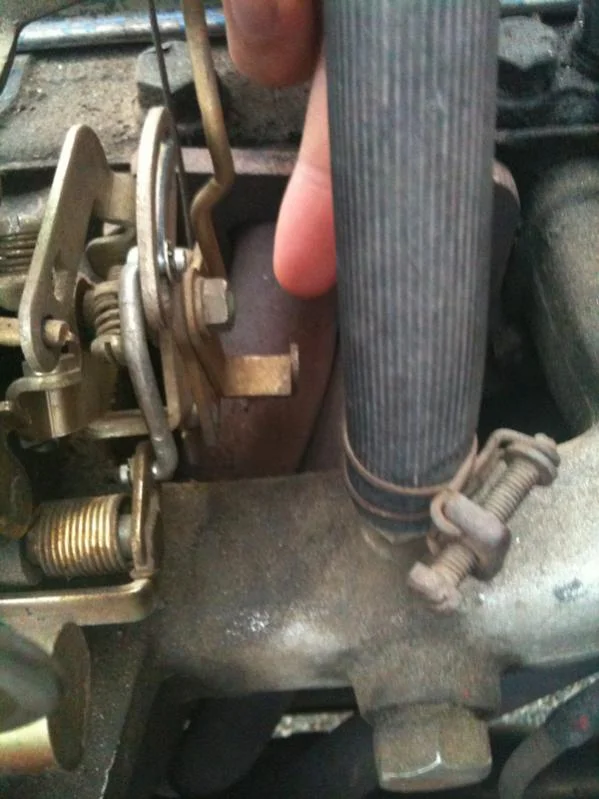

It was a loose mounting bolt. Can you send me a pic of your Carb? We think there is a missing idle spring now. It was idling fine, I took off for a test drive and now its reved up and we think there may be a missing spring....Weird.
Thanks again for your help.
Alex
What's an idle spring?
The throttle has a single spring on the carb and you would know if it was missing.
Idle mixture and speed screws have little springs and I doubt that they are missing. I can see the idle speed screw in your pic.
When you tightened your dizzy screw did you readjust the timing? That could be way off.
We were looking at the carb. The spot I'm pointing at looks like it had a spring there at some point. I tried looking in the manual that I have and it dis not show enough. Now it idles well until you give it gas. Once you let your foot off it stays in a high idle. The place I'm pointing to does not come all the way back into normal position. That was why the question of a spring came up.
As far as the second pic. The gas level is very high in the window.
Suggestions?

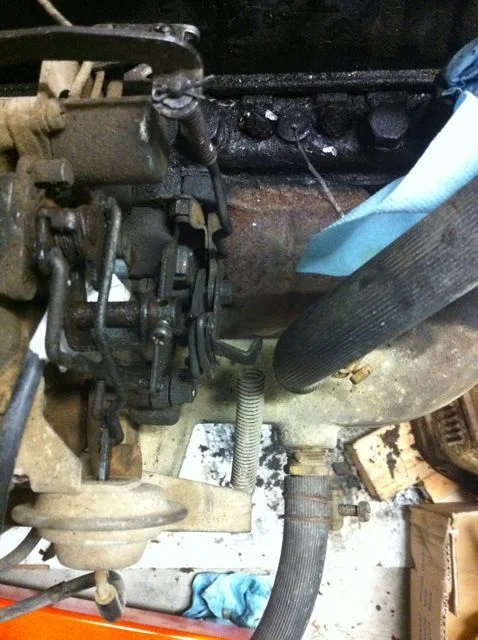

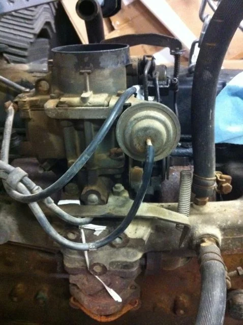

Do you have a pic of the same carb?
Thanks!
Yes, there is a spring missing. Or should I say I have a spring on my 71 carb.
These two pics are from the drivers side and above. Yes the engine is off the frame right now and the accelerator and choke cables disconnected.
There is a flat F shaped bracket that the spring attaches to at one and end the other on the throttle linkage.
