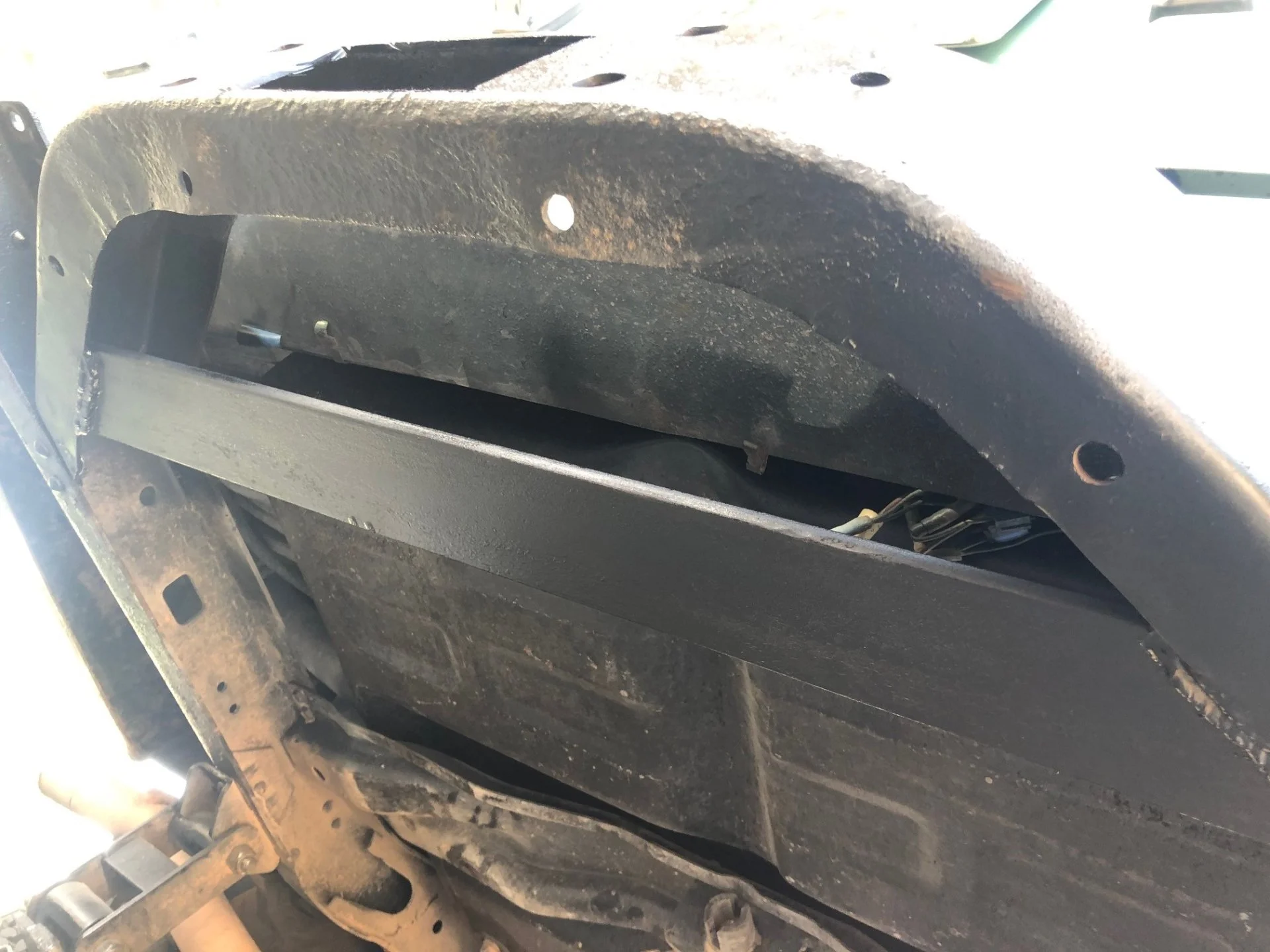

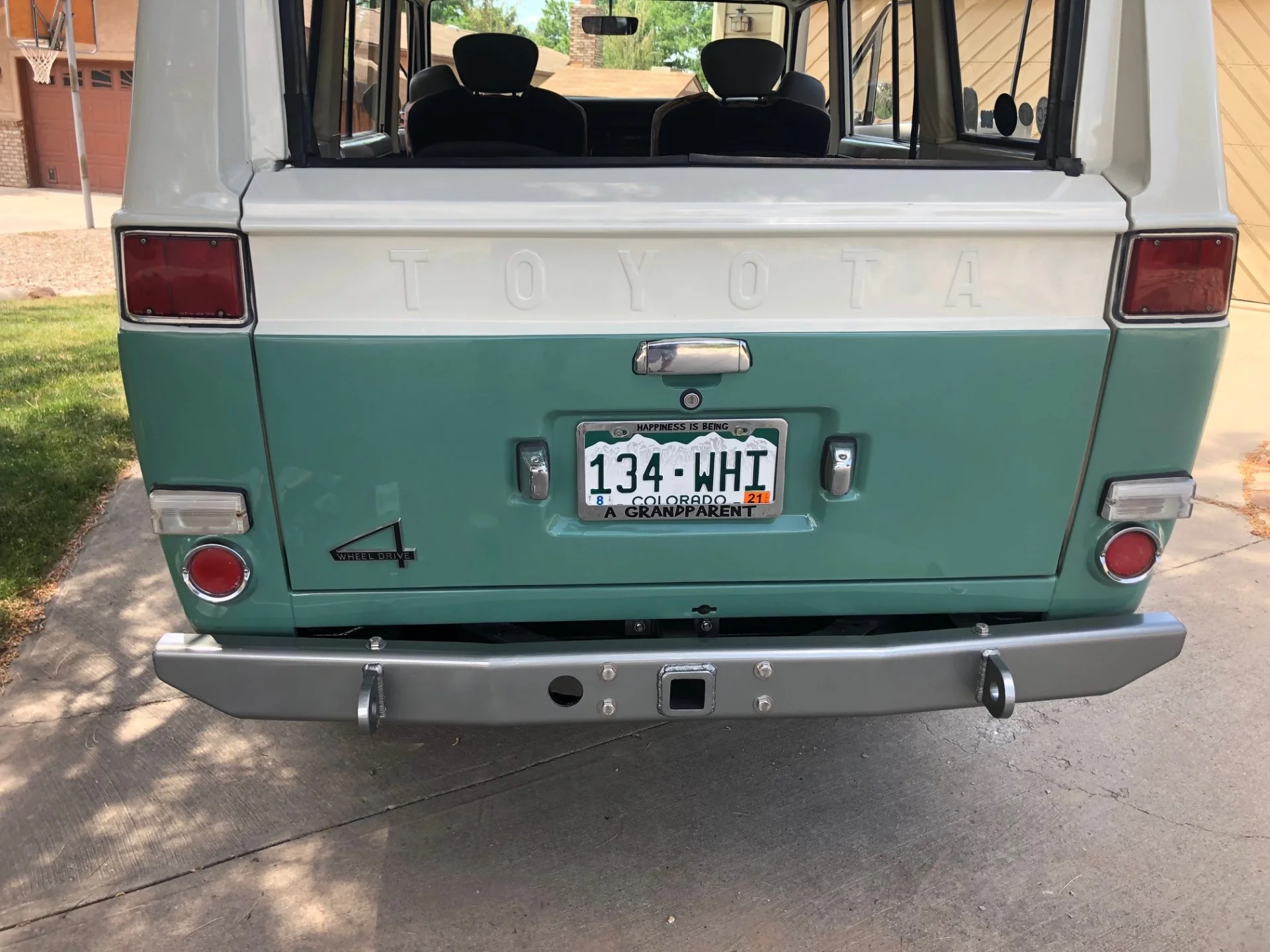

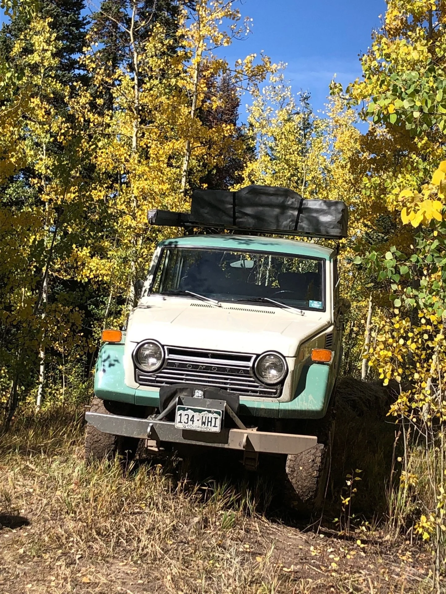

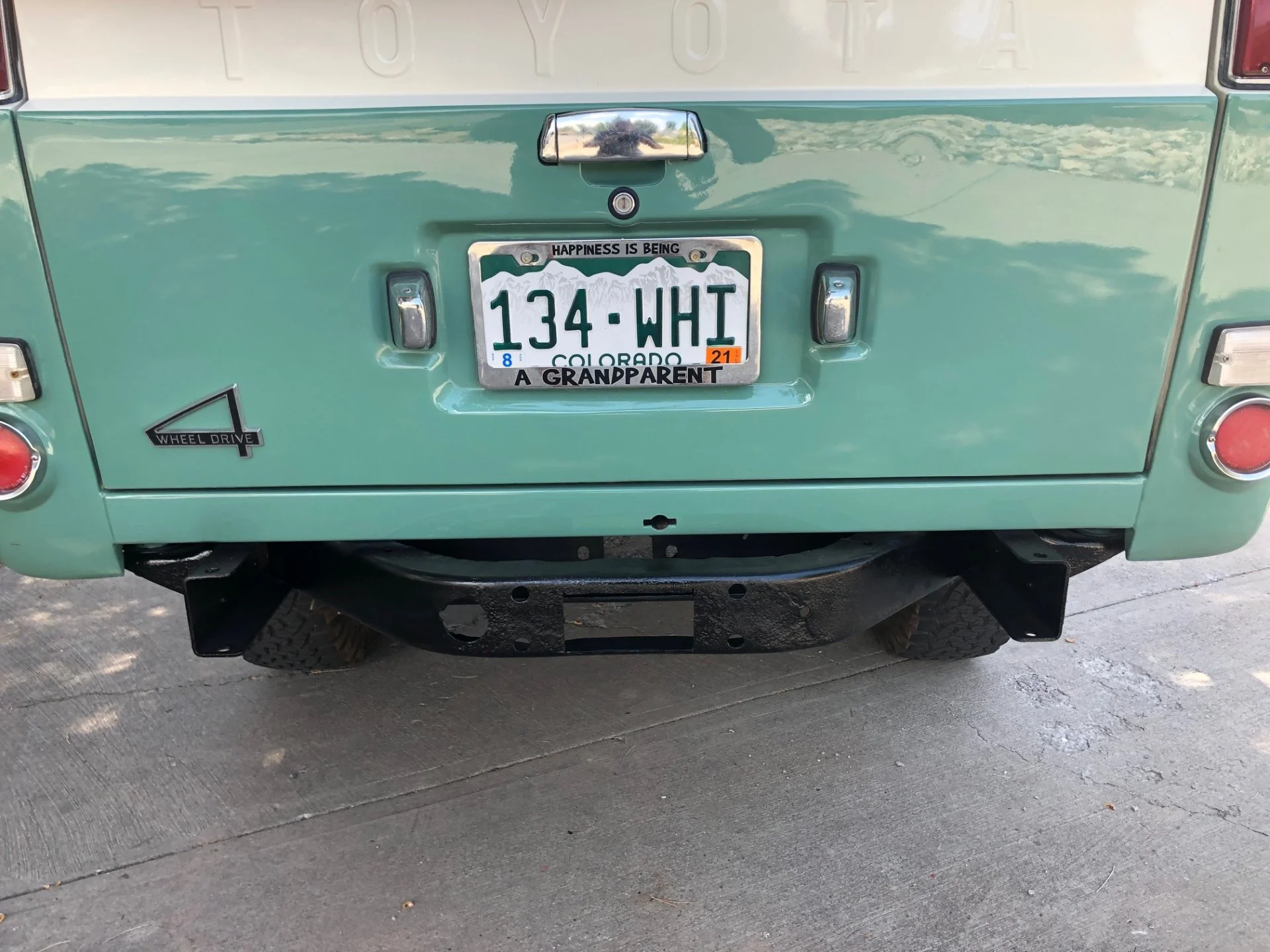

Here’s mine. Fabbed locally to mimic the front obtained from Gary S which I think is a old Iron Pig Off-Road bumper with additional upright structure added. I wanted the receiver tube built into the face of the bumper. Cutting the necessary square hole in the triangular bumper support cost four bolt holes but we added an additional crossmember further back bolted to a tee at the end of the tube. Originally welded in but had to cut it out to change out my gas tank. Design flaw that would have been avoided by shortening the tube and moving the new cross support about a half inch to the back. Fixed by now having it bolt to the frame on either side so it's easily removable if I have to go back in..
Hell for stout. Both bumpers also angle a bit from near the frame horns toward the outside corner of the body. Don't tow much, but wanted it heavy duty to save my frequently damaged rear quarter panels and give Doomer something sturdy to hook to the next time he has to pull me out backwards after I follow him into Utah mud.

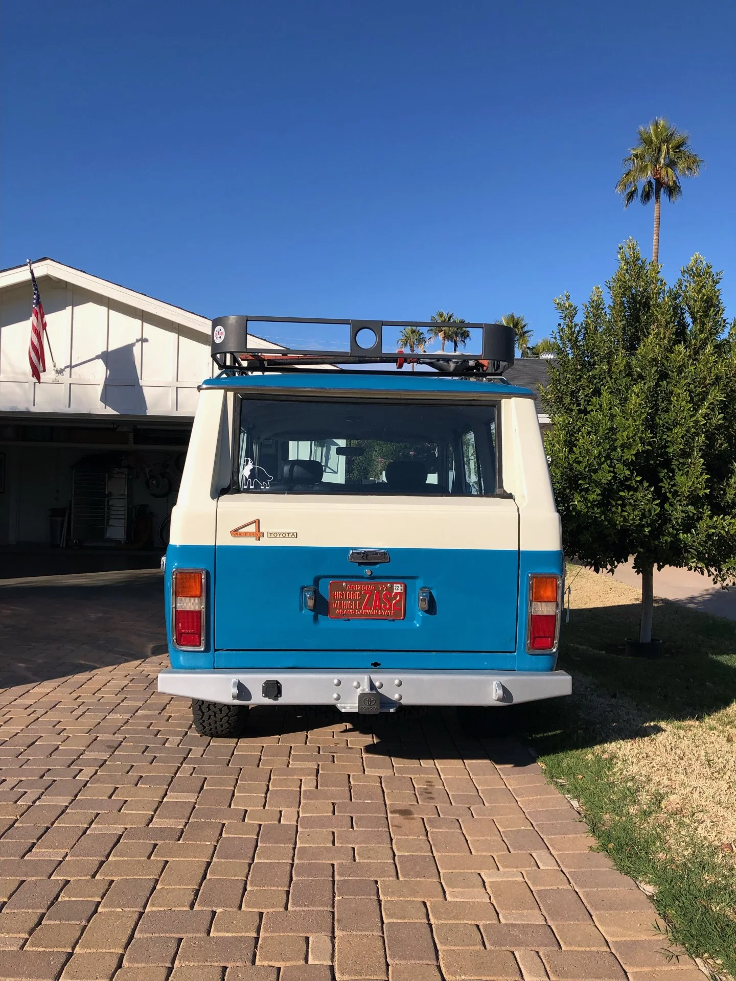

This is the Bump It/BIO rear bumper:
