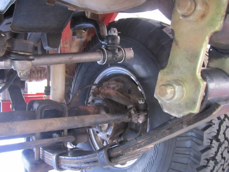

Concerning the steering, initially it wandered pretty bad while driving down the road which was quickly improved by tightening the nuts down on 2 tie rods, Still some wander but much better.
The difference in going from tightened down tie rods to new ones was just as substantial. Kurt at Cruiser outfitters finally got a set of the 555's in and sold me the set of four. I typically am Toyota parts loyal but in this case the price difference was substantial and the build quality of the 555's were very impressive. Bottom line: Now the truck steers straight and feels very tight. I can truly relax driving down the road.

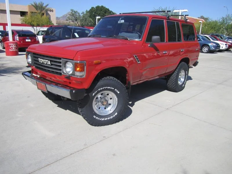

After this I also installed a new set of BFG KO's with the white letters out (old school - 1985 was all about the white letters and is appropriate for this 60 IMO :grinpimp:)
Driveline: Ive been dealing with a vibration from the undercarriage (after the lift) that would start right above 65 mph and get worse as the speed increased. The vehicle would vibrate and create a booming sound in the cabin which was almost deafening at 75mph.
I replaced the u-joints with Toyota joints and sent it out to be balanced. Upon the subsequent test drive, the noise was eliminated! :bounce:You may wonder why I even need to go over 65? Each time I bring the 60 on a group run, in order to keep up with the other CSC'rs on the freeway I must go approx 75-80. A bunch of law-breaking speed demons :eek:
Trans mount: Props to MikeOB1 who suggested I check my Transmission mount after hearing that on the recent March run the transfer case popped out of 4WD once on a tough off camber situation. It didnt do it on a couple more runs up the same hill but Mike said he has seen this same issue. Back at the shop, sure enough after removing the big skid plate we found the trans mount was bad. The new mount now holds the assy tight in place and took away the excessive movement that lead to this problem.
A/C - my expansion valve decided to stop working so upon replacement, we took the opportunity and also cleaned out the evaporator of 27 years of dust. Some new o-rings, reciever dryer, schrader valves, it now blows 26 degrees on low fan speed! Gotta love R-12...
body: The dent guy was sick and no removal of any yet. Maybe later...as long as she is in top shape mechanically, the visuals can take a back seat.

Hey, murf - in that first picture, it looks like you have very little clearance between the steering ball joint and the inside edge of the rim; is that just an optical illusion from the camera angle?
Pic;
<img>https://forum.ih8mud.com/attachment.php?attachmentid=616452&stc=1&d=1333149463&</img>
