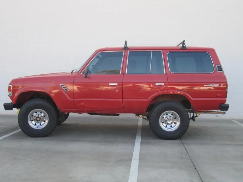

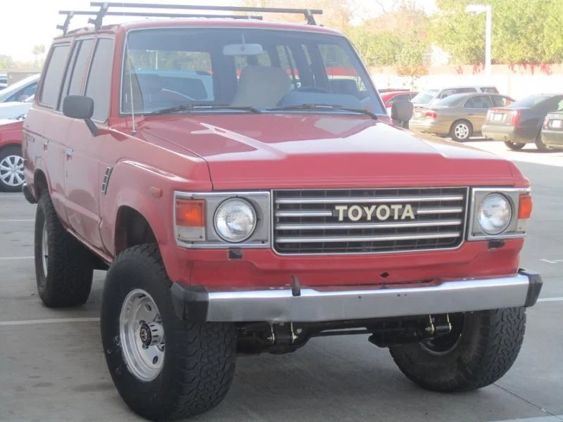

I got the lift springs and matching shocks on finally (thanks Living in the past :cheers:). Replaced the shackles (stock size), shackle bushings, greasable pins, and sway bar link bushings from MAF.
Rides great!
New misc componenets in the engine compartment that needed replaced or upgraded. Cleaned up wheels and paint too.
Mechanicals are mostly done.

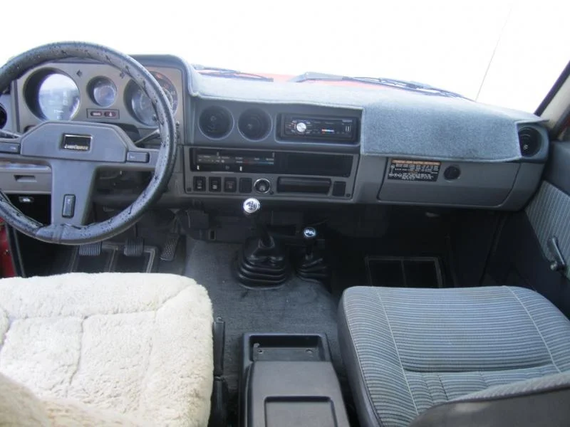

Interior, stereo, rear hatch struts, tint, etc..

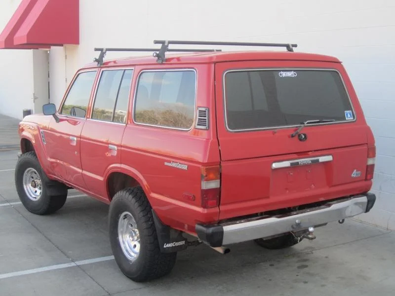

Got her real close except for some minor tweaks and upgrades.
Heres the latest after adding some 33's on 15x8 wheels from MoGas (thx!)

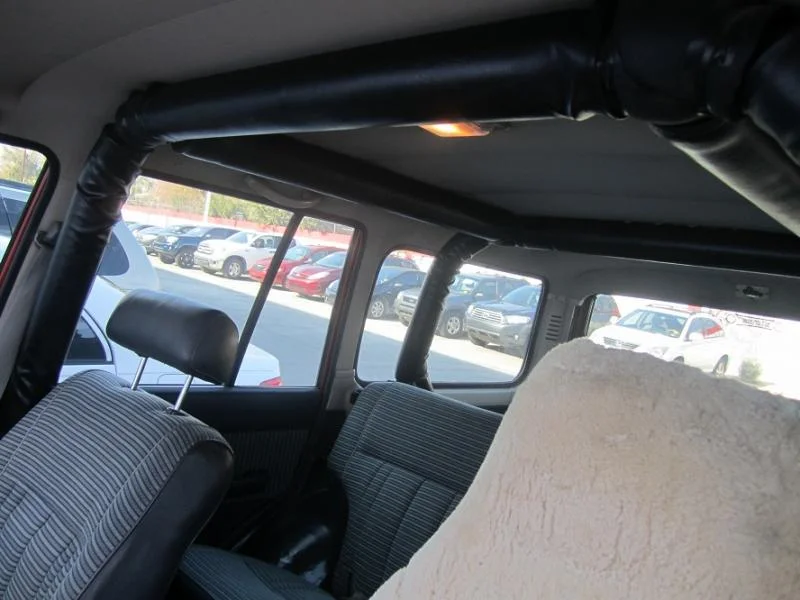

I also added a picture of the top of the 6 point roll bar. (just in case I guess)
most every panel has a ding or dent in it except one I think. Runs great and does well.
Now to get her off road and test it out.

It is looking nice. I'm betting wider tires and greaseable shackles is going to make this ride better than those springs did in my 62. Curious did you use the spring marked A on the driver's side rear? How does it set in the back? Level?
Wow, those wheels cleaned up really well!!!

Yes, the A is on drivers rear and it sits level. The ride is pretty good. Prolly helps I am running 32 front and 28 rear psi.
Mucho buffing really made them look new-ish again. Thx
