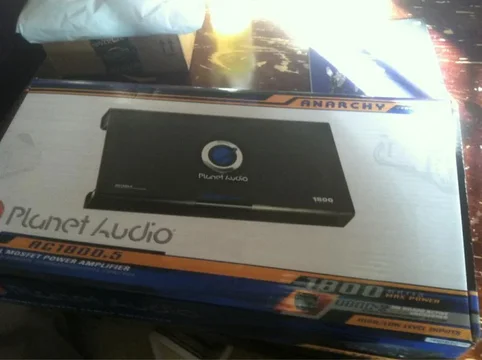

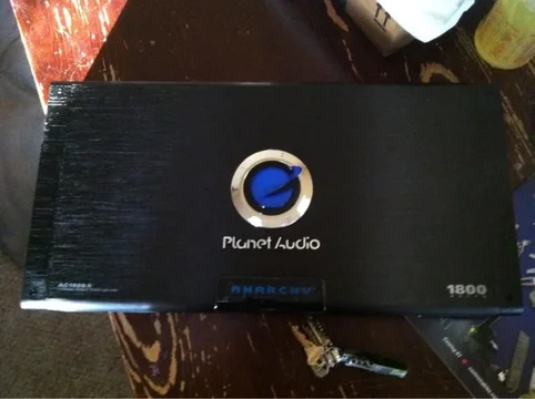

First off I needed an amp. Something that can power 4 door speakers an a sub. 20 years ago had I put my budget on a $150 amp and I would have gotten something that buzzed, smoked, and produced noise not music. Today you can actually get an amp for very little money. After looking at reviews and wanting a 5 channel amp I set my sights on a Planet Audio AC1800.5. For $150 you get 1800watts. Not bad as it comes loaded with all kinds of features. It was the first thing to show up on my doorstep from Amazon.

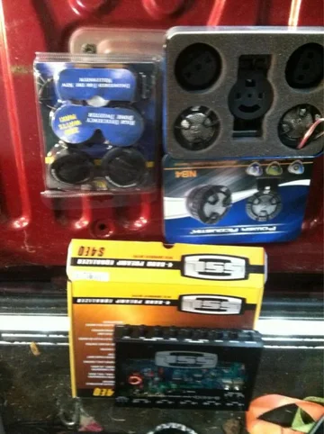

And let's be honest having the ability to adjust just the base and treble for a system with so many different size speakers and so many different places was not going to do. So I bought an eq. For a whopping $30 I got a sound storm laboratories 4 band eq with sub crossover input gains. Hopefully i'll be able to get all the speakers to sound well together. But even better it has knobs. It's a real pain in the ass adjusting the sound on the go trying to use buttons and on screen labels. We all know the Beastie Boys are going to require a whole different set levels than Doc Watson.
As well I picked up two sets of sub $12 tweeters. The reviews were good for the money.

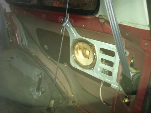

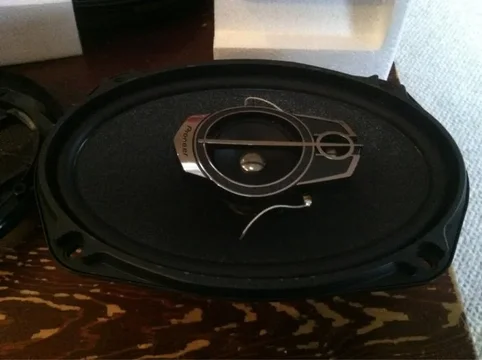

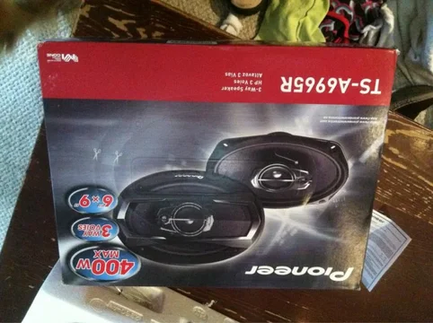

Now on to those 4" speakers in the rear doors. I wanted something that would provide some punch to the system. I'm thinking I can get these $42 pioneer 6x9's to fit in there with a little creativity.

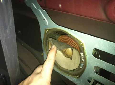

Now that I've got most of the stuff it's time to start making it fit. So off with the rear quarter.
I was really impressed with the factory sub. It really has held up well. In fact so well that the PO unplugged it's awesome sound a long time ago.

Be prepared to cut your rear doors. I put Rockford Fosgate 6.5" T165 speakers in and had to sawsall the indented portion of the sheet metal around the existing mounting holes. Magnets on the 6x9s you purchased, I imagine, can only be bigger. Killed me to cut the 80, but I forgot all about it when I turned on the music.

What year is your 80? That rotted surround on the rear sub has me worried. I just got my '97 and new audio is not in the budget for a long while yet. I hope everything holds up till then.
Guaranteed rotted out sub woofer. Mine was just as bad as the OP’s. Just disconnect it. I removed mine and the bracket. Also, I took note of the color scheme of the remote wire to the amp for future reference when I install my Zapco amps.
There is no way in this world or the next that your amp produces 1800 watts.
it'll do more than the head unit, but in reality the decimal point should move to the left.
What size fuse is on it? 1800w 12v is 150 amperes.
RMS power ratings for his amp are 210 x 4 and 420 x 1. So in reality, 1260W bridged into 2 ohms. I have owned PlanetAudio amps in the past, I was really impressed with their output.
FWIW, It has 3 25amp fuses.
Pretty sure everyone knows a $150 amp that says it makes 1800w doesn't. But I really like the fact you tried hard at finding some sort of flaw in my cheap build.
I think the point he was just trying to make is that there is no way the amp could put out 1800W unless it is some how making it's own power. 75A*14.4V = 1080 max W.

*shrug* it'd already been pointed out that the speakers won't fit.
Yes the 6x9 are not going to fit in the rear doors as is. I thought I could find a simple spacer but that isn't going to happen. So I'm going to build my own out of resin, felt and glass mat. So while I'm customizing my door is there anything I should add to it to make it more function over looks. I need some ideas.
there are a lot of 6x9 spacers on amazon. I guess i don't know how complex the problem you're trying to solve is.
Other than that, the usual. peel-n-seal on the sheet metal, etc.
