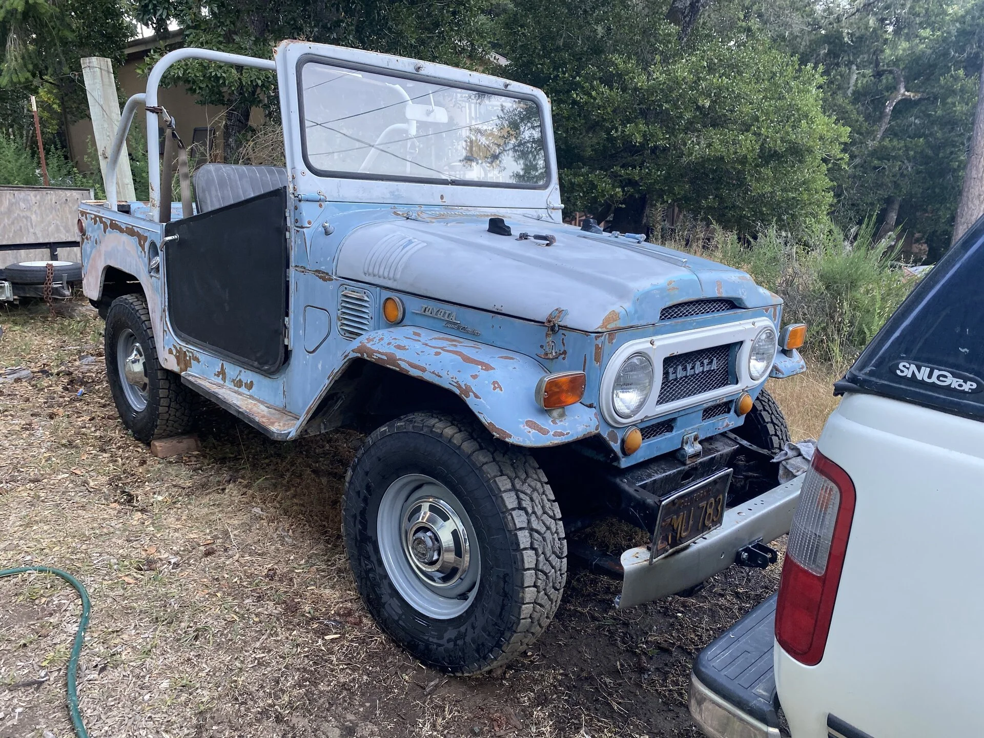

Tonight my son and I bled the brakes and I topped off the coolant. Tomorrow I jump start it, check for leaks, and hopefully take it for a spin.
Since I did the headgasket and a bunch of other stuff, it’s run for maybe 10 minutes total, I’ve turned it around in my driveway (with no brakes 😳 ) and towed it to a car show. That’s it in the last ~2.5 years.

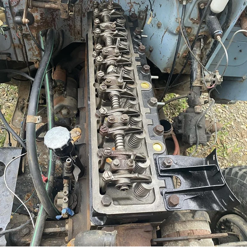

Pulled the valve cover off and attempted to re torque all the bolts except number one which is under the rocker shaft. Then I find out I’m supposed to loosen all the valves first.
Oh well. None of the bolts were loose anyway.

If you didn’t chase all the bolt holes in the block and blow them out, it’s possible that the bolts reached torque without sealing the head and gasket.
I did not, there was no mention of it in my manual and no one said anything until after the fact. Not blaming anyone but me.
I suppose I could start all over again but what’s that saying about doing the same thing over and over, expecting different results... 😉

The odds are good that if you get all the holes cleaned, the gasket will hold.
You DO have the washers on the headbolts, right? The core I bought off the forum a few months ago had a blown head gasket…and no washers ☹️

Hard to see, but yes, washers are present. Thank you for the info, it is appreciated.
Sorry to hear this. The only things I can think of is that the head wasn’t flat to begin with (unlikely as this was a reputable rebuild), the block wasn’t level or had residual stuff on it, or as Mark said, the bolts didn’t torque all the way.
If you decide to go after it again, may help to replace the bolts as well if you hadn’t the first time around. Clean those bores out super good with brake cleaner and an old head bolt with channels cut into the threads to push out the junk, then get super dry with paper towels stuffed into the bores. Bolts should go in lightly lubricated.

If I do it again, definitely new bolts, a good hole clean and check the block with a straight edge this time.

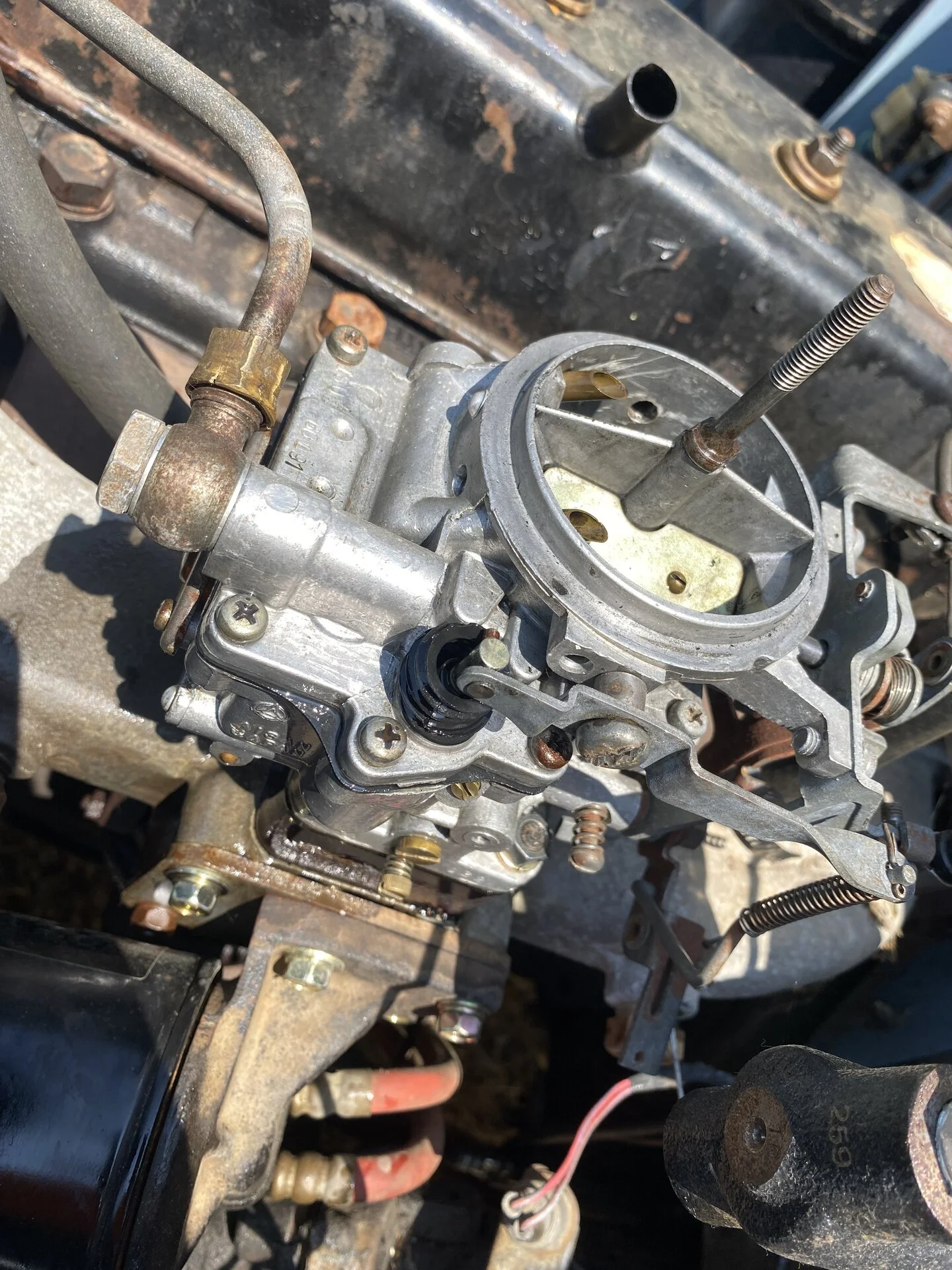

Re-tourqued the head and topped off the coolant. Started it to give it a once over to find the carburetor puking fuel everywhere. The fun doesn’t stop. The top was loose so I tightened the screws. It’s pouring out of the boot and shooting out of those upper ports.
Likely a sticky needle and seat. Give it a few light taps on the inlet port to hopefully get it unstuck without pulling the top of the carb off.
