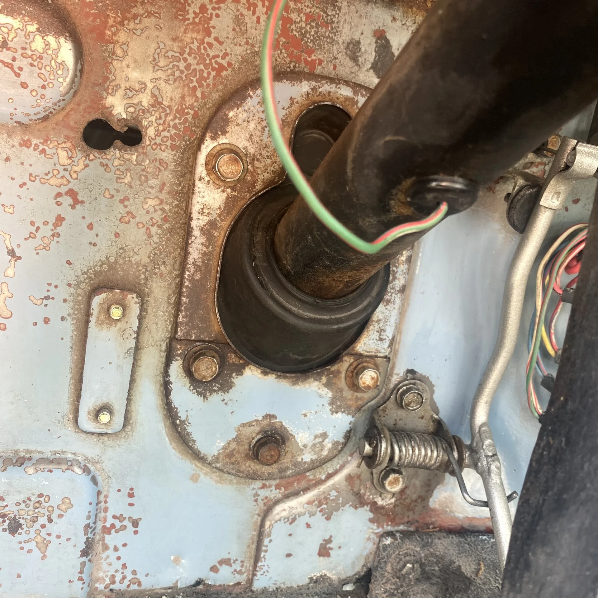

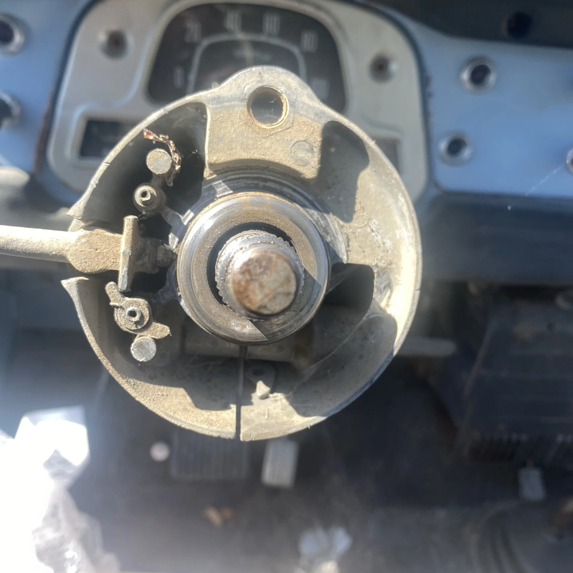

Looking good. That firewall steering column seal is available. I fixed mine awhile back.
At some point I’ll go through and replace all the grommets I can. Debating wether or not to remove the heater, as I’ll probably never use it. More holes to plug. 😉

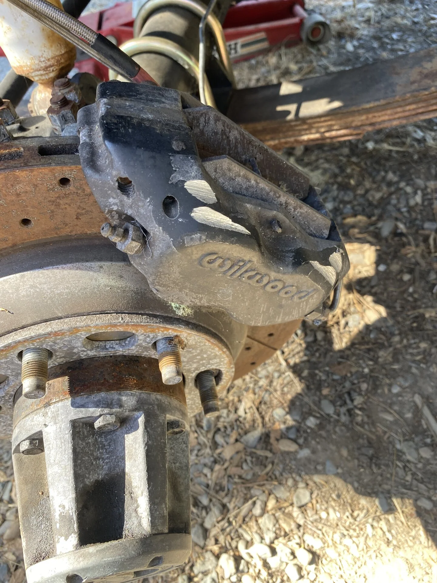

Found out my (stock, welded, steel) wheels don’t fit whatever Wilwood disc brake kit is on this front end.
Regardless, I still can’t get pedal (at first pump) despite bleeding all the wheels and master again.

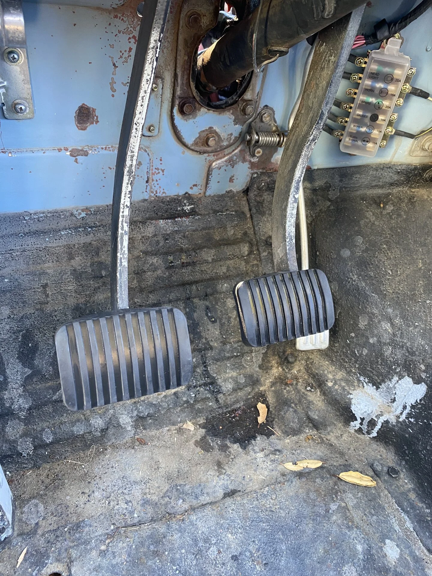

Put the pedal pads on though, so there’s that.
