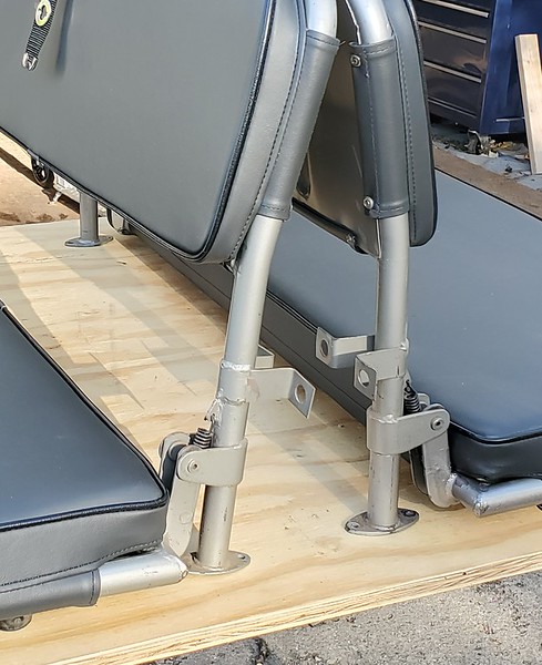

Working on installing my swap meet rear seats. I think they’ve been modded a time or two and don’t want to fit at all.
I can get both rear body tabs to work, and most of the posts I can tweak to fit, but both of the front body tabs sit way high and inside to bolt up.
I’ve beat on the area where the posts sit (it’s a bit rusty and that f&$”ing bedliner crap) to try and lower them but I think I have to cut them off and have someone weld them back on once I get the uppers to bolt up.
Not sure what these seats were out of but nothing lined up. The holes in the bottom tabs are too close together to fit the threaded holes in the tub even though they look the same as the tabs on my spare frame that does fit.
The front tabs for the body are too high.
I guess I’m going to make a couple feet with the correct spacing and have them welded on to the frame in place of the ones on there now.
Grind off the front bracket and have it welded on lower.
Not sure how clean you want to make them, but do you have enough room on the upper brackets to just elongate the holes?
On the bottom ones you could also weld on some material and drill another hole; but probably the same effort as welding on a new foot like you mentioned.
I can’t answer as far as why the holes are different; I don’t know how they changed over the years.
If the bracket didn’t extend above the sill, I probably would enlarge the wholes, but they’re pretty big already.
Now that I’ve removed them from one frame, I have an idea of what I’m up against. It’s the welding them back on that is a pita. Hopefully I can find someone local and drive it over there to have them done.
I’m far from a good welder; but it’s really handy. If you think you’ll use it in the future you can pick up a mig for decent prices and the learning curve isn’t too bad. I wouldn’t trust my welds on an axle or something but most stuff is ok.
Removed the windshield frame. What a pita. Worst part is, I broke the glass in the process. 😬
Got all the bolts out though. I have another one that is way less rusty and I don’t have to unpaint it.
Here's a pic of the stock seats out of my '69. The feet look slightly different compared to yours, maybe? Are your seat bottoms rectangular or angled?
Those look like mine from what I can tell. Both of my swap meet seats had feet that looked like the ones that came with my seat, the holes were just closer together by ~3/8”. Weirdest thing. I either have to find a junk seat with the correct feet or make my own. Both options about the same level of difficulty.
