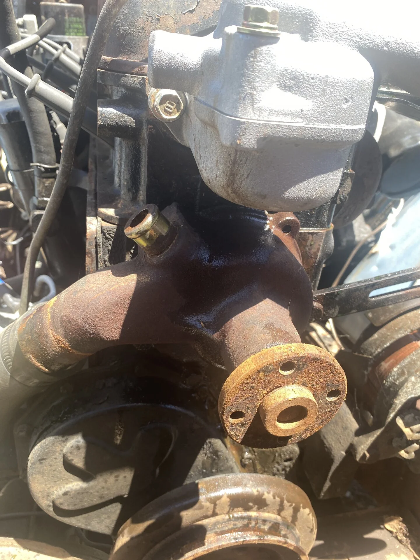

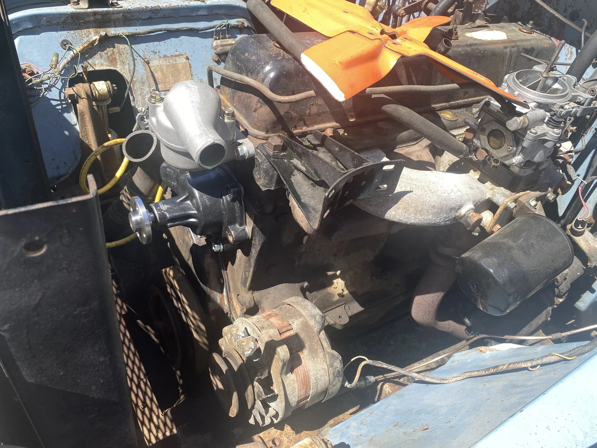

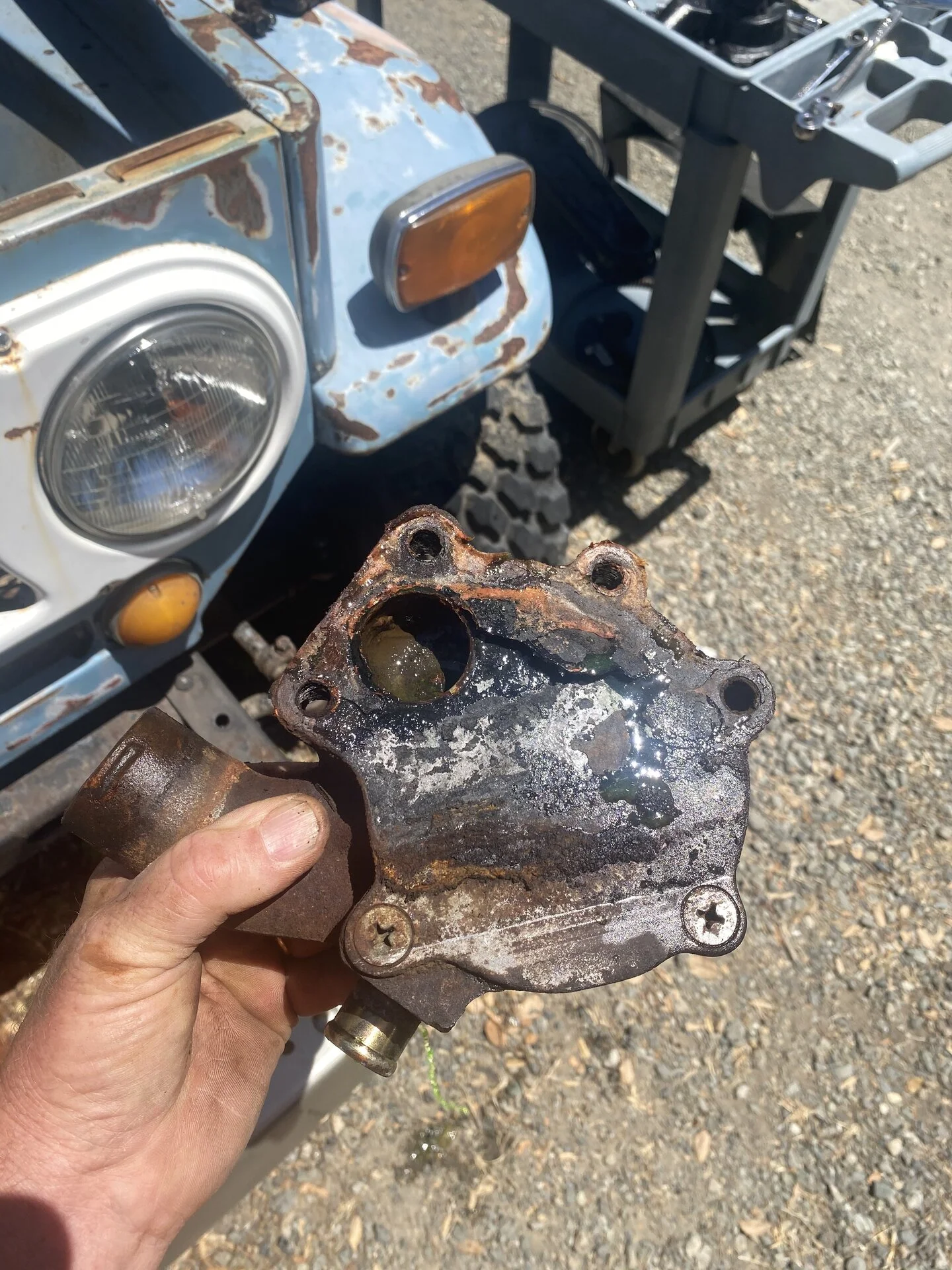

Yes! Waterpump requires Toyota FIPG on both sides of the plate on the pump body as well as the new gasket.
Both sides of the plate? It’s already assembled. Do you recommend a bead around the whole plate, smear it around where the gasket goes, and on the gasket to block surface?
I did some of that red spray-a-gasket on both sides of the paper gasket, let it get tacky and then put it together. Worked out fine.
Orange FIPG (for coolant) not the black FIPG (for oil). Light coat on both sides of gasket.
Yes, take plate off. Then both sides of gasket. The black toyota fipg is fine as long as you don't fill the coolant right away. Assemble and let it cure 24 hrs first.
So the parts guy at the dealer said orange was for transmissions, there’s a black for coolant at $90/tube or the standard black fipg at $20/tube. Guess which one I’m going with. 😉
I’ll let it set up for a day or two before refilling the coolant.
Don’t know where that brain fart came from, good you verified such. Sorry ‘bout that.

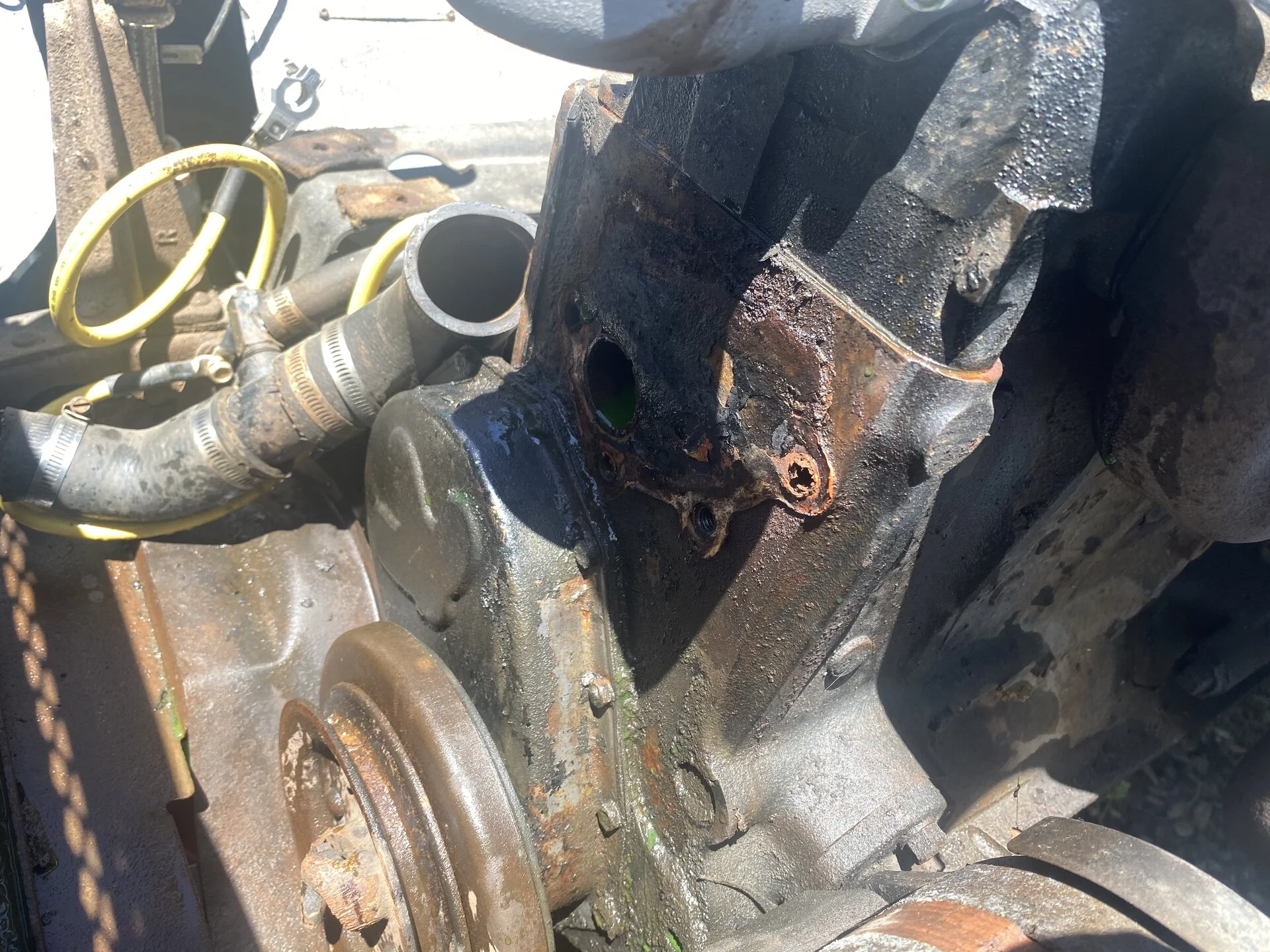

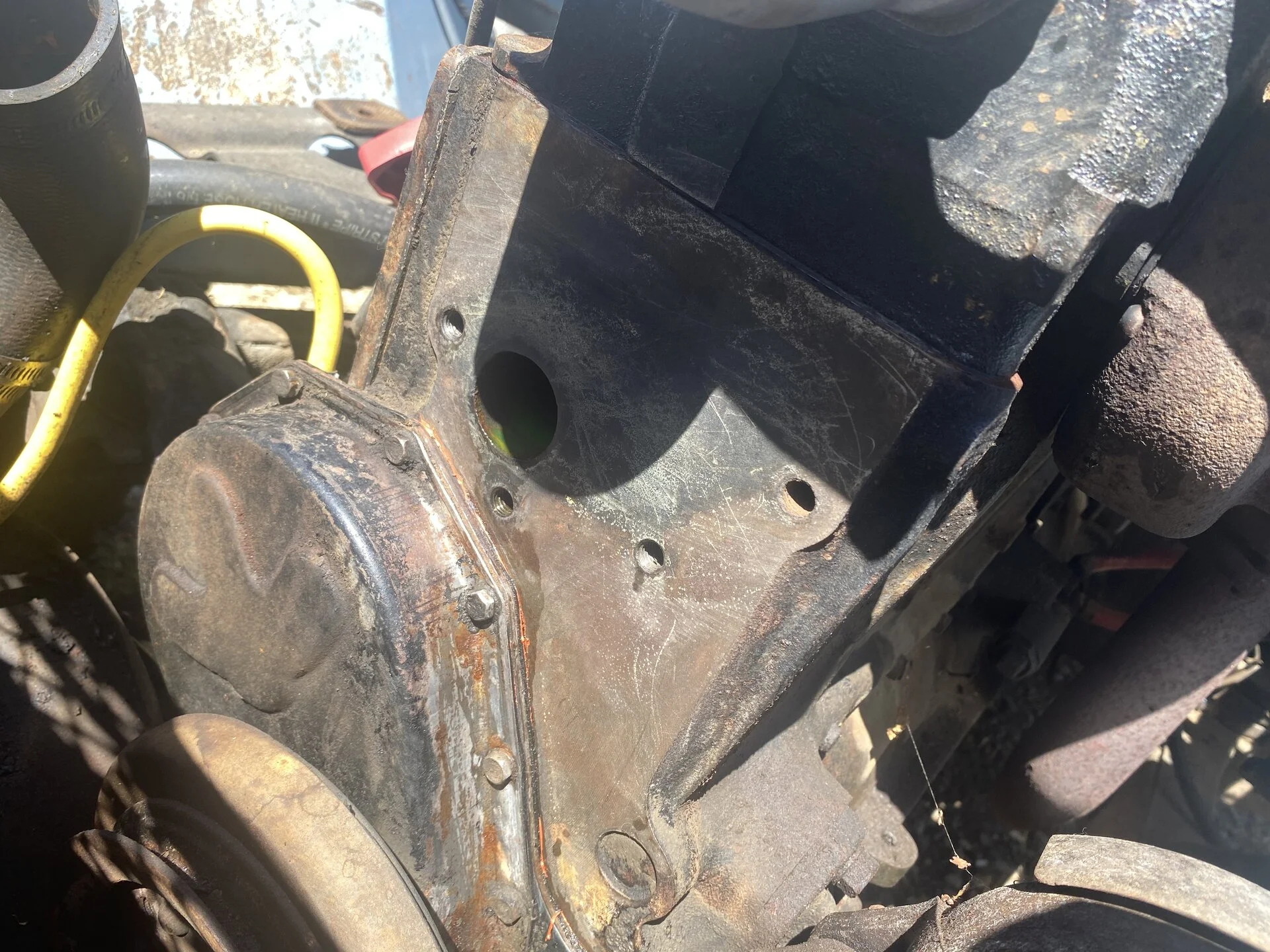

Aaaand guess who’s got a stripped water pump bolt hole.
Yay me. It’s getting assembled for now. Hoping to make a local show on Saturday.
